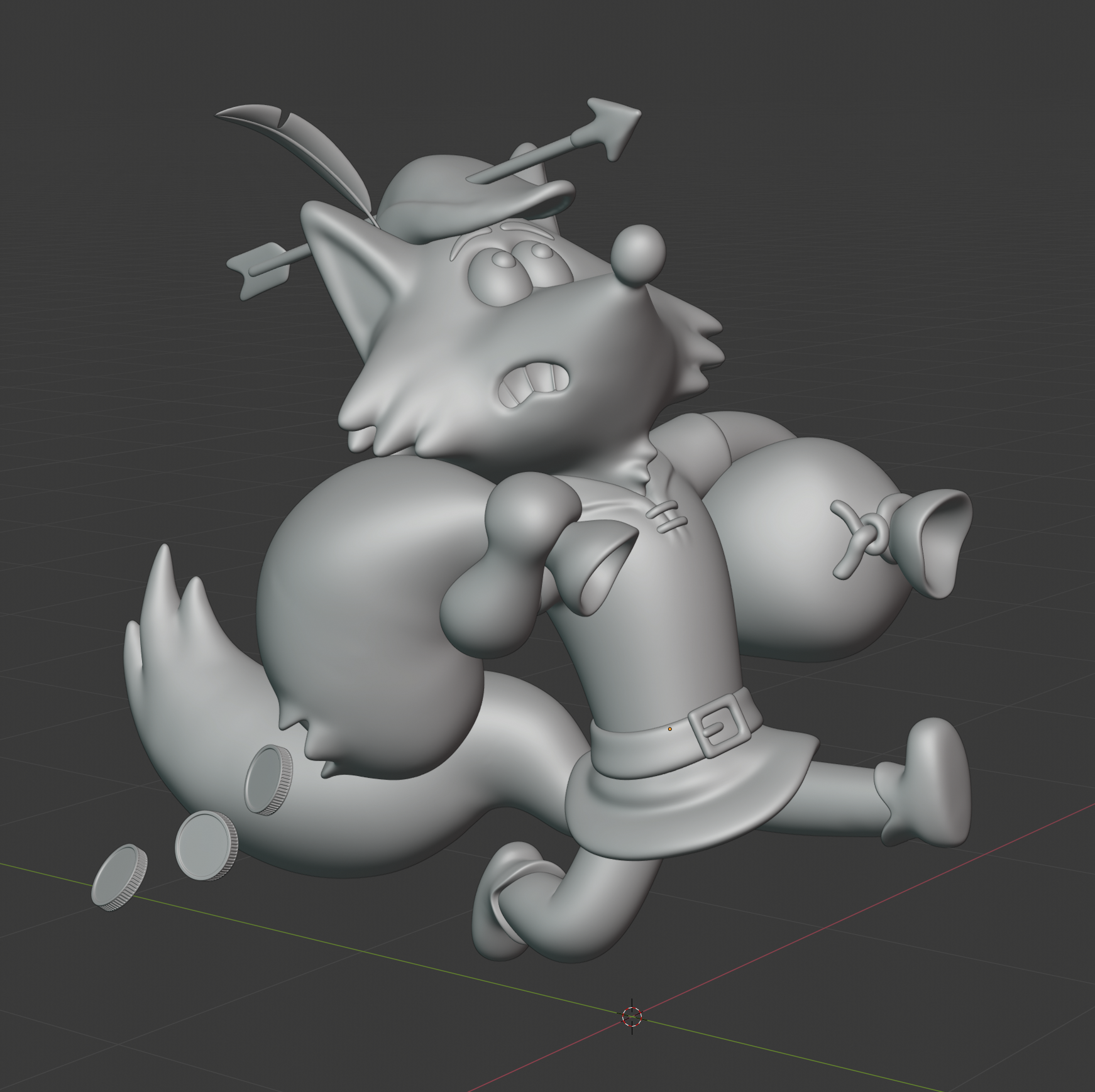

So far we’ve got the finished model of the kawaii incarnation of Disney’s Robin Hood fox character. The first part of this 2-part Blender tutorial covers the modeling procedure. Please follow that part first if you haven’t already done that.
The finished fox character model

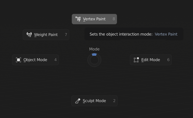

Select a part you’d like to color first, then enter Vertex Paint mode by pressing Control + Tab and selecting the Vertex Paint menu item.
Activating Vertex Paint mode by pressing Control + Tab

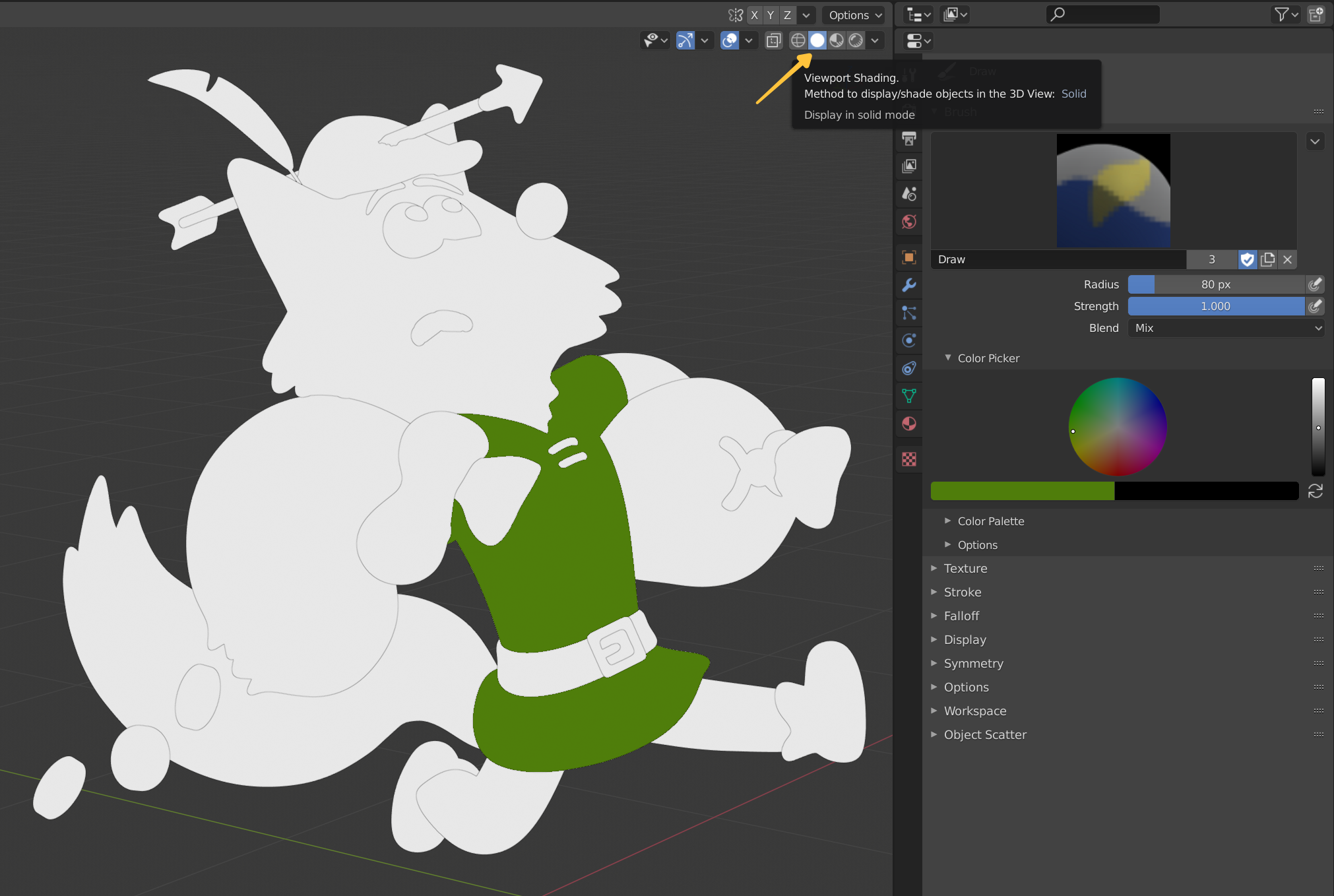

After activating Vertex Paint mode, I usually switch the Viewport Shading to Flat, in order to have a clear, plain view of the colors, but also to easily pick colors from the viewport without shading getting in the way.
Pick a color for the currently selected object, and press Shift + K to fill the object with the color.
Setting the viewport shading to flat for color clarity

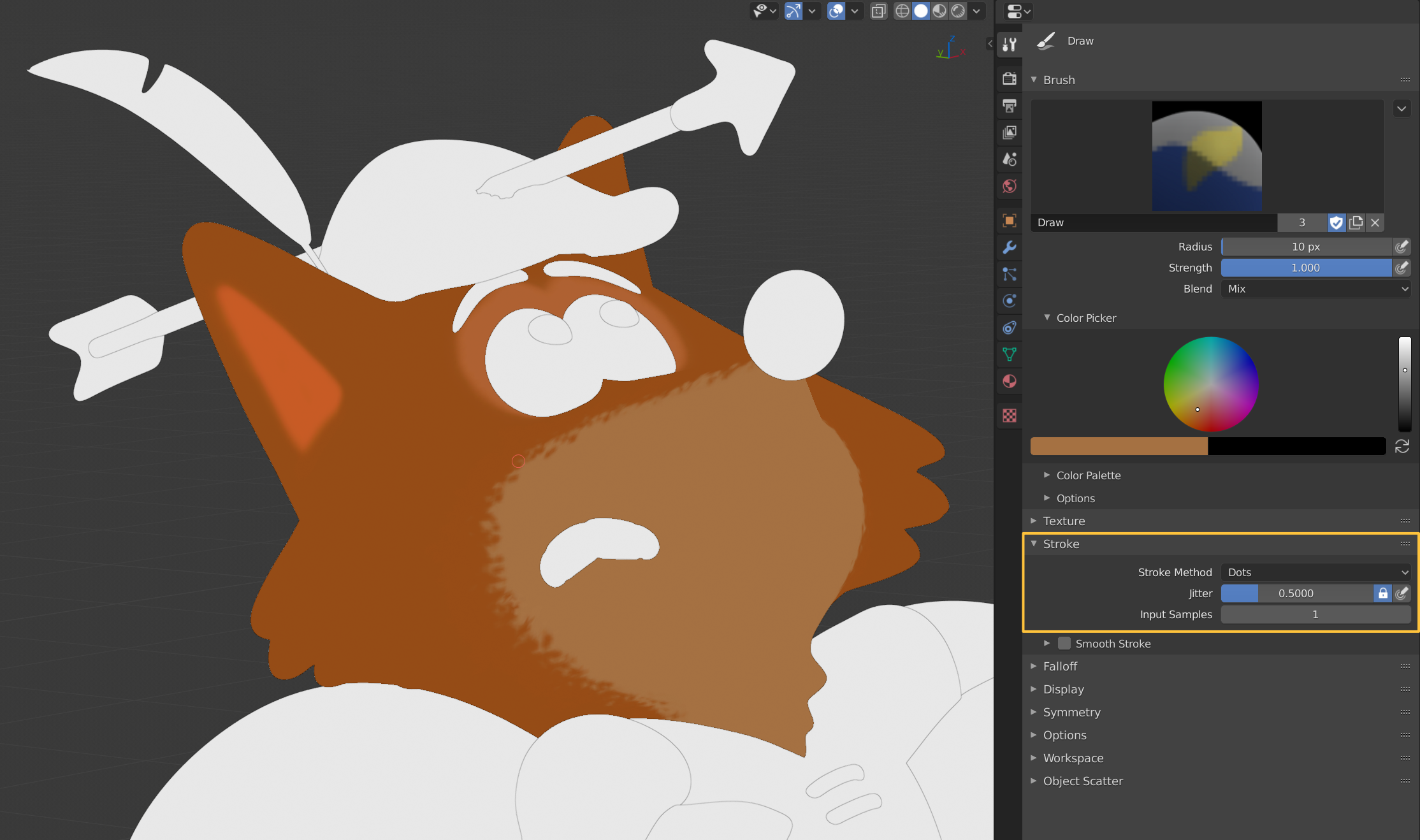

  4. Paint the snout area with the Draw tool from the left side toolbar.
  5. In the Active Tool settings tab, open the Stroke rollout, select the Dots stroke type, and increase the Jitter value.
  6. Set the brush Radius value to a small size and start spraying paint dots across the snout color border.
  7. Alternate between the snout area’s beige color and the head’s brown fur color, to establish more variation in the paint dot shapes.
  8. Experiment with the brush settings for different effects, until the result is satisfactory.
Now switch back to a smooth paint brush, and add a pinkish-red color to the inner area of the ears, and a light brown color around the eyes. Voilá, your fox head is done.
Activating Dots and Jitter Stroke settings to prepare for spraying dots

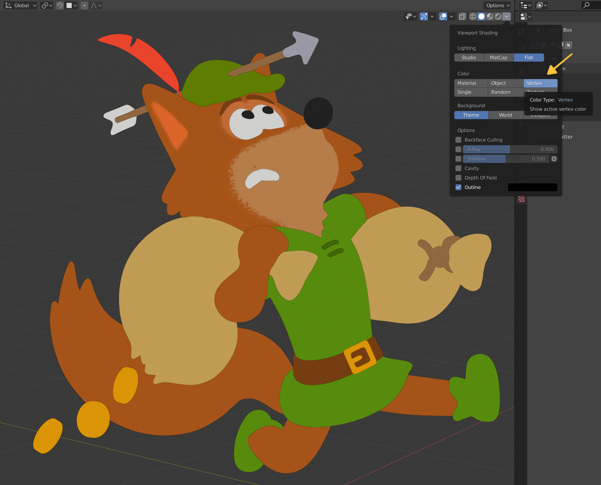

Once you return to Object Mode, the vertex colors become invisible. Simply activate Viewport Shading ➔ Colors ➔ Vertex to view all vertex colors.
Activating Vertex viewport shading mode to see all vertex colors in Object Mode

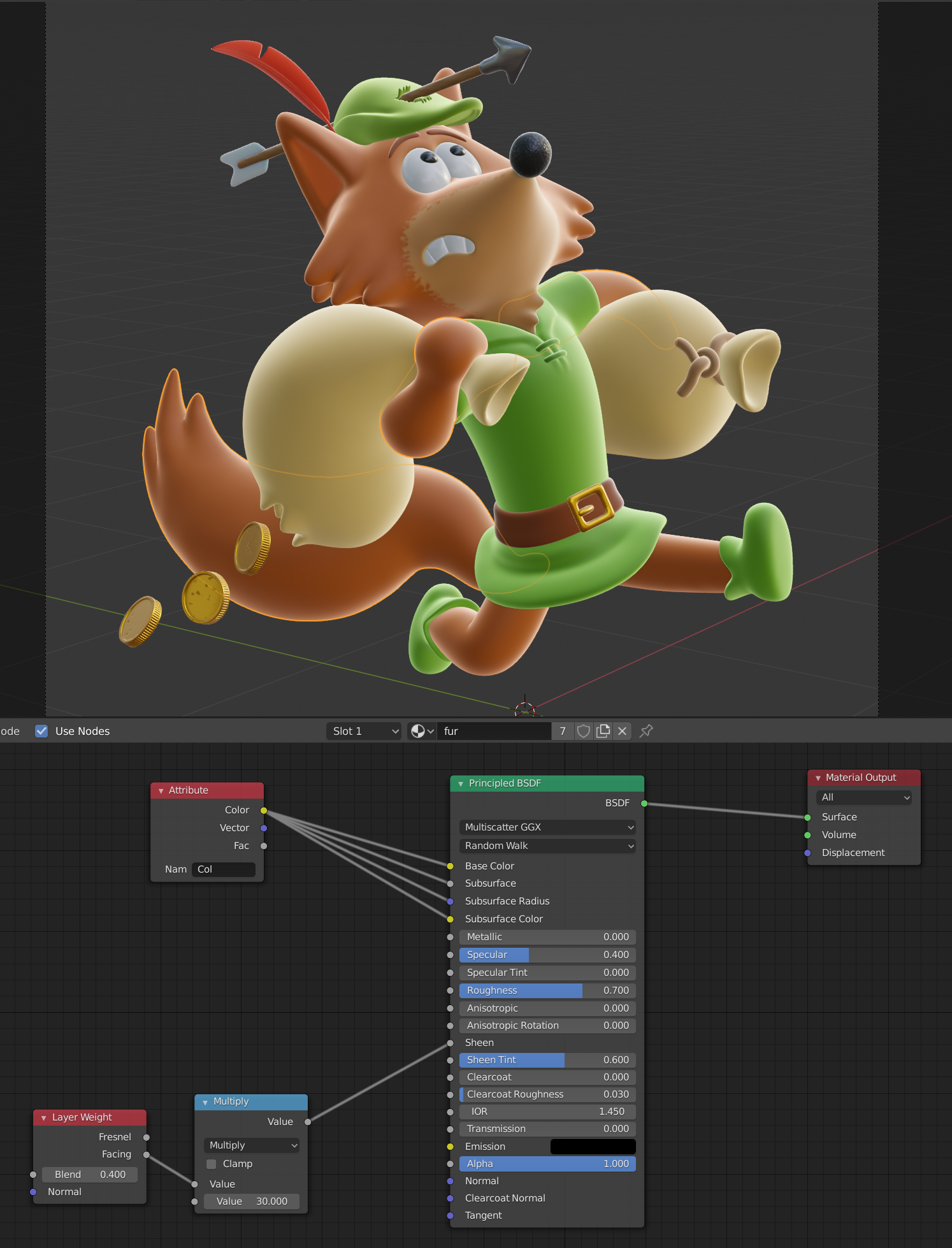

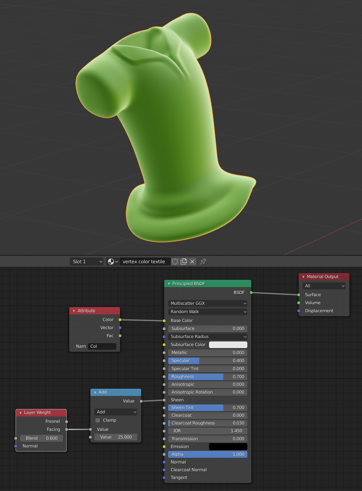

3. Creating Materials for Robin Hood
In Object Mode, select the shirt of the Fox, and press Shift + H to hide all other model parts.
Press the Z key and choose Material Preview to see shading on your vertex-painted shirt. Then split the viewport into two sections on top of each other by moving your pointer to a corner of the main view and dragging up or down when the cursor changes to a cross shape.
Now place your pointer in the new bottom section and press Shift + F3 to switch the area to the Shader Editor.
The default material is a Principled BSDF material, which is a flexible general-purpose material.

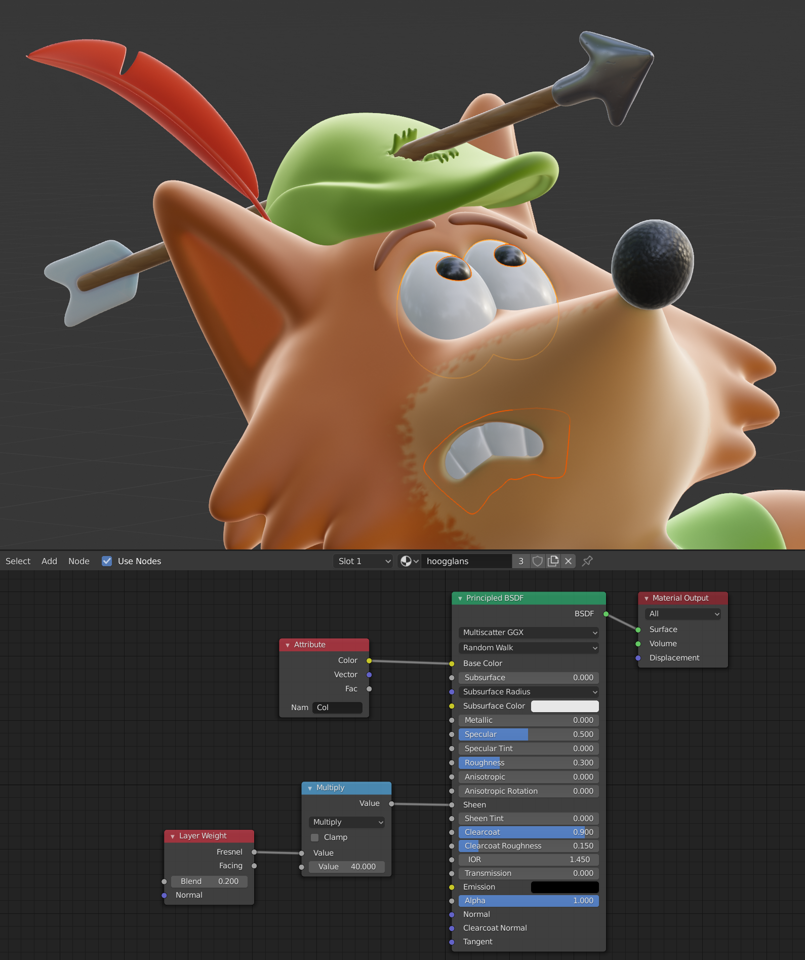

With the pointer still in the Shader Editor section, press Shift + A and select Input menu ➔ Attribute.
Enter “Col” (without the quotation marks) in the Attribute node’s text input field, then connect the Attribute node to the Base Color input dot of the material. This makes the vertex paint channel visible in the material. “Col” is the default vertex channel name, but you can rename a vertex color channel if you like.
Now we’ll add a sheen to the shirt, to make it more like fabric. Using Shift + A again, add a Layer Weight node and a Math node (in Add mode) to the Shader Editor, set the values, settings and node connections as in the screenshot, and connect the result to the material’s Sheen input dot.
Adding vertex color and a fabric-like sheen with nodes
The Layer Weight node restricts the sheen effect to the object’s edges, and the Math (Add) node adds enough to the output value to make the effect really visible.
Set the Sheen Tint value to 0.7, which pushes the sheen color towards the material’s diffuse color instead of neutral white.
With your pointer placed inside the 3D view, press Alt + H to unhide all objects, and assign the material to all textile / fabric parts (clothing, shoes, money bags, hat, etcetera).
A big advantage of coloring each part by applying vertex colors is that you don’t need to create different materials for each color, just for parts with different surface properties, like glossy parts and matte parts.
For the fur I’ve made a slight variation of the textile material, adding some SubSurface Scattering for a more vivid result. You can fiddle with the different Subsurface parameters, but I just lazily plugged the vertex color Attribute node into all Subsurface slots of the material, and changed some other values here and there, see the next screenshot.

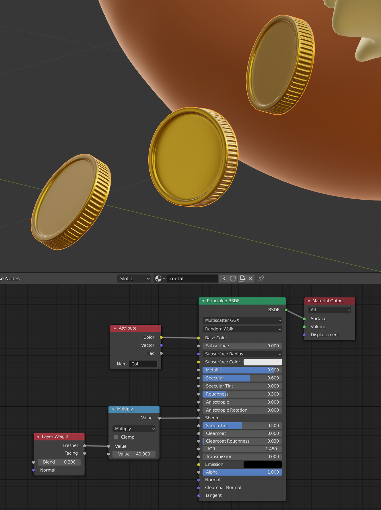

For the metal parts (coins, belt buckle and arrowhead) I cranked up the material’s Metallic value and adjusted some other settings, see the next screenshot.
Increasing the Metallic value and tweaking some settings for the metal parts

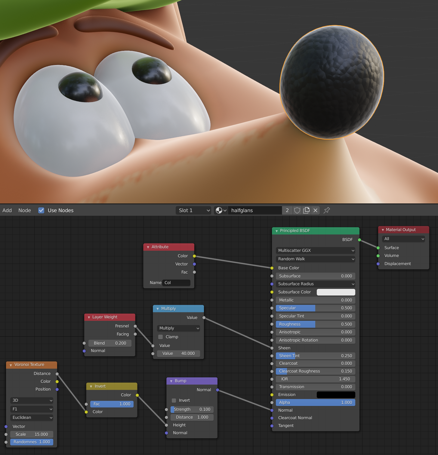

To finish it off I gave the nose a subtle Voronoi noise with a Bump node in the material’s Normal input.
A bumpy nose using a Voronoi texture

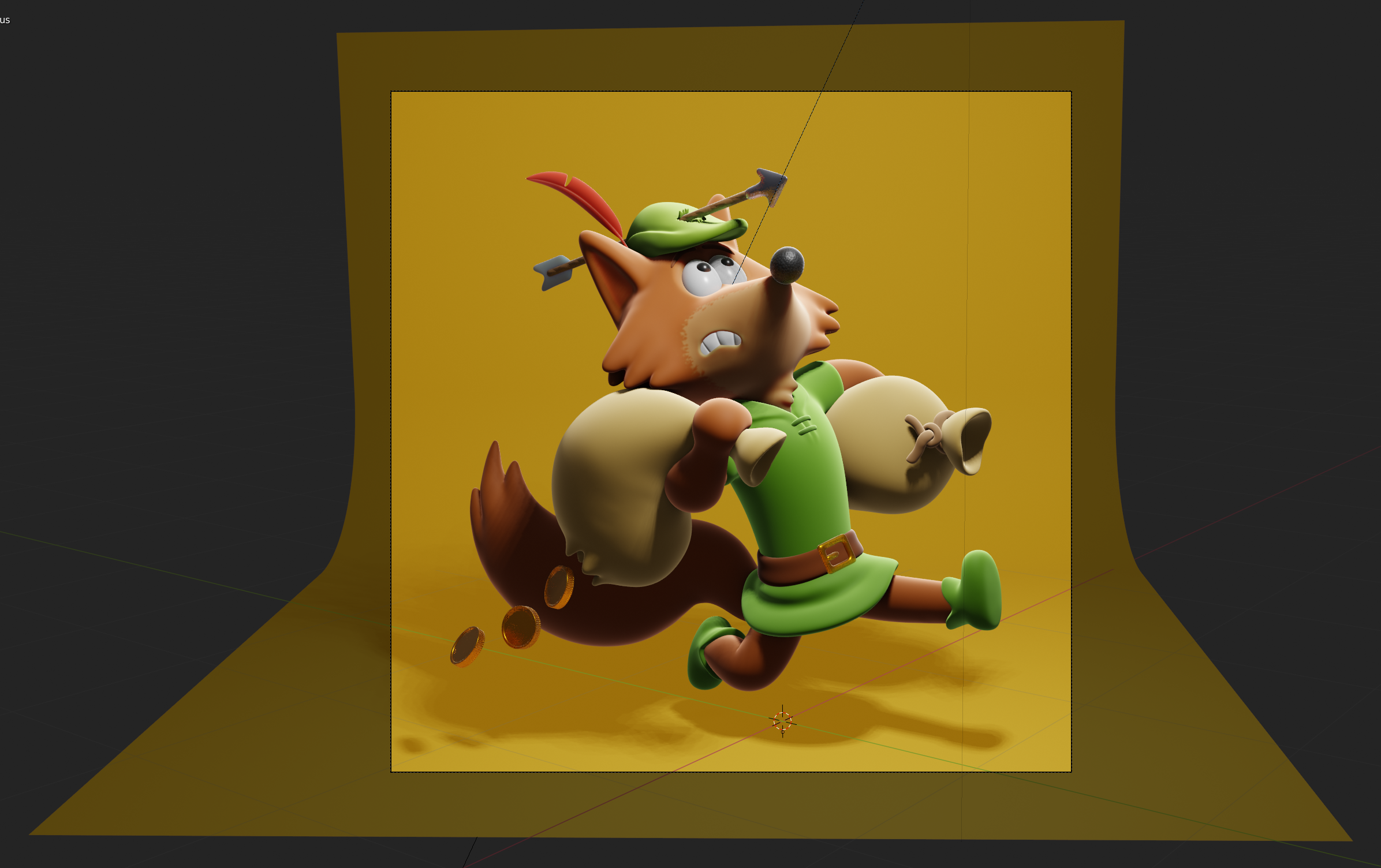

4. Lighting and rendering
For lighting I simply added a standard Blender Area light type, then created a simple Plane primitive with an extruded edge and a Bevel modifier to serve as a background.
Press Z and choose Rendered to see the Eevee renderer’s result in the viewport.
The initial Eevee rendering result
The background plane includes a slight bit of Emission to avoid harsh dropshadows.

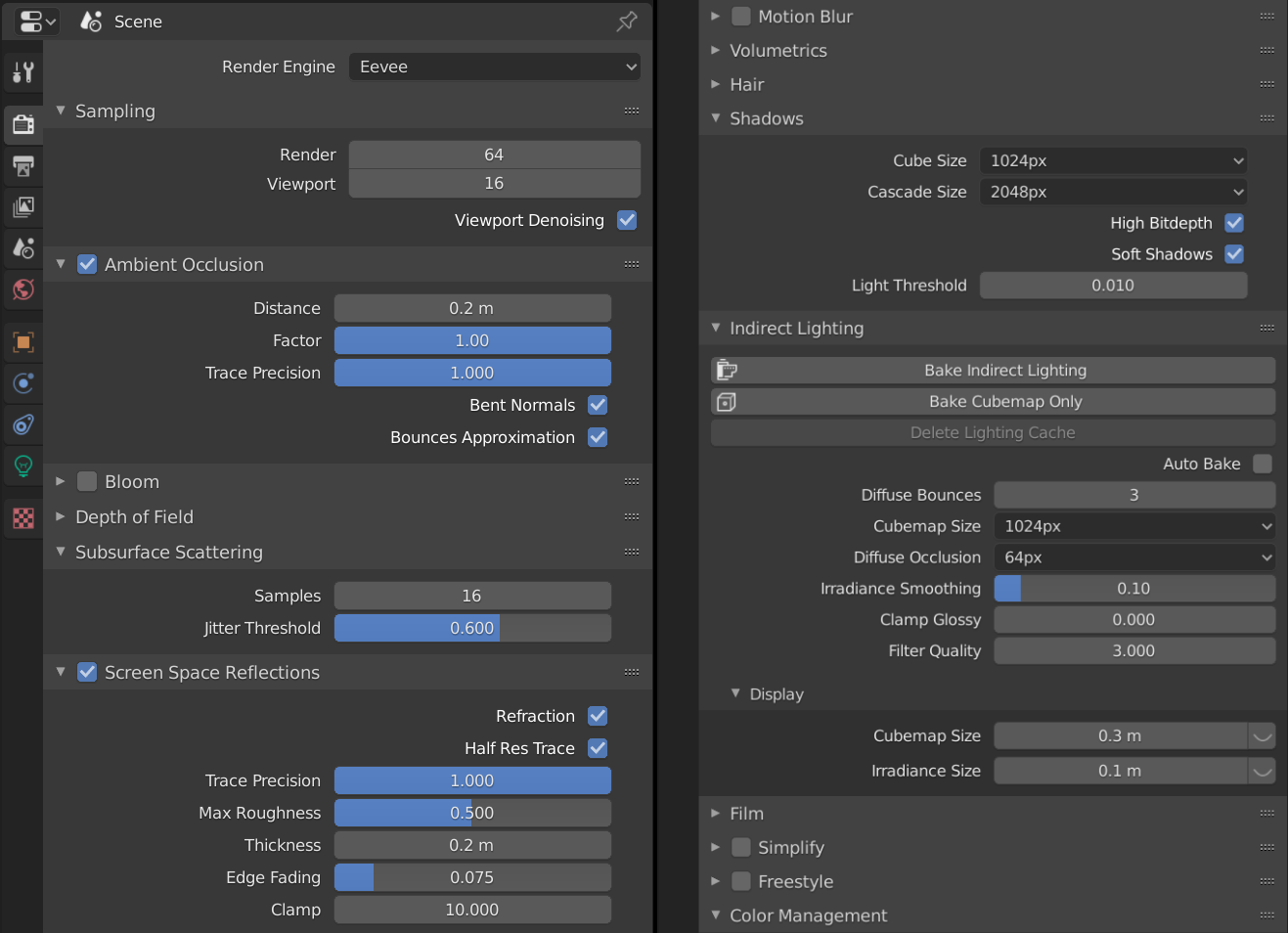

I turned up the Eevee settings, because the end result will a still image, so we don’t need speed-preserving low-quality settings.
Souped-up Eevee render settings

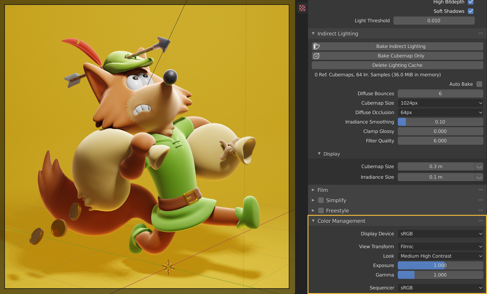

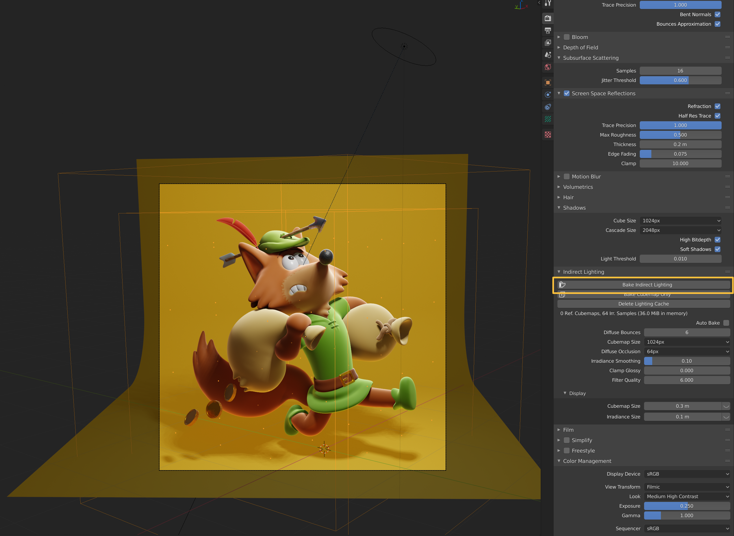

The shadow parts of the fox are too dark. To fix this, press Shift + A, and add an Irradiance Volume from the Light Probe submenu. Scale and position the Irradiance Volume cube to encompass the fox. Then go to the Render Properties tab ➔ Indirect Lighting rollout, turn up the Diffuse Bounces to 6, and press the Bake Indirect Lighting button to calculate the bounced light on the fox.
Baking indirect lighting to brighten the shadow parts
Let’s move on to some final adjustments. Scroll to the Color Management tab, set the Look to Medium High Contrast, and the Exposure value to 1.
Color Management tuning for lighter shadow areas

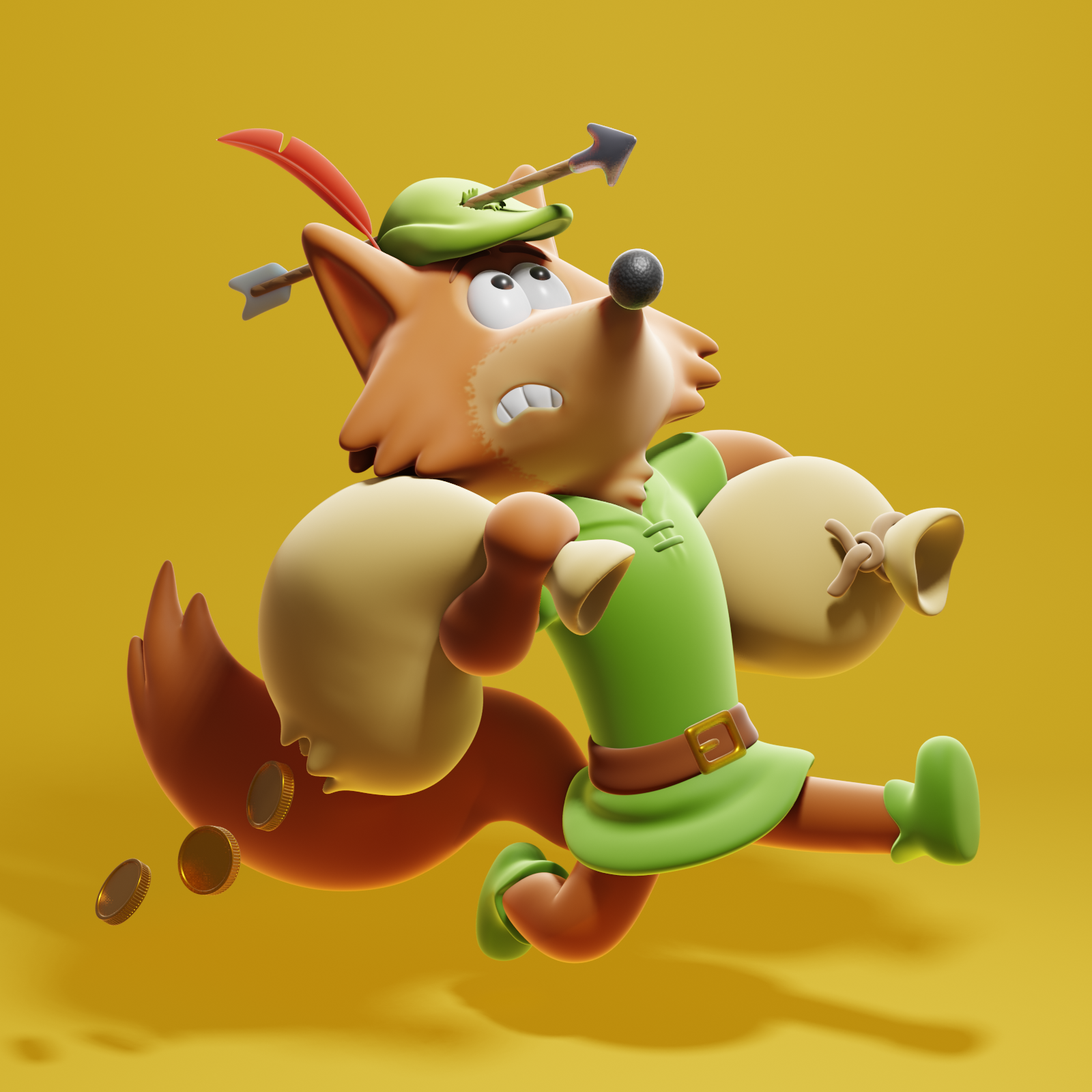

This concludes Robin Hood’s 3D journey. To render an image:
  1. Increase the Eevee Render samples (I doubled the value to 128).
  2. Add a camera (Shift + A ➔ Camera).
  3. Set the desired X and Y pixel dimensions in the Output Properties tab.
  4. Press the F12 key to render.
  5. When the rendering is finished, press Shift + S to save it.
The final Robin Hood fox Eevee rendering
