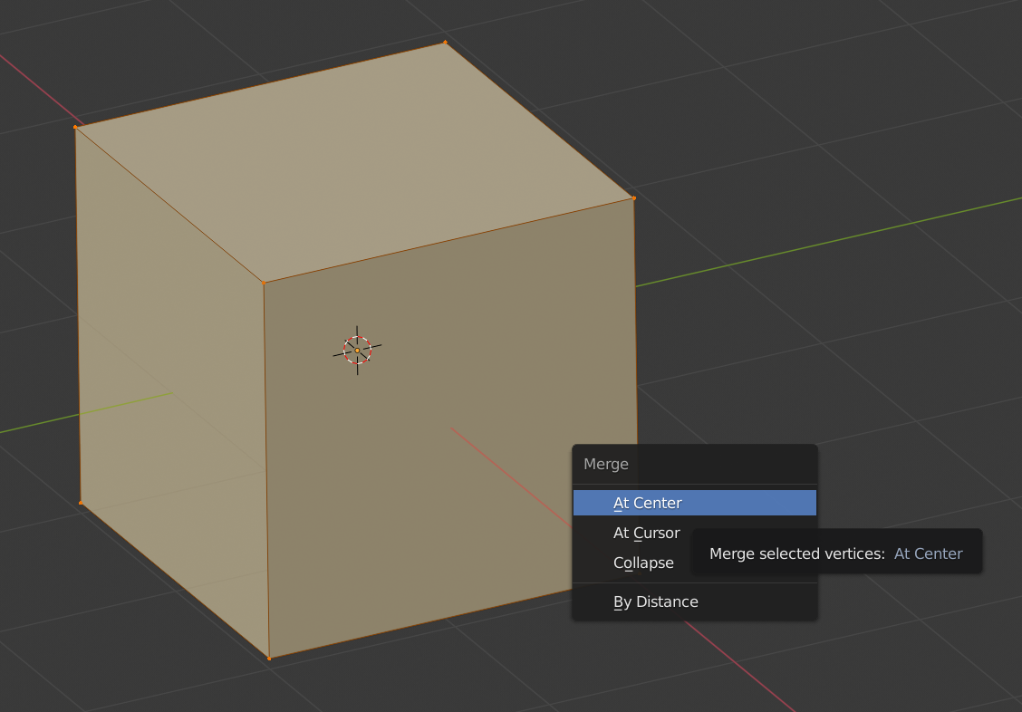

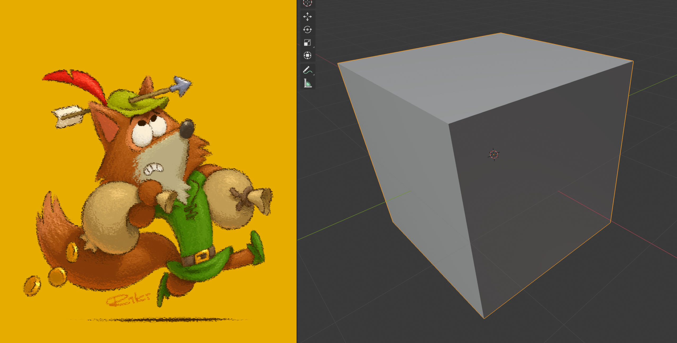

I always delete the camera and light, for minimal distraction during the modeling phase. Then I select the default cube, enter Edit Mode and press Alt + M ➔ At Center to leave only one vertex at the world center.
Then I press E to extrude that vertex and form an edge, and add a Skin modifier.

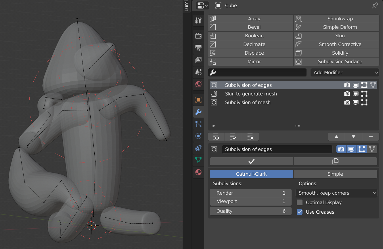

Add a Subdivision modifier to the modifier stack, and set the subdivisions to 3.
The result of a Skin and Subdivision modifier on an edge.

If your model is symmetrical, add a Mirror modifier before the Skin modifier, and synchronize the mirror axes of the Mirror modifier and Skin modifier.
To make the Skin modifier’s mesh result a bit smoother, add another Subdivision modifier before the Skin modifier, to subdivide the edges before they’re ‘Skinned’.

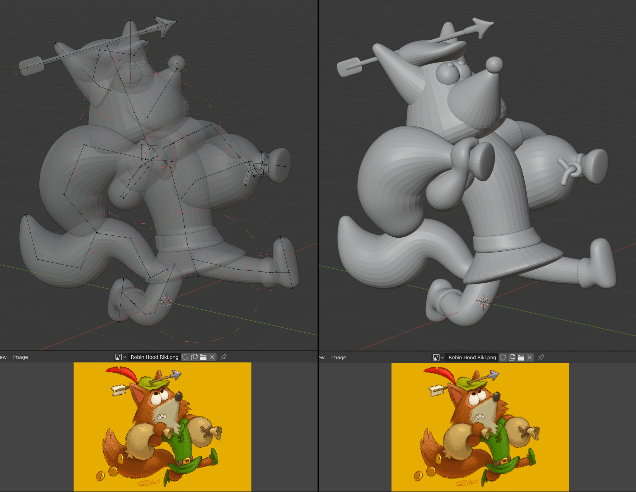

Work in progress of blocking out the fox base shapes using the Skin and Subdivision modifiers. A Subdivision modifier has been added before the Skin modifier as well.
If an ‘island’ of edges doesn’t show up as a mesh part generated by the Skin modifier, that part will probably lack a marked root vertex. You can assign this in the Skin modifier settings. It’s good practice to assign the root to a vertex at an outer end.
To select connected edges, press the L key while the pointer is placed on the part, or select a vertex and press Control + L to select all linked vertices. You can then easily copy the selected part using Shift + D. If necessary, press Alt + A to deselect all before selecting the desired part.
You can also non-uniformly scale a vertex influence on the Skin modifier result by pressing X or Y after Control + A. This is useful for things like making hand shapes flatter than the arm they’re extruded from. To reset the non-uniform scaling, select vertices and press the Equalize Radii button in the Skin modifier settings.

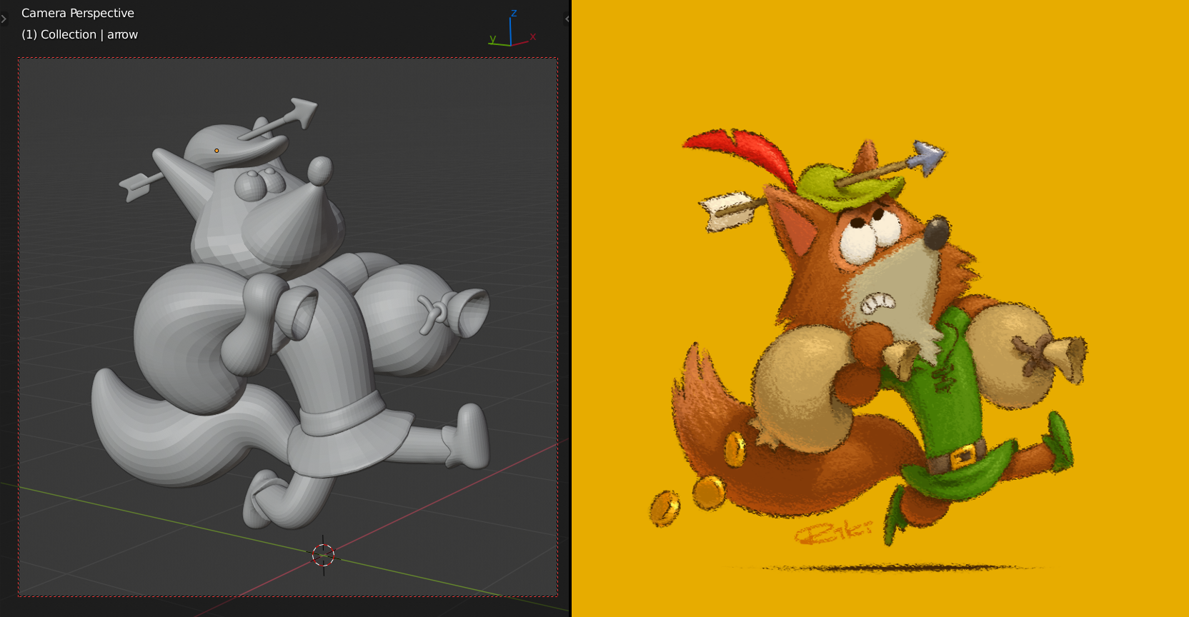

  • Now it’s time to add (or unhide) a camera, assign a section of the UI to the camera view, and modify the camera view and settings to match the concept art, so from now on you can keep an eye on the camera view while adjusting and sculpting.

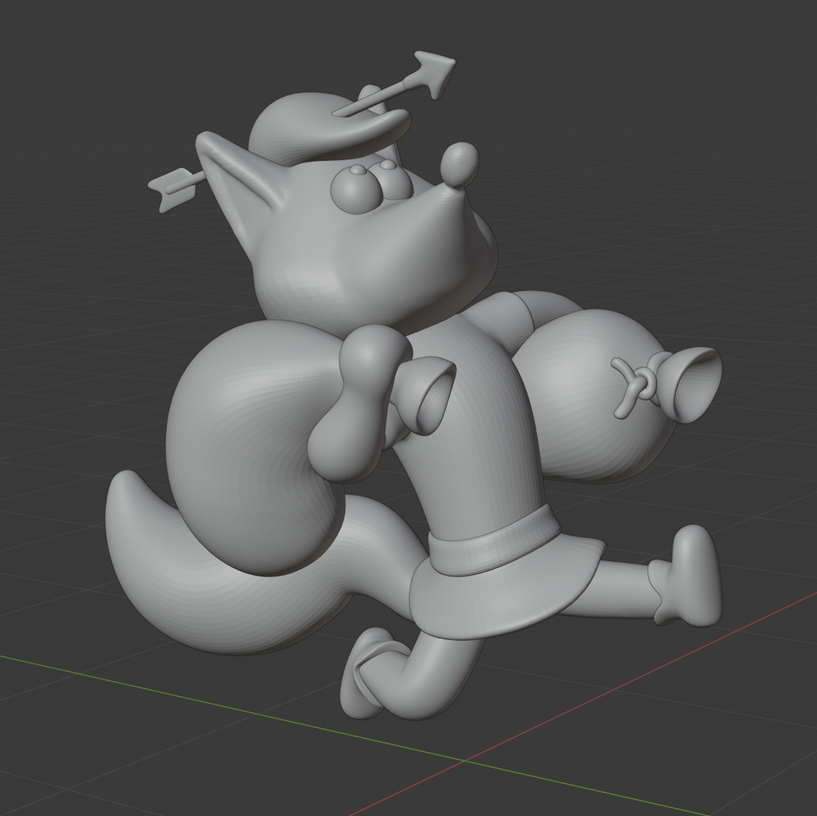

The tuned result, opening the door to fine-tuning

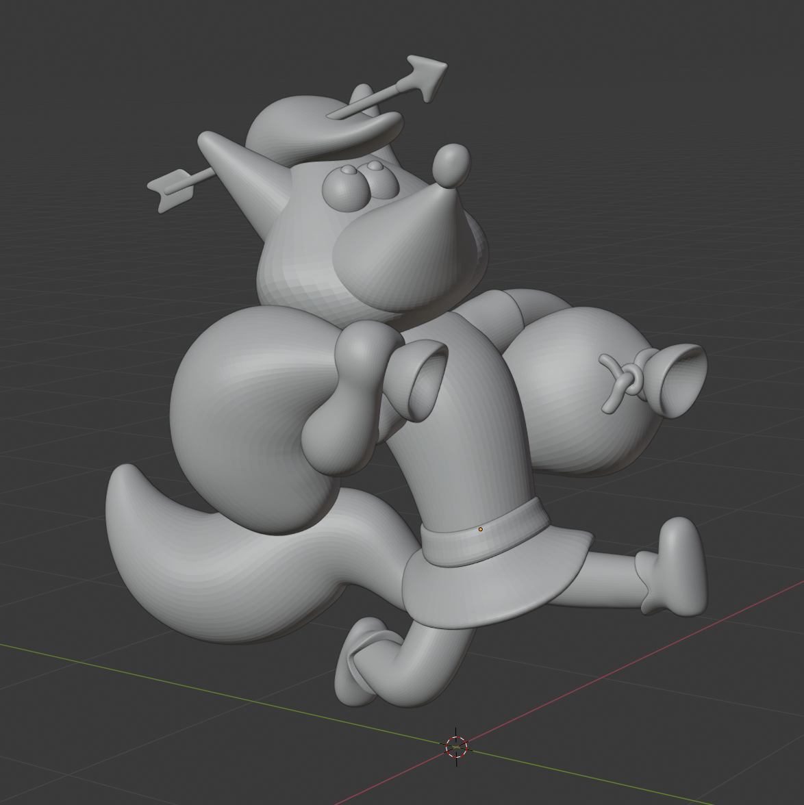

First I add one more subdivision level to all parts, because I had left the detail low to keep everything very adjustable.
One more subdivision added for smoother shapes

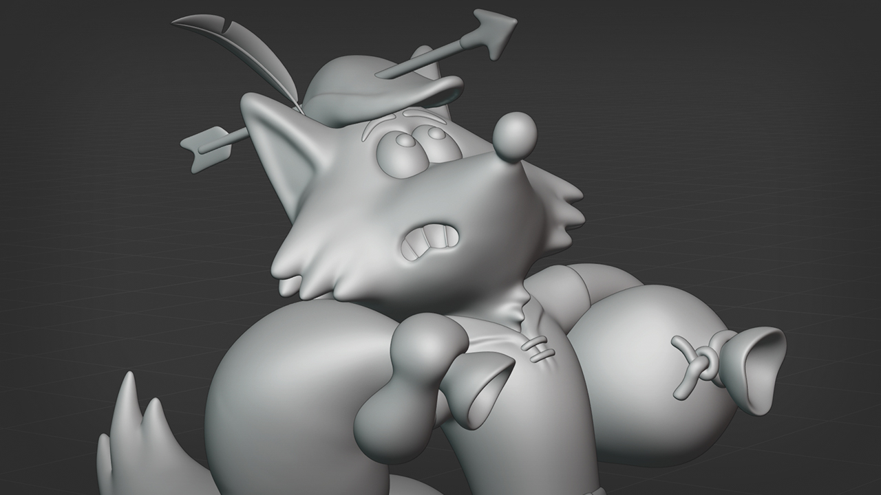

Let’s move on to the last sculpting stage: adding the final details. First stop: adding a subtle rim along the outline of the ears. I’m still in Dyntopo mode, because it allows for total sculpting freedom without having to keep track of polygon stretching and having to frequently remesh, resulting in a subtle overall smoothing that I don’t want. So, Dyntopo is my friend, although it’s running a different, slower engine inside Sculpt Mode, but that’s okay, because we’re not working on a scene with millions of polygons.
Added a subtle rim to the ear outlines, after blending the head and snout, and the shirt and its sleeves.

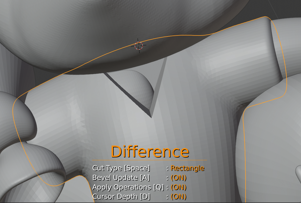

Then it’s time for the other details, such as the edge of the hat, the folds in his outfit, fur tufts on the tail, and some cut-outs, such as the V-shape in his shirt. For this I go to Object Mode, place the 3D cursor on the depth I like the cut-out to have, then press Control + Shift + X to activate the Carver add-on that comes with Blender. Carver has a number of on-screen options, including pressing Spacebar to change the Cut Type from Rectangle to Line, and pressing D to make the cut stop at the cursor depth.
A V-shape cut out of the shirt. A piece of an arm appeared, but that’s no problem, because we’re going to create a neck in the V-shape.
After making the cut, I return to Sculpt Mode and perform a Voxel Remesh (Control + R, don’t forget to set the Voxel Size to a sufficient detail first), so I can smooth the harsh edge of the V-shape a bit.

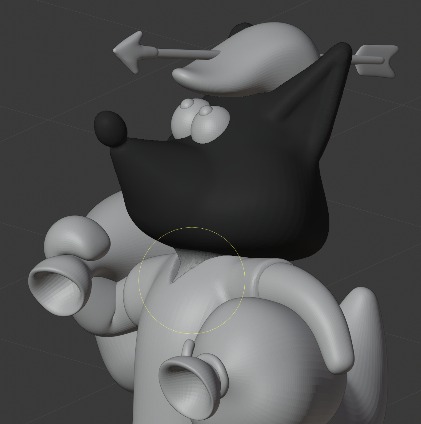

Then, mask a circular area underneath the head, activate Dyntopo (if necessary) and use the Snakehook brush to pull out a neck.
Pulling out a neck using the Snakehook brush in Dyntopo mode. As you can see, there’s no hidden hand behind the money bag. 🙂
Use the Snakehook brush to pull out some fur tufts from the neck. Then select the shirt, mask an area to pull out as the collar of the shirt, after inverting the mask and activating the Move tool.

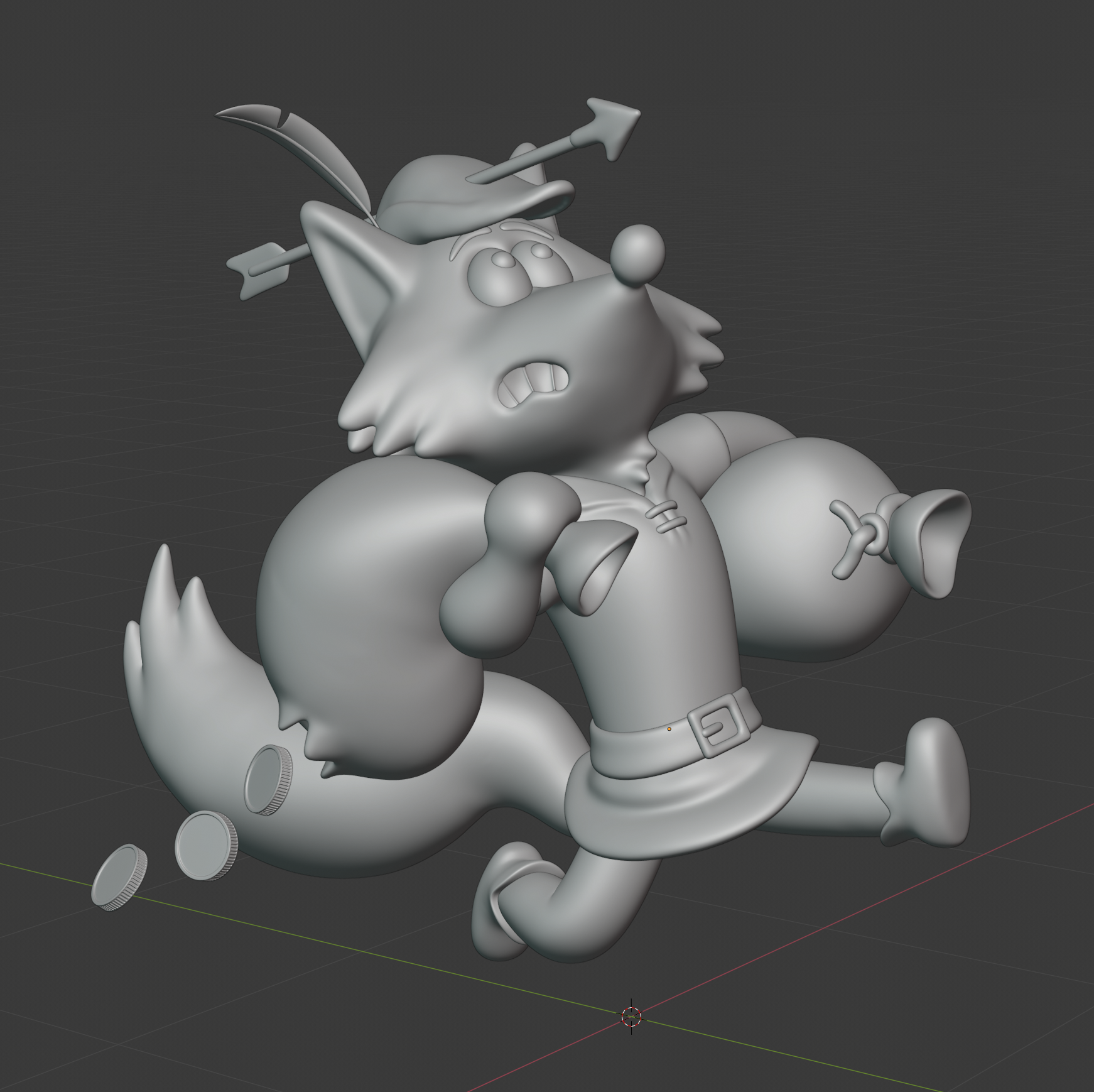

The final sculpture!
This wraps up the modeling of a kawaii interpretation of Disney’s Robin Hood fox character. I hope you learned some useful Blender techniques.
