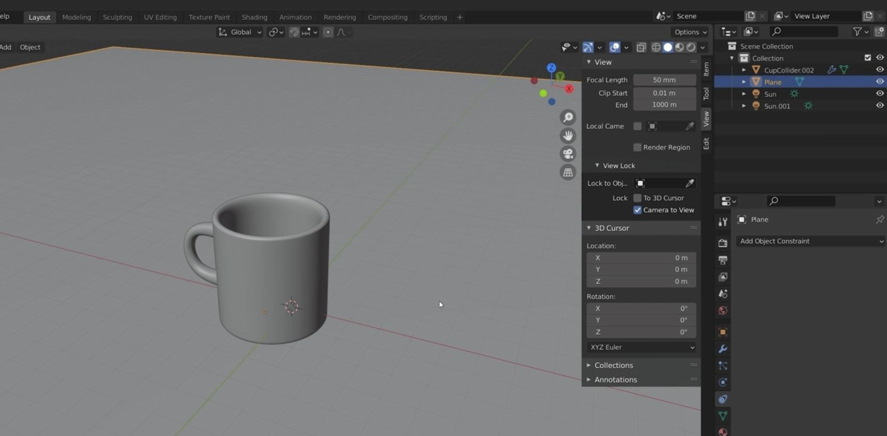

To fill up our cup, let’s begin by going through these components one by one. I’m starting off
with a scene containing just a basic cup and a ground plane.

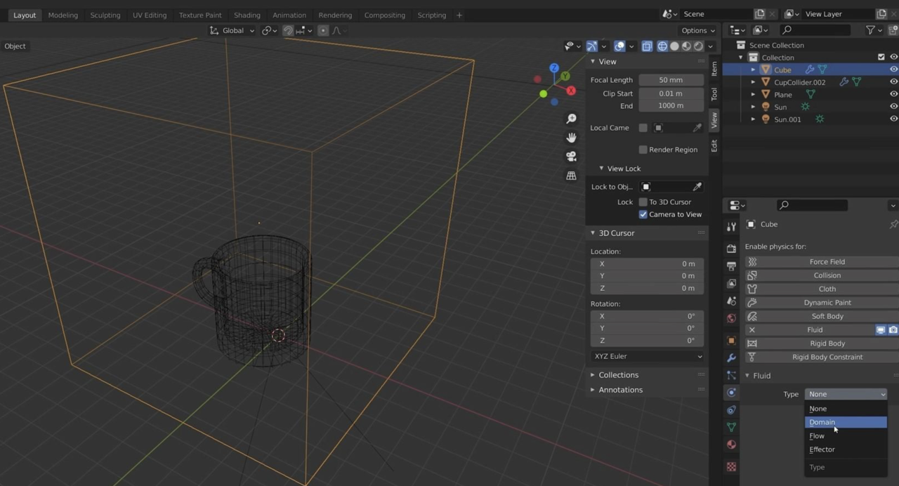

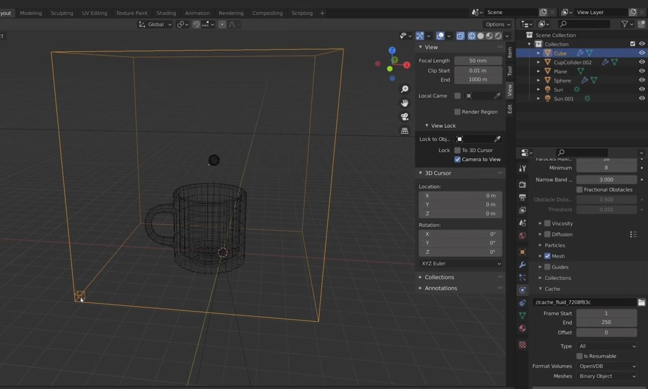

Create a domain. The first thing we want to do is create a domain. To do this, we can
create a regular old cube and resize so it encompasses the whole cup we’ll be filling. Then
in the physics tab for the cube, we can enable the fluid physics and pick the “Domain”
fluid type.

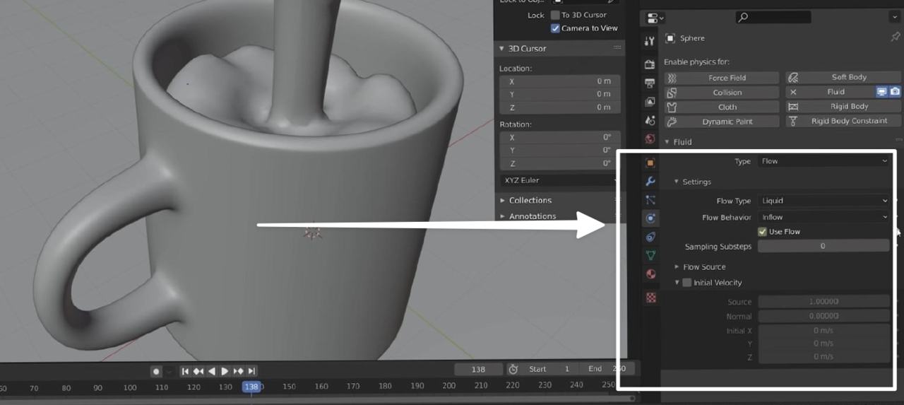

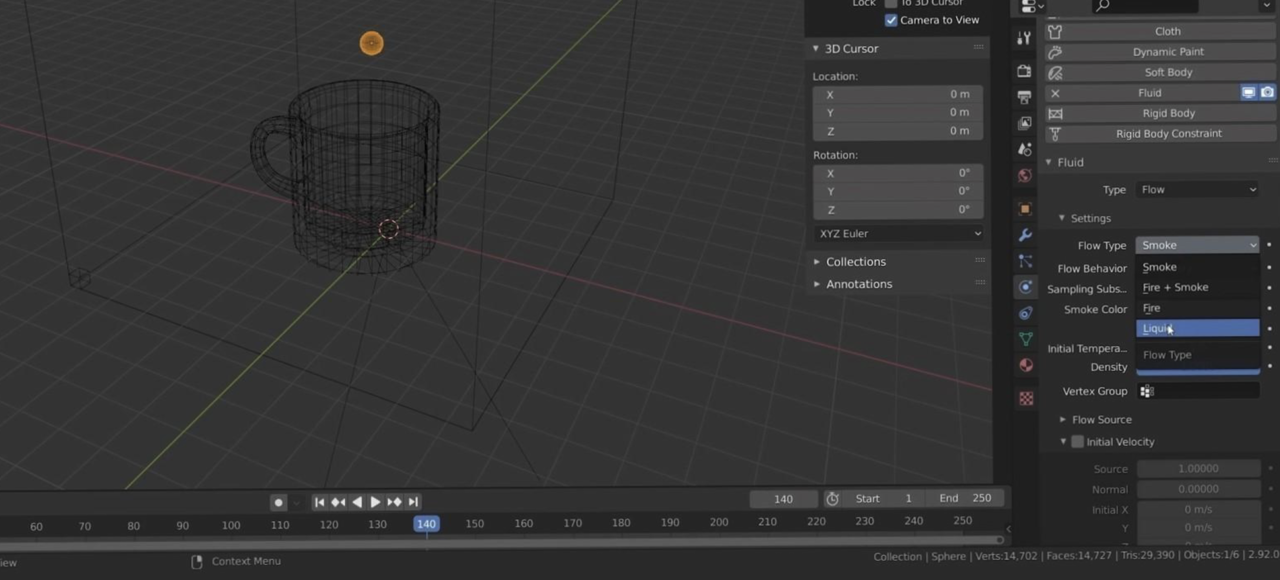

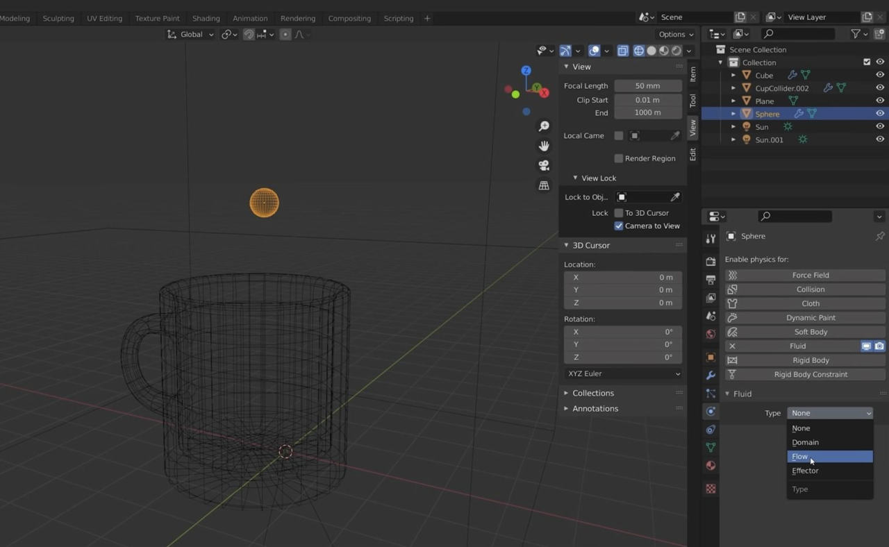

Create an inflow. Our next step is to create an inflow. To do this, let’s create a simple
UV sphere and place it where we want our fluid to originate from. Then, just like with the
domain, we can enable fluid physics in the physics tab for the sphere. This time, we’ll
pick the “Flow” fluid type.

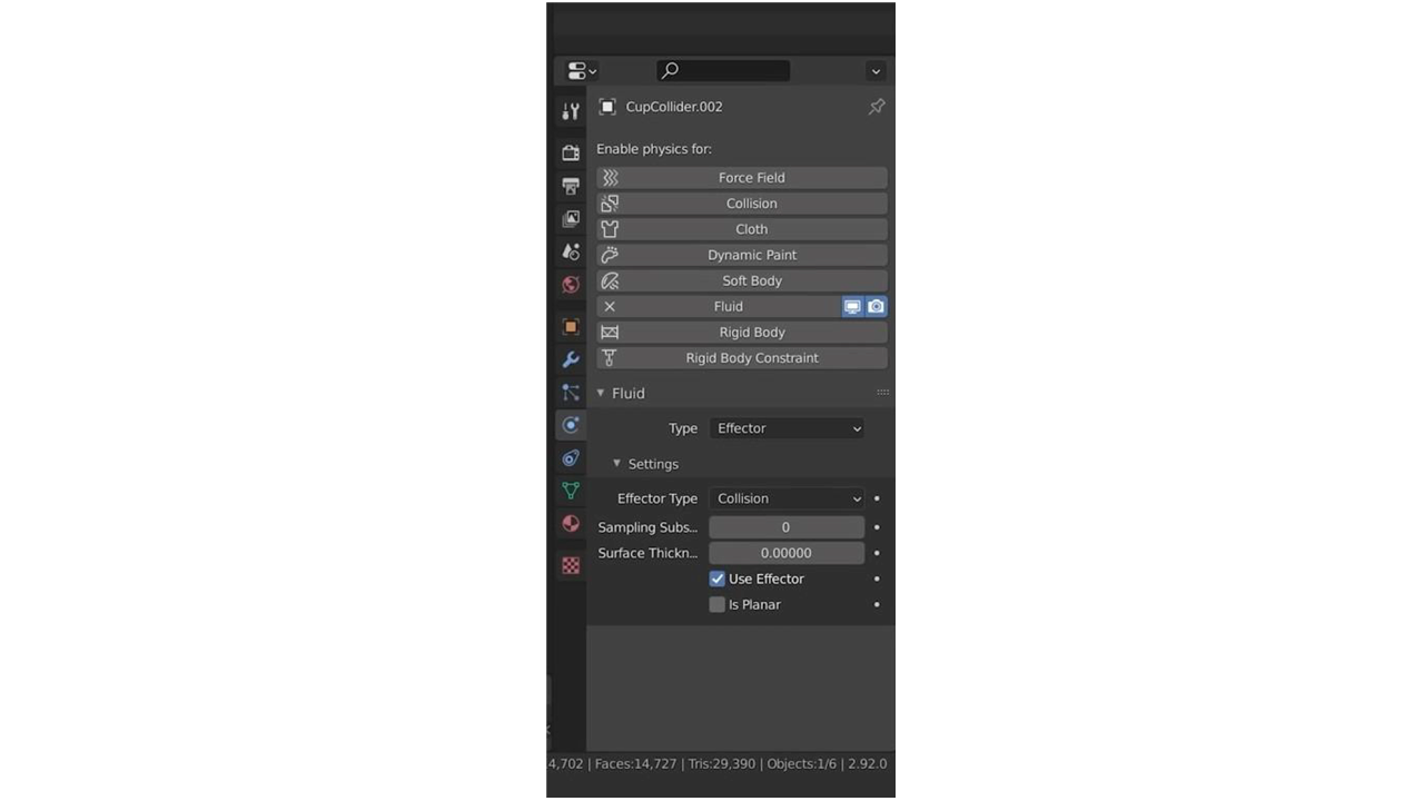

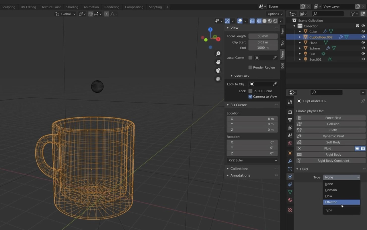

Create a collider. Our last step is turning our cup into a collider so our fluid interacts like a real coffee cup. To do this, we’ll enable the fluid physics in the physics
tab for the cup, the same as before. The fluid type we’ll use this time is “Effector.” The
effector type should be set to “Collision” and the “Use Effector” option should be
checked by default.
Important note: since our coffee cup has some thickness and is a closed mesh, that’s all
we need to do here. However, if you had an unclosed mesh (e.g. a plane) that you wanted
your fluid to interact with as a collider, you could check the “Is Planar” option.

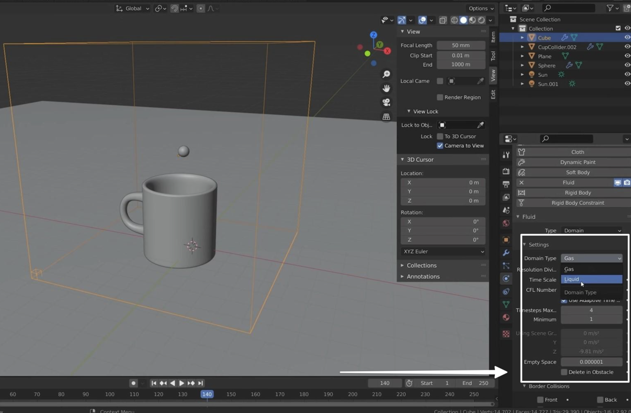

Now that we have our objects created, we have some settings we need to change.

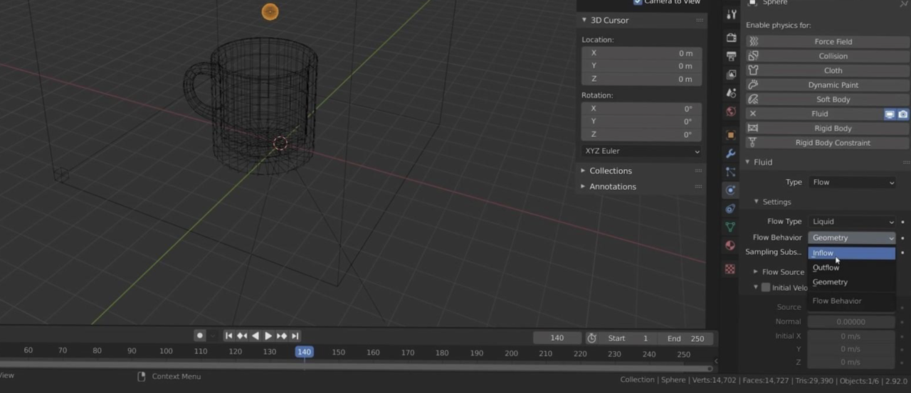

1. Switch the domain’s domain type to “Liquid.”
2. Switch the inflow’s flow type to “Liquid.”
3. Switch the inflow’s flow behavior to “Inflow.”
Note: There are three settings for flow behavior: “Inflow,” “Outflow,” and “Geometry.”
The difference between Inflow and Geometry is that the Inflow option will act like a
faucet, pouring out a steady and continuous stream of liquid until stopped, whereas the
Geometry option will take the Flow object—in our case, the UV sphere—and treat it as a
finite amount of liquid with the same geometry. That is, if we wanted a ball of liquid to
just drop into our scene and splash on the floor and disappear, the Geometry option
would be perfect. For our scene, we’ll stick with Inflow.

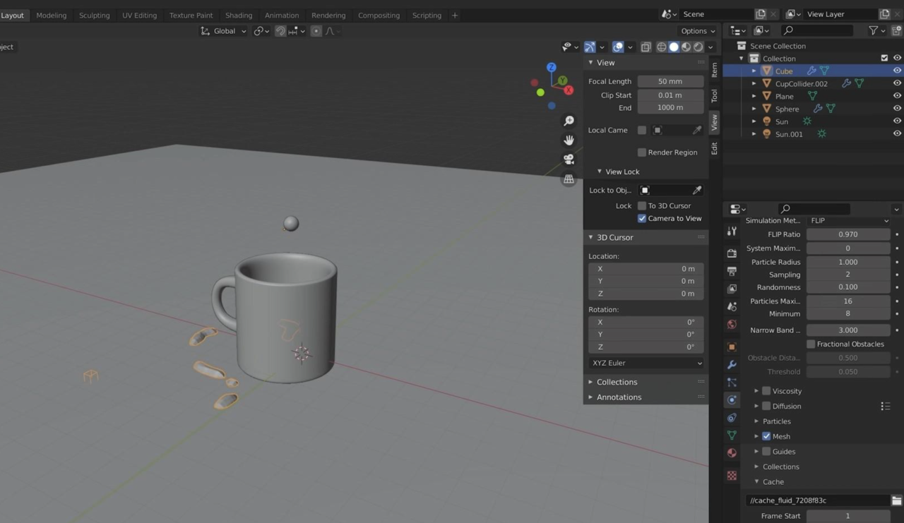

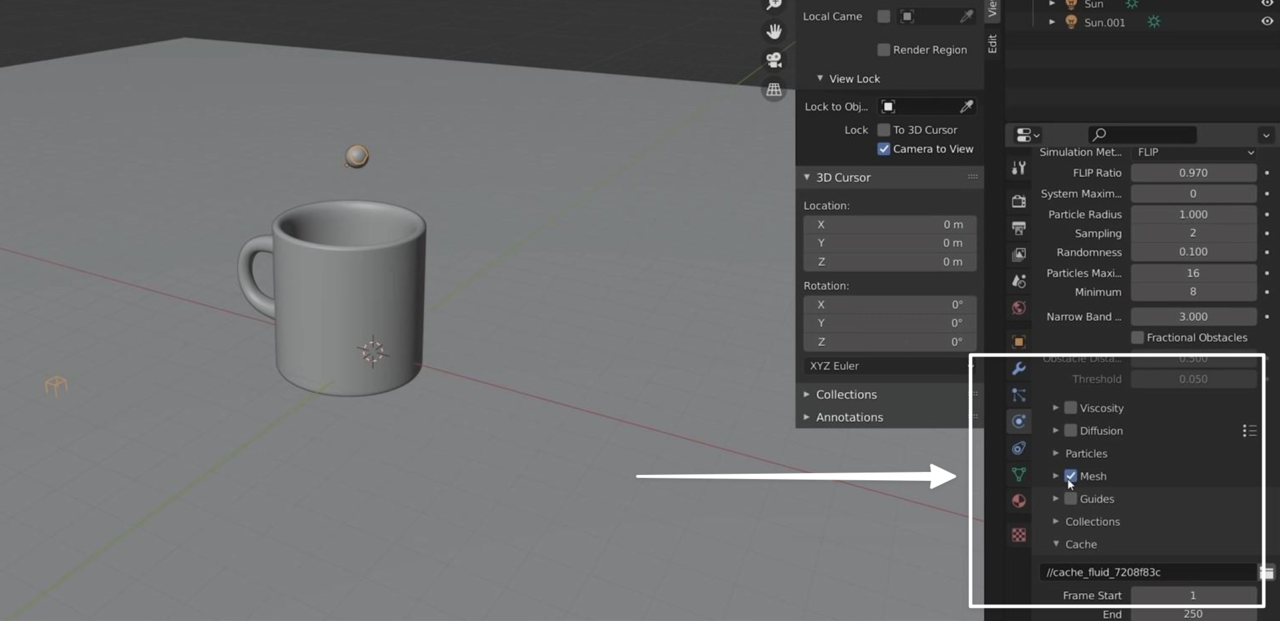

Enable the domain’s “Mesh” option. This will tell Blender to take our simulation and
turn it into mesh for us. At this point, the cube should disappear, because the cube has
become the fluid simulation itself. You can now hit Play on your timeline and see the
fluid start to generate!

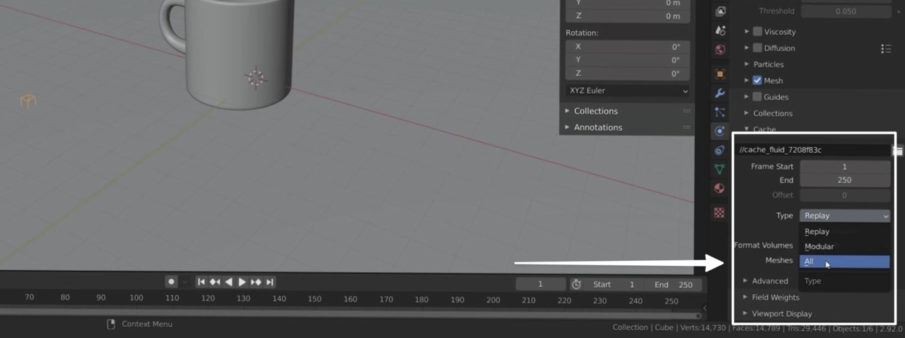

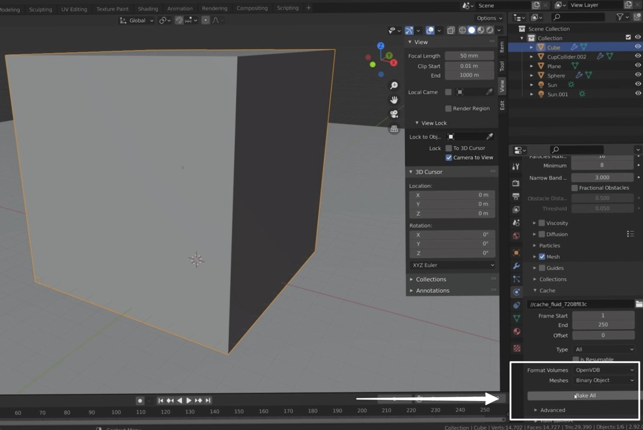

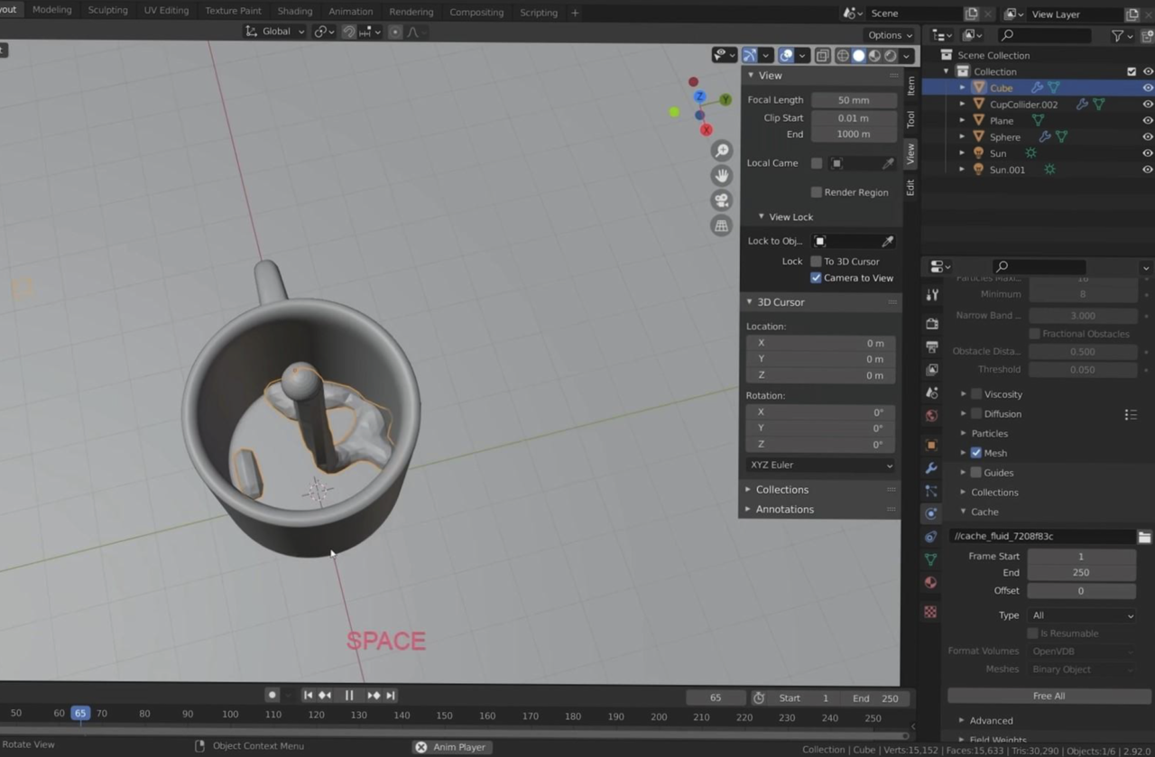

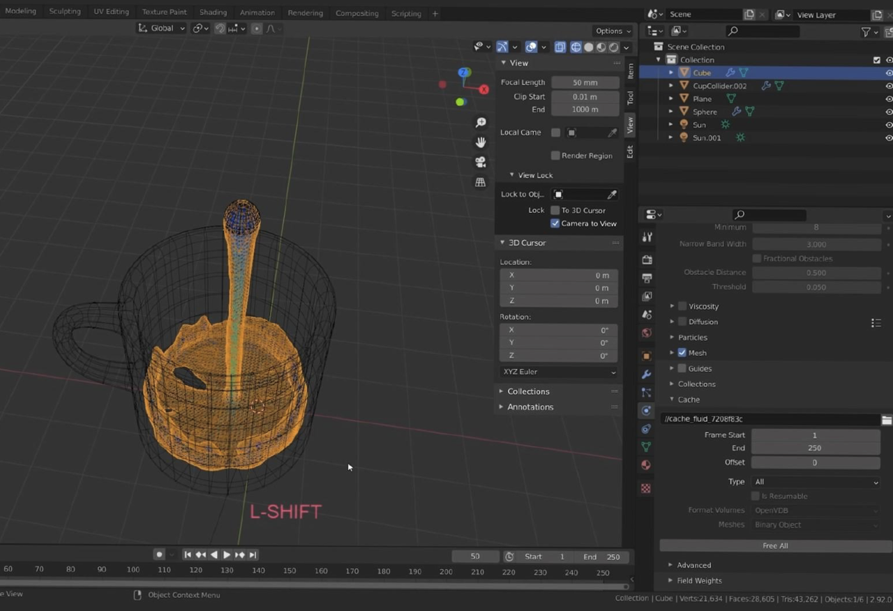

It’s important to note that running the simulation directly in your timeline is very unstable
and will generate weird results like this.
To get more reliable, consistent results that let you see what’s really going on, you’ll need to use
the cache, which you can find right under “Mesh.” Let’s change the cache type to “All” so that
our fluid cache gets saved as a file on our computer; this will make sure our simulation is stable.
With that done, we can hit “Bake All” to bake our simulation.

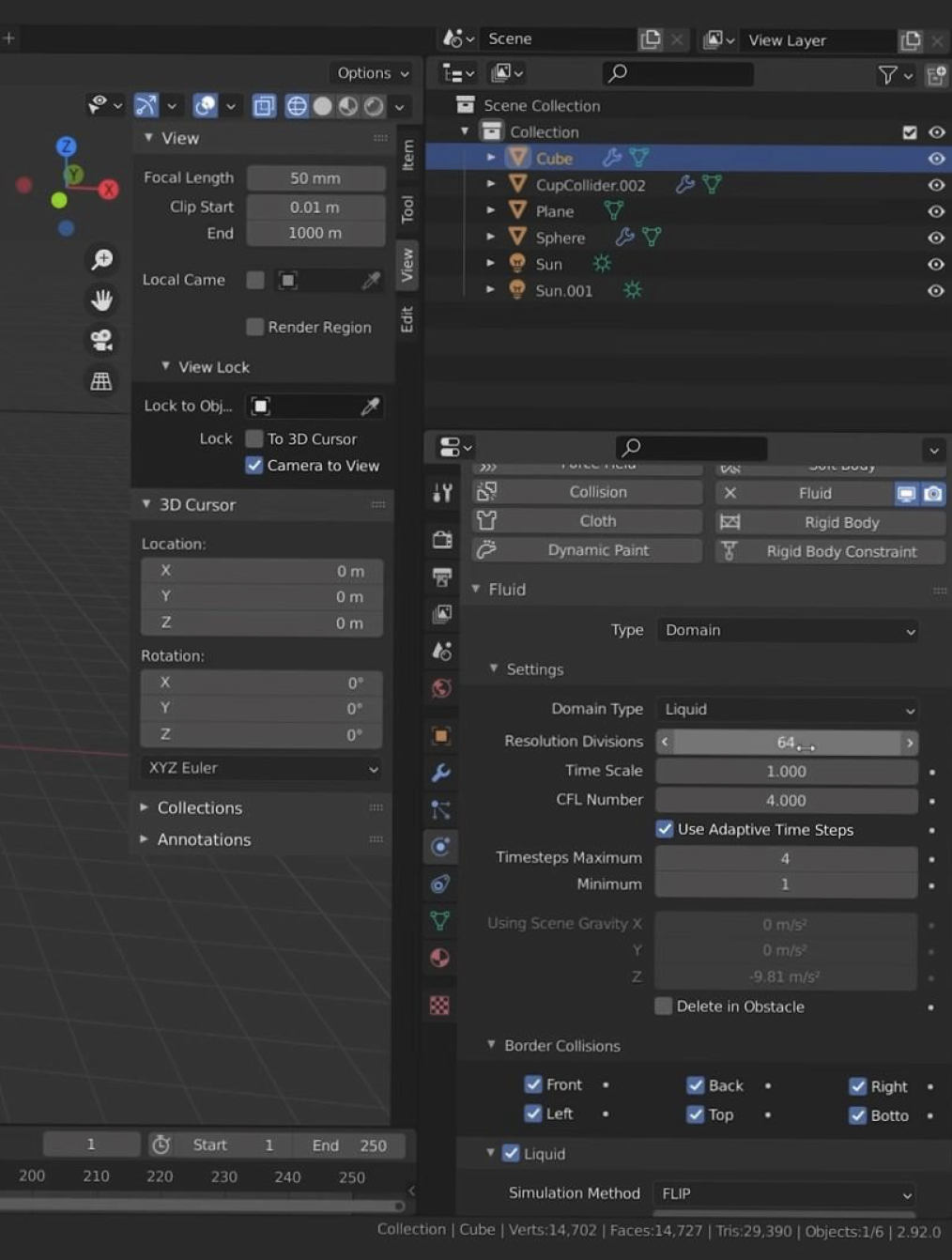

The simulation looks like it’s working, but it’s not the greatest. Let’s hit “Free All” so we can
troubleshoot. The problem here is that the resolution of our fluid sim is pretty low. You can see
the resolution of the fluid simulation from the box in the corner of your domain while in wireframe
mode.
This small box represents the size of one “voxel,” which is basically the particle size that the
fluid simulation works with. Because of that, the higher the resolution, the more voxels our
domain is divided into, and the finer the detail on our simulation, but the longer the simulation
takes to run. Conversely, the lower the resolution, the lower the number of voxels, and the
chunkier and grosser our simulation will look, but the faster it runs.
By default, the resolution divisions (which controls the number of voxels our domain is divided
into) is set to 32. Let’s go ahead and set it to 64 so that our fluid simulations are closer to the final
product.
Now let’s bake again and take another look.
Hopefully, you agree that things are looking a lot better now. Let’s turn the resolution divisions
back down to 40 for the time being so our simulation runs quickly while we’re changing settings.

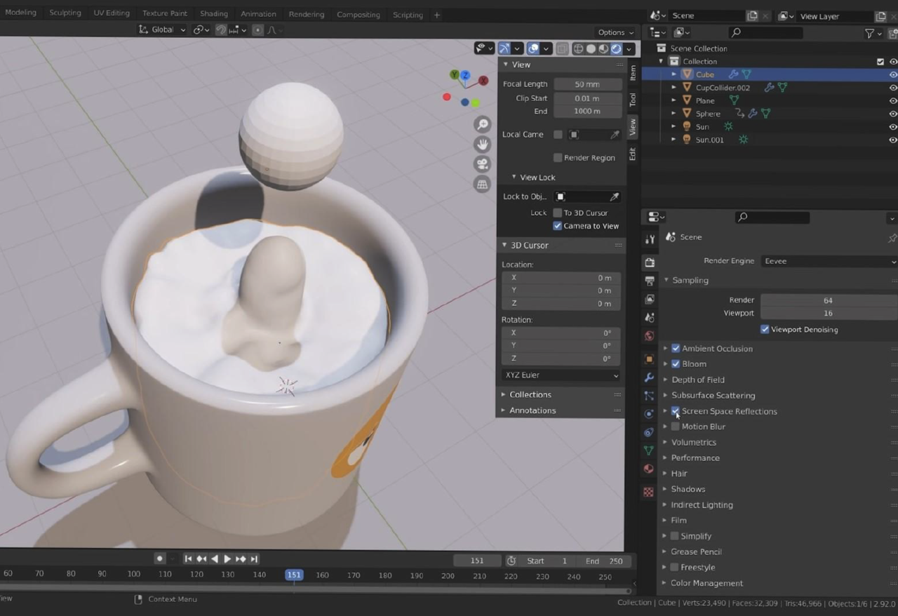

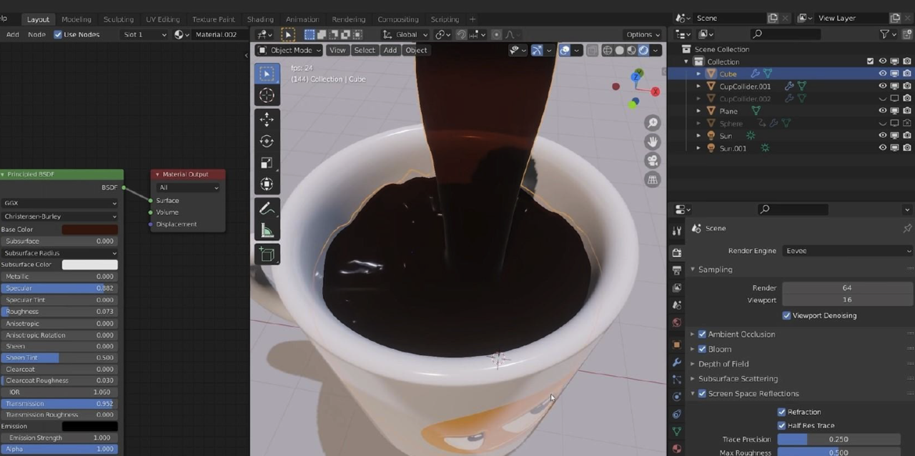

That should get our coffee to stop pouring exactly when we want it to. Now it’s time to see if we
can texture this fluid to actually make it look like coffee. We’ll go into rendered view, make sure
our render engine is set to “Eevee,” and turn on “Ambient Occlusion,” “Bloom,” and “Screen
Space Reflections.”
From here, we can open up our Shader Editor and change some parameters to get closer to the
look of coffee. I recommend watching the video version of this tutorial for a deep dive into exactly
what I’ve set each value to and how, but the parameters I’ve changed are base color,
transmission, IOR, specular, and roughness.
And here’s the final result!
