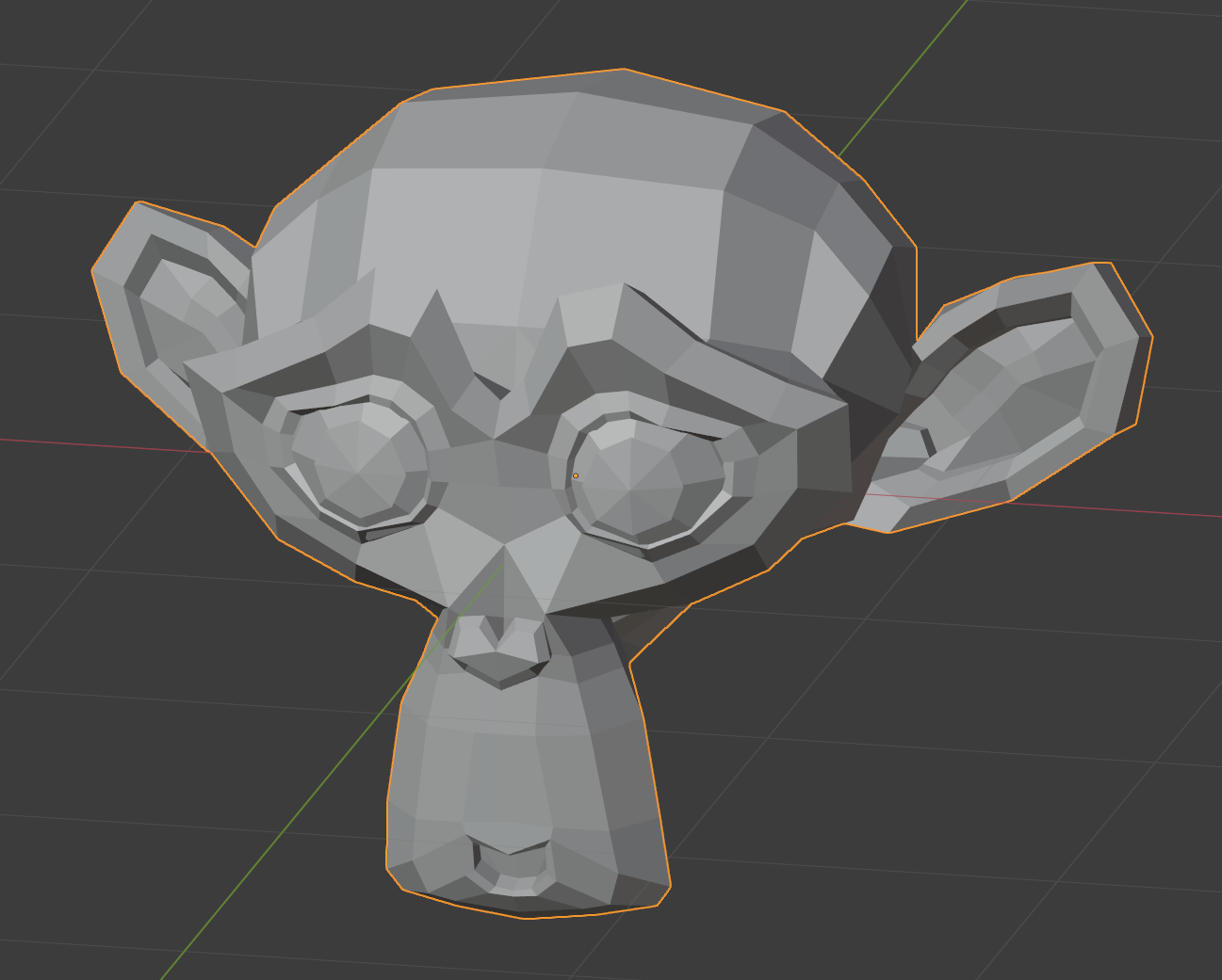

Let’s delete all default scene elements, and add a Suzanne (Monkey) head to Blender.
The default monkey head has a very coarse amount of polygons.

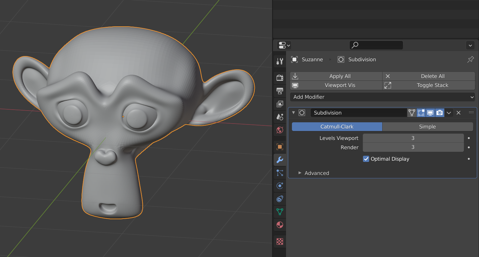

While the head is selected, press Control + 3 to add a Subdivision modifier with three subdivision iterations.
This will smooth out Suzanne’s surface, so we’ve got proper polygon detail for 3D printing.
Susanne with subdivisions
Hover your pointer over the Subdivision modifier and press Control + A to apply the subdivisions to the monkey head.

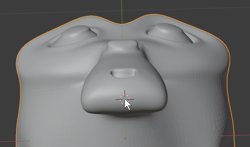

Take Suzanne, for example. Place her on a table with that distinct tilt to her head, and she might just decide to take a roll. So, let’s give her a bit of backup, ensuring she stays just as poised as she does in our 3D view.

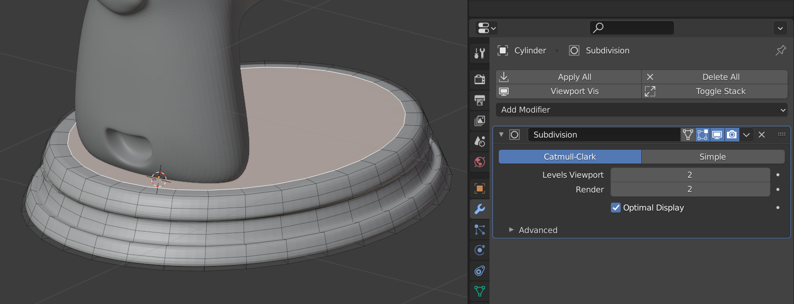

Want to get started? Swing your view around to get a good look at Suzanne’s chin. Then, with a quick Shift + right-click on her chin’s base, you’ll set Blender’s 3D cursor right where we need it.
3D cursor under suzanne.
Press Shift + A ➔ Mesh ➔ Cylinder to add a cylinder to the 3D cursor position. Enter Edit Mode and manipulate the cylinder vertices as you wish, moving vertices, adding edge loops, and extruding faces.
I’ve kept it simple and minimalistic. Added two subdivisions with the subdivision modifier, extruded a middle part, and added some edge loops, also inside the caps, to make the features a bit sharper.

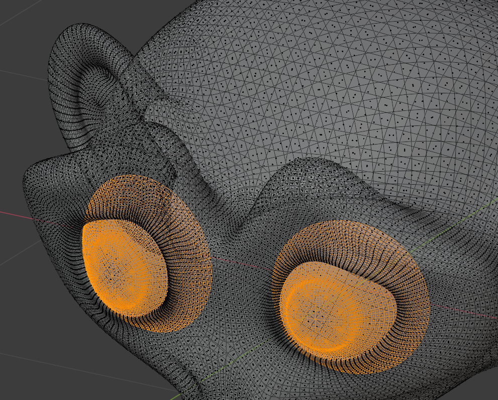

In this case, the monkey mesh exists of three separate parts, featuring open edges: the head and two eyes.

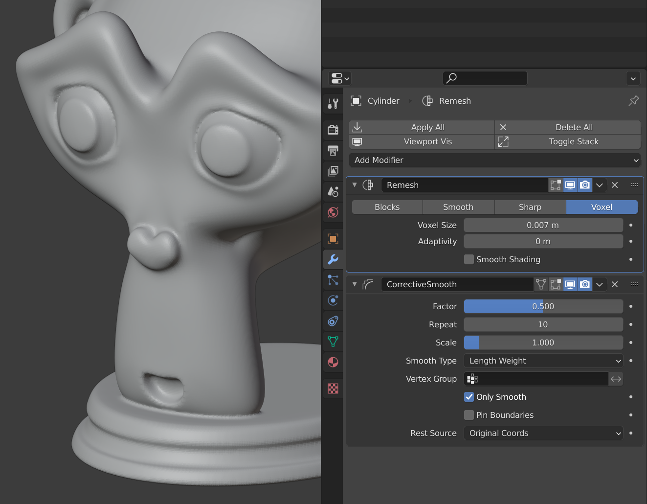

  2. Add a Remesh modifier, make sure Voxel mode is active and set the Voxel Size to a detail level you like. Using the default Suzanne dimensions, I set the Voxel Size to 0.007.
  3. To soften the artifacts caused by the voxel remeshing, add a Smooth Corrective modifier, check Only Smooth, set the Smooth Type to Length Weight and adjust the Repeat value to your liking. I’ve set the Repeat value to 10.
  4. Hover your pointer over the Remesh modifier and press Control + A to apply it, then do the same with the remaining CorrectiveSmooth modifier.

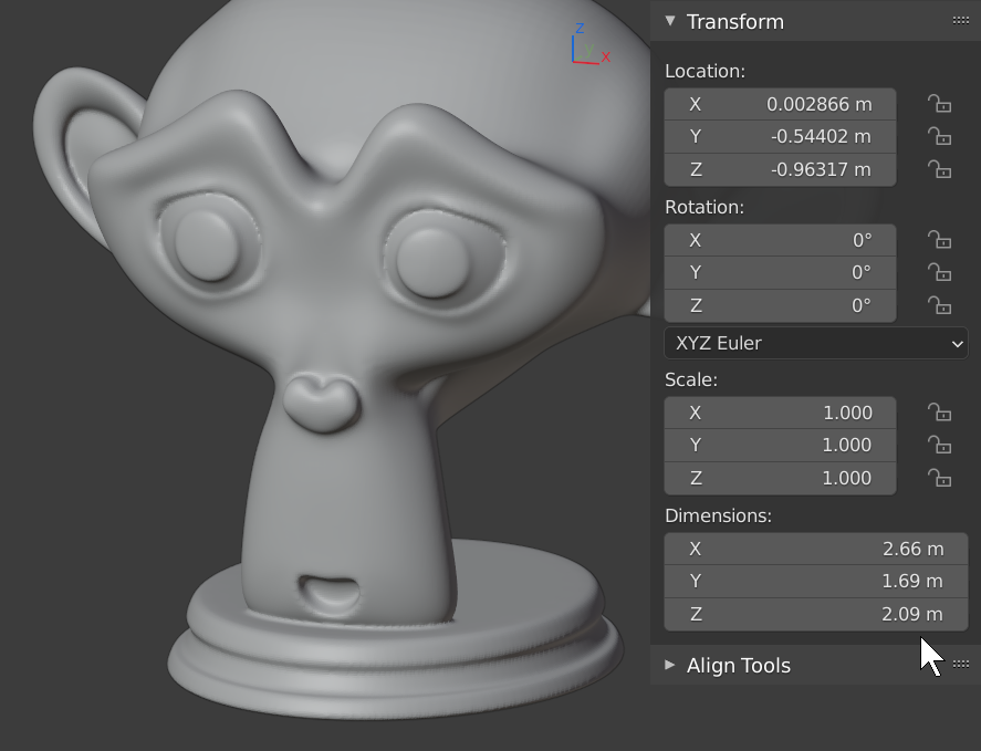

You can check your object’s scale in the N-key panel ➔ Transform ➔ Dimensions.
Make sure Blender is set to your local unit system
As a European resident, I’m working with metric units, so for the scope of this article, it would be convenient if US readers would change their Blender units to metric as well, if necessary.

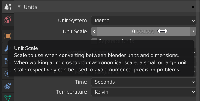

This can be realized in the Scene Properties tab ➔ Unit System ➔ Metric.
After setting the Unit System to Metric, one more important setting needs to be changed: set the Unit Scale to 0.001.
This will synchronize Blender units with a scale of millimeters, because Blender’s 1.0 Unit Scale equals 1 meter. Most 3D file formats used for printing use millimeters for the dimension values.

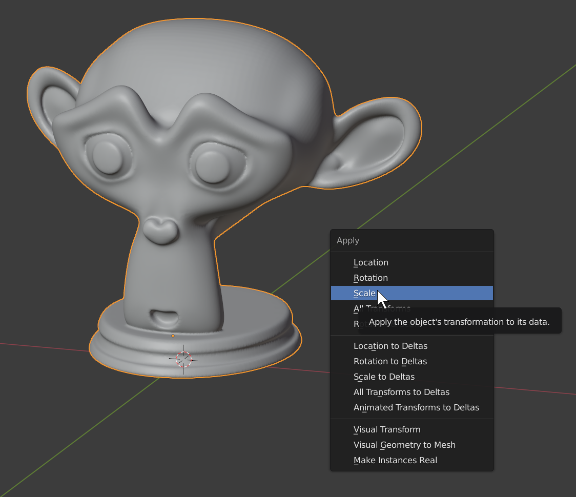

  5. This last step is very important: press Control + A ➔ Apply ➔ Scale to hardwire the new scale into the mesh. The Scale values in the N-panel (not the Dimensions) should now indicate 1.0.

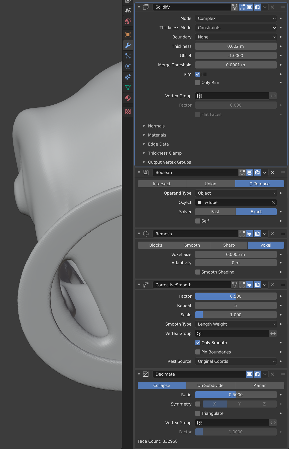

Next, select the 3D print model and add the following modifiers and settings:
  1. Solidify modifier, with Mode set to Complex, and Thickness set to your desired wall thickness. For example, a value of 0.002 equals 2 millimeters in metric units.
  2. Boolean modifier, set to Difference, with the vent object set as the Boolean Object, to form the hole at the bottom.
  3. Remesh modifier, in Voxel mode, with the Voxel Size set low enough to maintain the small object’s details.
  4. Smooth Corrective modifier, set to Only Smooth, the Smooth Type set to Length Weight and the Repeat value adjusted to your liking. I’ve set the Repeat value to 5.
  5. Optionally, add a Decimate modifier, in Collapse mode, and set the Ratio to something like 0.5. Usually, this doesn’t change the object visibly, but halves the number of polygons.

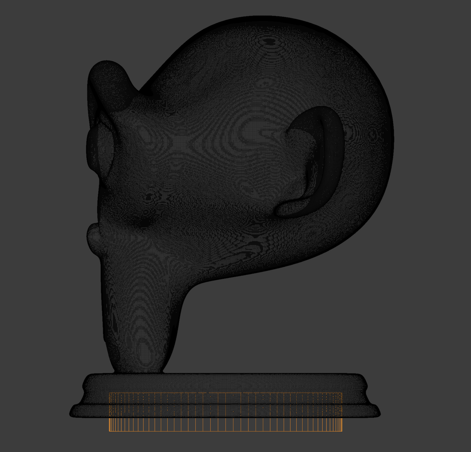

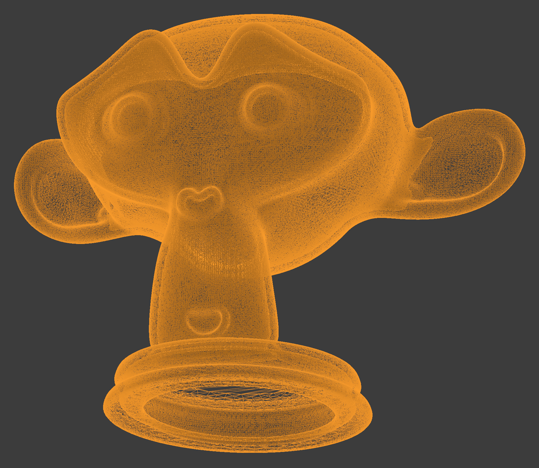

Below is a wireframe view of the final hollow mesh, including some decimation at the end. As you can see, the modifier stack automatically stops hollowing where parts would become too thin, such as the ears.
