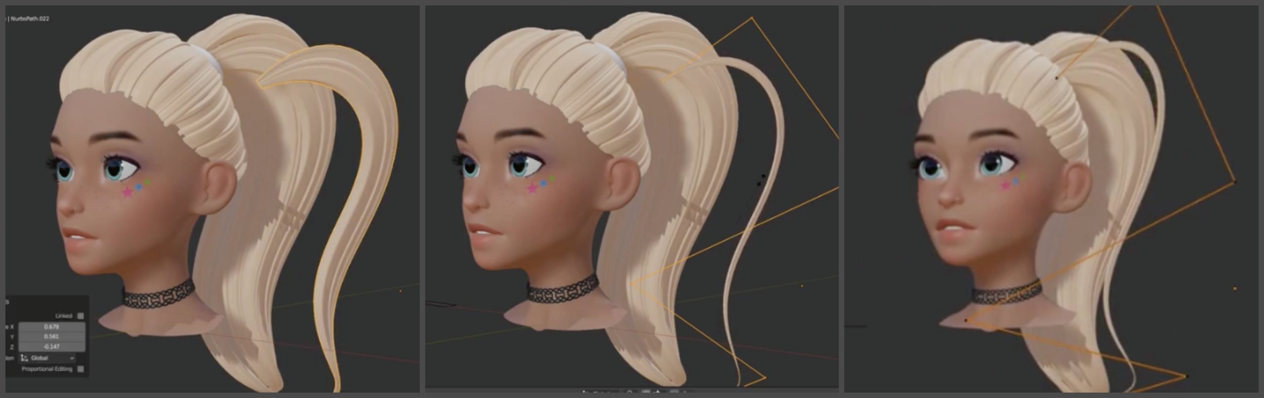

As you look at hairstyles, you’ll notice 3 primary forms: big, medium and small.
- Big shapes are the overall forms that make up your silhouette. In the above example, it’s the top of the head and the ponytail.
- Medium shapes are the clumps and main strands that make up the big shapes.
- Small shapes are the finer strands that tend to live within – or break away from – the medium shapes.

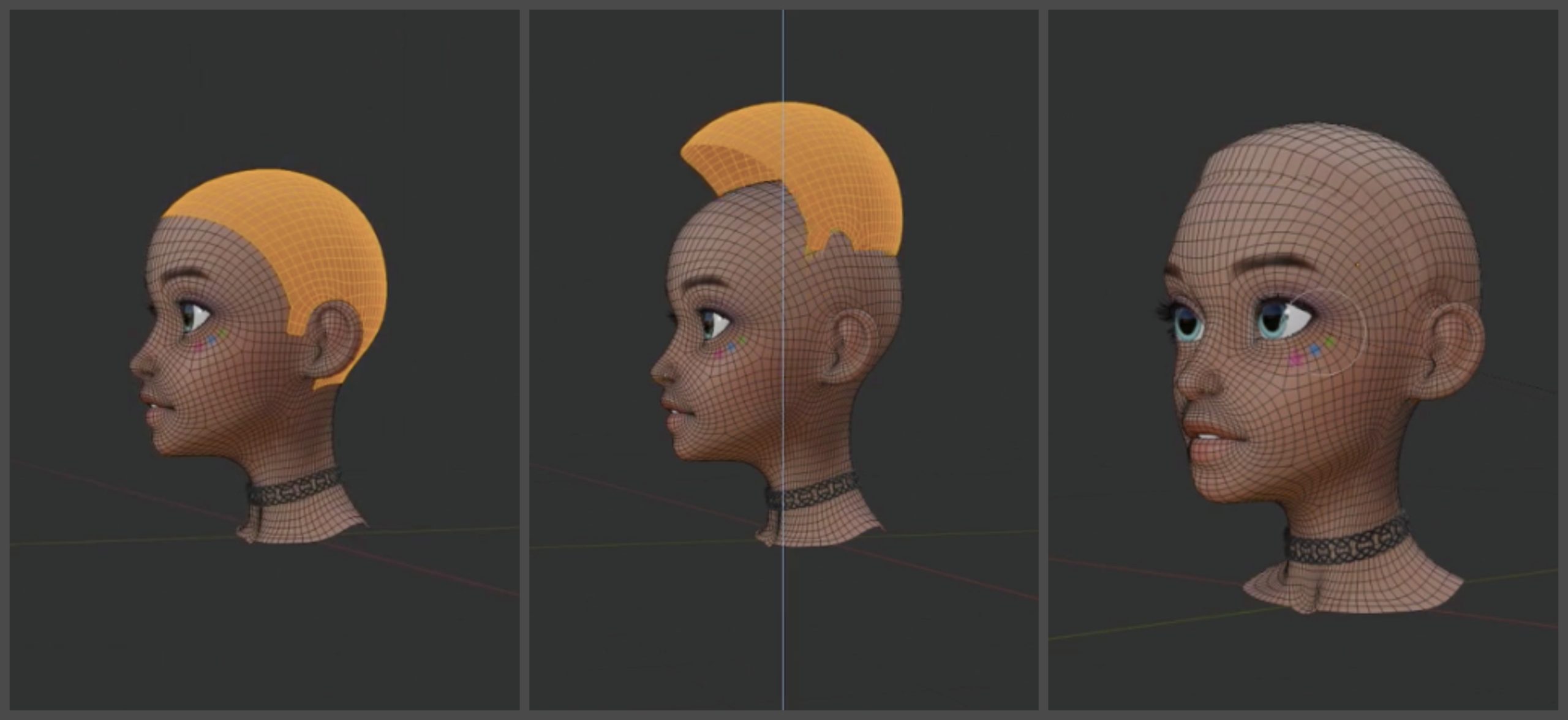

It’s best to start with a ponytail hairstyle, which is simpler because you can use the character’s head to create the first shape.
First, highlight the faces on the head to indicate the hair outline. Next, duplicate and separate the faces from the mesh.
Now that the scalp outline is its own object, we’ll scale it up a little, then, in edit mode, we scale it onto the head.
You’ll end with a very basic shape to work with – the body of the hair that your ponytail will sit on.
Next, use Sculpting Tools to Establish the Directionality of the Hair
You might like using Clay Strips with Dynamic Topology and Symmetry turned on.
Note: with real-life like hair, you should try to avoid unrealistic symmetry. But at this stage, we are not looking for perfection yet. Instead, we are roughing out the basic idea which we will cover up later.

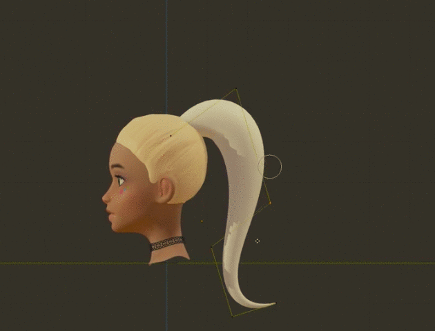

Step 3: Block out the primary shape of the ponytail

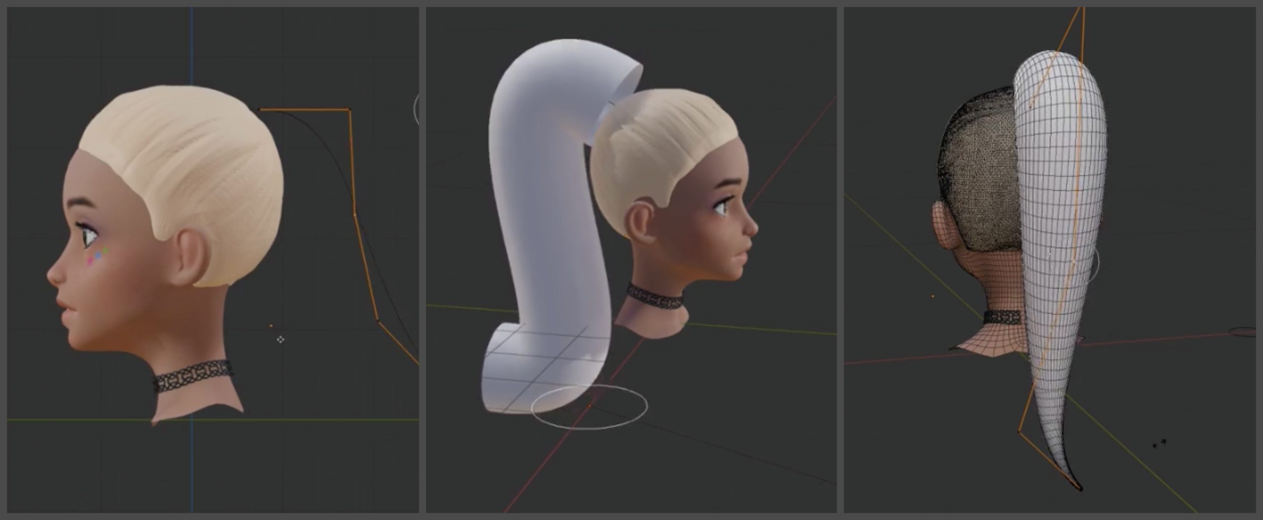

First, we’ll place a curve at a position where (roughly) our ponytail is going to sit. Again, no need to be absolutely accurate at this point yet.
Next, add in a Bezier Circle and set it to be the bevel object of the curve. This is found under Geometry in the Curve Properties panel.
We can now start to refine the shape of our ponytail by using handy hotkeys:
- Alt + S lets you scale points on the curve of the ponytail, to adjust its thickness
- Ctrl + T lets you twist points on the curve – at this point, it’s not doing much yet, but will be really useful later for the medium and small shapes
Need more points to control your hair?
Select two of them, Right-Click and hit Subdivide.
Have you got too many points making it difficult to control?
Just dissolve them with the hotkey Ctrl + X.
Pro tip: To wrap up this step, make sure the final big shape of your hair looks good from all angles, including from above and below.

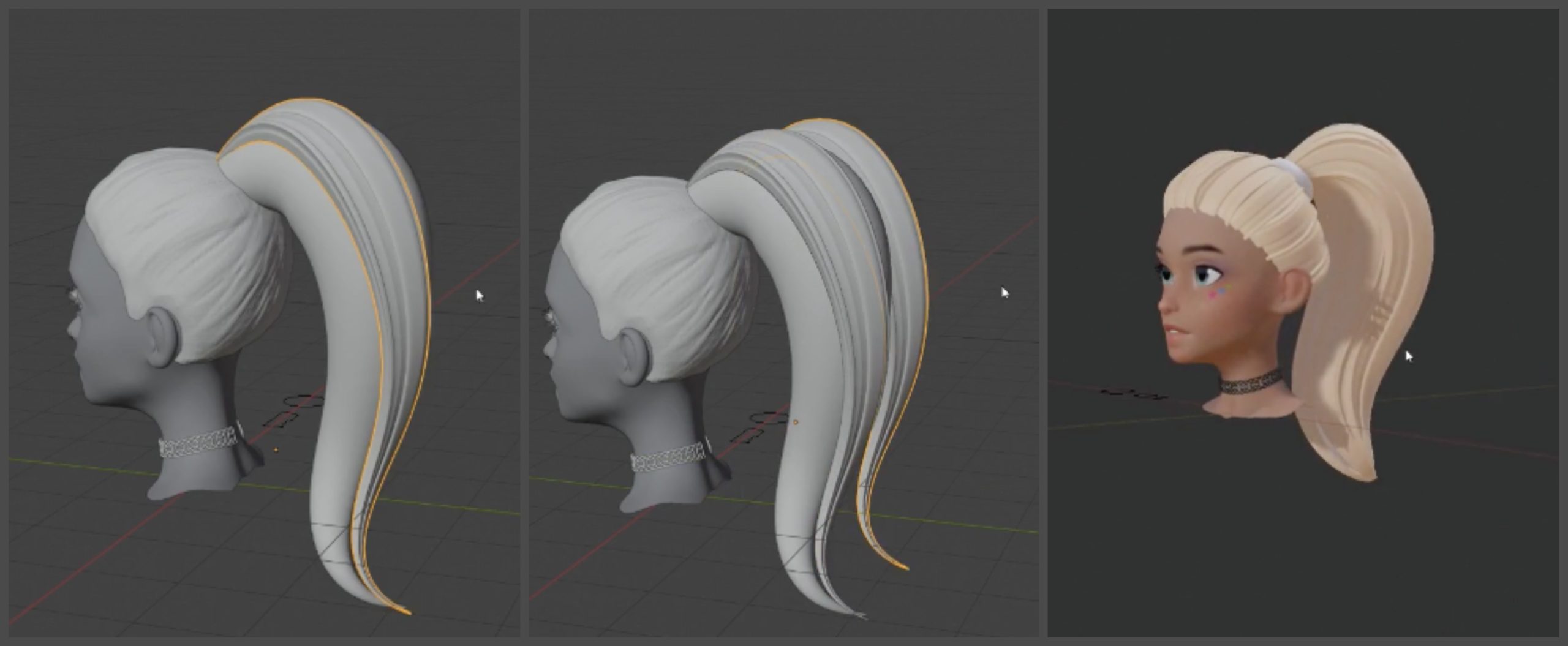

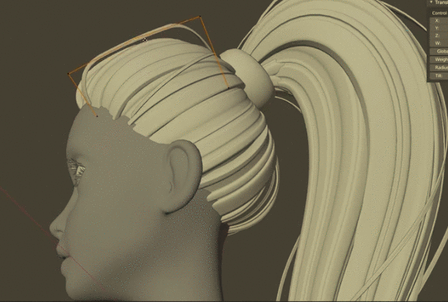

Step 4: Block out the Medium Hair Shapes
To get started with the medium shapes, we’ll simply duplicate our ponytail to use it as additional hair strands.
Remember, the ponytail is now controlled by the Bevel object (a circle) so we need to duplicate it as well and assign the new circle as the new Bevel object.
Try making the medium shape a bit wider and flatter. That way, you’ll need fewer strands to cover a wider area.
Pro tip: Create a second 3D view so that you can adjust the shape and adjust the result at the same time.
Once you’re happy with the shape of your secondary hair strand, place it on top of your main ponytail shape.
Next, duplicate it and place this one, too. Keep repeating this process.
To tweak the design and add some variation, you can also change the shape of some of the underlying Bevel objects.
Before you move on to the small hair objects, check again that your model looks good from all angles.

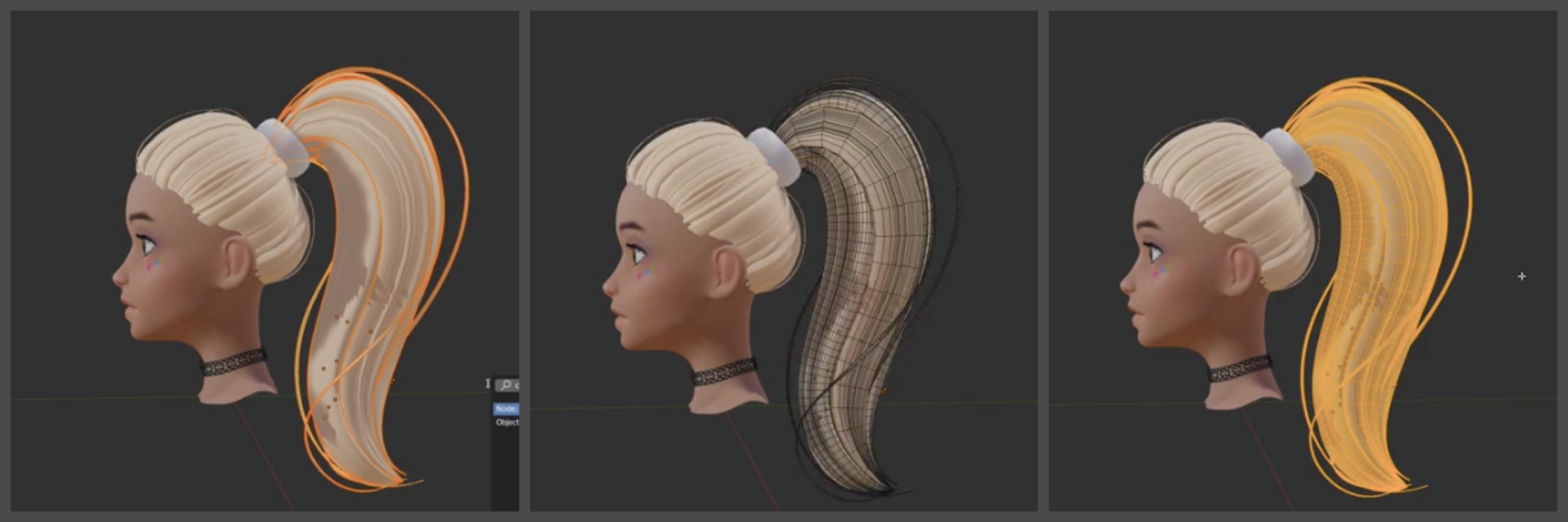

Step 5: Create Small Hair Objects
This is no rocket science: as we did before, we’ll duplicate the medium hair objects to create the small ones.
In real hair, the small strands can be outliers that move in different directions and shapes. Since these strands are so thin, we would expect them to be more affected by wind and less by gravity.
Pro tip: to make the result look more appealing, add in some negative space. This will also give volume to your hairstyle.
This part of the workflow is similar to the previous step, refining the placement of each strand and ensuring it looks good from all sides, including the top and bottom.

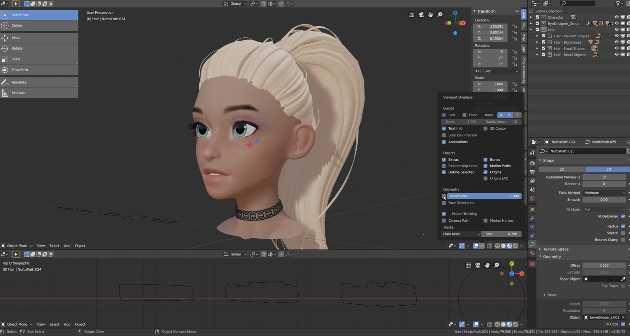

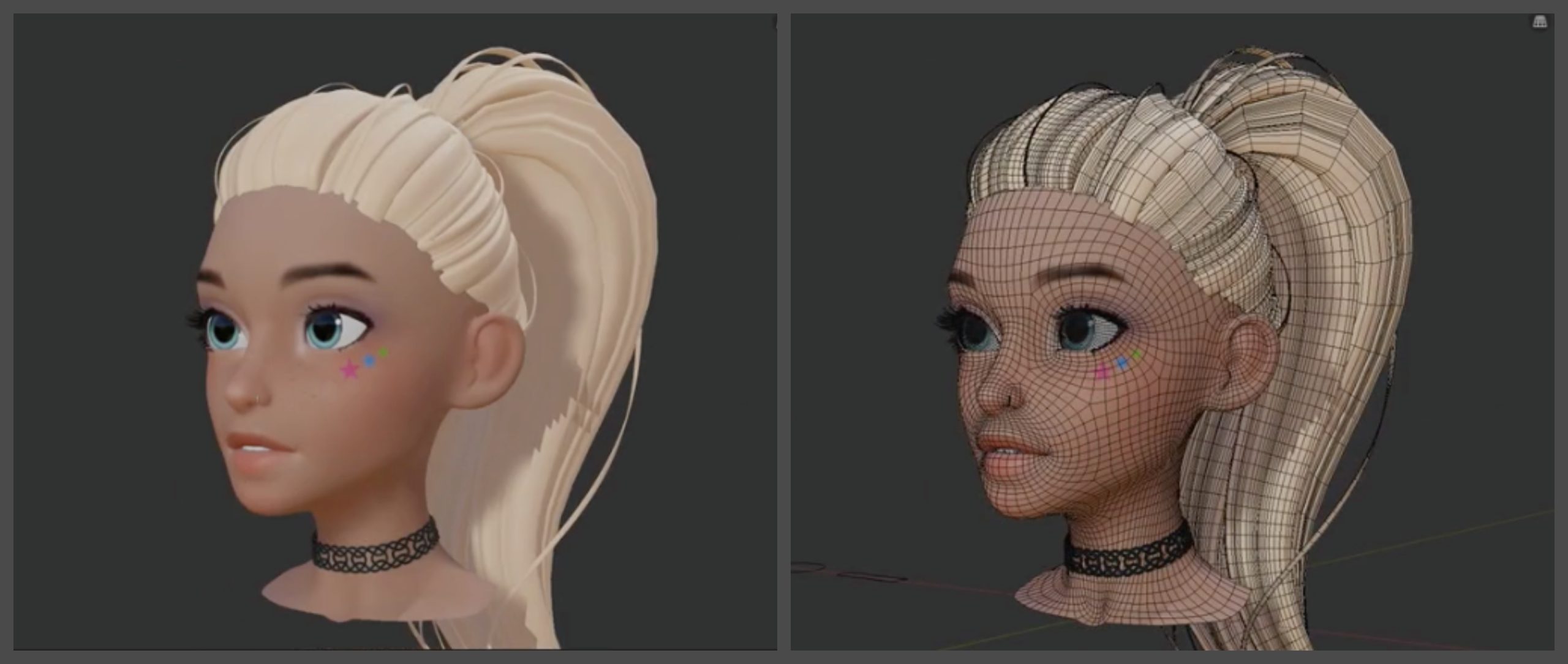

Step 6: Optimize the Polycount of our Hairstyle
You may have noticed that each of our strands has the same polycount – and it can be quite high, making it tough to use for a game engine.
By changing Resolution Preview U in the Curve Properties panel, we can control how many edges wrap around a strand. You can also control the resolution down the length of the hair by selecting its Bevel object and again changing Resolution Preview U.
For very thin hair strands, we don’t need elaborate Bevel objects. So to optimize these, it’s best to give the Bevels a basic pattern like a rectangle.
Step 7: Finalize the Hair Model
Once you have all the shape, join all the strands into one object. You’ll probably want to convert them from curves to polygon meshes.
If you’re doing that, make sure to convert them first, then join them – otherwise, they will all end up using the same Bevel object.
