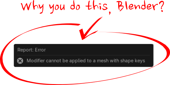

If you’ve encountered the error message “Can’t Apply Modifiers to mesh with shapes” in Blender, there’s a good chance you’ve been frustrated, possibly even close to setting your computer on fire.

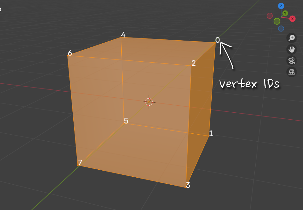

Shape keys actually refer to the differences between one shape and another. That is, the difference between the “basis” or base shape and the actual shape key.
This difference is calculated using vertex IDs, which is how Blender knows where every vertex is and where it will move to when you activate a shape key.
You can learn more about this in detail in the Blender Tutorial SHAPE. This will deepen your skills using shape keys in rigging, giving you the opportunity to practice these skills as you learn.
The issue, however, when it comes to modifiers, is that they can change the number of vertices and/or the vertex IDs on the mesh.
This can interfere with shape keys.
Since many modifiers like Subdivision Surface, Mirror, Bevel, and others alter the mesh structure, Blender cannot automatically handle the shape key calculations alongside these modifiers.
This is the reason behind the “Can’t Apply Modifiers to mesh with shapes” error message. Essentially, Blender cannot figure out how to properly apply the modifier without breaking the shape key data, so it won’t let you do this.

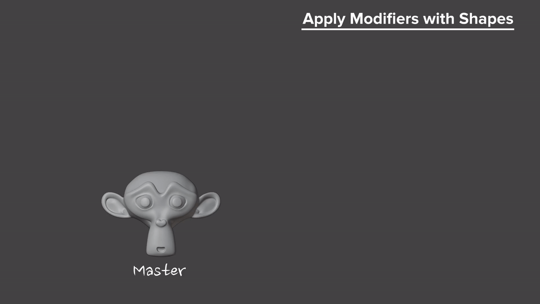

1. Duplicate the Mesh
— Create one copy for each shape key
2. Rename Each Copy
— Activate only 1 Shape Key
— Apply the shape by clicking “Apply”
— Apply the modifier(s) you need to
3. On the Original Mesh (Master Copy)
— Press the “Delete All Shape Keys” button
— Apply the same modifier(s) to the master copy
4. Join the Copies as Shapes
— Repair Any Broken Drivers or Min/Max Settings (If Applicable)
— Delete all the copies

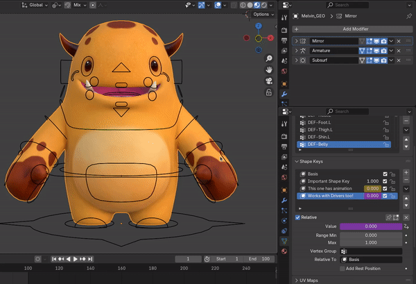

The Smart Way
Now that you understand what’s happening under the hood, wouldn’t it be nice if you could just click a button and choose what modifiers you want to apply? Well you can.
After installing the add-on, you can find in located in the Shape Key Context menu.  (That’s the little triangle in the Shape Key tab).
