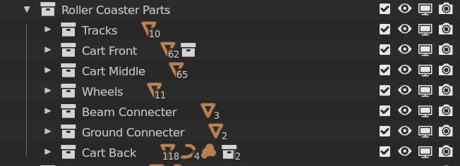

Due its previous large impact on performance, you can no longer search overrides by name in the Hierarchies view of the Outliner’s Library Overrides display mode. The count on objects in a collection has also been improved to be more readable and it can display up to three digits now instead of two.

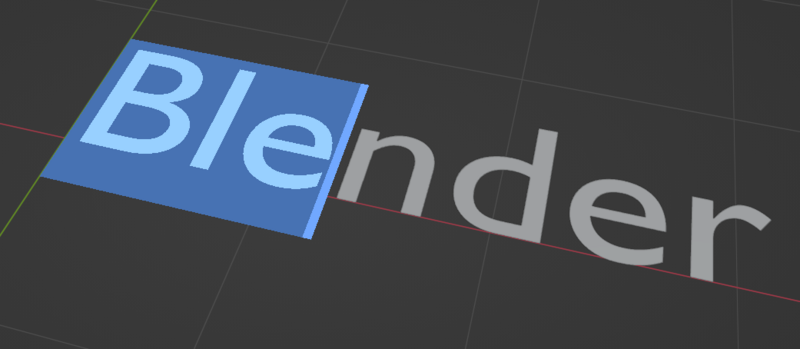

3D text editing is looking a bit nicer now that the cursor is thin, and the selection highlight uses the theme’s text input highlight color.

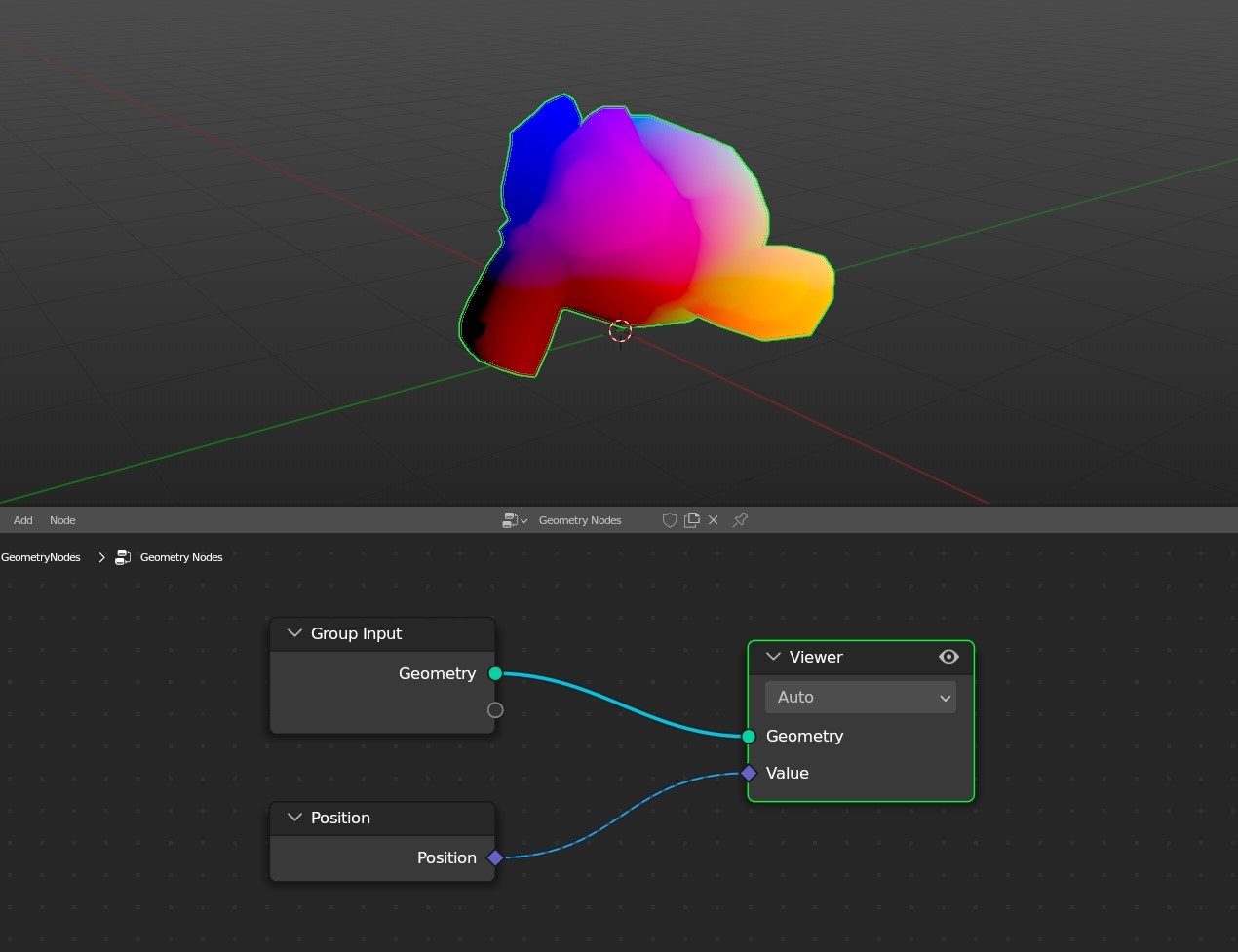

The new Viewer Node by Jacques Lucke is incredibly helpful for previewing each step of a procedural creation in the viewport. Combined with Node Wrangler, Ctrl Shift can be used to not only switch between geometry outputs but also to preview colors, vectors, textures, and other data extremely quickly.

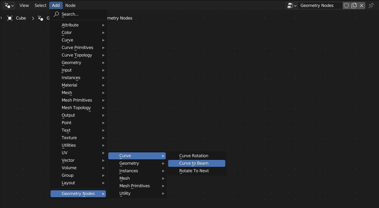

If you noticed the Geometry Nodes Add menu slowing to a crawl when you first opened up Blender 3.4, you’re not alone! That’s because it’s loading in node group assets from the asset browser. Only node group assets that have been saved with Blender 3.4 will be visible. I was not a huge fan of this change at first as it really did slow me down every time I opened Blender and wanted to node around, but after backing up my asset library and re-saving my node groups with Blender 3.4, everything got slightly smoother. I also tested a patch for an upcoming Blender 3.4.1 corrective release that is blazing fast and solves the problem entirely.

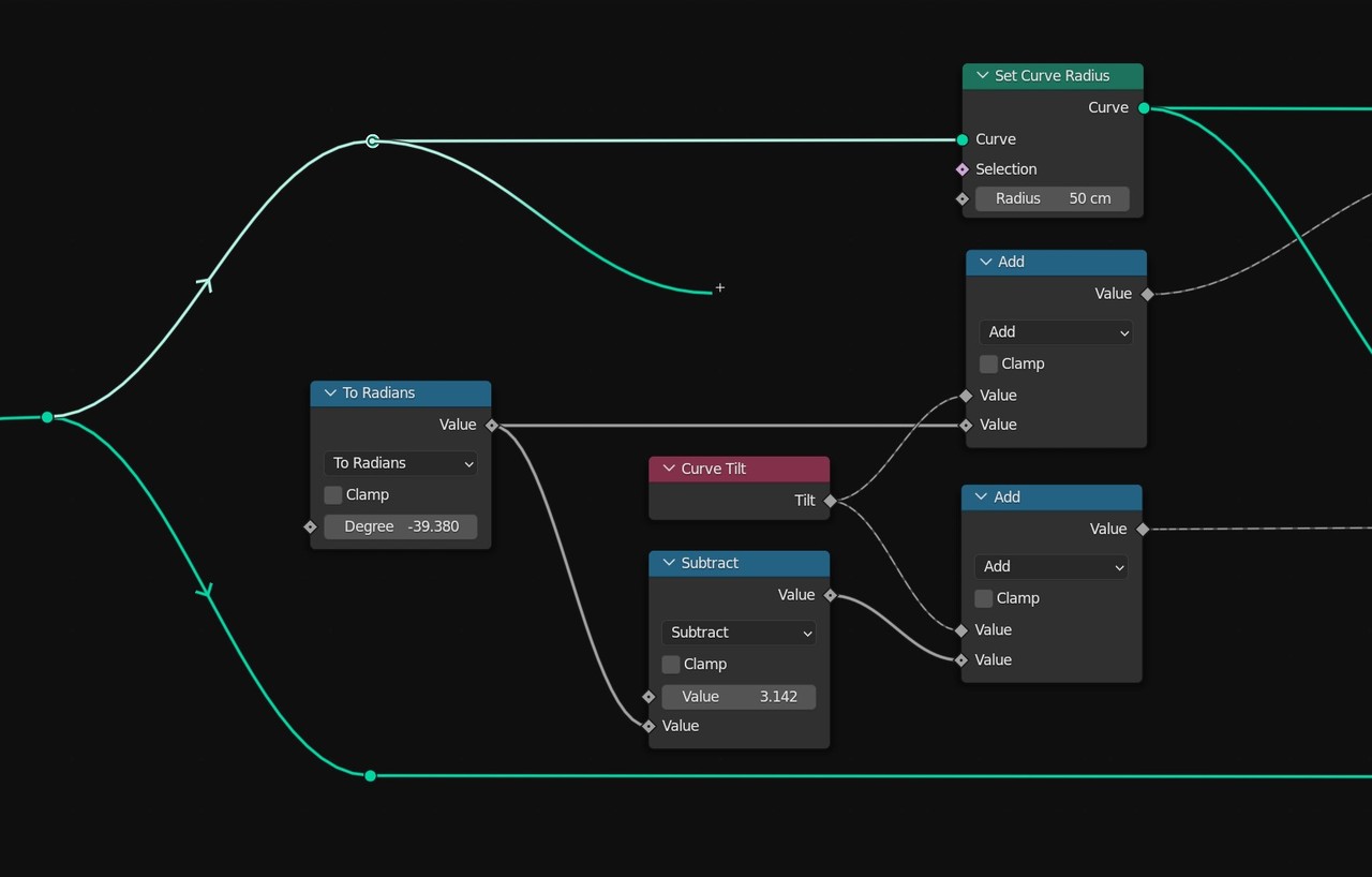

RIP the Transfer Attribute node. Long live Sample Index, Sample Nearest, and Sample Nearest Surface! Those three nodes, which exactly mirror Transfer Attribute’s three modes, have replaced Transfer Attribute in order to make room for more types of sampling in the future. The first two can be found in the Geometry category and the latter can be found under Mesh.

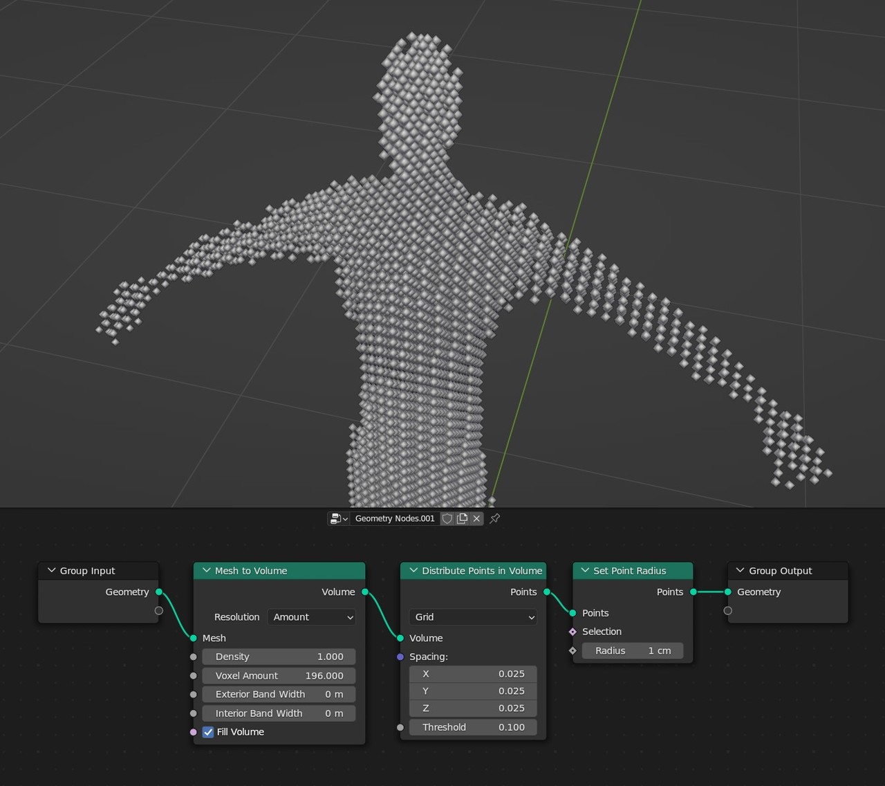

At long last, the Distribute Points in Volume node has arrived!

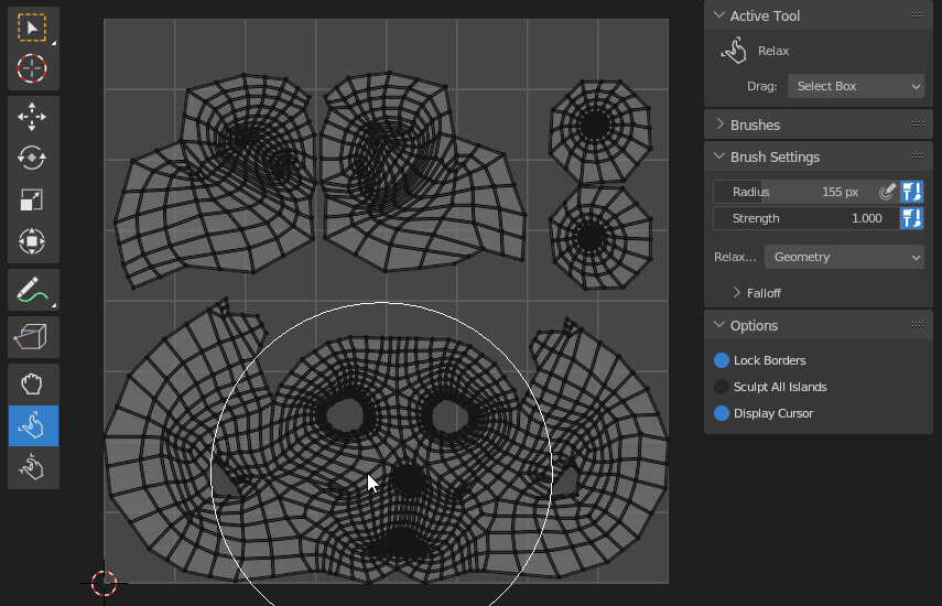

The Relax brush has a new Geometry method that attempts to keep the UV’s in line with the 3D topology. For some reason this can only be found in the sidebar’s tool settings and not the header’s tool settings. UV sculpting was also improved in general. It now supports pinned vertices, constraining to the bounds of the grid, and live unwrap as well as new fixes for boundary edges and orphaned islands.

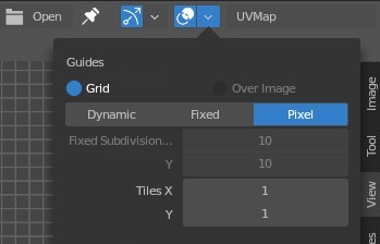

The UV grid can now be non-square if you set the shape to Fixed and it can be matched to the pixels of the image if the shape is set to Pixel. The grid can also be shown over the image. Combined with Increment Snapping and Absolute Grid Snap, that means you can now snap UVs to pixels! There’s also a set of options called Round to Pixels that does exactly that automatically. It may seem like a minor improvement but it should help a lot of game artists in particular.

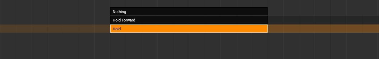

In the NLA editor, the track background now communicates the strip’s extrapolation type so you can clearly see if a strip is set to hold or hold forward. The sidebar got cleaned up a bit with the Edited Action tab removed when it’s not usable. Also, pushing down an action to an NLA track now names the track after the action. Thanks to Brad Clark for bringing that up in his Blender conference talk, and to Sybren for committing the improvement before the talk was even over!

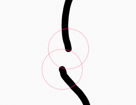

Grease Pencil Fill tool now has a new and improved method for closing gaps called Radius, which checks to see if the end of one stroke is within a certain distance of another. Enabling Visual Aids will make this process interactive if no bridgeable gaps were detected.

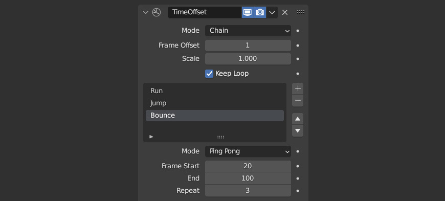

The Time Offset modifier received a new mode called Chain, which can be used to run different time offsets together in a sequence.
