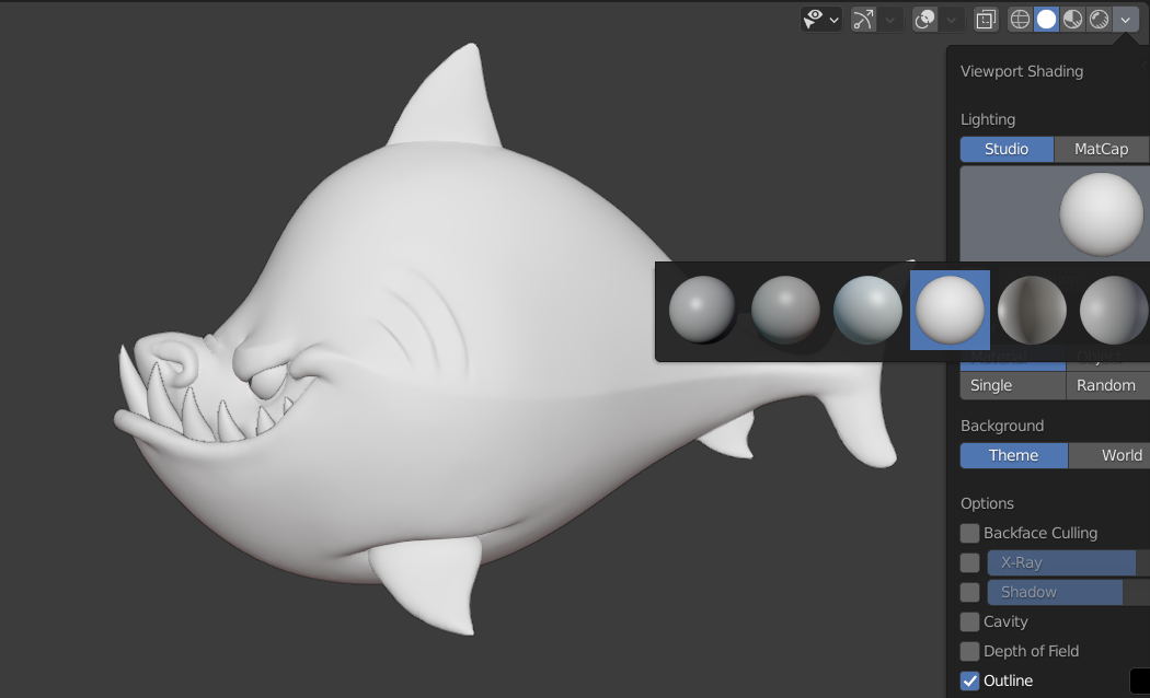

A new Viewport Studio Light was added that’s designed to be really close to white with a little darkening around the edges so that colors can be seen more clearly while texture, weight, or vertex painting.

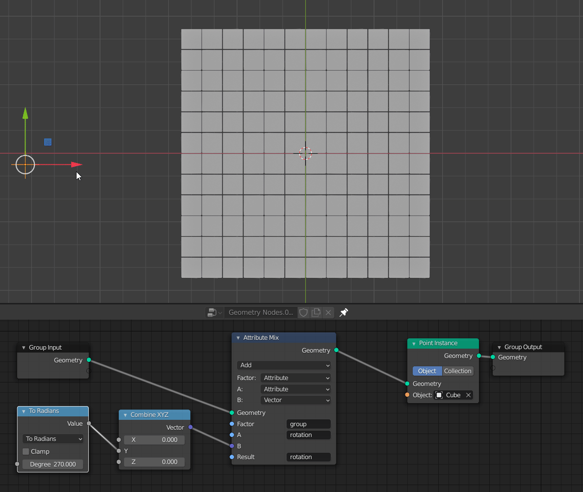

The most exciting development, at least in my opinion, is the initial implementation of node-based modifiers! To use, add a Geometry Nodes modifier, make sure it is the active modifier by clicking on it, and then open up the Geometry Nodes Editor.
It’s just the first steps so only the Subdivision Surface, Triangulate, and Bevel modifiers are available as nodes, but with its built in point instancing system and attribute support, a lot of new possibilities are already available. The attribute system is not particularly intuitive to use as it expects you to memorize all available attributes such as vertex group names, but I expect that to be improved over time as well.
To create something like this example above, this video by Sketches for Humanity is a good introduction.

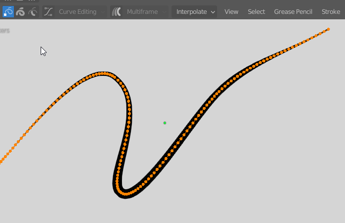

The biggest change to the Grease Pencil in Blender 2.92 is the addition of Curve Editing mode inside of Edit mode.
Just turn it on in the header and manipulate the stroke with Bezier handles!
Some Edit mode operators are not supported in this mode but the developers say they will be soon.

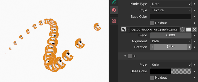

Textures for dots and strokes can now be rotated in the material properties and in the Texture modifier.

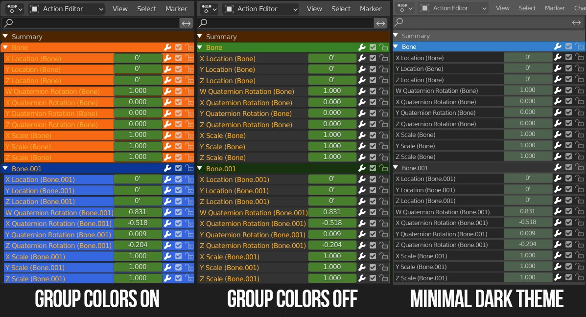

The Group Colors option that used to be in each animation editor has been moved to one single option in the User Preferences under Animation. It’s nice to be able to turn off once and for all, because bright bone group colors make the text impossible to read. For anyone who still thinks the colors are a bit too much, try using my Minimal Dark theme that’s included as a default as well.

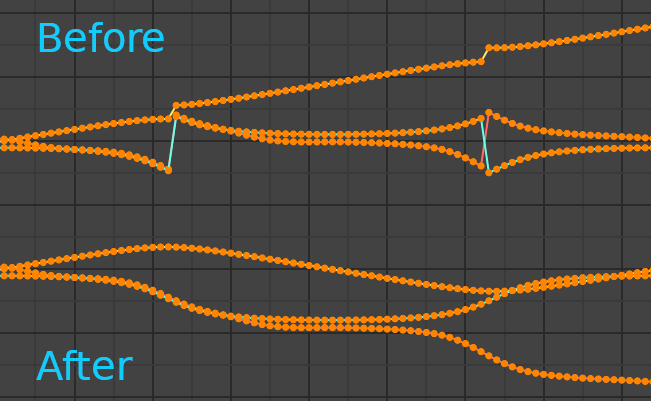

The Euler Discontinuity Filter, which cleans up jumps in the graph editor caused by gimbal lock, has been improved so that it can solve a lot more cases.
