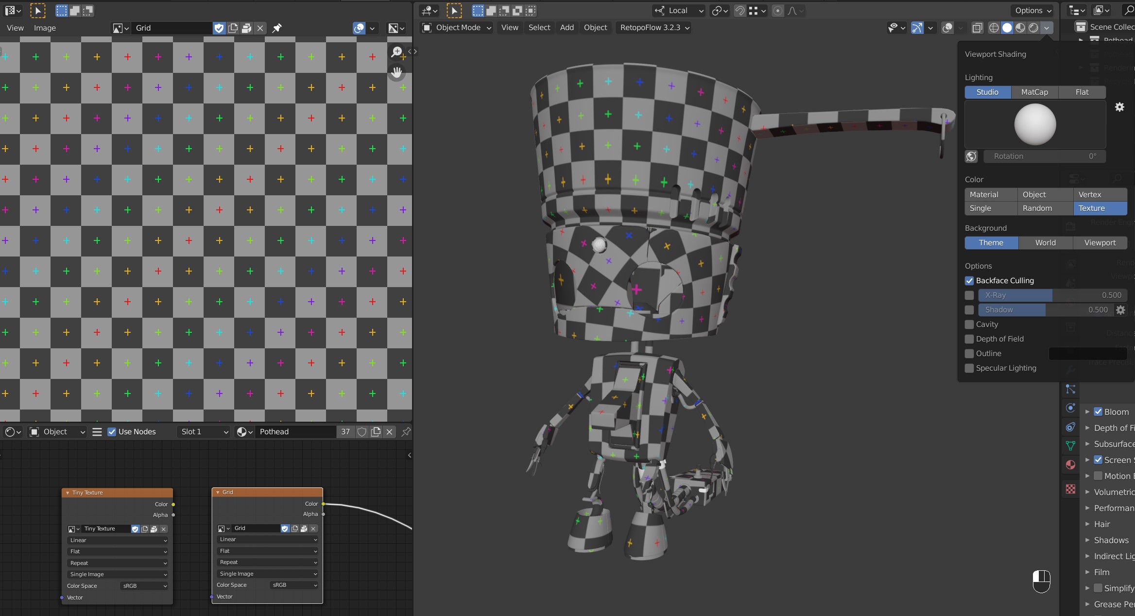

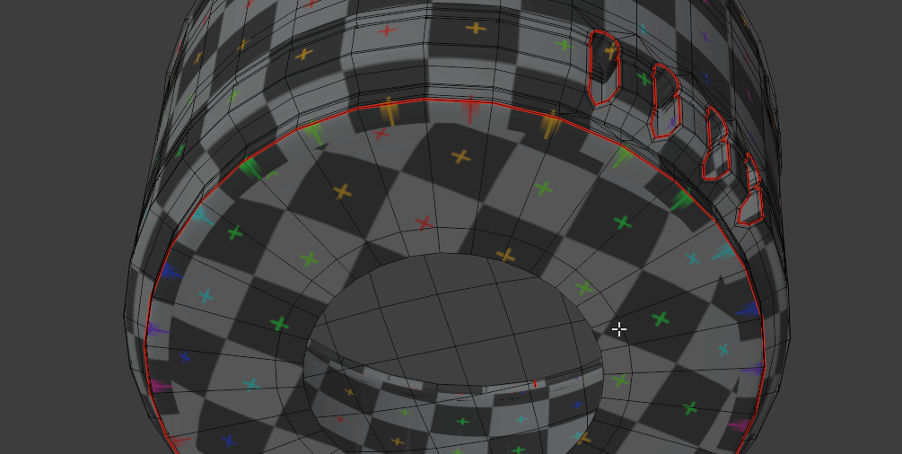

1. Use a grid texture
A checkerboard texture can be seen in many artists workflows while they’re unwrapping for good reason. The evenly spaced square checkers clearly show how large your UV islands are in comparison to other UV islands and whether or not your unwrap is causing any stretching. In other words, it’s the universal way to test if your UVs look good.
You can easily create a grid texture in Blender’s Image Editor or UV Editor by going to Image / New and setting the Generated Type to UV Grid or Color Grid. Then, to see it applied to your mesh in the 3D View, add it to your Shader Editor as an image texture, make sure it’s the selected texture node, and set your Viewport Shading Color to  Texture. I like to use the brightest Studio Light while unwrapping so that I can see the texture clearly but also get a hint of the 3D form of the object.

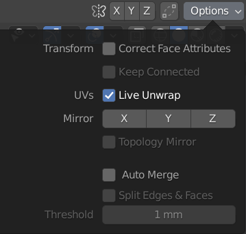

4. Live Unwrap
Placing seams and then unwrapping can be quite tedious if you have hundreds of cuts to make. Live Unwrap in Blender is amazing because it takes away half of that work for you by unwrapping your mesh again every time you mark or clear a seam. You can enable it in the 3D View in the Options popover or, if you don’t have the tool settings visible in the header, in the Tool section of the Properties Editor. To use Live Unwrap in the UV Editor, you can turn it on there as well in the UV menu.

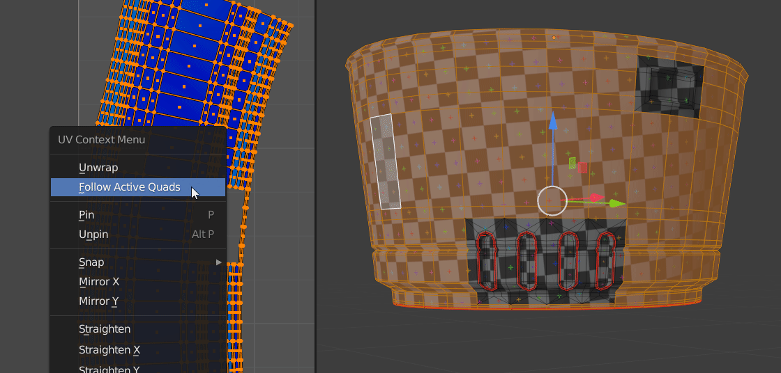

9. Follow Active Quads
This operation is basically a shortcut for aligning all of the UV edges in your island all at once. To use it, straighten out just one quad using Align Auto on all four of its sides if needed, select that quad in the UV Editor to make it the active one, select the rest of the island with Ctrl+L to select everything linked to that quad, then go to UV / Unwrap (or use your context menu) and choose Follow Active Quads. Just like that, all of the edges have been aligned to the edges of the active quad! This will usually cause a minor amount of stretching, but it’s usually worth it for the more efficient packing and the ability to draw clean lines.

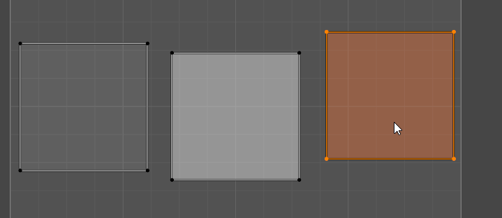

10. Pinning
The problem with using Follow Active Quads with Live Unwrap turned on is that you’ll lose all of your hard work as soon as you place another seam since it will re-unwrap everything automatically. Pinning will help you to avoid this. To pin, select some vertices, edges, faces, or islands in the UV Editor and go to UV / Pin. You can also just use the hotkey P. Now, whenever you unwrap, those pinned components will stay anchored in place while everything else is unwrapped as usual. To unpin, use the same menu or Alt+P.
11. Moving Islands to the Side
Pinned islands will get ignored while unwrapping, but that also means that other islands might get unwrapped on top of them. This isn’t really an issue as you’ll want to unpin and re-pack everything at the end anyway, but overlapping islands can be messy to work with. I like to keep my UV work area clean by moving pinned islands off to the side of the texture space so that they don’t get in the way.

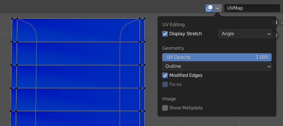

14. Visualizing Stretching and Modified UVs
As mentioned before, I usually like to work with subdiv disabled in Edit Mode, but it can be helpful to turn on sometimes to diagnose what is causing some stretching. After enabling it, turn on Modified Edges in the UV Editor’s Overlays popover (I think it may actually be on by default now) and you’ll be able to see just how your UV edges are being pulled around by the smoothing.
You can also turn on Display Stretch in that same menu, which shows a helpful heatmap of where your islands are most distorted.
15. Partially Following Active Quads
Here’s the best trick I know for straightening out more complex islands: use Follow Active Quads on only the part of the mesh that should have straight quads, pin those vertices, and then unwrap the rest of the island. Everything that’s not pinned will snap right into place!

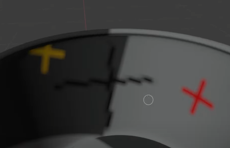

18. Split Convex Corners
Placing seams where a UV island is concave will cause overlapping, but cutting where it is convex will often help it to lie flat. Just make sure that the new seam doesn’t cause more Subdiv stretching!

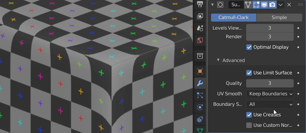

20. Fix Stretching from Subdiv’s UV Smooth
By default, the Subdivision Surface modifier causes some pretty bad UV stretching when you place a seam along a sharp edge. To fix this, just switch the UV Smooth option on the modifier from Keep Boundaries to Keep Corners. In some cases, Keep Corners Junctions and Concave will work even better. The names are pretty self explanatory, but don’t forget you can check out Modified Edges in the UV Editor to see exactly what’s changing!

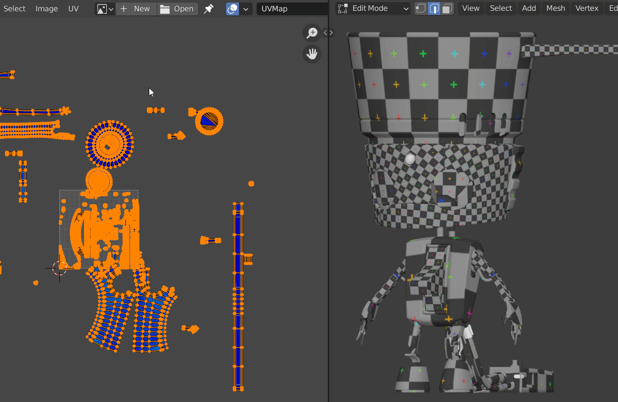

23. Average Islands Scale
It’s always good to make sure that the different parts of your model have roughly the same texel density, i.e. the squares on the checker texture look about the same size. To even out your texel density for all islands at once at the end, select all of your parts and go to UV / Average Islands Scale.

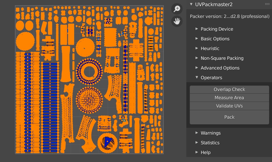

26. Use Better Packing Algorithms
Blender’s default UV packer is great for packing basic shapes, but it treats every island like a box and therefore doesn’t pack anything into concave shapes. I’d highly recommend picking up an addon with a more advanced algorithm like UV Packmaster 2 (paid, lots of features) or UV Packer (free, fewer features) so that you can make the most out of your texture space without needing to pack things by hand.
