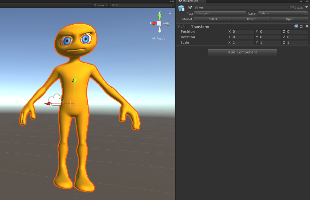

Lets take a look at an example of how this would work. Say I want our Baker character to be 6 feet tall. In Unity they use meters, so we can use a game object to act as our “ruler”. Since we’re only interested in the height of this character, I’ll use the Y axis to determine the measurement. Placing our character into the scene directly at 0,0,0 for the X, Y and Z axis which puts him directly in the center of the world. Do the same for the rotation. Here is what he looks like with the defaults in the Transform component:

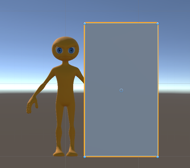

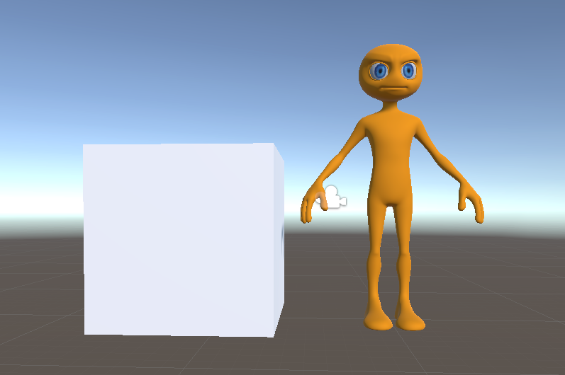

The scale of this object says 1x1x1, which means he’s 1 meter tall based off the defaults. Now lets see how tall he really is by default. Create a cube game object, this game object is a good representation of units in Unity as it’s exactly 1x1x1, other game objects may differ in default sizes so use a cube to be safe. Placing the cube directly at the same spot as his feet, we can see the baker character is actually much taller than 1 meter in height.

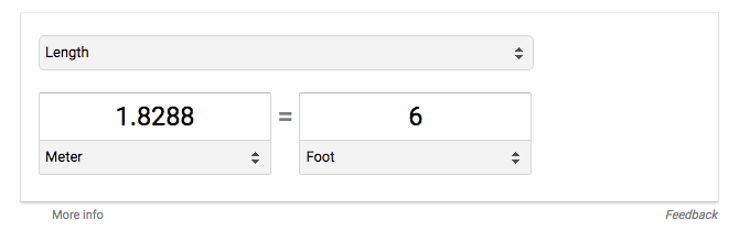

This is due to the differences in scale units used when this object was created in Blender. It’s a non-issue since we will be using the cube as a reference of the height but something to be aware of. So we wanted to scale this character to be 6ft tall, since Unity uses meters we need to ensure we convert these measurements. A quick Google conversion shows 6ft is 1.8288 meters
I increased the scale of the cube up to 1.8288 in the Y axis since we’re just tracking height. Here we can see the Baker character is nearly 6ft tall by default, we just need to scale him up a bit more to better match:
To scale him up I want to ensure I scale uniformly along each axis. While I do want to adjust his height, his width needs to match as well to avoid an elongated character model:

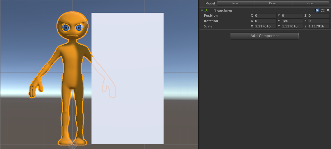

There we go, bumping the scale up to 1.117016 we can see he’s now the same height as our cube. Ideally models of this kind would be created in a 3d program with precise real world measurements, but if you’re using assets you’ve acquired elsewhere or want to reuse older assets this is a simple work around.

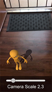

Instead of scaling an object, you can scale the camera. This in effect will determine how big something looks without actually changing the scale of the objects. The scale of the camera can also determine how quickly you can “walk up to” an object.
Below you’ll see an example of how adjusting the camera’s scale can mimic the effect of resizing an object when in reality we’re just adjusting the scale of the camera to make it seem so.
The larger the camera scale the smaller the objects will appear. The smaller the camera scale, the larger the objects will appear. Use this when scaling the objects directly is not feasible. It may also make sense when you want to scale multiple objects at once using a “uniform scale” versus manually adjusting the size of each object.

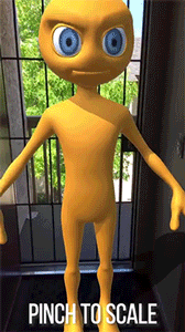

What would you expect to be able to do instinctively? Naturally you’d want to swipe left and right, up and down to essentially rotate the object to view it from all angles. Having a virtual joystick on screen would feel weird. Same is true for scale. Typically when scaling objects on a mobile device you’ll “pinch” the screen in or out to scale it. This is expected behavior and as such you should include it if you allow users to interact with an object in this way.
Pinch to Scale can be used in a variety of ways, but also helps to enhance the general interaction a user might expect. Below you’ll see an example of this at work as well.  Too big or too small and it becomes a chore to interact with the object. Here we have pinch to scale with our Baker character:

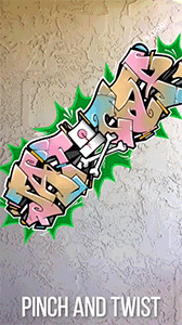

Another common mechanic is to “pinch and twist” to scale and rotate simultaneously. An example of this would be placing 2D images onto a wall such as graffiti or posters. Here is an example of that at work:
Examples shown above used Lean Touch
