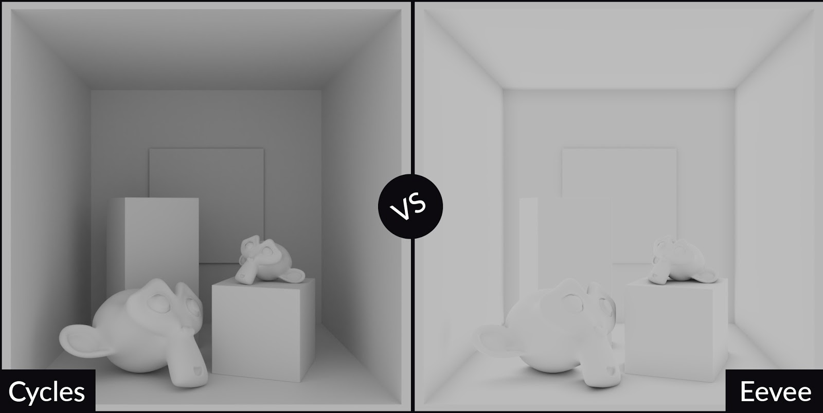

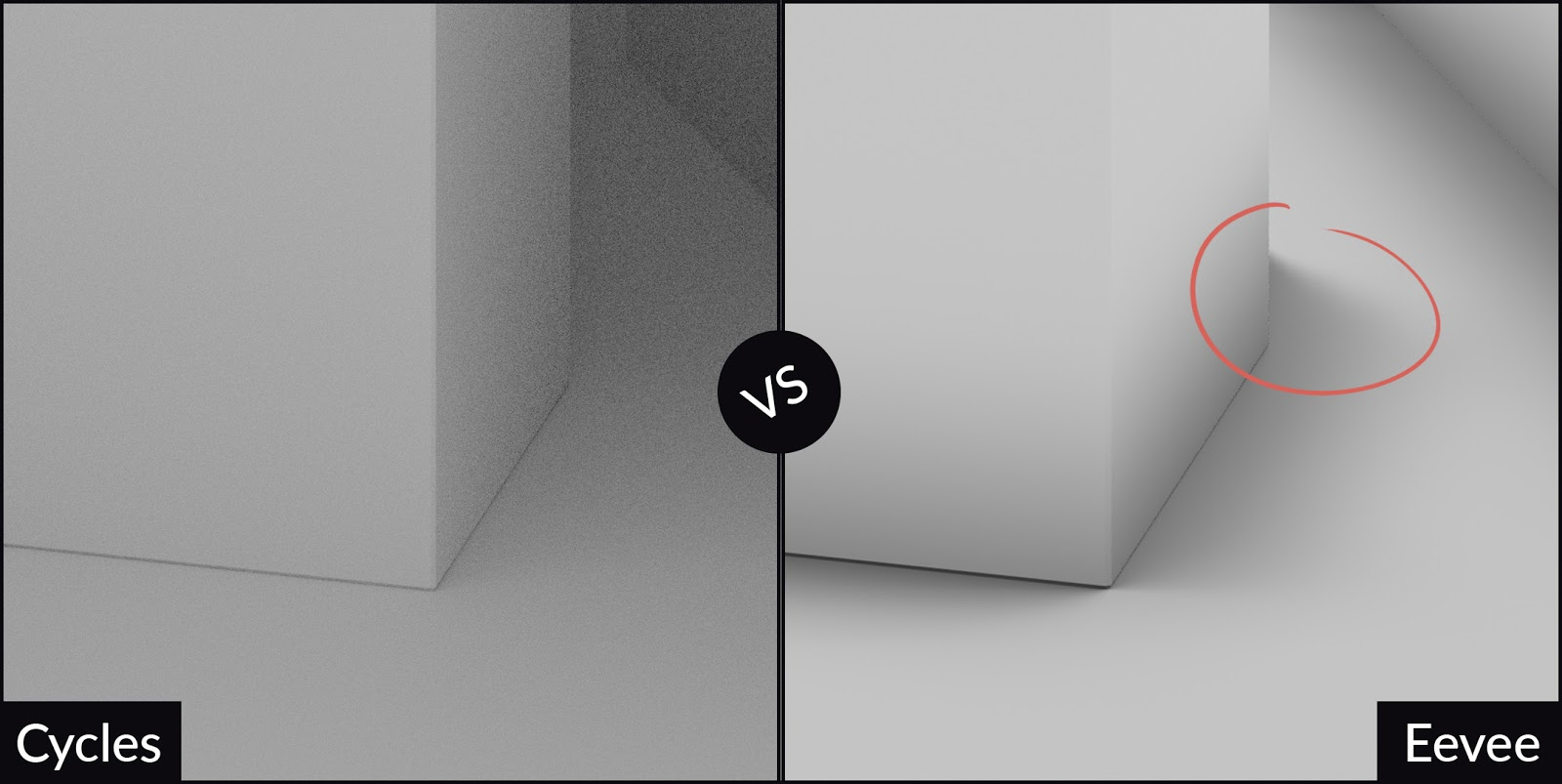

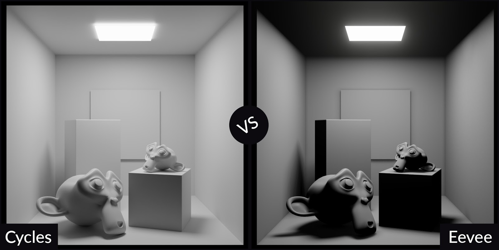

Ambient Occlusion
Cycles ambient occlusion is based on the distance between surfaces in 3D space. Eevee AO is based on the distance between surfaces according to the 2D image the screen sees.
It manages to still look quite good because it uses a depth pass to determine where to fade out the AO so that it doesn’t cast on objects far behind it (you’ll notice this in 2.79’s viewport AO).
However, you’ll often see occlusion attach itself to objects before the depth cutoff takes effect.
Eevee can only occlude a set distance away from an object. In the first Cycles render above, notice how the sides of the box have large gradients and the surfaces where the monkey heads sit have small gradients.
The combination of sharp and broad transitions between light and dark looks natural. In Eevee, both areas of gradients are the same size, causing the sides of the box to look flat and the occlusion beneath the monkeys to look overly dark.
Update: Ambient occlusion is much better in Blender 2.93 and later, but still doesn’t hold up to Cycles for the same reasons as listed above.

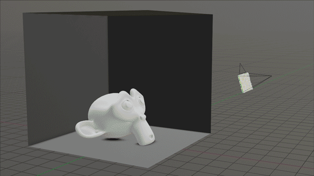

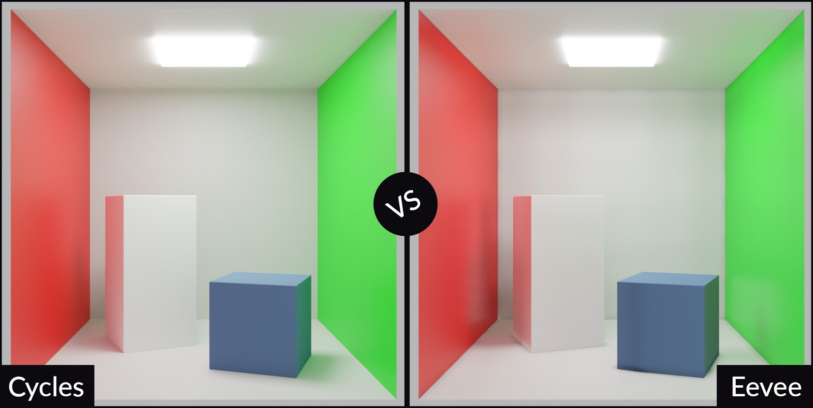

Global Illumination
Cycles has global illumination (a.k.a indirect lighting, radiosity, etc…) baked deep into how it works. Light paths pick up data (like what color has already been absorbed) from each time they bounce and uses that information to determine what to do when it hits the next surface.
Eevee definitely can’t get that bounce information, so it uses light probes to approximate it. Light probes essentially take snapshots of the scene from their point in space, and project the appropriate colors onto objects in their vicinity.
This is called baking; the data is stored and not updated every frame. Therefore, objects with baked indirect lighting should not be animated.
An massive amount of light probes would result in the scene looking about the same as in Cycles, but of course that would take an eternity to bake. The limited amount of light probes means that the space between them must be approximated, which can result in artifacts.
In the render above, notice the faint dark splotch on the blue cube, and the uneven occlusion where it meets the ground.

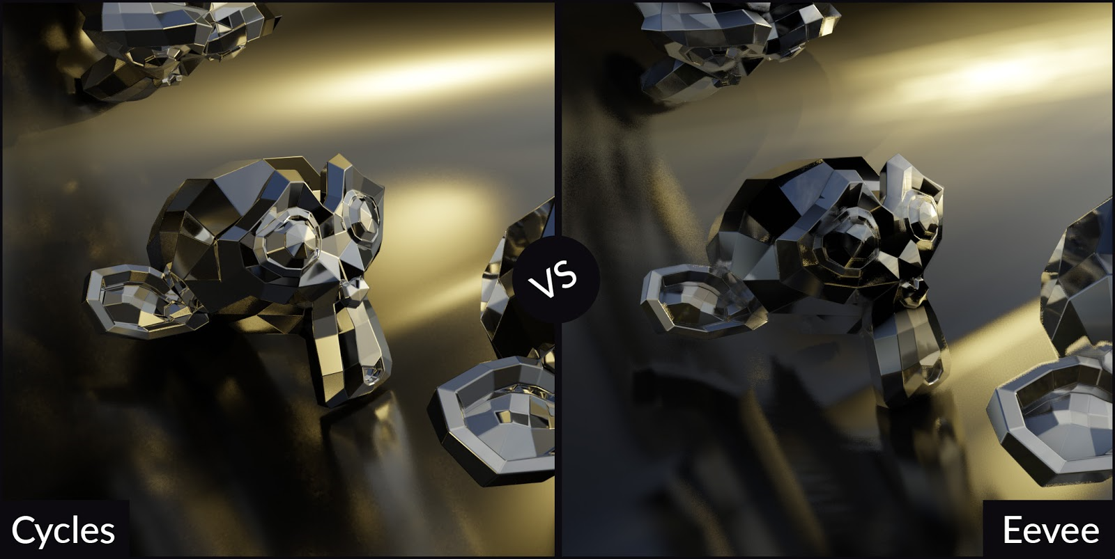

Reflections
At this point you can safely assume that any feature of Cycles works by bouncing rays of light, so great reflections are not surprising. Eevee uses a couple tricks to try to mimic this, but of course it still ends up a ways away from accuracy.
Screen space reflections work by taking the resulting image from the camera and flipping it around. This is fast and looks great in most circumstances, but cannot work with anything not seen by the camera such as the backs or bottoms of objects.
Eevee can also use reflection probes, which are planes, cubes, or spheres that act like virtual cameras. They render what is around them and then map that image onto the object.
Since planes are quite simple they can be updated in real time, but cube and sphere maps need to be baked and therefore the objects they are getting data for will not look right when animated. It’s also rare that an object is a perfect cube or sphere, so the mapping will also introduce some imperfections.

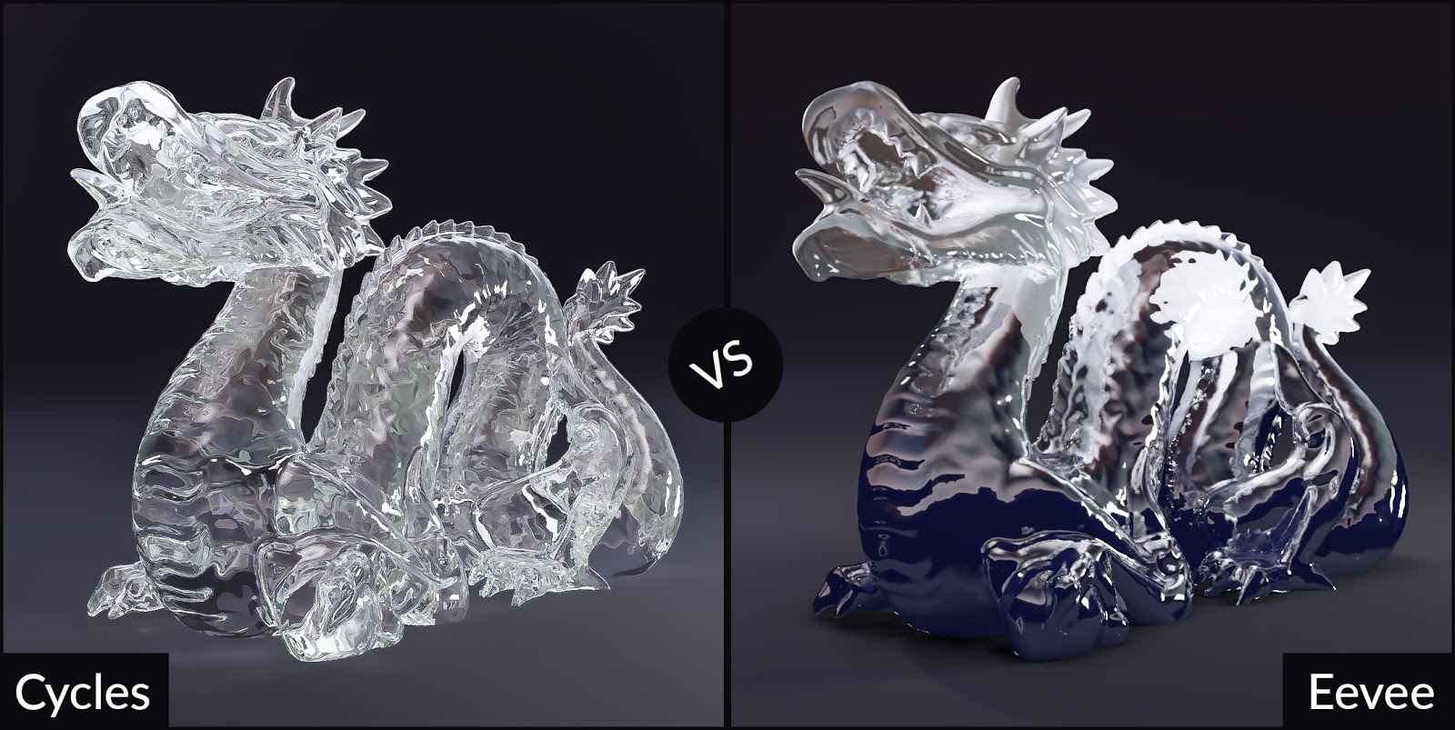

Transparency
Both render engines support transparent materials, but that’s not something any render engine loves to handle. Cycles transparency is limited by the number of bounces, after which the material will render as pure black.
Eevee’s Alpha Blend material setting works by layering the materials on top of each other, from back to front, and it needs a limit in order to not slow to a glacial crawl. After it hits that limit it will just not draw any more faces, resulting in a mushy render if you have too many layers.
Eevee’s Alpha Clip on the other hand, layers materials from the front to the back, and looks nice and crisp. The trade-off here is that the material is either fully opaque or transparent, and can’t handle any blend between the two. They also tend to get more transparent as you move away from them. You can see in the example above that the tree in the back has its branches clearly showing through the leaves, even though it should be almost completely occluded.

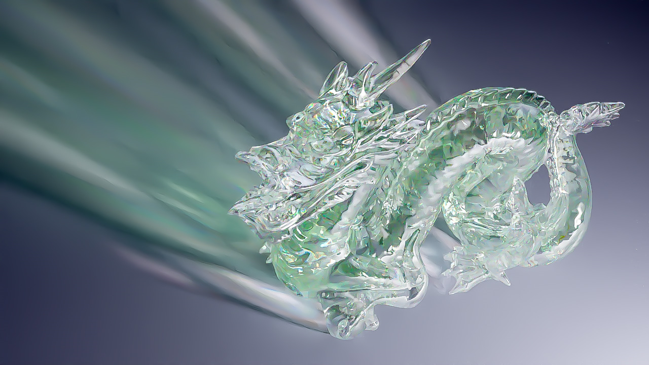

Refraction
Refraction in Eevee is done by warping what is behind the object or is seen from a cube map according to its normals and thickness. This means that the light is not bouncing around inside the object like in Cycles, and is not aware of the light entering from all angles. This can result in a fantastic looking glass ball, bubble, or puddle of water, but it’s not quite up to par when it comes to complex objects. Even ray traced refractions like we had in Blender Internal can’t hold a candle to the result we get from full path tracing in Cycles.
For a deep dive on how to work with transparency and refraction in Eevee, watch the Fundamentals of Shading lesson on creating glass in Eevee or pick apart our advanced Eevee glass shader.

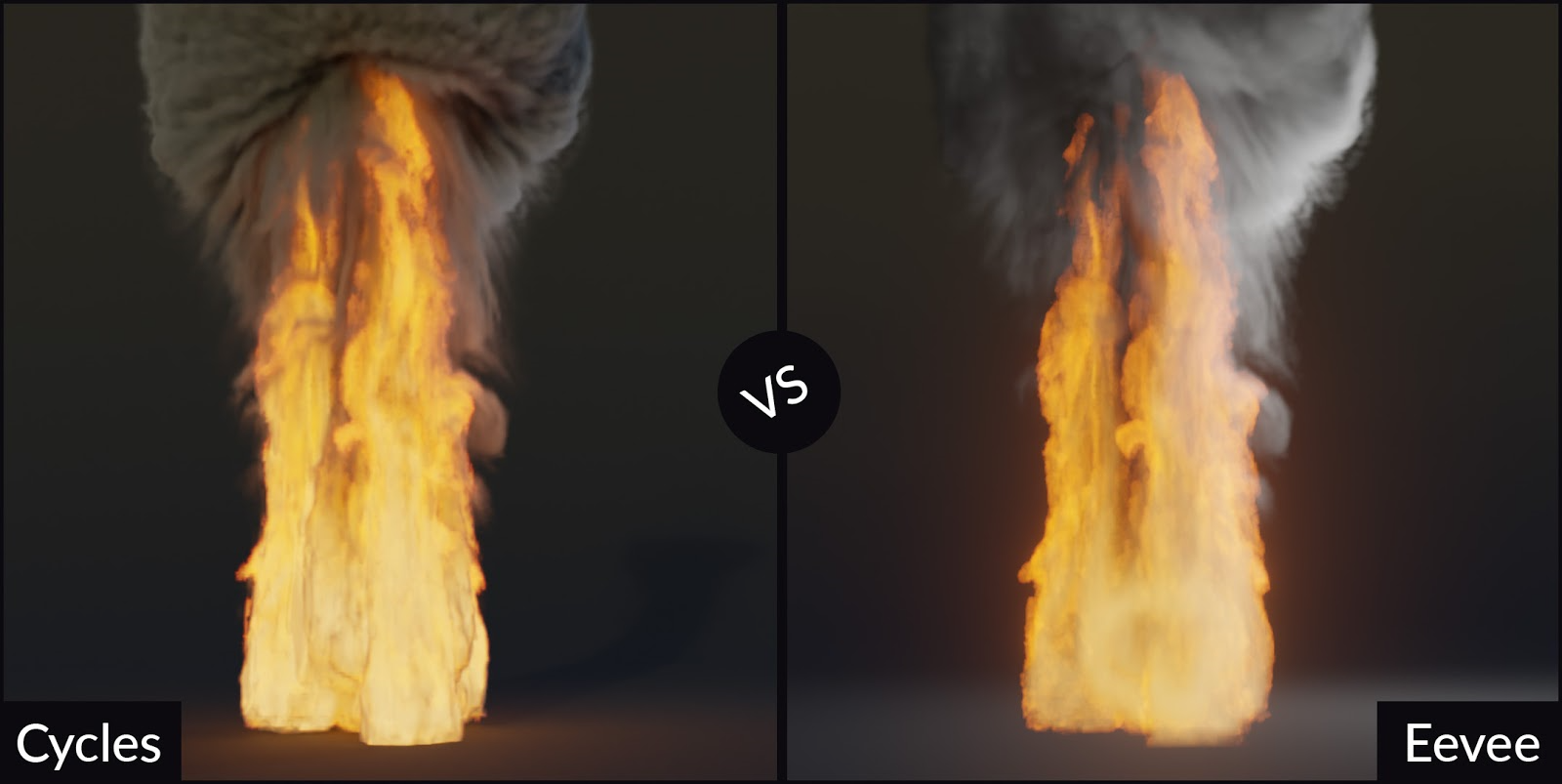

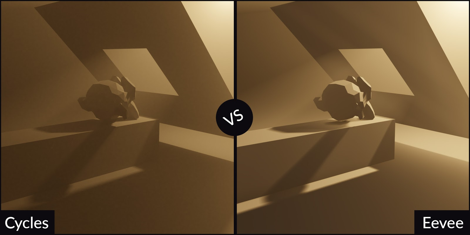

Volumetrics
The thing Eevee kicks Cycles’ butt at is rendering ‘god rays’, where light is projected through a volume. While Eevee is less accurate, it looks good enough for most cases and is completely noise free. You can even add 3D textures to make it even more interesting.
Complex volumes, however, are another story. Actual ray scattering is needed for dense looking smoke, light emission, or casting shadows from the volume onto other objects.

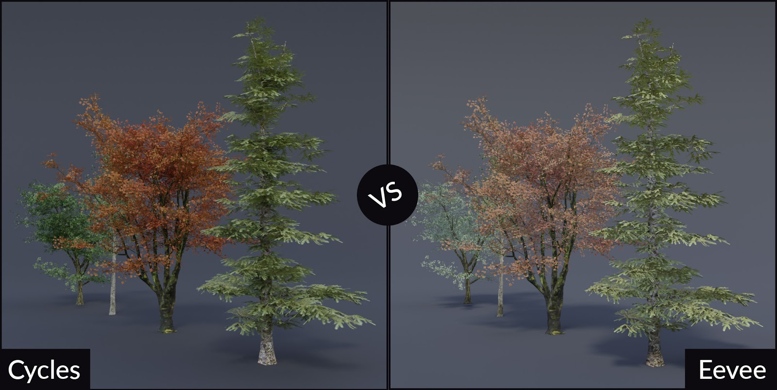

Subsurface Scattering
Eevee uses the thickness of an object along with its normals to approximate light scattering under the surface. It looks quite good when used in subtle amounts, which is what you would want for things like skin.
What it struggles with are thin surfaces and sharp details as compared to Cycles, especially when using the Random Walk SSS method. In the render above, notice the lack of definition around the chin and roof of the mouth. The tail, on the other hand, looks about spot on.

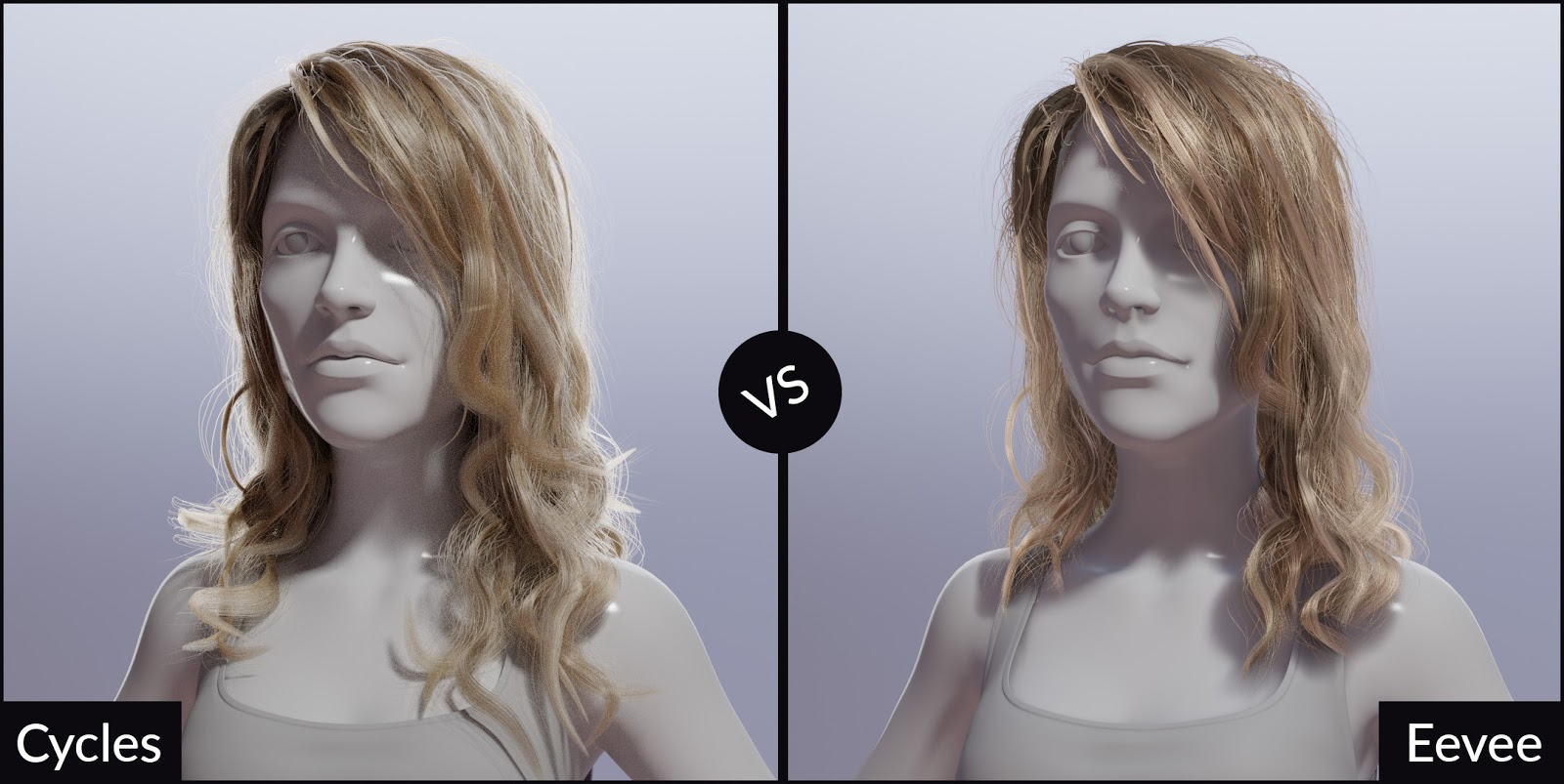

Hair and Fur
Hair in Eevee looks better than real time hair has any right to look, and it can handle a pretty ridiculous amount of strands. Just look at this tiger demo by Daniel Bystedt to see what’s possible!
The limitations on Eevee hair come into play when you look at the shadows they cast and the lack of scattering through groups of strands that we would get by using the Cycles Principled Hair BSDF. In the example above, look at where the hair meets the neck and shoulder, the shadow on the forehead, and the gradation of color along the hair across the side of the head.

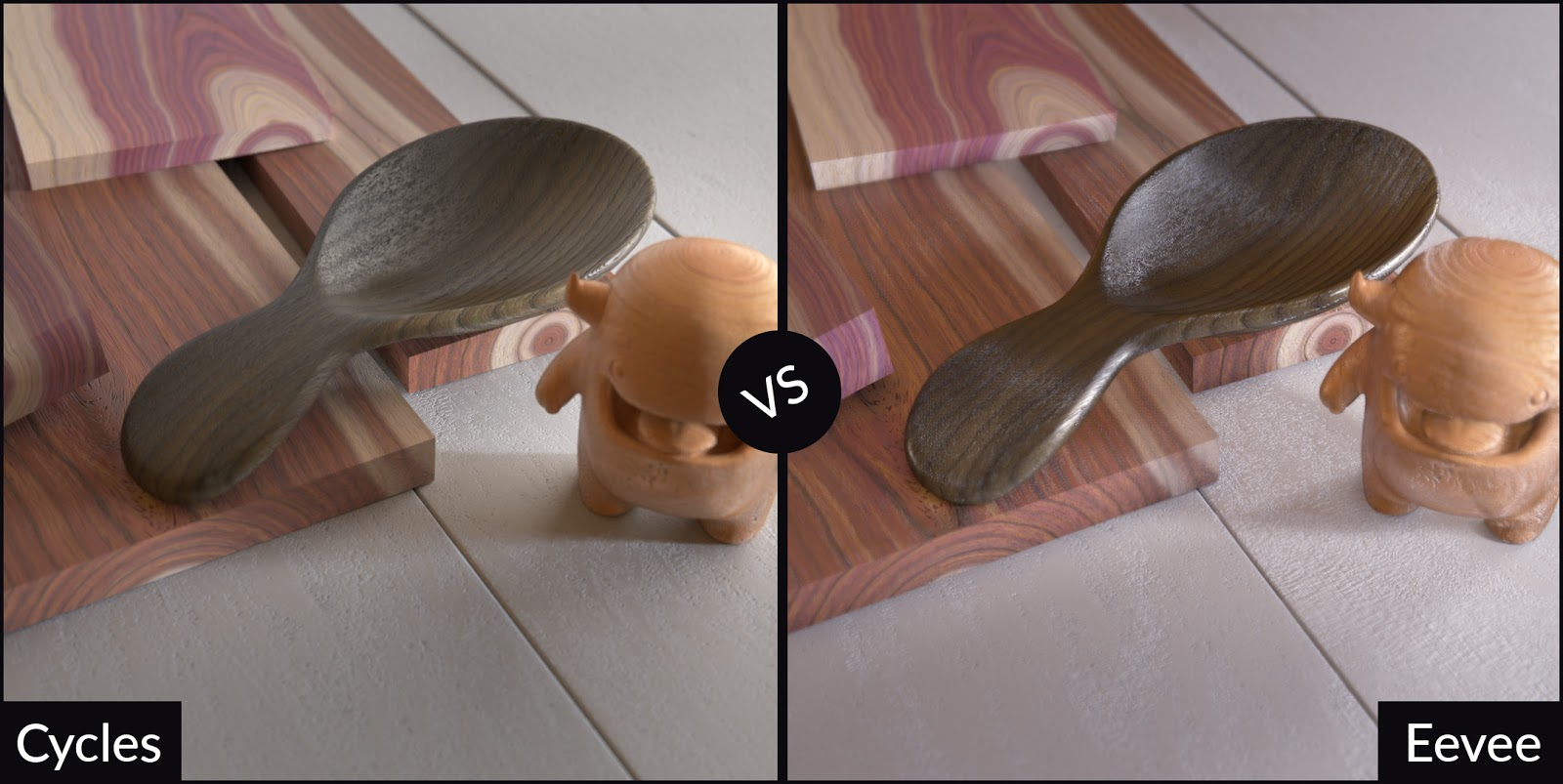

It also has a hard time rendering complex bump details. In the image above, notice the wood grain on the spoon. Because Cycles is averaging many samples, it looks much more detailed than the real time version which uses relatively few screen space reflection samples. Improved bump mapping is on the road map for Eevee after 2.81, and the developers have stated that the new method should look close to Cycles quality.
Update: Eevee’s bump rendering  has been improved and it does look quite close to Cycles. Go Blender devs!

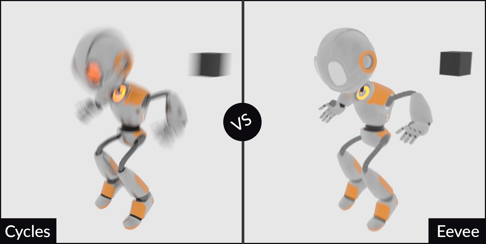

Motion Blur
Cycles supports motion blur from most sources, while Eevee currently only supports camera motion blur. Objects moving or armatures deforming won’t have any effect. It also doesn’t support fancy effects like rolling shutters. This is not an inherent limitation of rasterization though, so it’s likely to be updated in the future. Cycles started out the same way and has had its motion blur drastically improved over time. It’s not a trivial problem and can take quite a while to implement.
Update: Motion blur now works very well in Eevee, even for rigged characters, though it does not support rolling shutter (a fairly niche use case I’ve never actually needed).

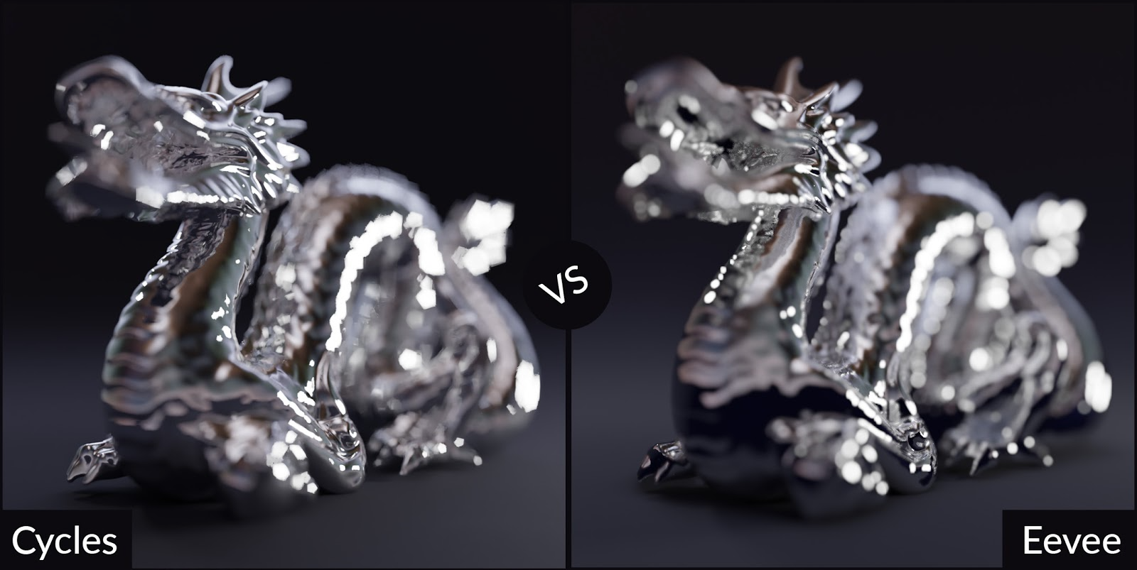

Depth of Field
Eevee supports depth of field, and it looks quite good! It’s still approximated though, whereas Cycles is physically accurate. The difference really only shows in the transition between sharp and blurred areas (notice the spikes along the chin in the example above) and the lack of bells and whistles like polygon shapes and anamorphic distortion. For the majority of cases though, it’ll work great and be way, way faster. Big improvements in Eevee DOF are on the way for Blender 2.81 or 2.82, which should make it more comparable to Cycles.
Update: Eevee’s DOF now looks impressively close to Cycles when using the High Quality Slight DOF and Jitter Camera options.

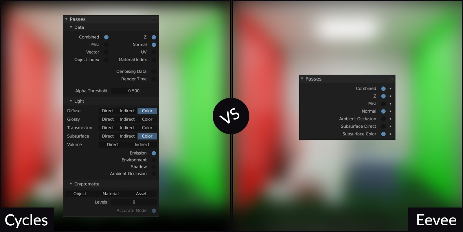

Compositing Passes
This last one is a big deal when it comes to VFX work. Eevee has the major ones like Mist, Normal, and AO, but it’s still missing important things like Vector, Object and Material Index, Shadow, Emission, and Cryptomatte. These may also be improved over time, but will never allow the same amount of fine tuning based on the lack of ray information.
Update: Eevee now also supports diffuse, specular, volume, emission, environment, shadow, bloom, and cryptomatte passes. Vector is the only major one that is currently missing.
