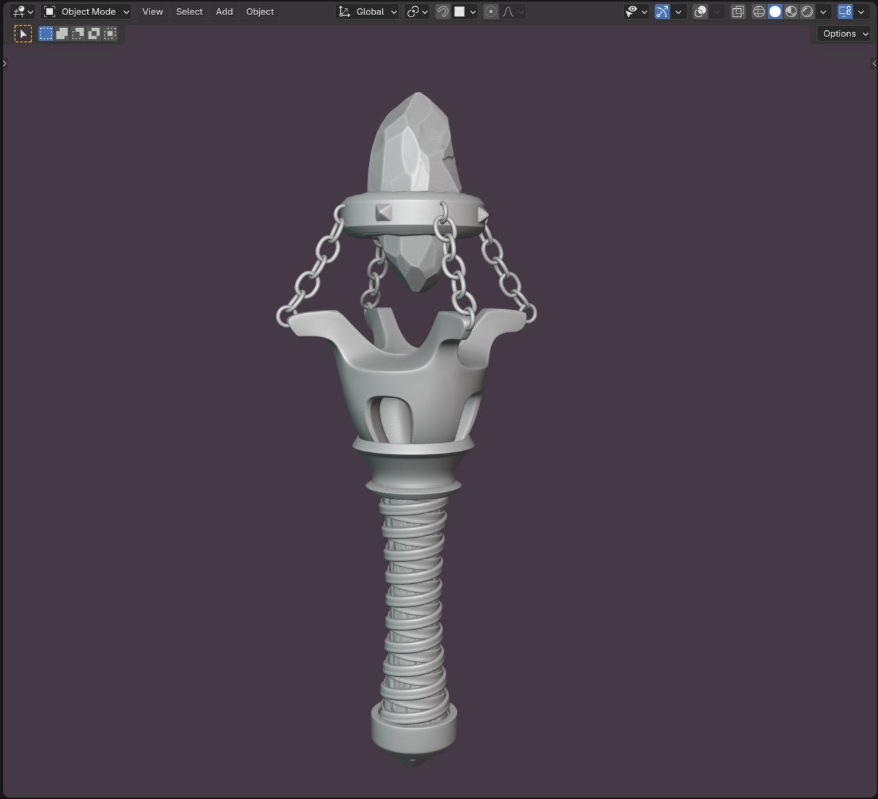

Where I normally start is the “High Poly” stage. Here, I model with no restriction on polygon count. I can model in the details as much as I want, because this asset isn’t going to be the final game model.

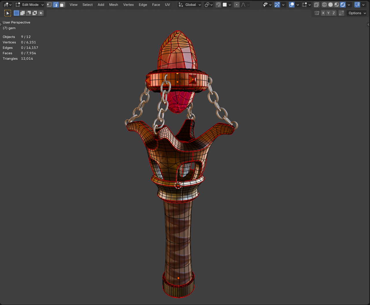

Once I’ve completed my high poly, I’ll take this and start to remove unnecessary polygons.
Everyone has their own way of accomplishing this, but I usually will remove edge loops that do not alter the silhouette of the model.
In this “Low Poly” stage, we are looking to only keep detail that will change the overall silhouette of the model. This is a pretty loose stage, and takes a bit of practice to really get comfortable with.
The unfortunate consequence of retopologizing too much or removing necessary polygons is that we could have baking artifacts later when we texture, so I am often more conservative with how much I remove in this stage.

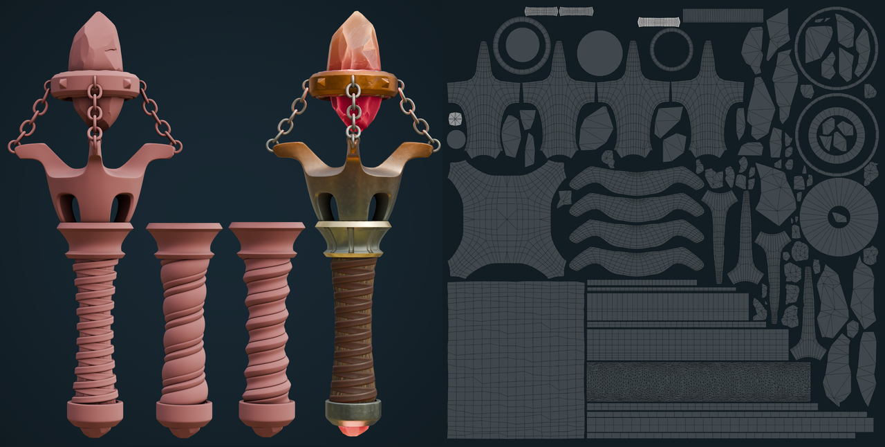

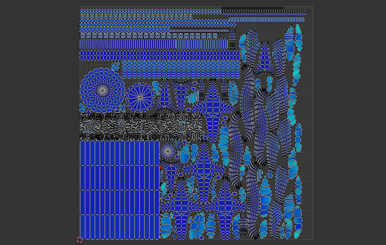

We’ll use the model’s UV coordinates to determine how the textures will appear. This involves creating seams to separate parts of the model, unwrapping the islands that are created from our seams and straightening everything out so that we minimize UV skew and distortion.

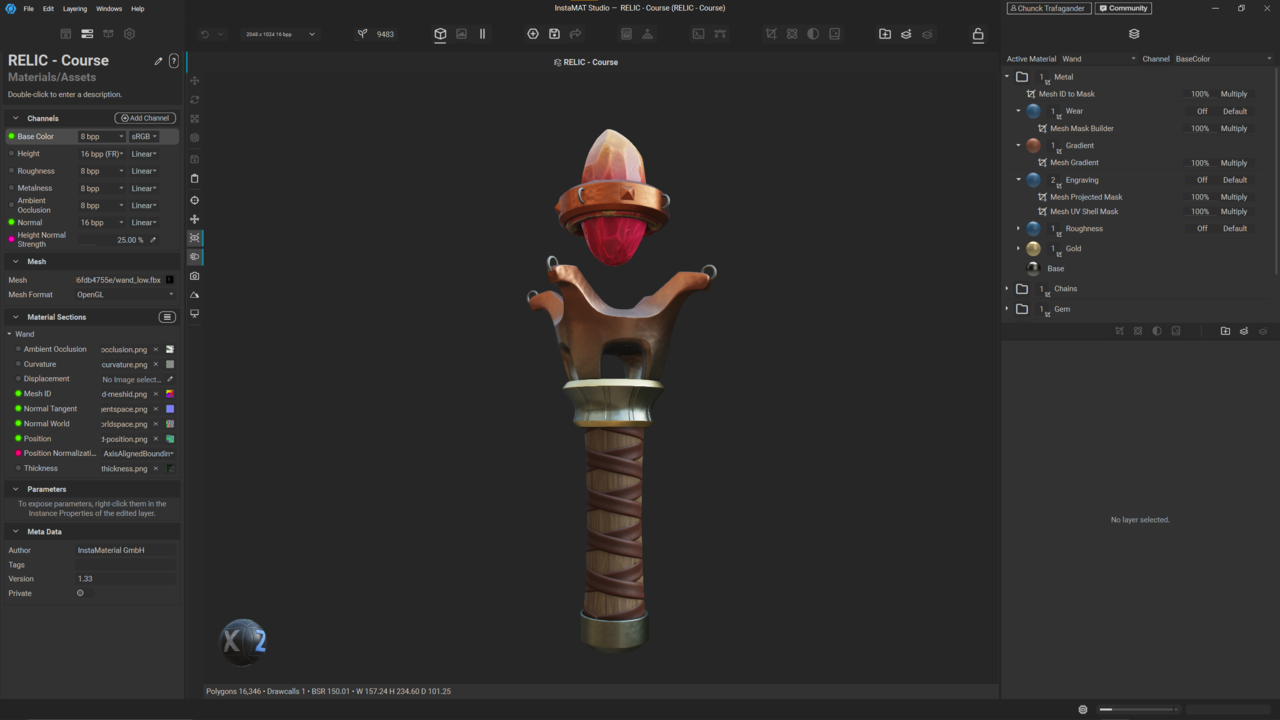

After the low-poly model has been UV unwrapped, we can begin the texturing process. There are countless texturing applications, each with their own advantages. I personally have been using a new software called InstaMAT to do all of my texturing, since it’s pretty powerful and it comes with a free commercial license.
First, we need to extract the high-quality details from our high-poly model. This process is referred to as “texture baking.” The software will cast rays from the surface of the low-poly onto the high-poly and return with the surface information it received. This process will generate useful images that we can use to start texturing.
We can use these images to give our model some “texture”, hence why we call these textures.
Here is where we can make the surfaces appear like any type of material we want, and give them characteristics to help contextualize the model for the environment in which it will be used.

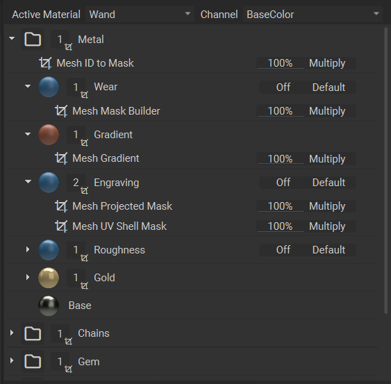

Each texturing application will operate differently, with a common theme of “layering” the effects that you add to your texture. If you are familiar with layer-based image editors like Photoshop or GIMP, you’ll get the idea.
