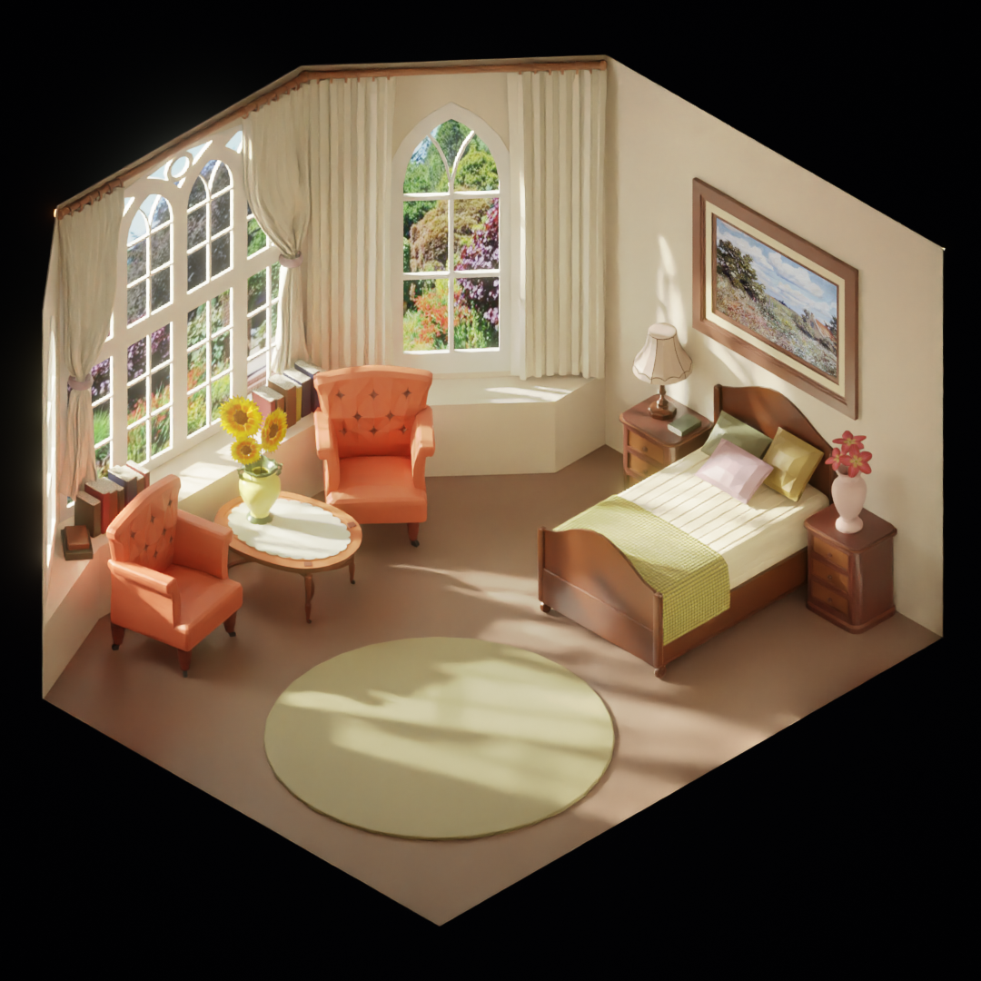

There’s a big gap between knowing tools though and knowing how to use them effectively. I’d recommend doing some low poly modeling to practice the tools, first with a couple objects at a time but then full scenes.
Keeping each object simple helps keep it less intimidating, but creating a whole scene filled with a lot of simple objects is incredibly helpful for practicing on a wide variety of shapes and for learning important skills in scene organization.
Example of a low poly room, created for the Mesh Modeling Fundamentals exercise, by Katerina Novakova

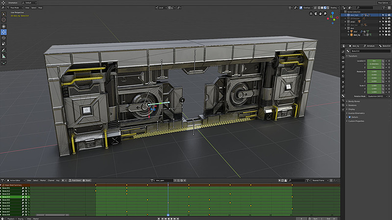

Hard surface modeling is the next step up from low poly modeling. It’s the same process at the beginning to create the basic shapes, but then requires you to learn a few new techniques for adding layers of detail and polishing the final result.
The complexity goes up, in both poly count and form, but modifiers can help keep the Edit Mode mesh easily editable. The modifiers that I would recommend learning (which are featured in both the Fundamentals and Modify courses) are:
  • Smooth by Angle
  • Bevel
  • Solidify
  • Boolean
  • Curve
  • Simple Deform
  • Lattice
Normals are much more important at this stage, since you’ll need flat surfaces to appear flat and rounded surfaces to appear perfectly smooth. It may sound simple, but it can be quite a challenge! Once you’re past the basics, you may want to learn about the Weighted Normal and Data Transfer modifiers as well.
You’ll also want to get familiar with curves, since you’ll be using those not just for cables and wires but also deforming shapes along a path.
Hard surface model created by Utopic Light based on the Press Start course

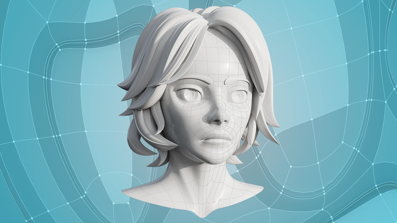

The Subdiv modifier is easy to enable, but modeling with it takes time to master. The results of smooth yet crisp high poly objects and of melting one shape seamlessly into another, however, are very worth it. Here’s where you’ll want to learn more about topology – edge flow, poles, quad junctions, and the like – so that you can get the best possible results with even the most complex shapes.
Cute example of a subdivision surface model by Ingrid Frank
