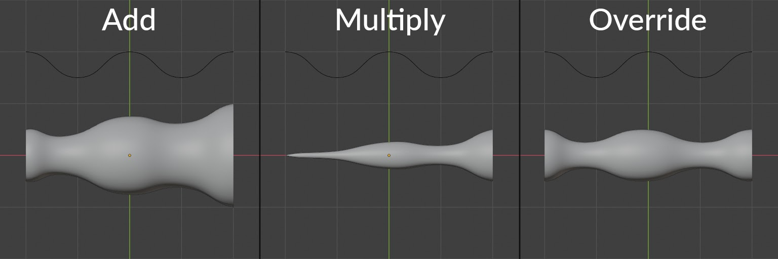

Curves have a new Taper Mode that changes how taper objects affect the radius of the curve.

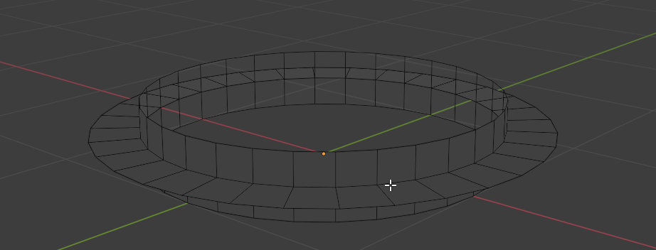

The Mirror Modifier has a new Bisect Distance option which determines how close a vertex can be from the cut and still be merged at the center.

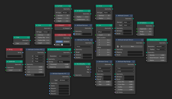

Blender 2.93  Geometry Nodes
There are so many geometry nodes updates that they get their own section! There are several new nodes that enable way more possibilities than the system’s first debut in Blender 2.92.
The Attribute Proximity node can be used to find the distance between one piece of geometry and another. The Distance output gives a value for how far each vertex is from the closest vertex of the target and the Position output gives the exact coordinates of the closest vertex. In the below example, I use it to build up some dirt or snow around the other objects in the scene.
Attribute Sample Texture gives a value for every pixel of a texture, which can be used to create cool effects like scaling instanced spheres up or down to create an old-school dot printed image.
Attribute Remove, as the name implies, helps clean up attributes that are no longer needed in order to save memory. Attribute Convert allows you to change the attribute from one type to another, such as from a float (single number) to a vector (set of three numbers). Attribute Clamp, Attribute Separate XYZ, and Attribute Map Range work the same way they do in the shader editor, except with attributes.
The new Bounding Box node finds a box with the same dimensions as the object so that some calculations that don’t require information from every face can be made significantly faster.
Collection Info can be used to get the geometry of all objects in a collection. You can add one of these to the Geometry Nodes editor very quickly by simply dragging and dropping a collection from the Outliner.
The Is Viewport node outputs True when rendered by the viewport and False for the final render. This is useful for having different values for each scenario like how the Subdiv Modifier has separate Levels values for Viewport and Render.

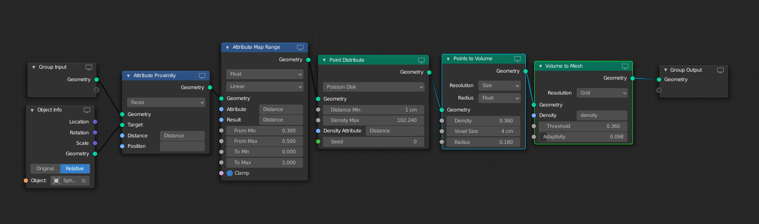

Points to Volume creates little volumetric spheres around each vertex, which could be useful for all sorts of dynamic effects like moving clouds or simple smoke.
Volume to Mesh can be used in combination with Points to Volume node or any other volume data to create a mesh in the same shape as the volume.
The Subdivide node offers a way to do a classic subdivision without smoothing like in Edit Mode.
The String Input node can be used to access an attribute by name and plug its result into any attribute input socket.
Last but not least, several mesh primitives have been added as nodes, so you can now procedurally create cones, cylinders, circles, cubes, spheres, icospheres, lines, and grids!
In addition to all those new nodes, more Blender attributes can be used as inputs such as UV layers, vertex colors, material indexes, face normals, smooth shading, and edge creases.

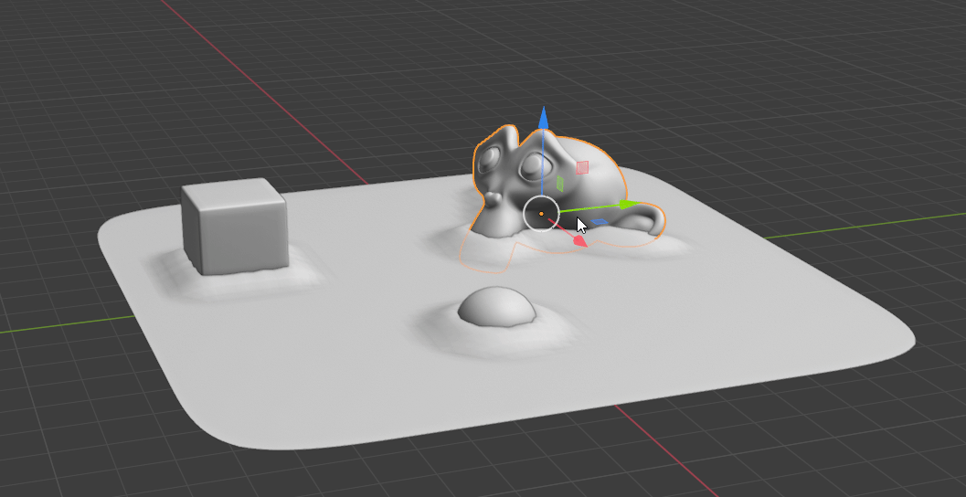

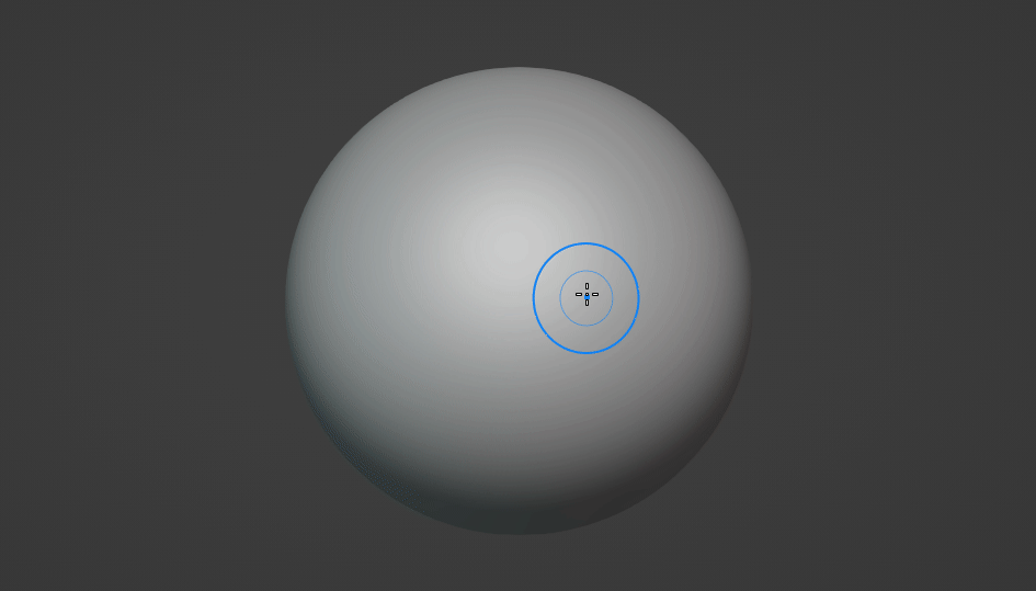

The Expand operator in Blender 2.93 is a more fleshed out version of the Mask Expand operator found in previous versions. It can be activated for masks using Shift+A (topology based) and Shift+Alt+A (normals based). For face sets it’s Shift+W and Shift+Alt+W. There’s quite a lot it can do, but it takes some getting used to. The extensive amount of hotkeys you can use while in the operator can be found in the status bar. It can use gradients (G), recursive patterns (R),  textures (Y and T), snap to face sets (Ctrl), and more!
I found that using a texture with Expand was confusing at first, but what you need to do is assign a texture to the current brush and then set the texture mapping of the brush to be 3D. The operator uses the current brush’s settings even though it is not part of the brush.

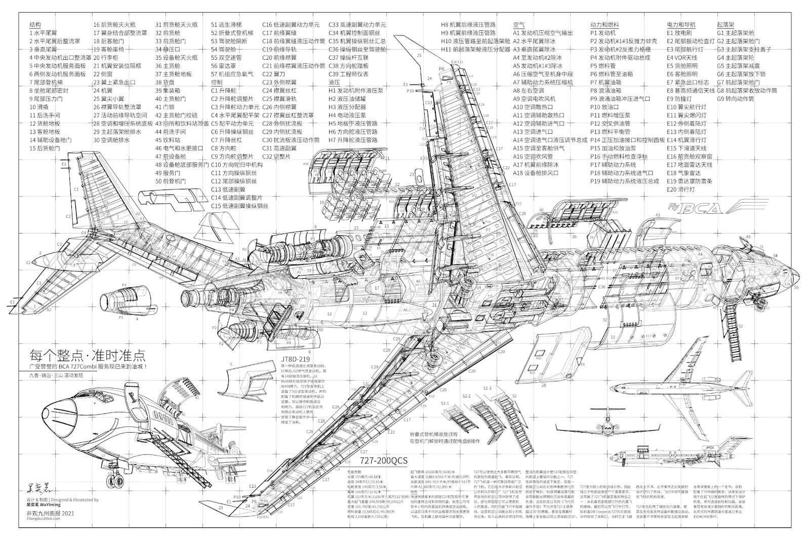

A new Line Art modifier for grease pencil objects generates strokes around an object or all objects in a collection. It’s important to note that this modifier calculates where the strokes should be placed based on the scene’s active camera, so you’ll need to look from the camera’s perspective in order for the lines to look correct.
(Image credit: ChengduLittleA)

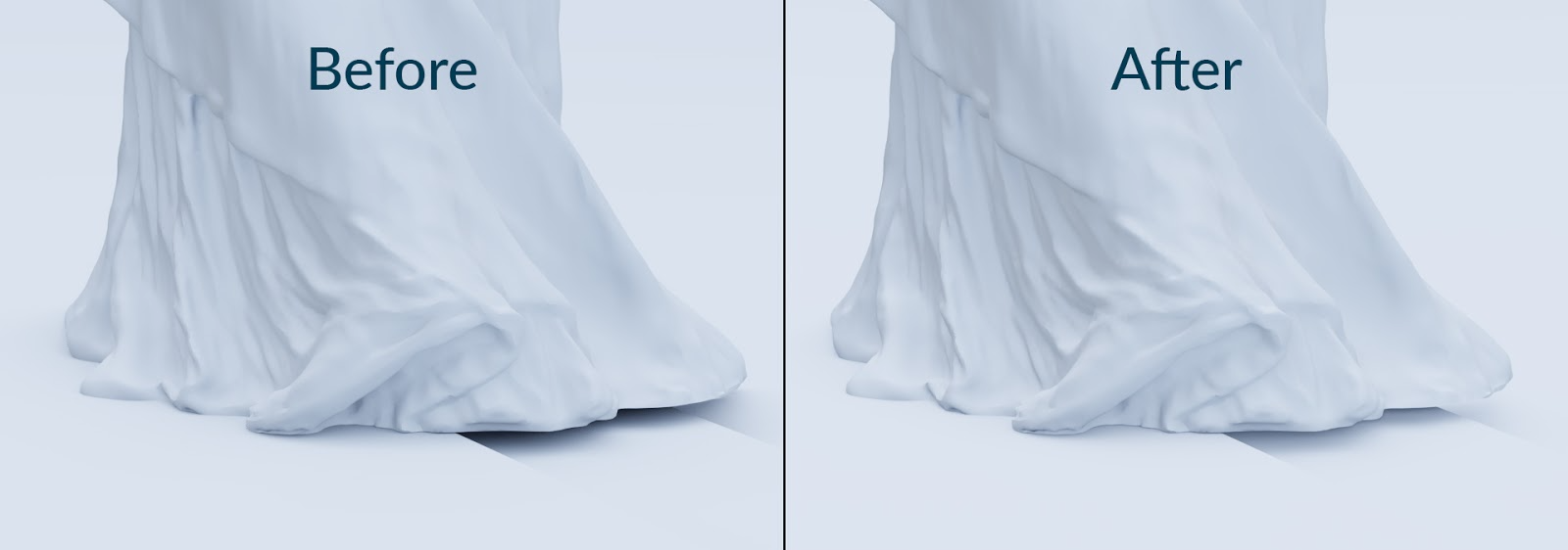

Ambient Occlusion was also refactored to look much more natural. The long list of improvements includes fixing noise on distant geometry, fixing overshadowing at grazing angles, improved performance, smoother results when using the Bent Normals option to sample the environment, Bent Normals support for glossy reflections, less overshadowing on thin objects, and it is now computed per BSDF rather than per material so mixed materials should look much better.

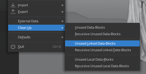

I have no idea when the Clean Up menu was added to Blender’s File menu, but now that its operators have been improved to better handle linked data, I’ll be using it all the time in the future.

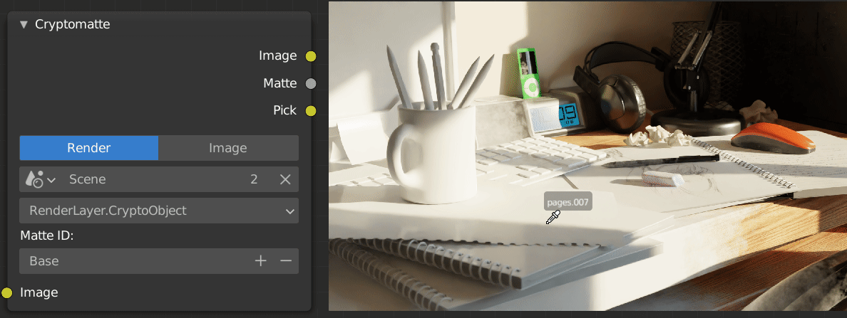

Over in the Compositor, the Cryptomatte node has been redesigned to be easier to work with. The matte layers are now extracted from the metadata of whichever image or render layer is selected by the node, so you won’t have to plug in a bunch of secondary sockets anymore. You can also pick Matte IDs directly from the regular image backdrop without switching to previewing the Pick output, and a handy tooltip will tell you which area your mouse is hovering over.
