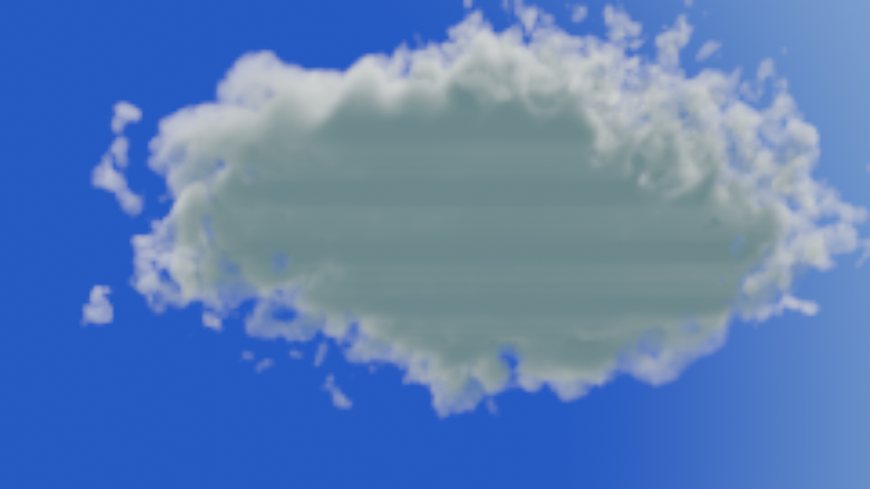

      When I look at a cloud from below, something like z-fighting occurs on the ground. This is probably due to my steep vector curve. But I want a flat bottom. Any idea how to make flat surfaces fluffier?

          Right! On the one hand flat, but at the same time fluffy. Maybe a bit like cotton. Actually, I’m already satisfied with the result, but unsightly stripes appear on the floor, which remind of a shading error.

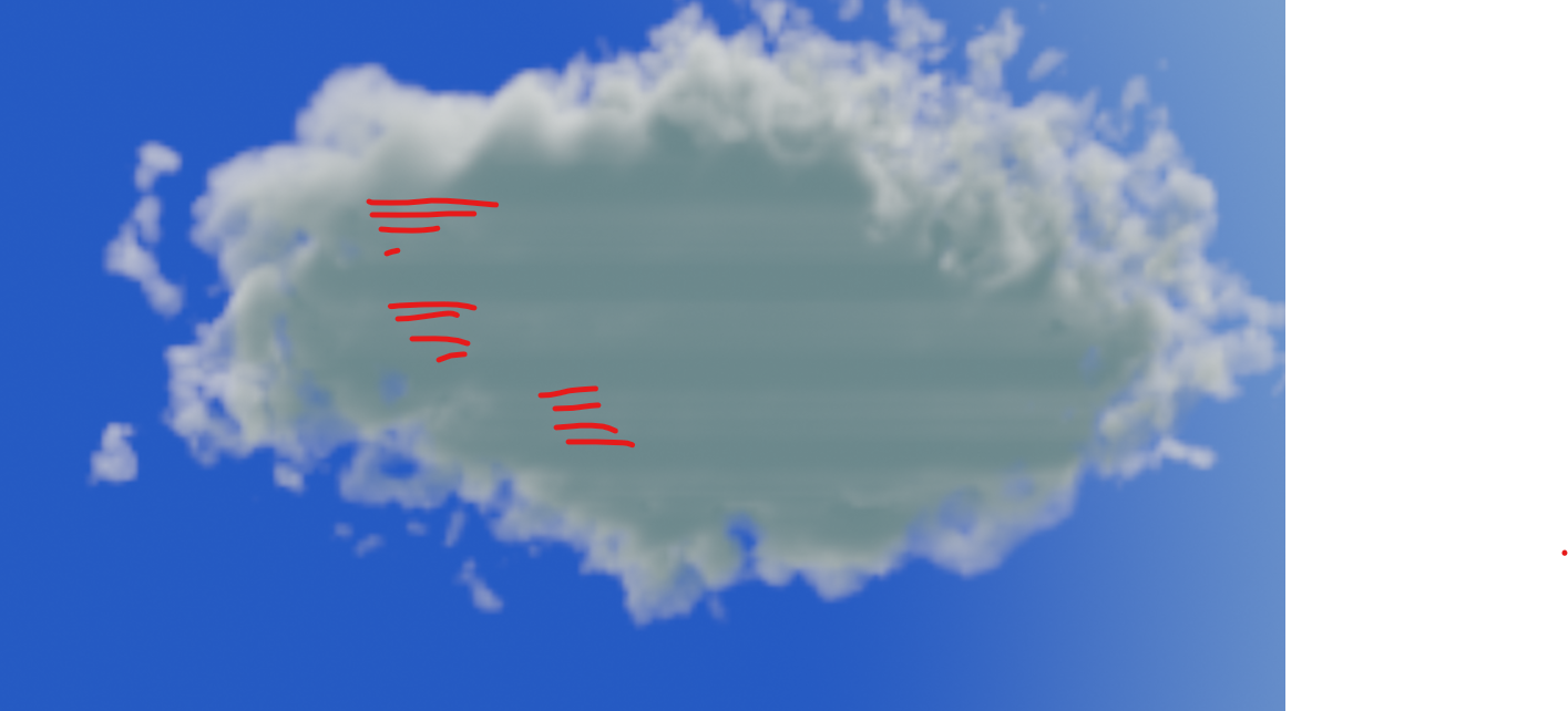

          Maximilian Erl
            Where I’ve drawn red, it looks like it’s flickering.

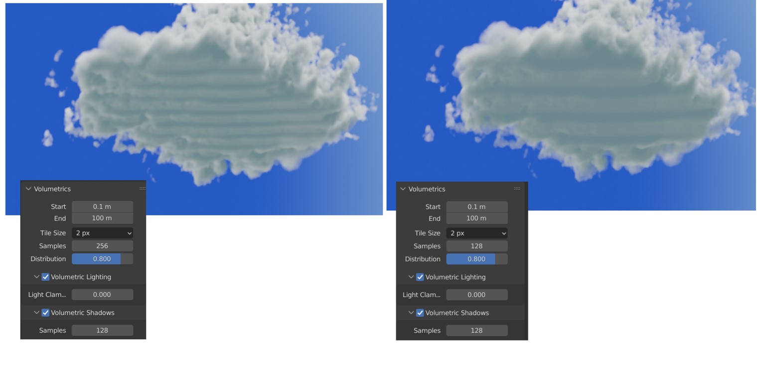

                        Thanks for the file @Max-Erl! Unfortunately I haven’t been able to figure out why the depth segmentation is so extreme in this example…I’ve spent 20 minutes tweaking a slew of render settings. The volumetric ones have the most effect, as you might guess:
                        But even with these “max quality” settings, the ridges remain very noticeable. I’ve never experienced them this bad. Maybe @spikeyxxx can troubleshoot this to better results, but my only theory is that the clouds shapes are too rounded and simplistic. Perhaps breaking them up with noise textures will hide the depth segmentation.
                        Apologies for a less-than-satisfying answer :/
