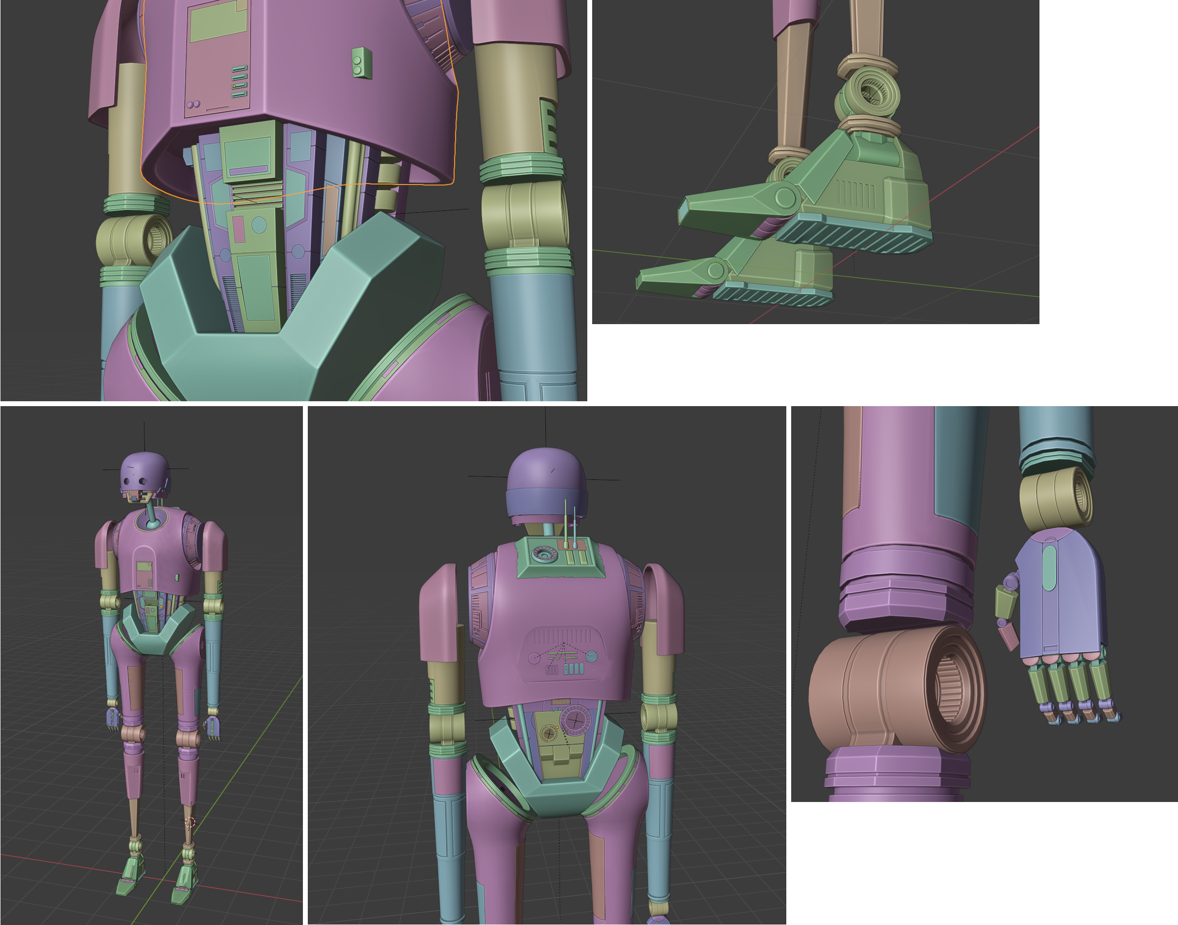

      I have been working for some time now on a personal project : to make of model of the droid K2-SO as realistic as posible, and then texture it with Substance Painter.
      It has been over a year know, and i have less and less time to practice Blender due to my job. That, and the fact that i became a mother July the 15th, my little boy leaving me almost no time to relax :).
      Nevertheless, i intend to continue my project until completion.
      Here is a collage of the work in progress.
      I would appreciate if you could give me some feedback / tips on the parts you judge the worst.

        Woah. I think it is looking good @koala
        The panels could probably stick out or in a little more sense they feel a little flat with their details. But I am no expert for this droid so maybe that is how it is supposed to look.
        I can’t wait to see this in substance painter.

          Thank you for your reply 🙂 i will try to make them stick a little bit out, or try with enlarged “grooves” on their side to make them more visible.
