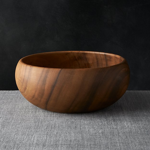

      Recently I’ve had the urge to create a wooden bowl. Sculpting is quite trivial. There are various ways to apply a wood-grain texture, but is there any way to make the grain variations accurate (i.e. as if carved from a single wood block) ? It doesn’t seem possible with the texture mapping/painting techniques I’m familiar with. Tutorials I’ve found on carving just apply displacement to a surface pattern.  I may need to put on my “problem-solving” hat.  One nice reference:
