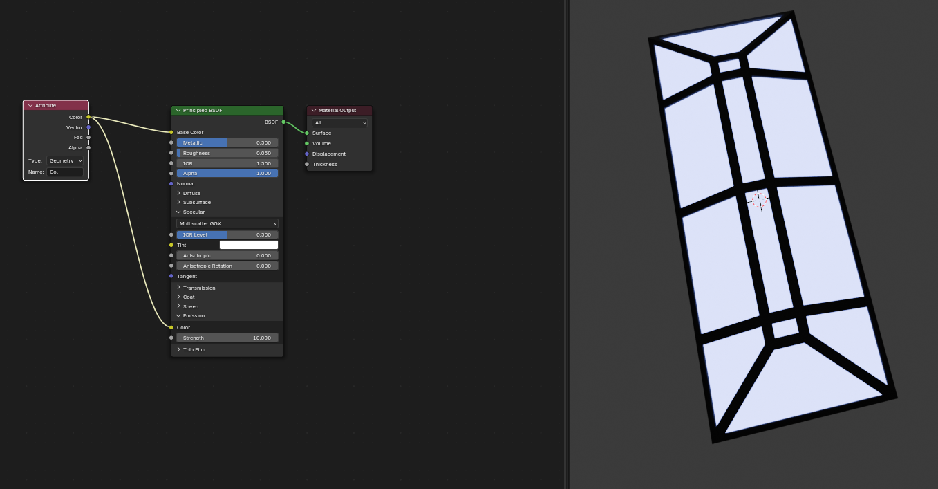

      Currently I’m a bit stuck on how to get reflections to show up the way that Kents are in the video. Currently everything is pretty dull. Not sure if this is related, but the old specular settings on the principled BSDF are no longer present, and I seem to have to plug the color attribute into the emission color to get things to show up in the correct color.
      This is what I have so far:
      #91879
        Hi @jammingammon ,
        Specular has been re-named to IOR Level and you have that at 0.5, just as in the Tutorial. Metallic at 0.5 is also the same and the Roughness.
        So the only thing would be to get rid of the Emission; remove the Color Input of the Emission and set the Color to black (or the Emission Strength to 0).
        #91880
          Also be sure you’re in material preview or actual render view and most importantly, that there’s a world HDRI so you get stuff to reflect to.
          #91881
          jammingammon
            Thanks guys. Seems to be working much better now. I think it was a combination of having the color input plugged into the emission, and not having a world HDRI. Before when I set the emission color to black, everything was flat and dark, but enabling the HDRI seemed to fix that.
