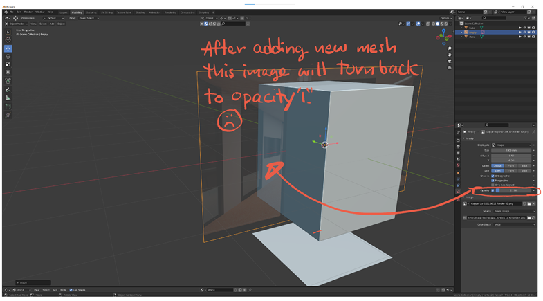

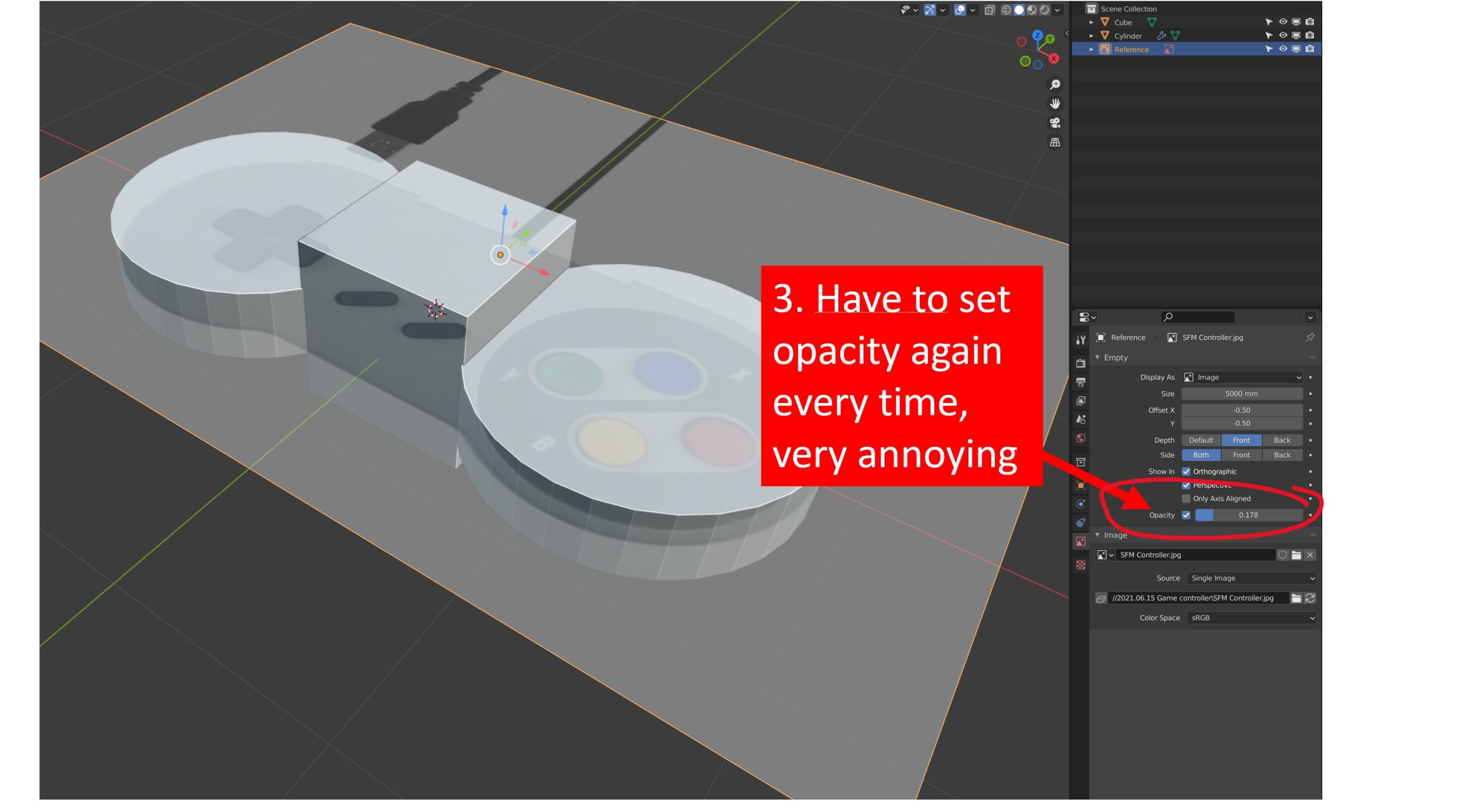

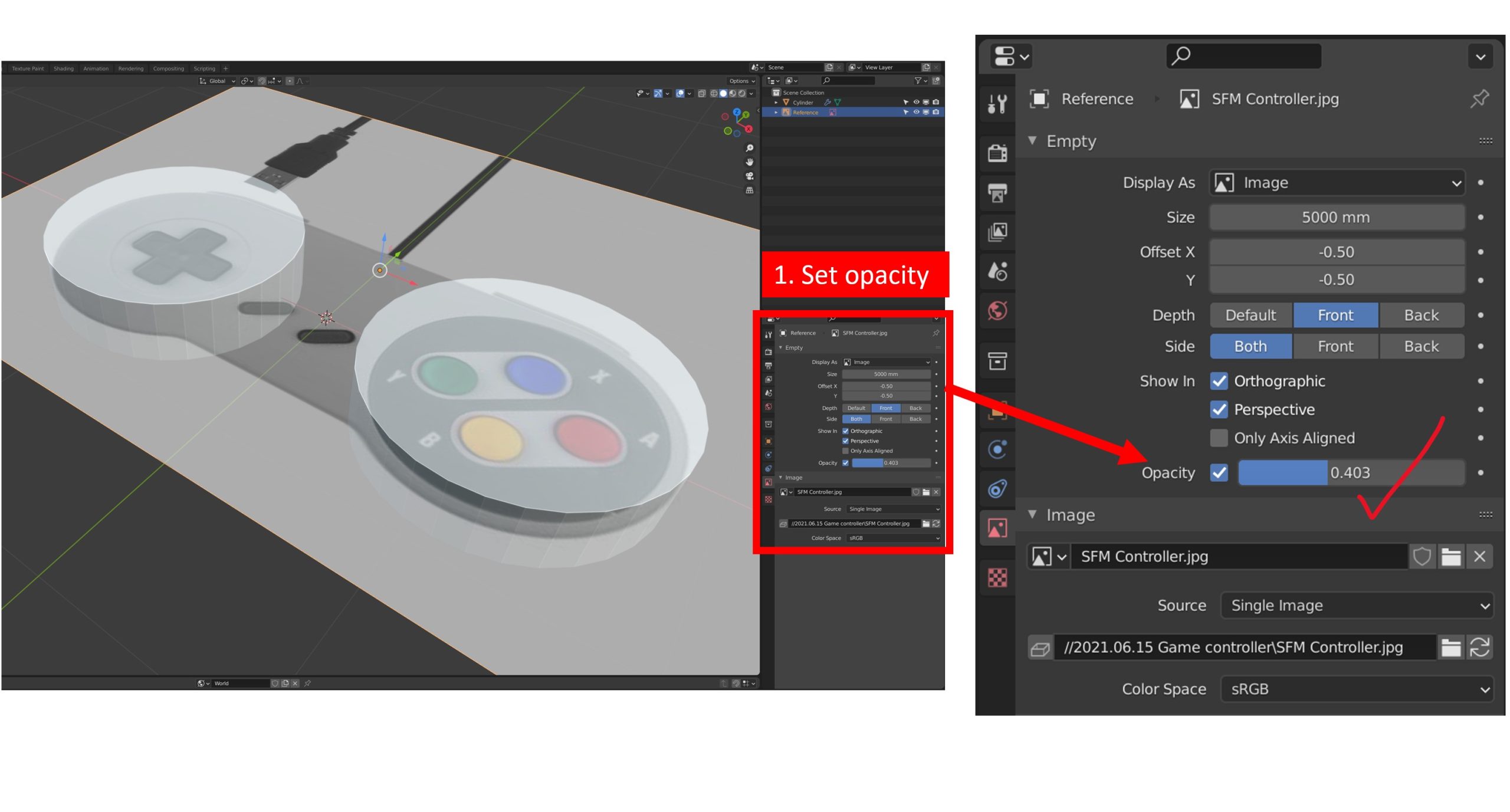

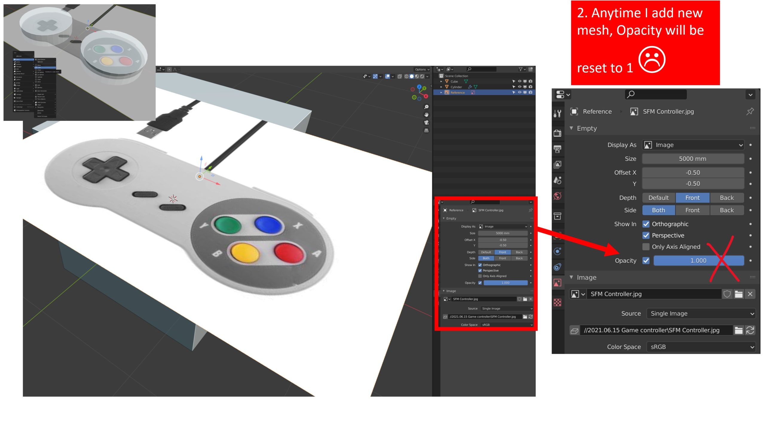

      Anyone can tell me how to fix reference opacity value.
      I experience this annoying behavior for a while. After I set opacity I would like to use, anytime I add new mesh to model, image opacity will automatically reset back to “1”.  So I always need to come back to make it transparent again and again.
      Thank you for your help.

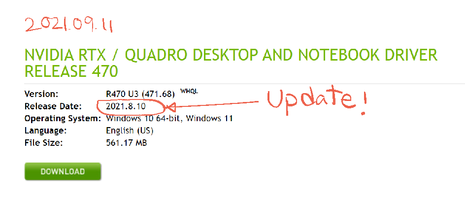

                        Hey @kwin ,
                        Don’t rely on Windows updates for GPU drivers. The drivers installed by Windows are usually not the latest drivers and only a basic version for your hardware to work with Windows.
                        Notice the word ‘BEST’, when using software such as Blender the ‘LATEST’ available recommended driver is advised.
                        You could check for driver updates every day for 5 years and get the same message, yet the drivers direct from NVIDIA are usually updated at least every quarter (4 times a year).
                        Go to NVIDIA website look for support and driver updates, and download the latest recommended driver for your GPU.
                        If you go to Windows Device Manager and look at the properties for the GPU Driver you will see some info like this:
                        You will probably see the date some time in the distant past. You could also search online for a list of drivers for your GPU. I have known of this to happen, where the driver is several years old and an early driver from when the GPU was first released.
                        #69012
                        Kwin K
                          Hi Adrain
                          Thanks for trying to help me here again. I follow your suggest go to Nvidia website and update latest driver. Also I just update Blender to version 2.93.4 but problem still remains.

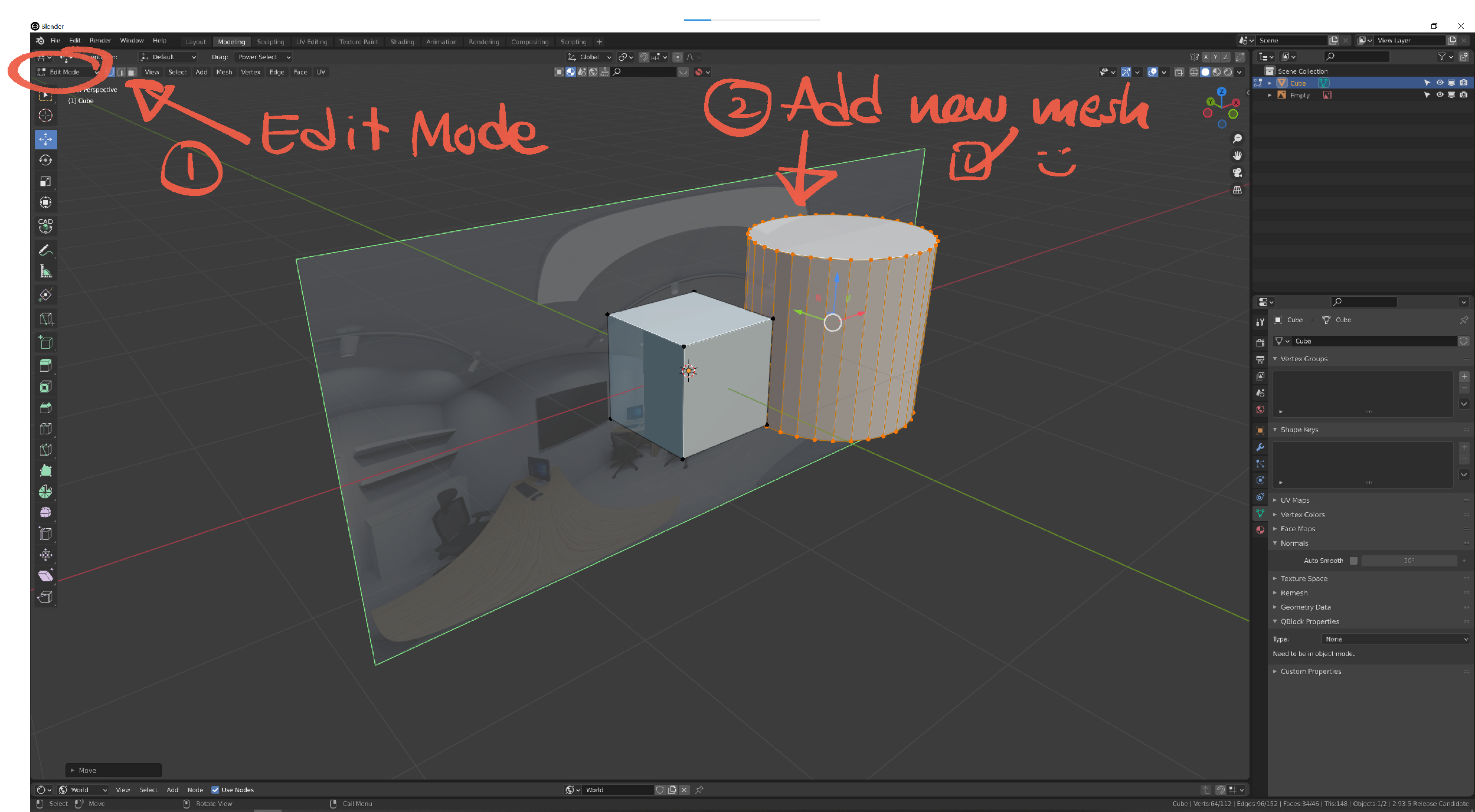

                              @kwin I do not know of any setting that could cause this behavior, but just to make sure, try to Reload Factory Settings.
                              Did you try key-framing the Opacity as a workaround?
                              Or adding new Meshes in Edit Mode (you can always separate them later if you wish)?

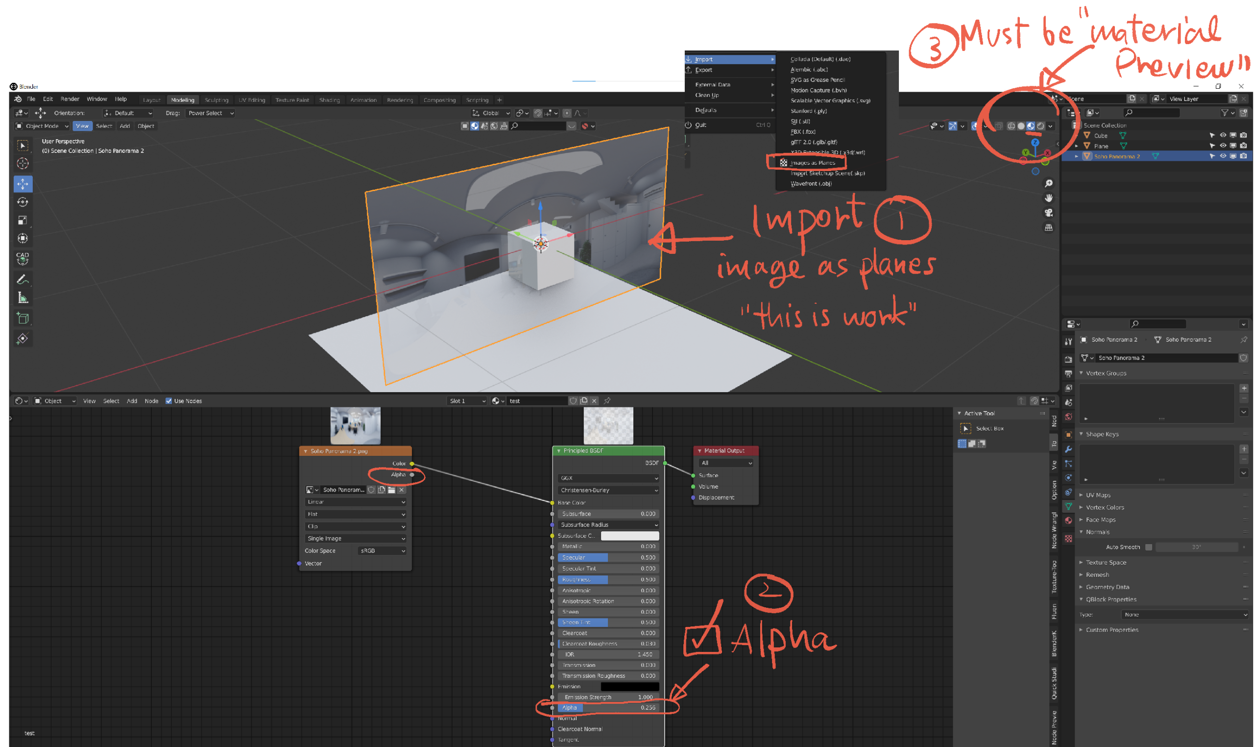

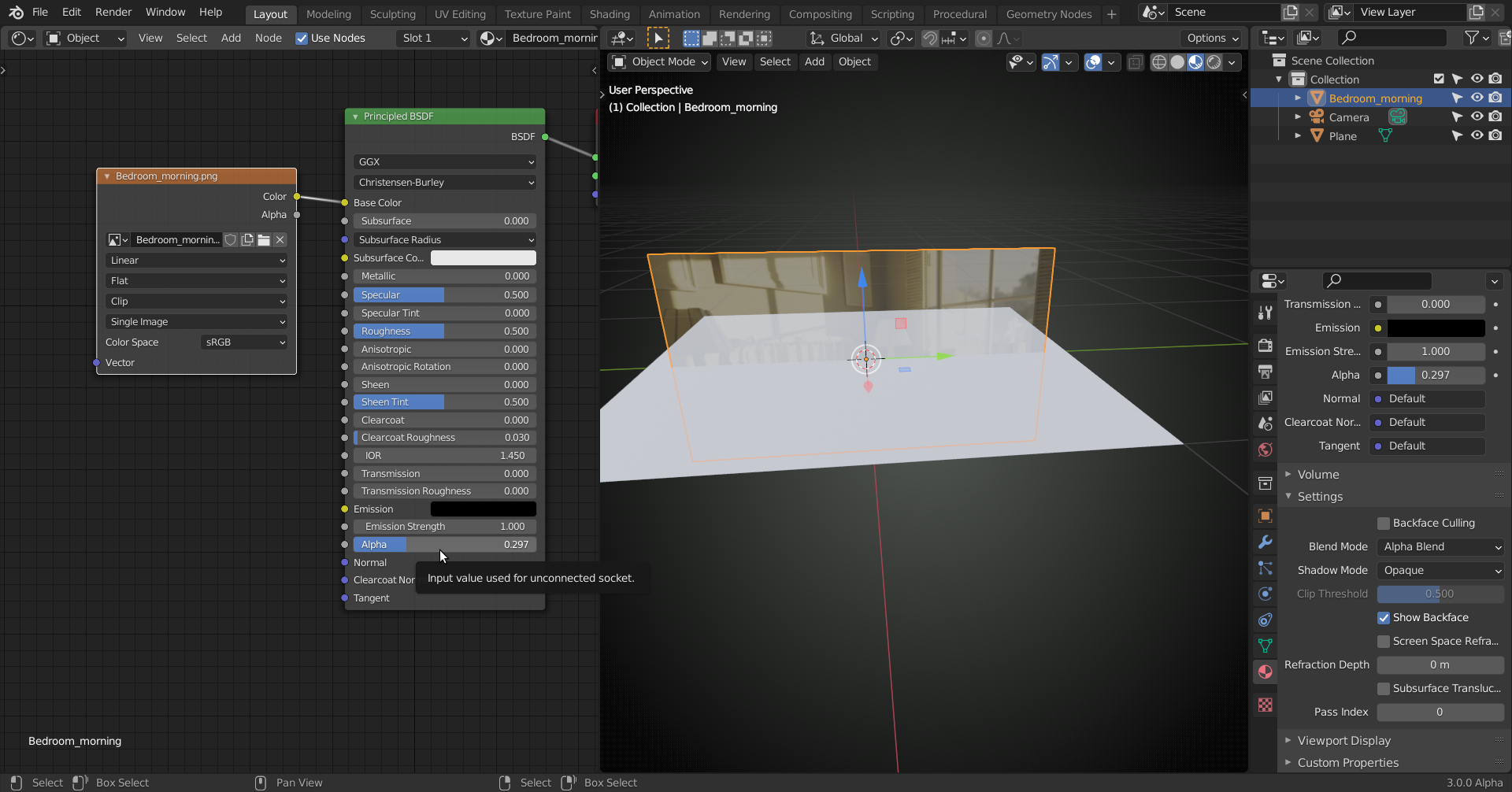

                              And yes, you can enable the Import Images as Planes addon and set the Alpha in the Material:

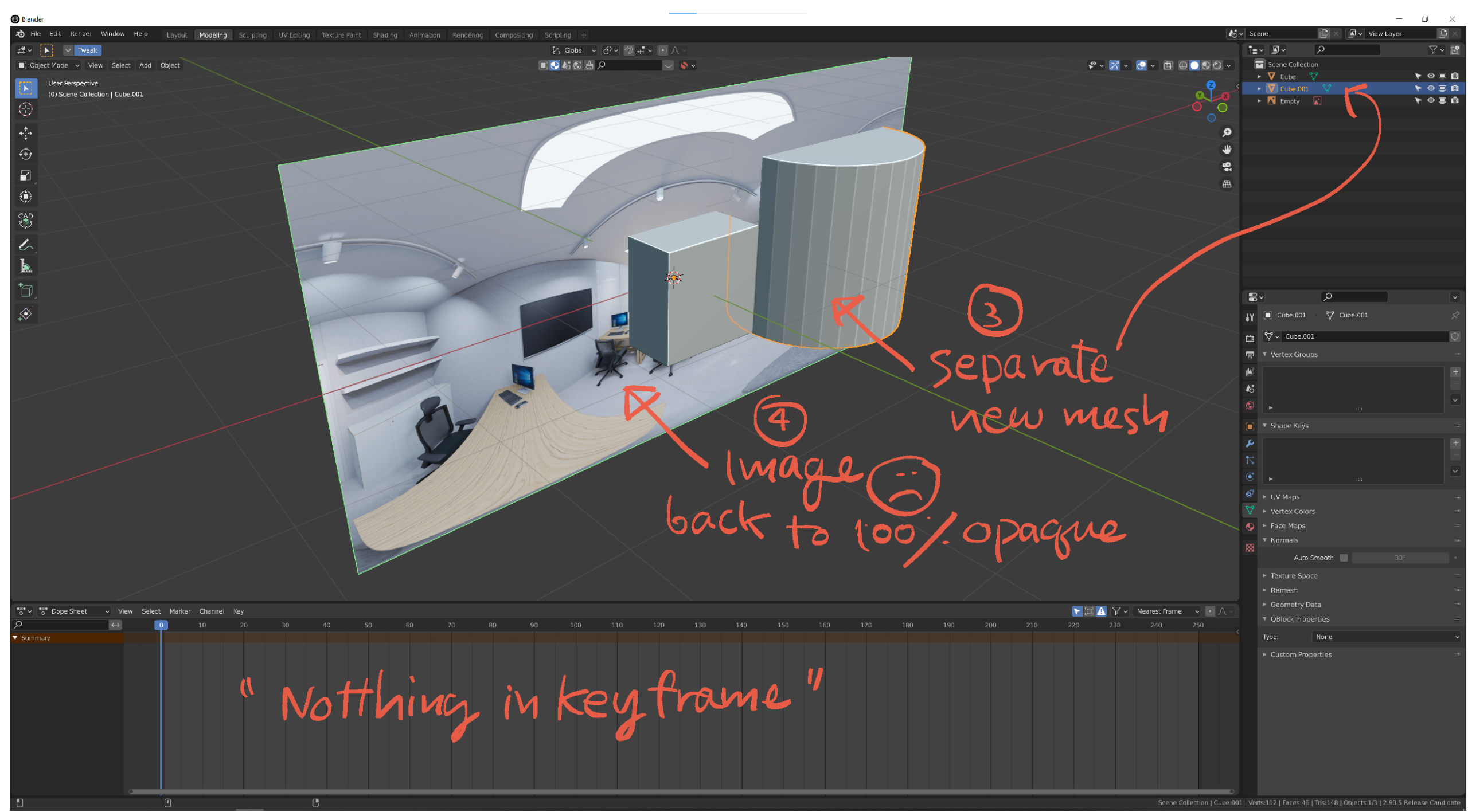

                                1. Solution 1 > adding new mesh in Edit mode and separate later.
                                It seems to work but when I separate new mesh to new object image will turn back to full opacity again!
                                I have checked key frame, there is nothing.

                                  2. Solution 2 > Import image as plane
                                  Thanks for this tip. It is work. I just learn how to use alpha.

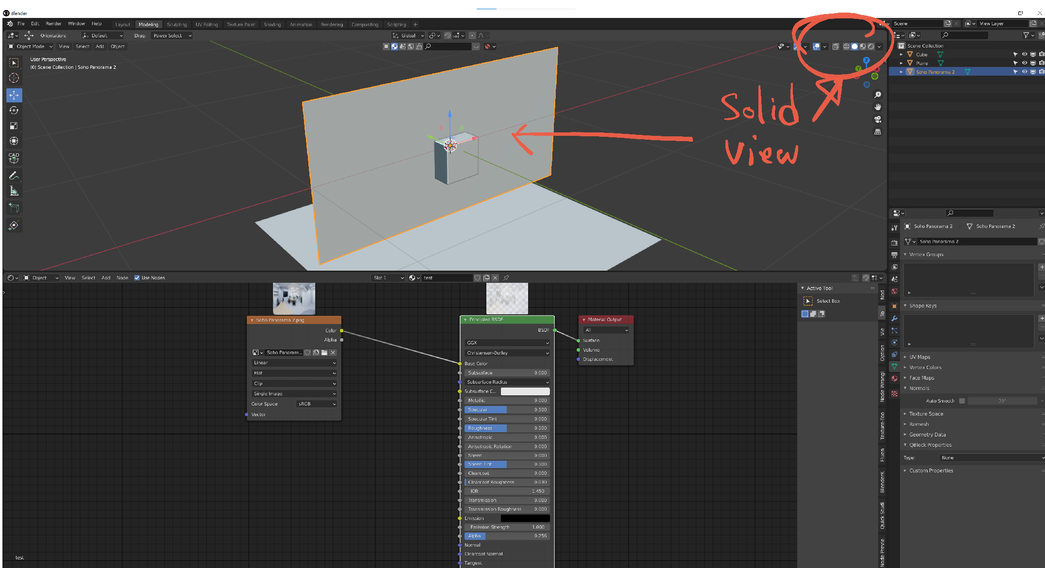

                                  There is only limitation is I have to model in “material preview” viewport display. Cannot see image in “solid view”
