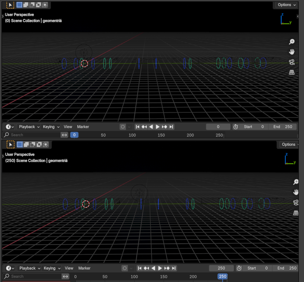

      Hello, I have a question. I don’t know why my frame0 and frame250 aren’t the same. I’ve checked the nodes several times and thought it was fine. These are my frame’s images:
      frame 0       /        frame 250
      Thank you in advance. Great course!!

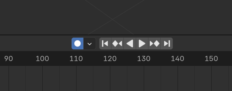

          Gonna hazard a guess and say your auto-keying was enabled, so any changes you made were recorded and automatically keyframed. In the “Timeline” window, if this record button is active, then auto-keyframing is on. You may have moved ahead in the timeline at some point, continued to edit, or work, and Blender automatically keyframed those changes.

            Hi Kepa @Kepa ,
            My guess is, that it’s because your Camera is animated and in a different Location in the two Frames. The Shader Nodes look correct to me, so looking at the Frames from the side, for instance (not through the Camera), they should be the same.

                Hi @Kepa ,
                No, those Instances have different Shading, because of the Object Info > Random Socket.
                Like I said, the Frames are the same:
                Everything is as it is supposed to be.

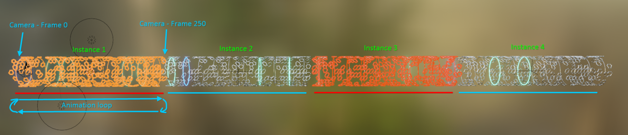

                      Hello again, I have been analyzing it and indeed, the node “random” does give a different value to each texture.
                      I have an answer to what is happening but in that case I cannot do a seamless loop, because each instance has to be identical to the previous one, in shape and color. The view from an external point of view (not from the camera) shows us that frames 0 and 250 are the same but what has to be the same is the 1st instance and the 2nd (and the following) so that when the camera arrives at end of the 1st instance (and end of animation) the 2nd instance is being viewed, restart the animation, return to its initial position (to frame1) and it seems that nothing has happened.
                      Thanks for everything, I will keep looking for a way to do it.

                            A sequence of colors must be achieved that changes from frame 0 to 250, this will be constantly repeated. 1 and 250 will be different, yes, (and, as you said, each one of them) the ones that have to be the same are 0 and 250 and thus ensure that we start the same sequence again. Therefore, if there was a way to make that color sequence apply to all instances, when you start seeing the 2nd instance and restart the animation, we would see the 1st instance (which would be identical) and thus the jump would not be noticeable.
