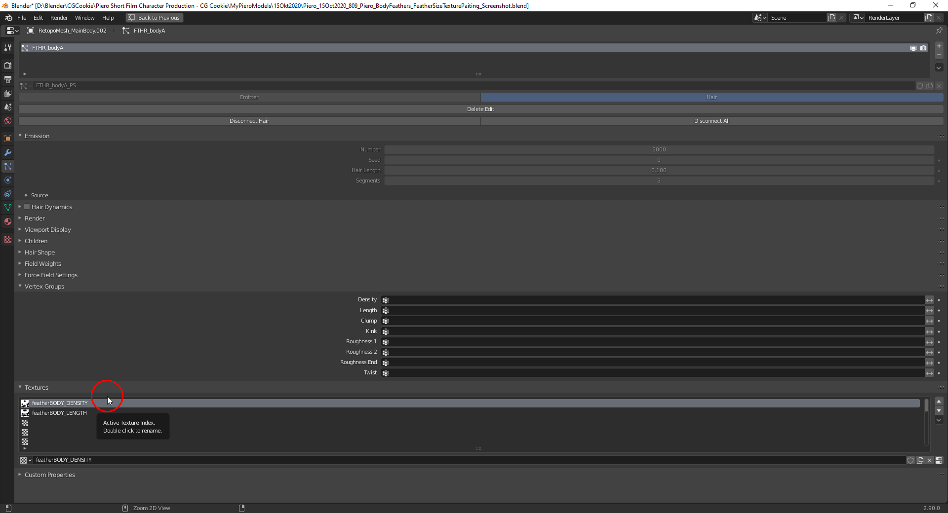

      In Blender 2.90 it’s the same as in version 2.66.1: The density setting for texture controled hair growth only works with “Children Hairs” turned on, best in “Interpolated” mode. How can this be explained?

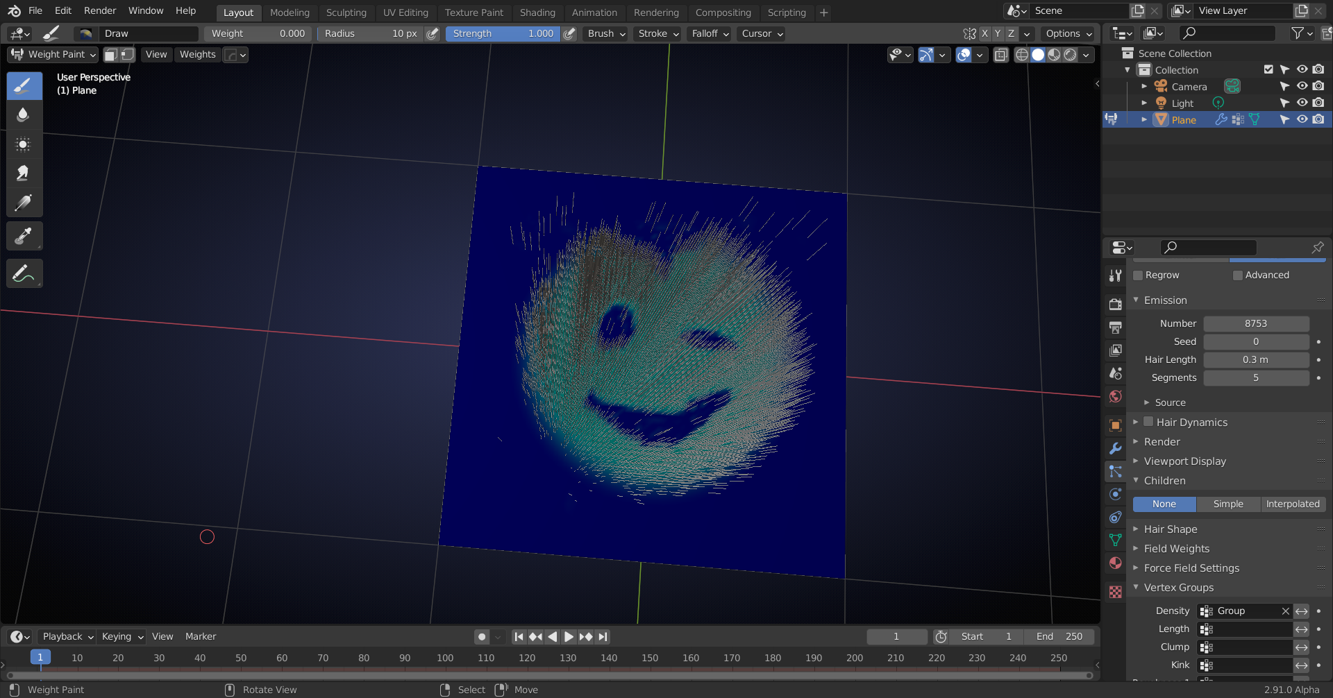

          @spikeyxxx I’m using a texture for controling the “Hair Density” and not a “Vertex Group” (please scroll down a little bit further in the “Particle System Tab” 😉):
          PS: I like your hairy Smiley! Or is it a pumpkin 😉?

            Sorry, still don’t get it:
            PS: it was supposed to be a combination of a smiley and a pumpkin 😉

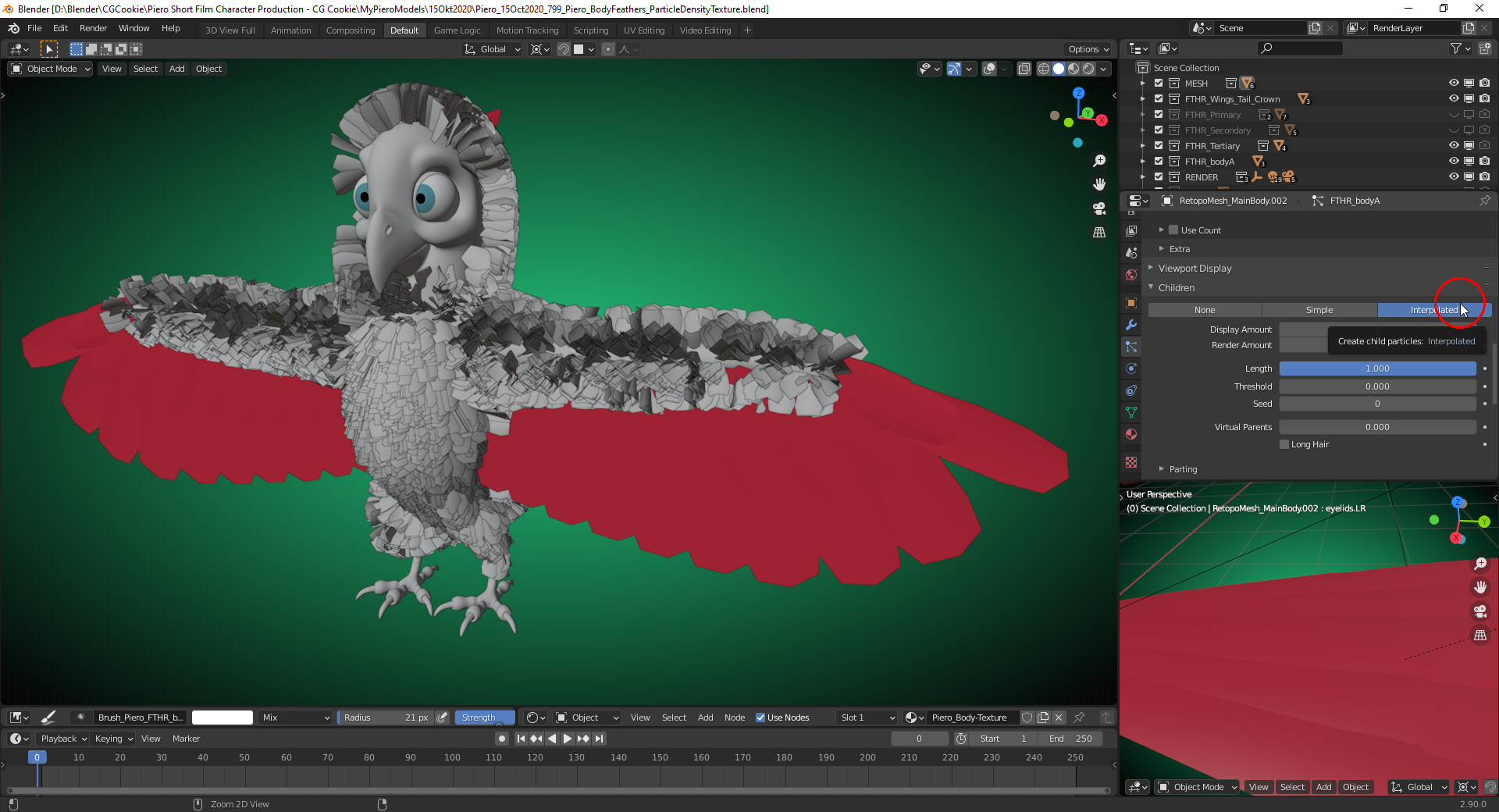

            #60889
            Ingmar Franz
              @spikeyxxx Please watch what  @theluthier says and shows from 16:50 to 17:20 in the video. I was facing the same problem.

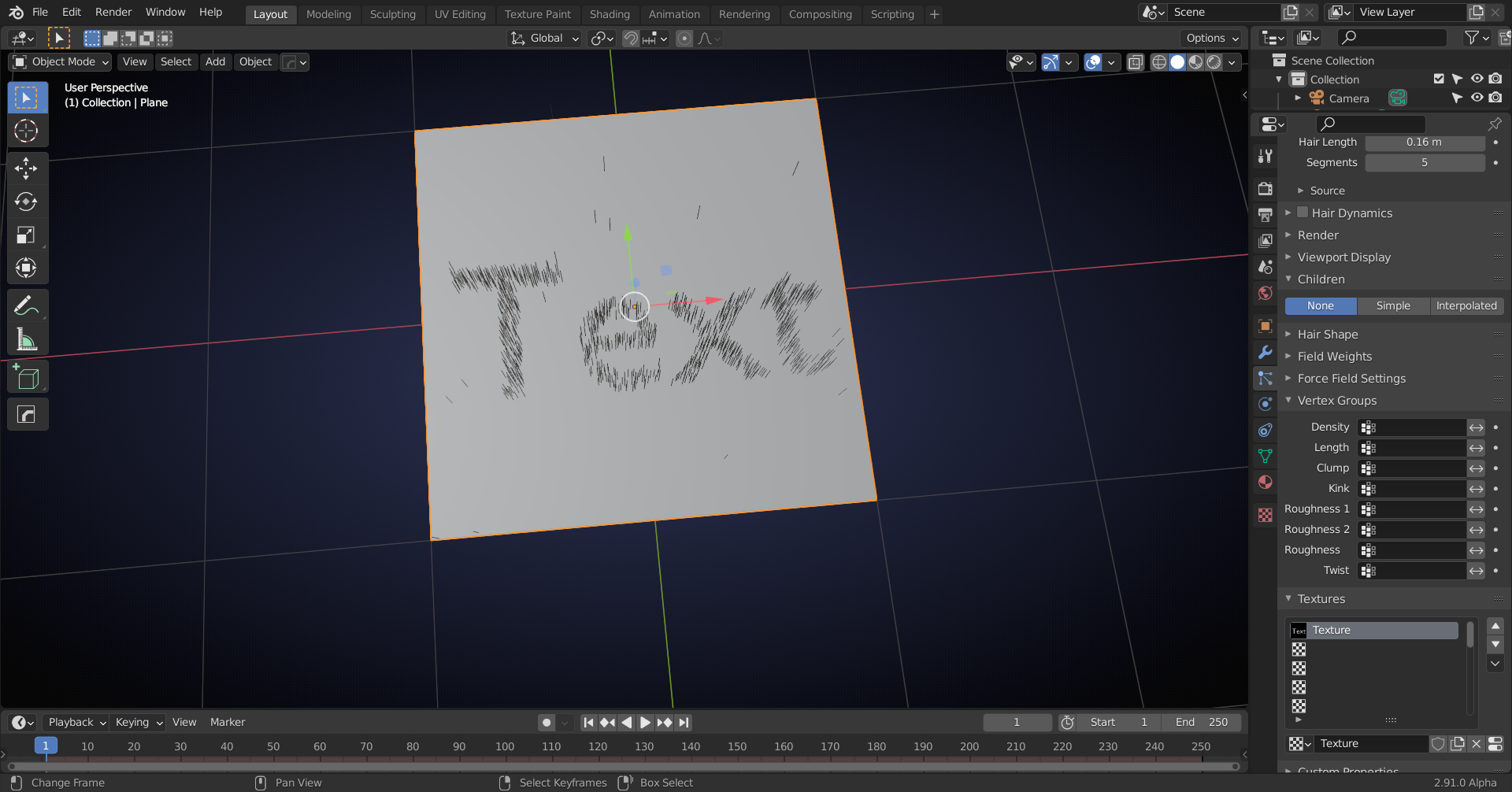

                Very strange! Is that a bug?
                Don’t seem to be able to reproduce this with a simple example:

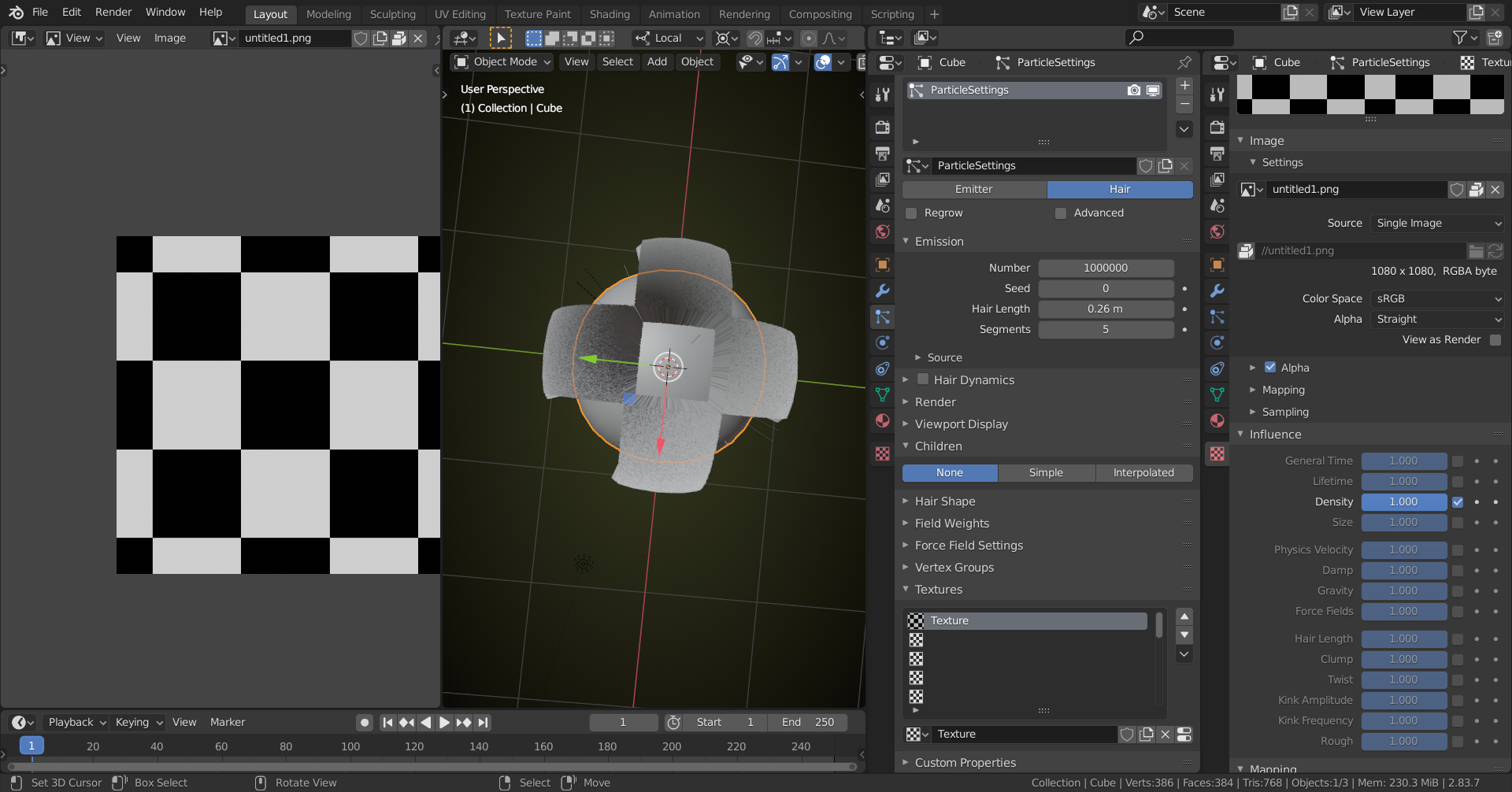

                #60891

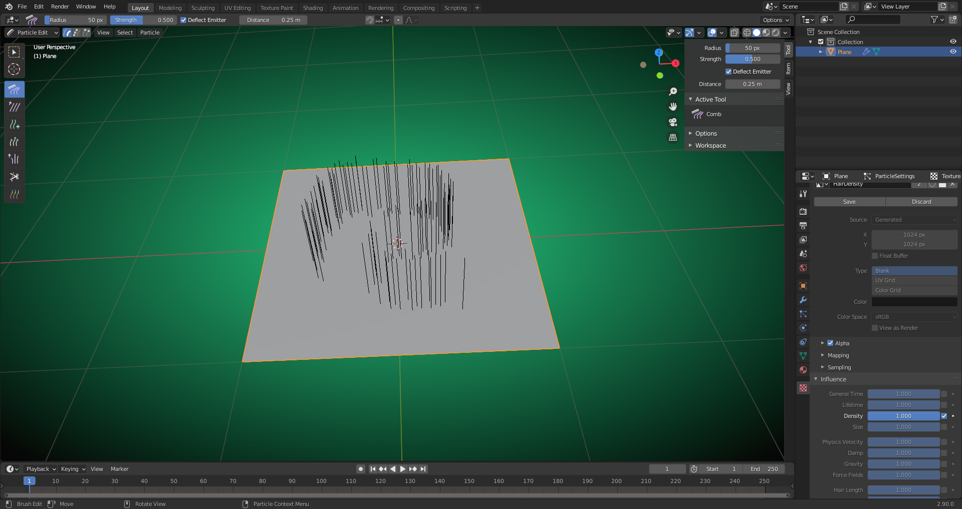

                Ingmar Franz
                  @spikeyxxx Really strange! I get the same result with that simple example:
                  Could the combing of hairs  or the addition of shades of grey in the “Hair Density Texture” have an influence?

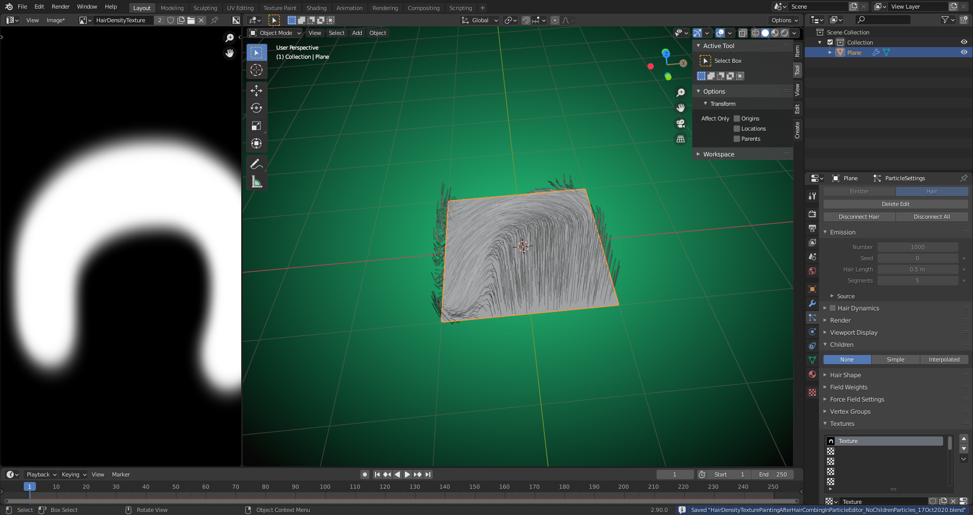

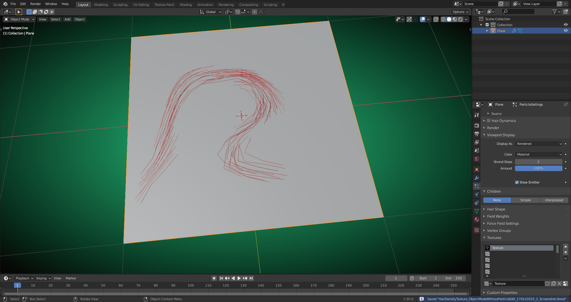

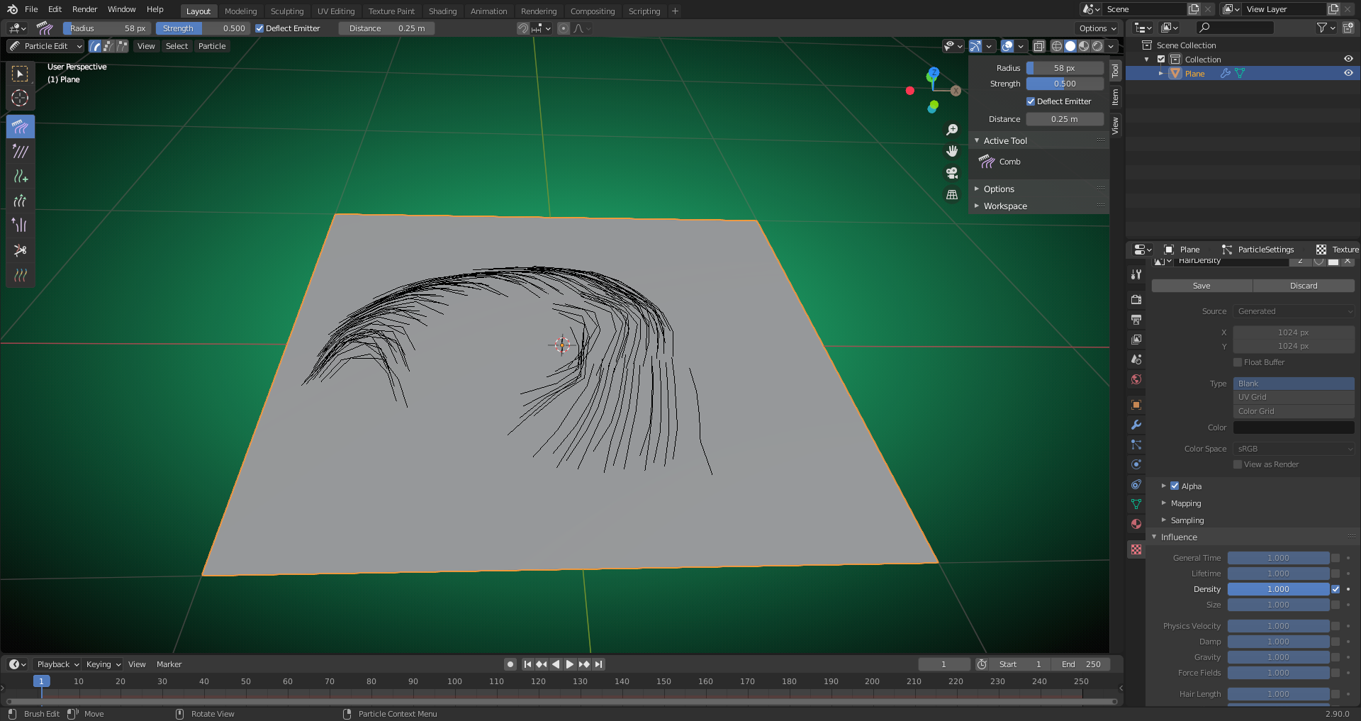

                  #60892
                  Ingmar Franz
                    It’s still working without “Child Hairs” after combing:

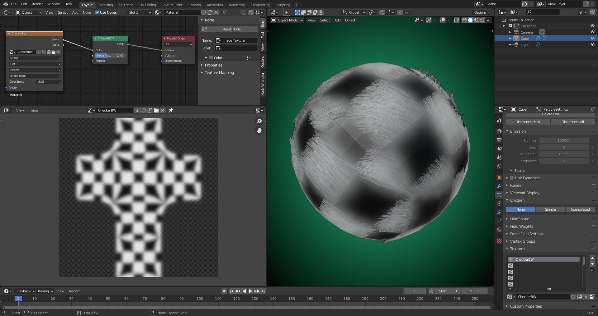

                    #60893
                    Ingmar Franz
                      And it’s also still working with a blurred texture created for introducing shades of grey:

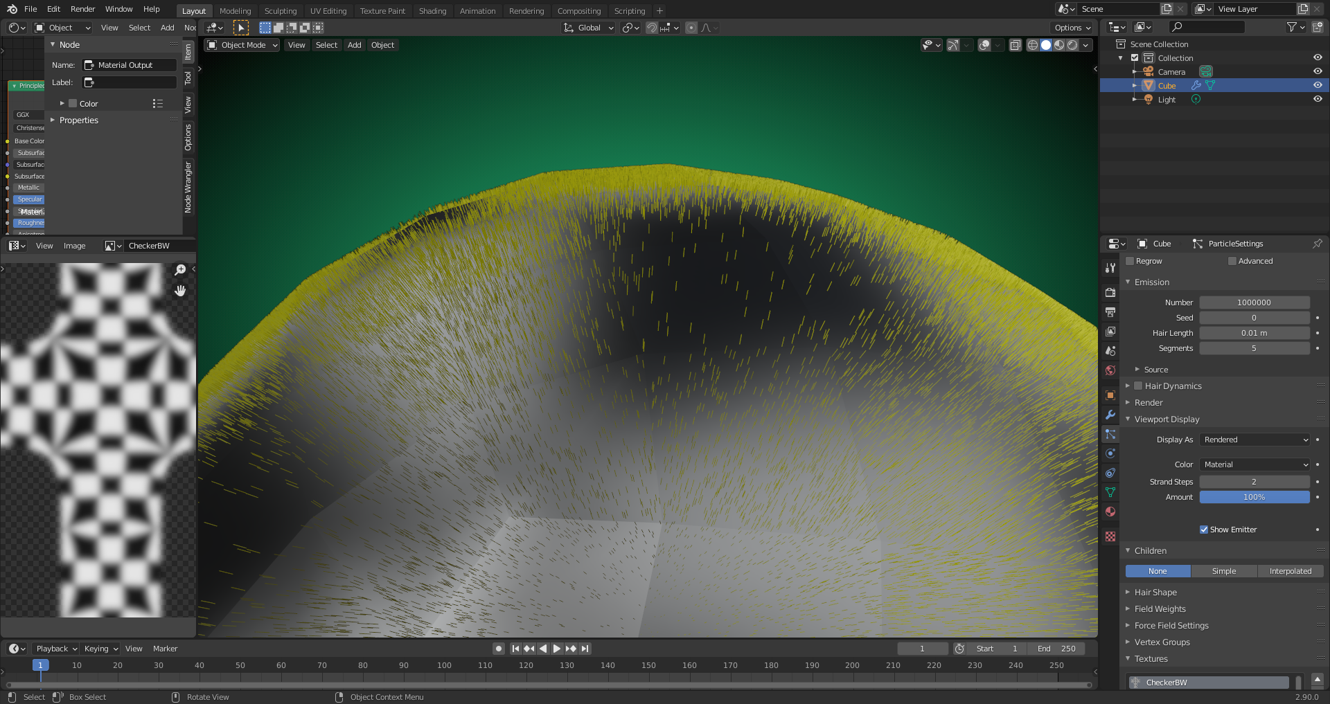

                        #60895

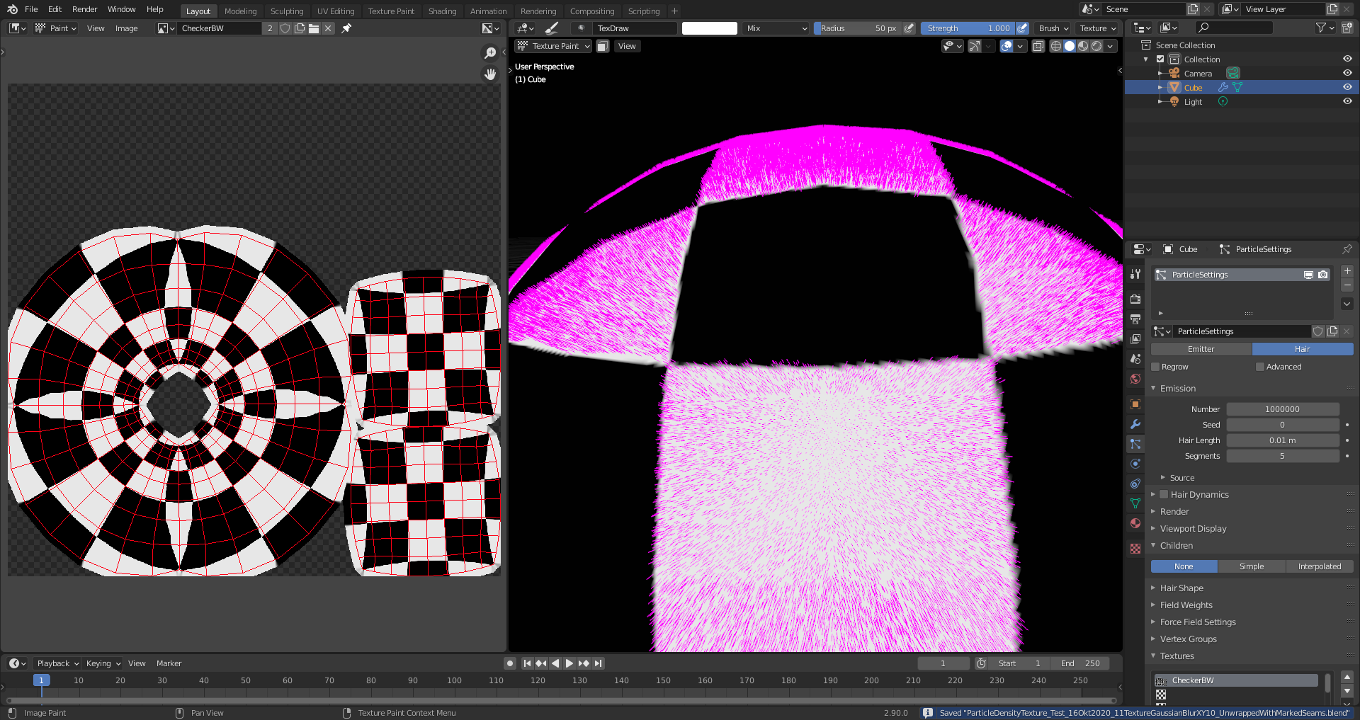

                        Ingmar Franz

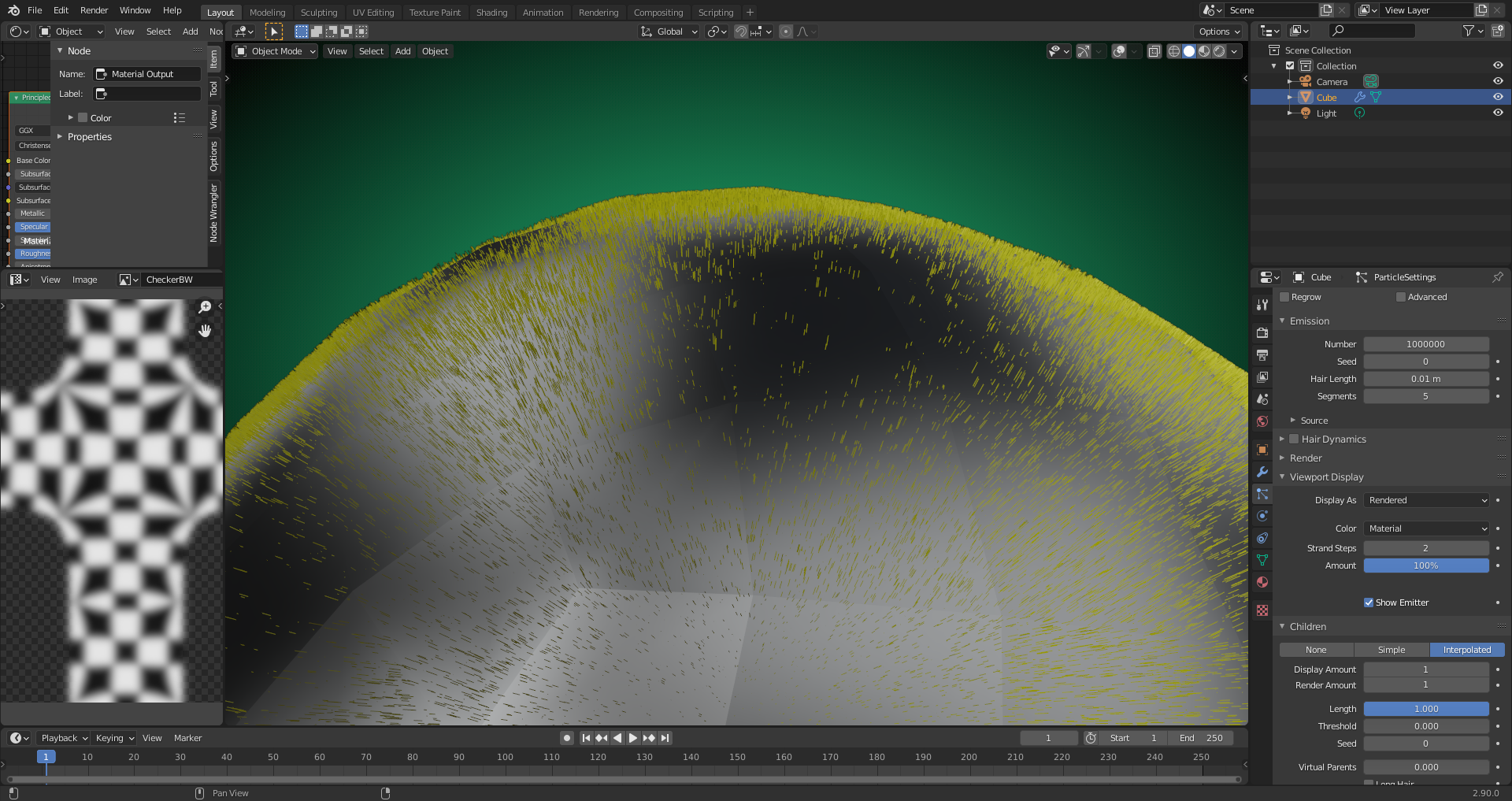

                          And a test with 1 million hairs:
                          1) No children
                          2) Children interpolated (children count set to 1):

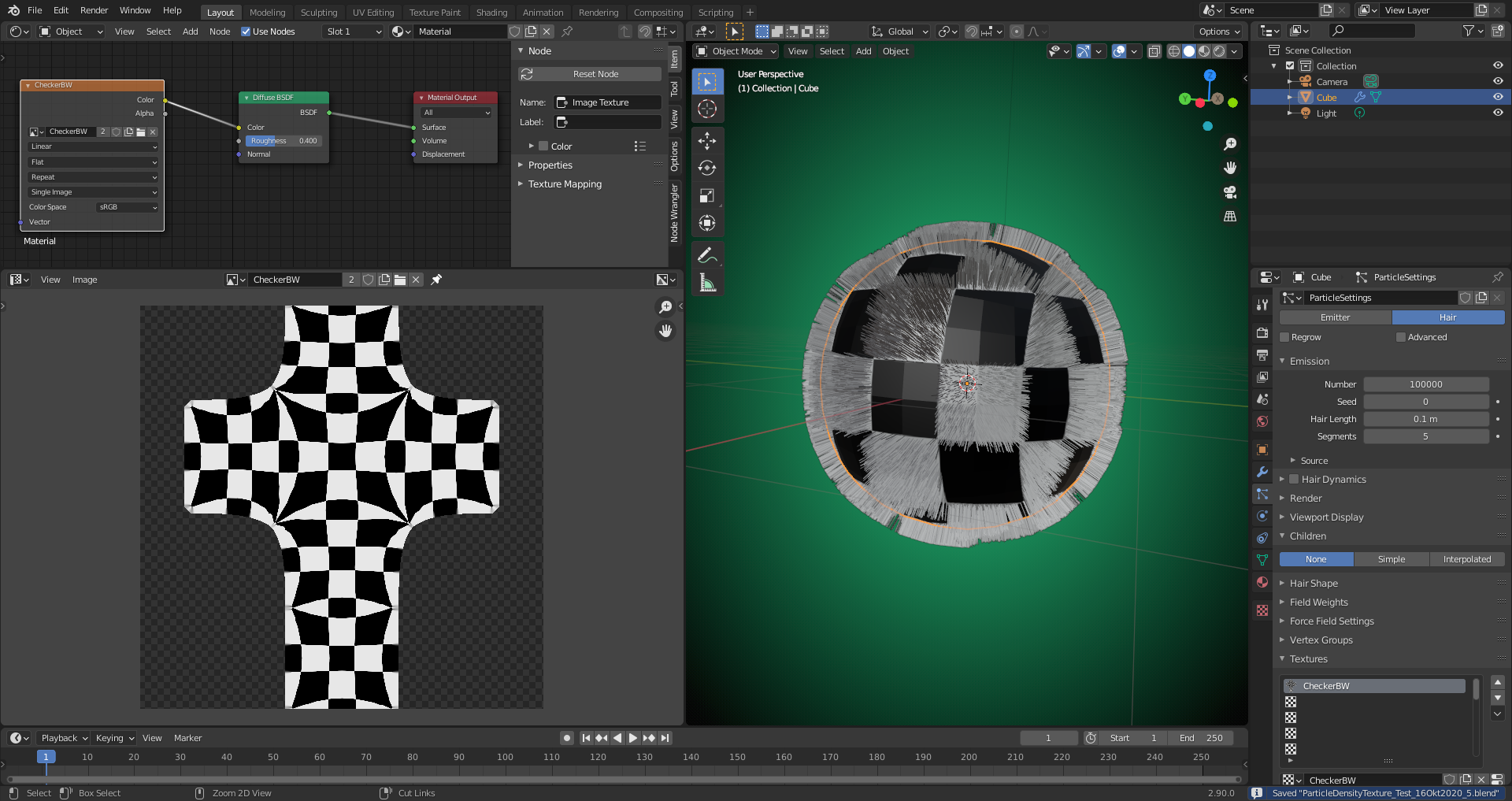

                          #60896
                          Ingmar Franz
                            Controling the “Hair Density” with a texture but without using “Hair Children” also works on that simple mesh if I split the “UVMap” into “UV Islands”:
                            Maybe it’s the complexity of Piero that makes the use of “Children Hairs” nececessary for the “Density” setting to work.

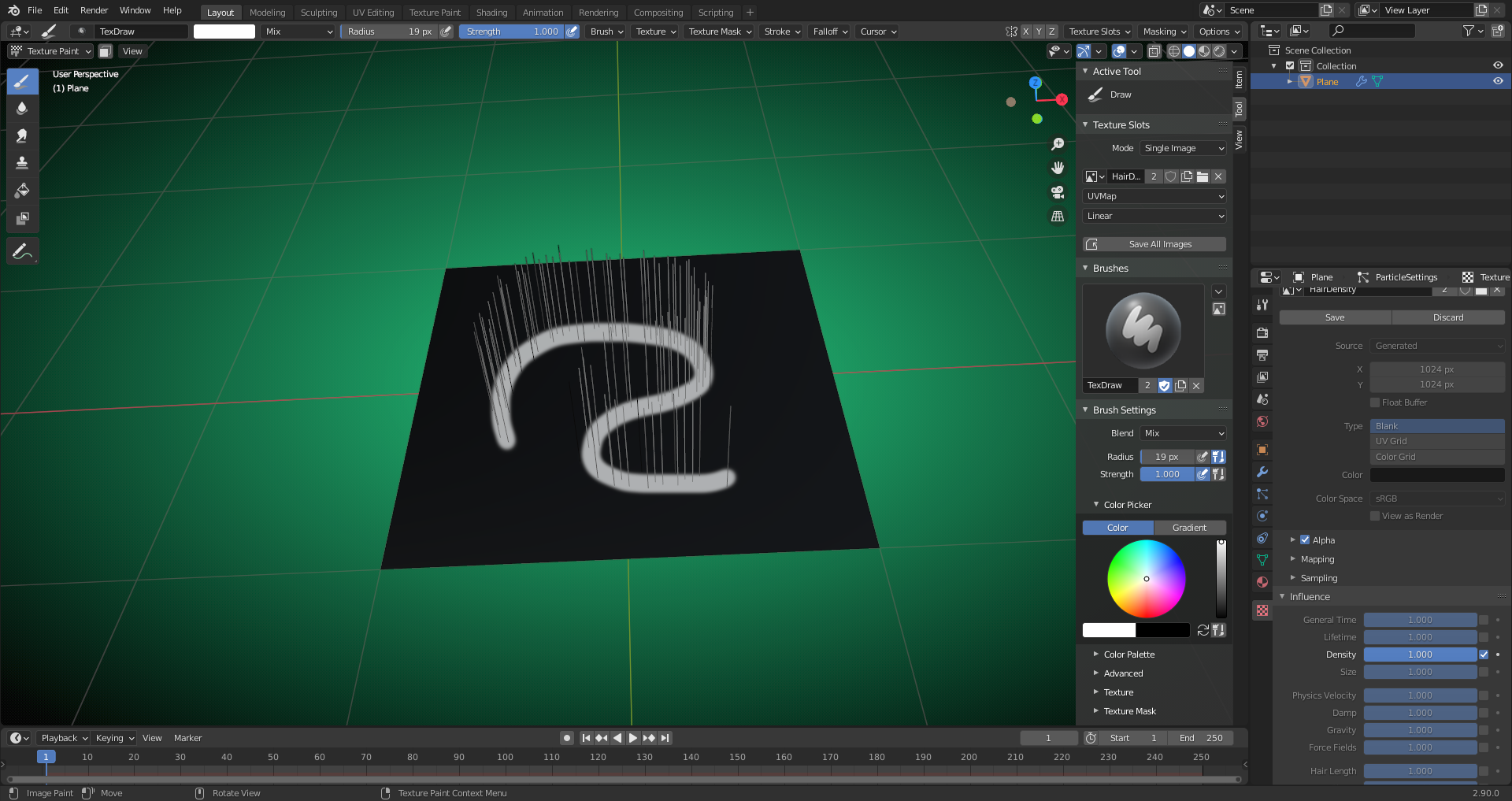

                              So, now I’ve found at least partially out, why Blender uses the “Density Setting” for an “Image Texture” only if there’re “Child Hairs” activated:
                              1) If I paint and assign the “Hair Density Texture” before combing or otherwise manipulating the hair in the “Particle Edit Mode” the hairs will grow with “Density” checked in the “Influence Settings” of the texture only in areas that aren’t 100% black. No “Child Hairs” are needed! This view is the same in “Object Mode”, “Texture Paint Mode” and in “Particle Edit Mode”

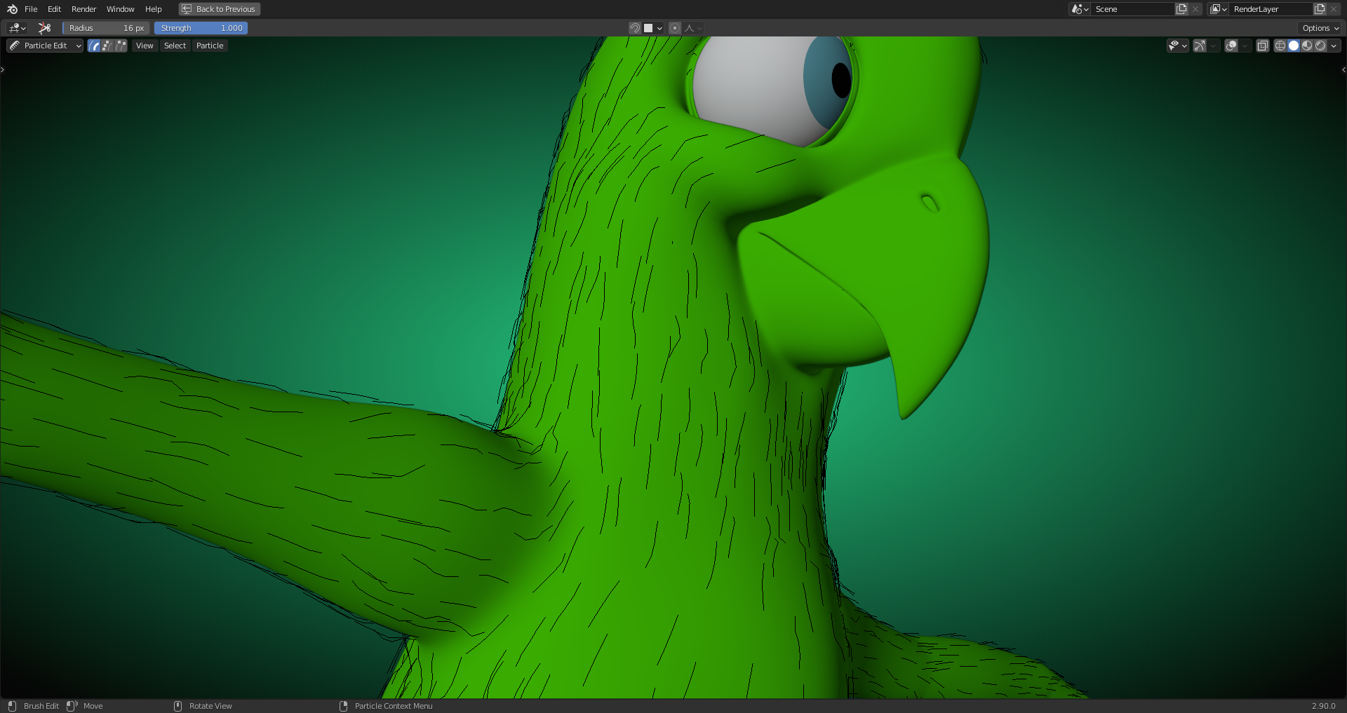

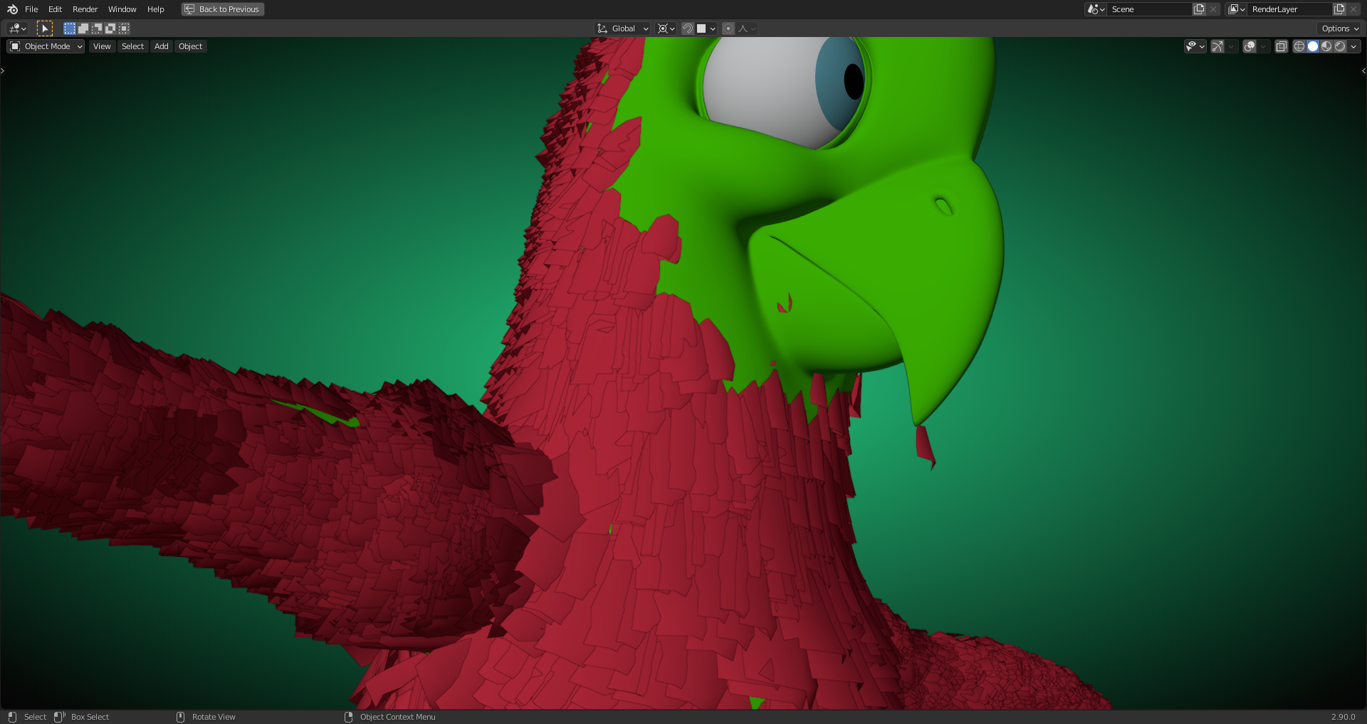

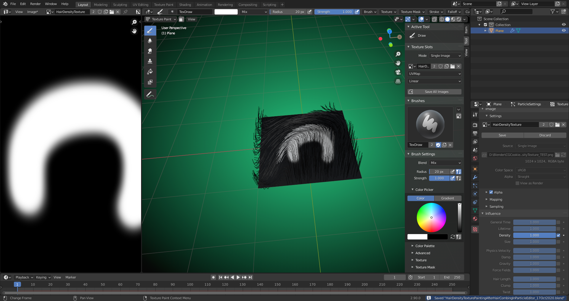

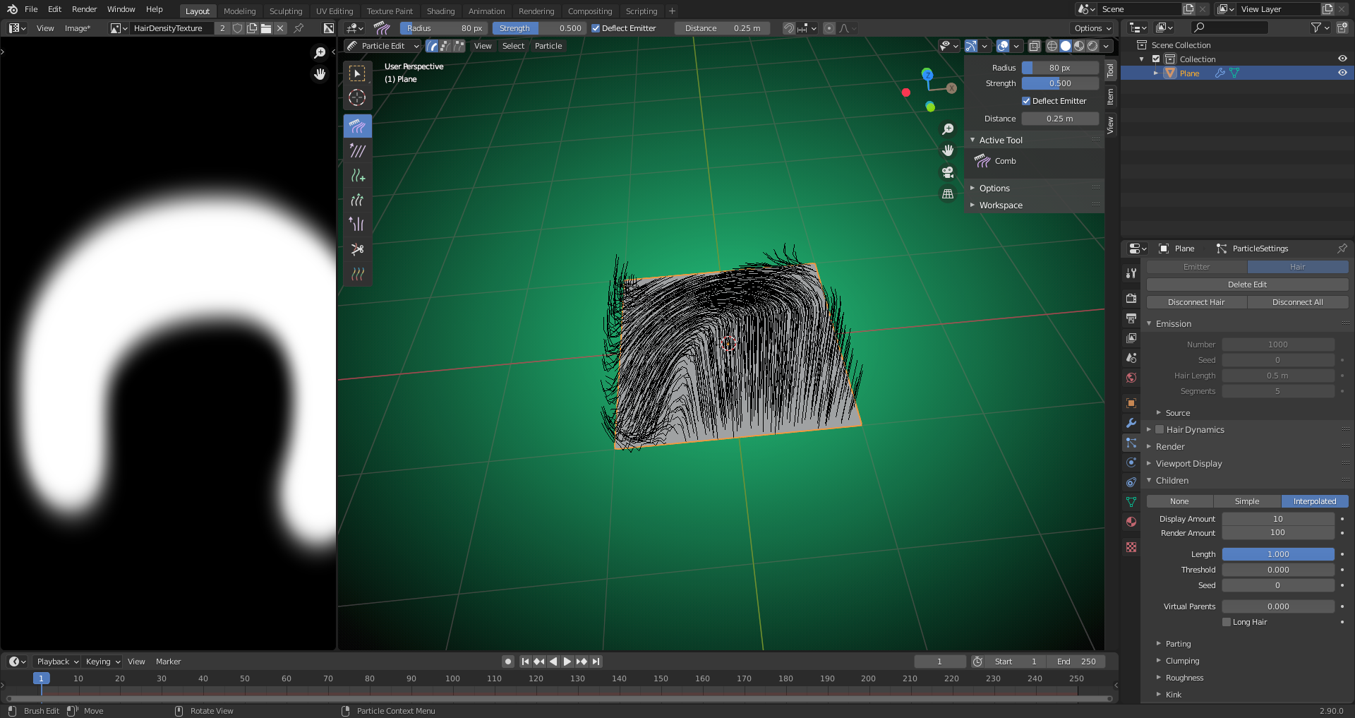

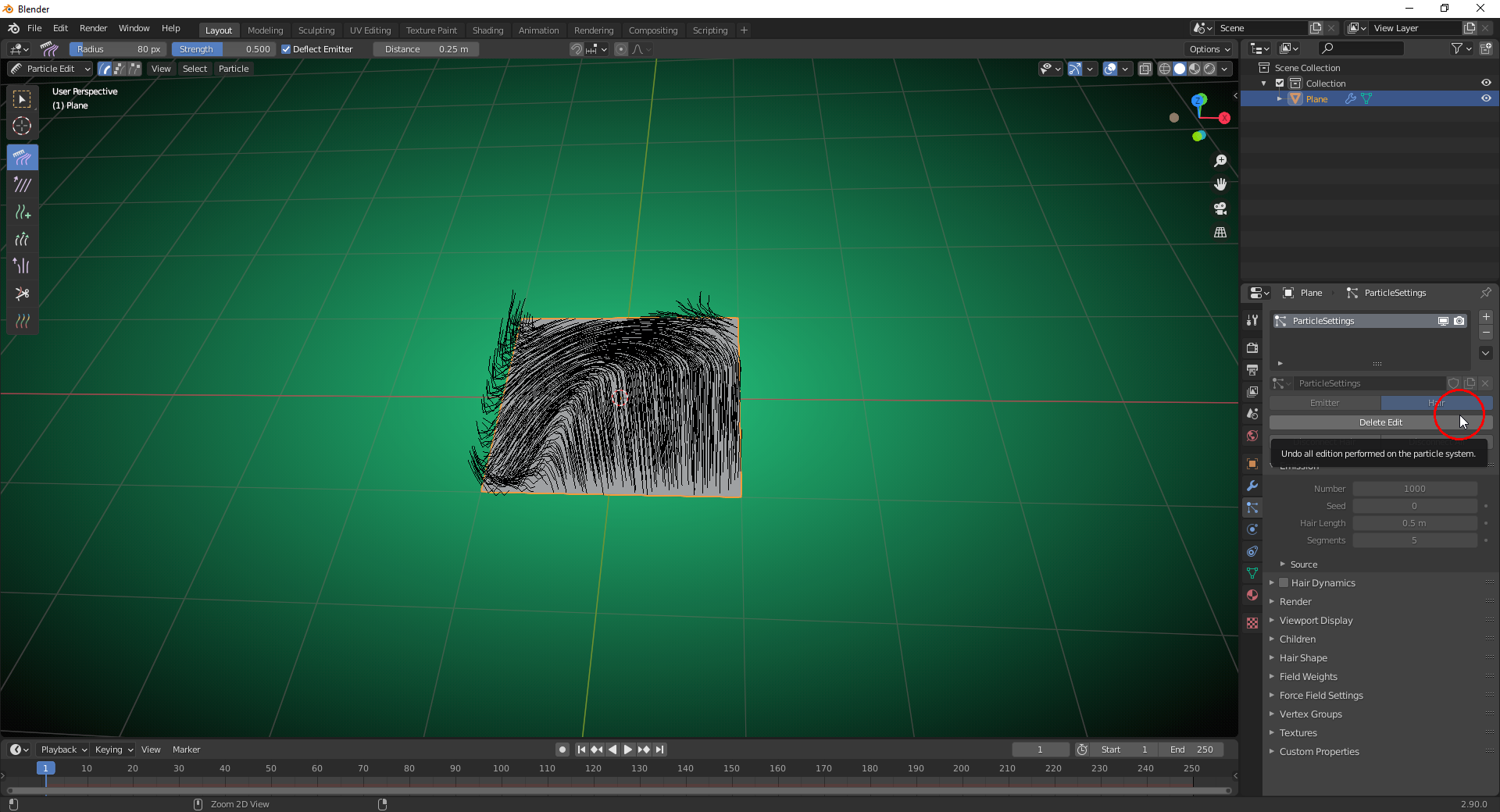

                              2) If I comb or edit the hairs before assigning a “Hair Density Texture”, then I need to activate “Child Hairs” in order to make this texture affect the hairs if I check “Density” in the texture’s “Influence Settings”. As soon as I do the first brush stroke in “Particle Edit Mode”, the hairs get kind of baken, a “Delete Edit” button for freeing that bake appears directly under the mode selection buttons “Emitter” and  “Hair” in the “Particle Properties Tab” of the “Properties Editor”:
                              a) Particle Edit Mode”
                              The “Particle System Settings” are greyed out since the “Particle Simulation” has hander over the control of the hairs to the manual editing in “Particle Edit Mode”.
                              b) Creation of the “Hair Density Texture” in “Texture Paint Mode” with the combed hair visible
                              c) The same view in “Object Mode” without “Child Hairs”
                              d) The same view in “Object Mode” with “Child Hairs” (Interpolated)
                              e) Switching back to “Particle Edit Mode” makes all hairs visible, even those which are hidden through the “Density Influence Setting” of the “Hair Density Texture” in case of the use of “Child Hairs”:

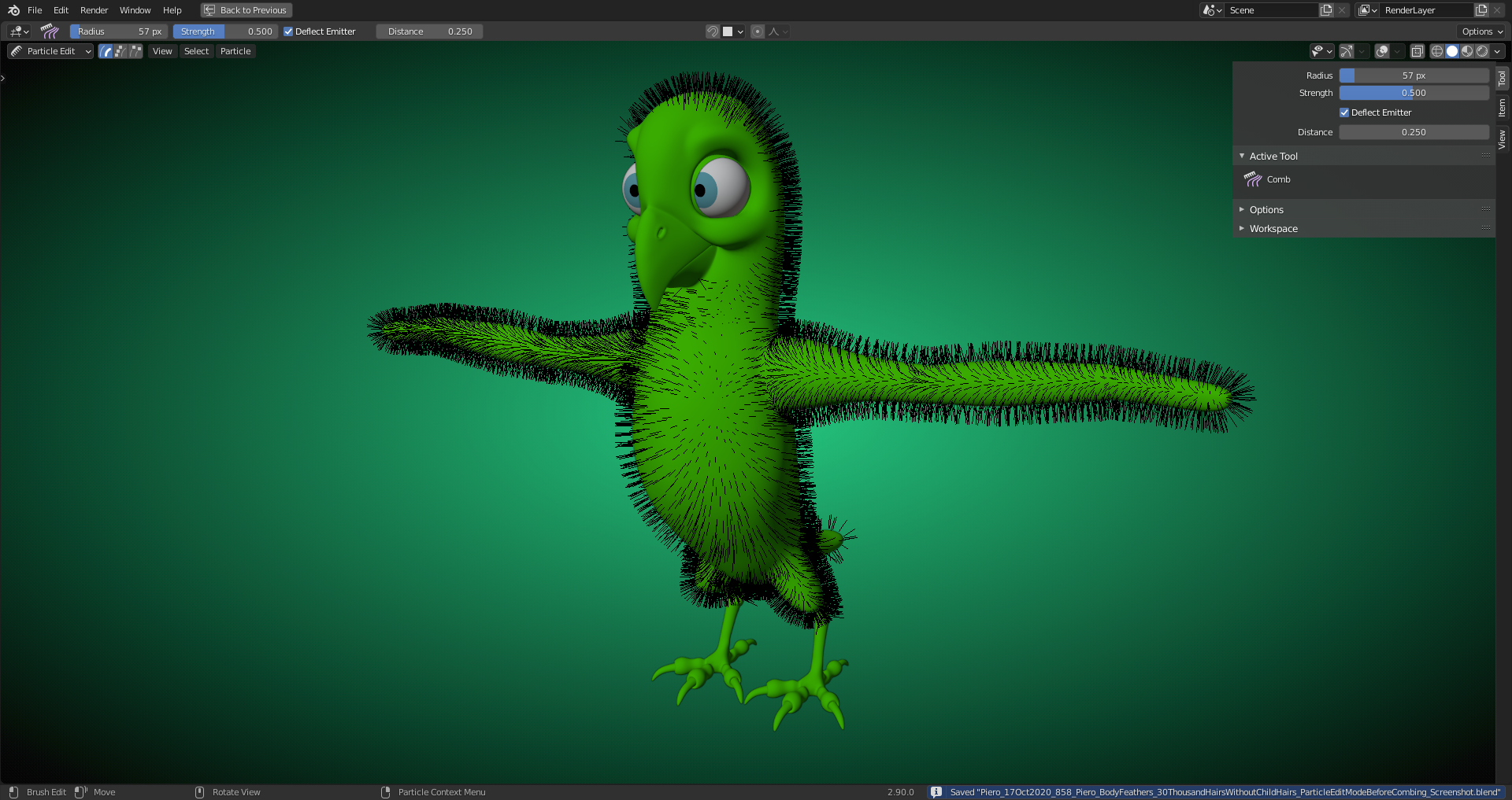

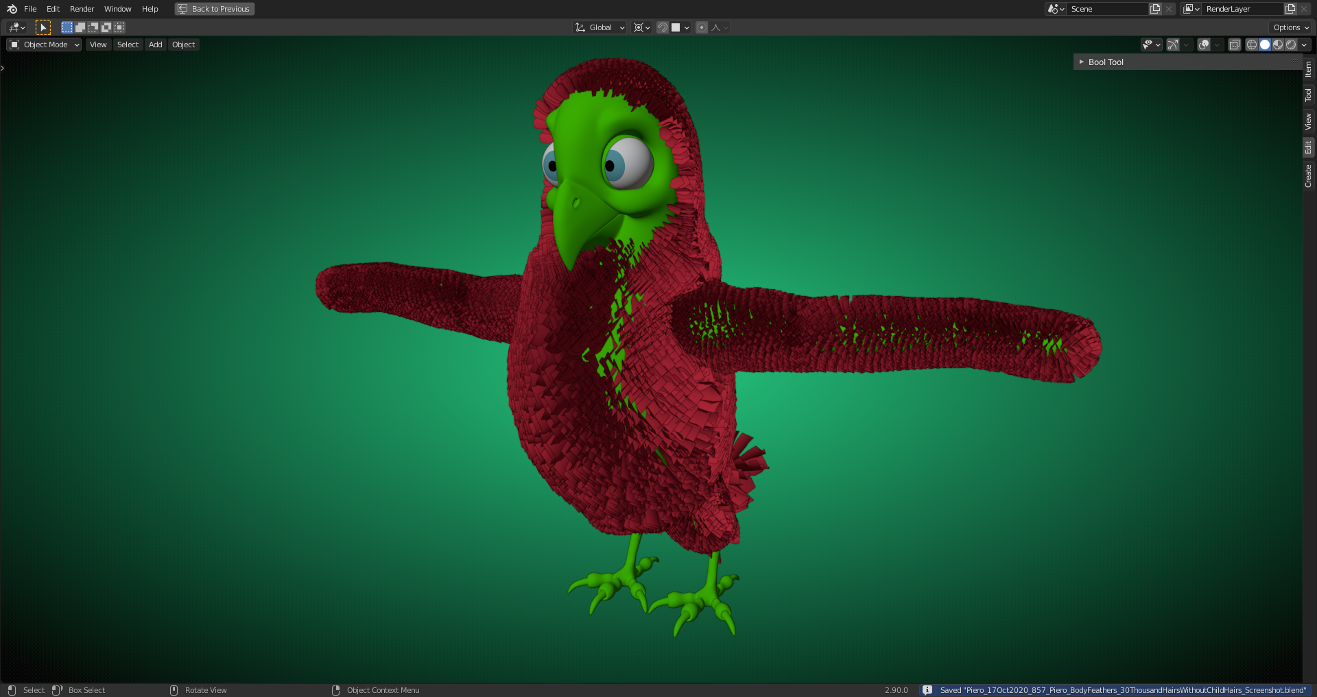

                              The hair interpolation for “Child Hairs” takes all hairs into account, even those hairs hidden by a “Hair Density Texture” that has been assigned after manipulating the hairs in “Particle Edit Mode”. This explains why I had a feather hanging at the beak of Piero even after removing the hairs on the beak (even those inside the beak and the throat!) . This feather was an “Interpolated Child Feather”:
                              1) “Object Mode”
                              2) Same view in “Particle Edit Mode”:
                              Conclusion: If I had assigned the “Hair Density Texture”  to Piero before combing the hairs, I wouldn’t have needed any “Child Hairs” and would have simply set the “Hair Number” higher which would have given me a predictable behaviour of the hairs whereas “Interpolated Child Hairs” proved to be problematic.
