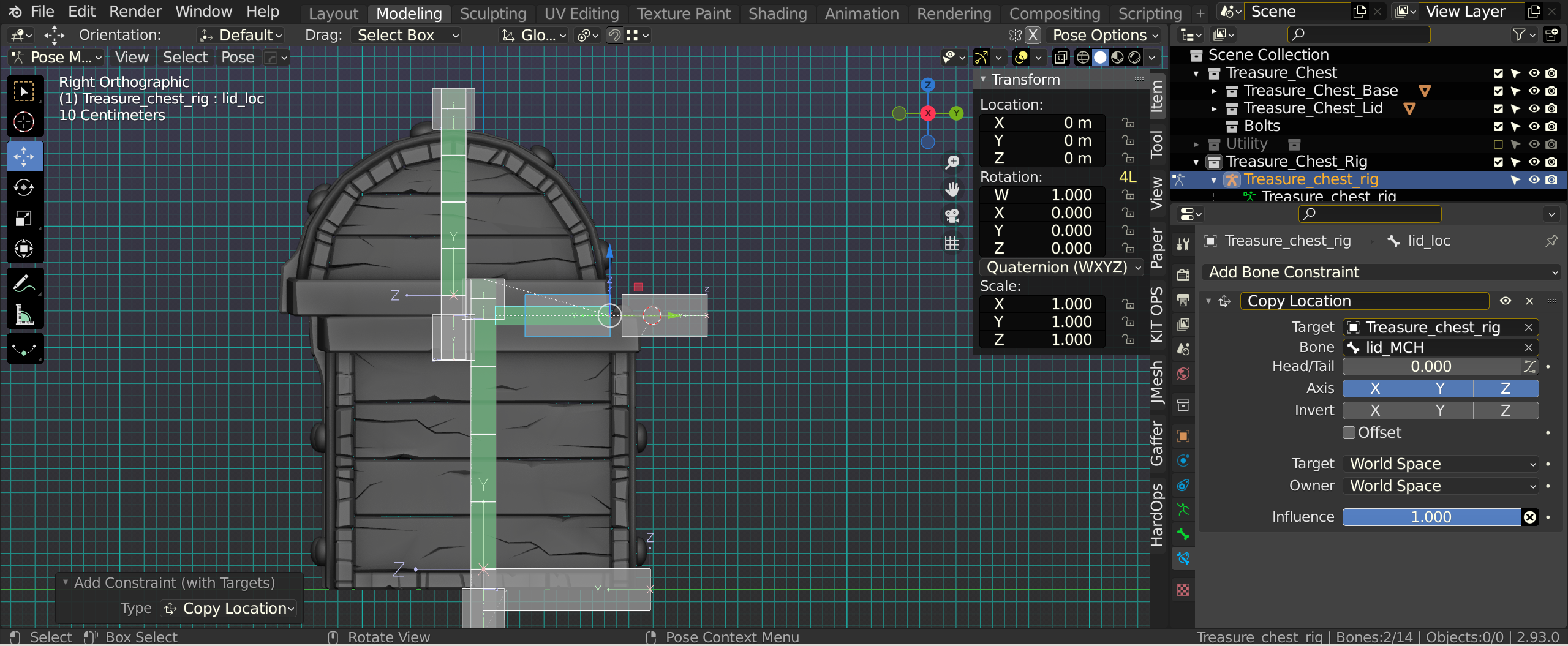

Why does the Copy location constraint move the other bones?

        Are the other bones parented to the bone you are adding the constraint to?
        If so, and there is a difference in the rest position, the constraint owner will snap to the target and pull all its children along with it.
        I hope that makes sense.
