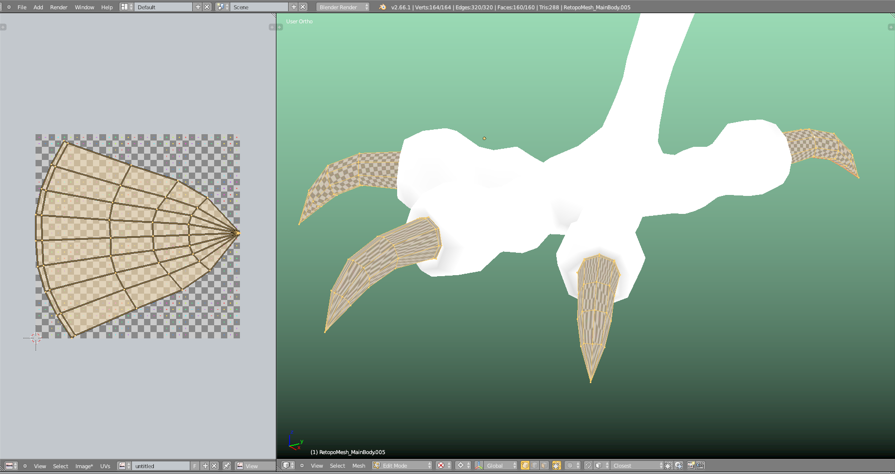

      The two claw toes in the middle of Piero’s left claw in the image below have distorted textures despite having identically looking UV map islands as the other two claw toes with undistorted textures?

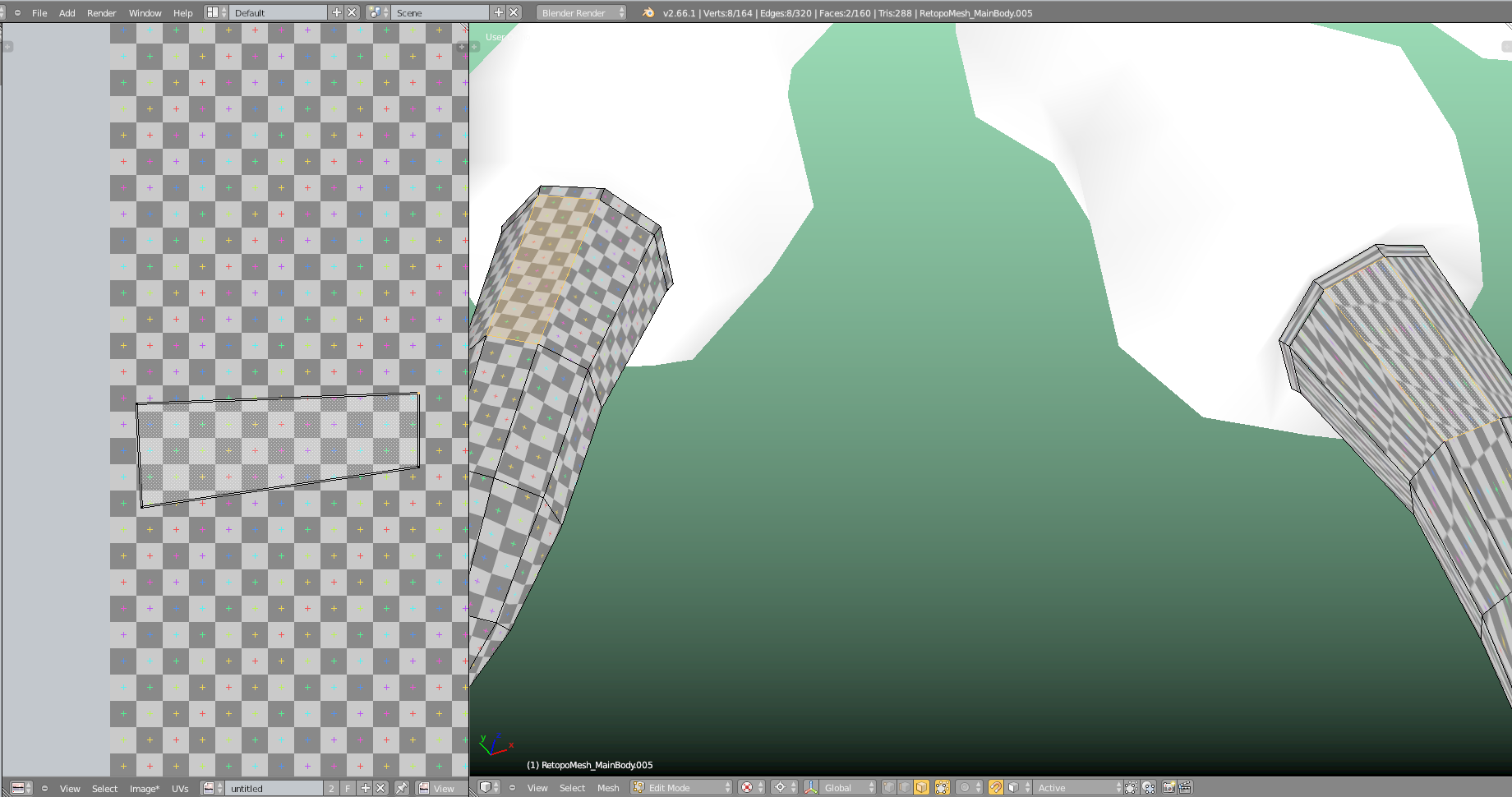

        It seems that although the UV islands for all 4 claw toes look the same corresponding faces on these toes aren’t mapped to the same area in the UV map:
        The highlighted faces are those of the left claw toe and the should overlap exactly with the UV faces linked with the 2 faces selected on the right claw toe at the same relative position on that toe as those selected on the left toe.

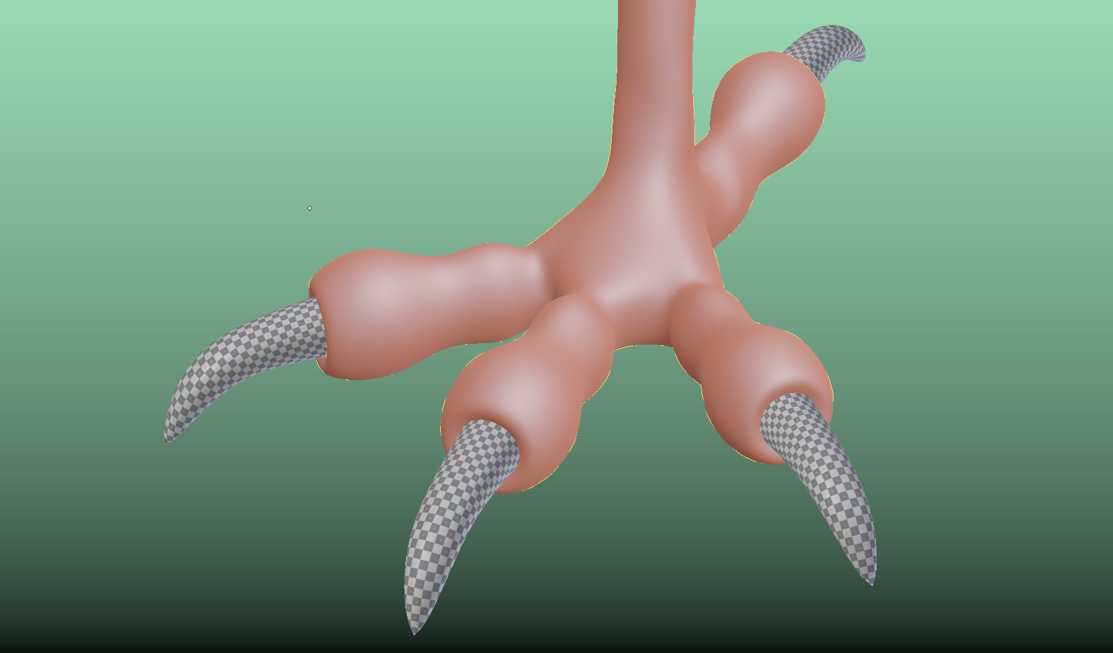

              I’ve now unwrapped each toe separately after having added a seam to each toe. The “UV Map Islands” are almost overlapping perfectly and I’ll use snapping to make it perfect.  Now, there’s no texture stretching on the toes:
              I don’t understand the sense of a “Join as UVs” function if it’s so sensitive and easily produces messy results. Then it’s easier and faster to do it manually than wasting a lot of time with an unnecessary cleanup.
