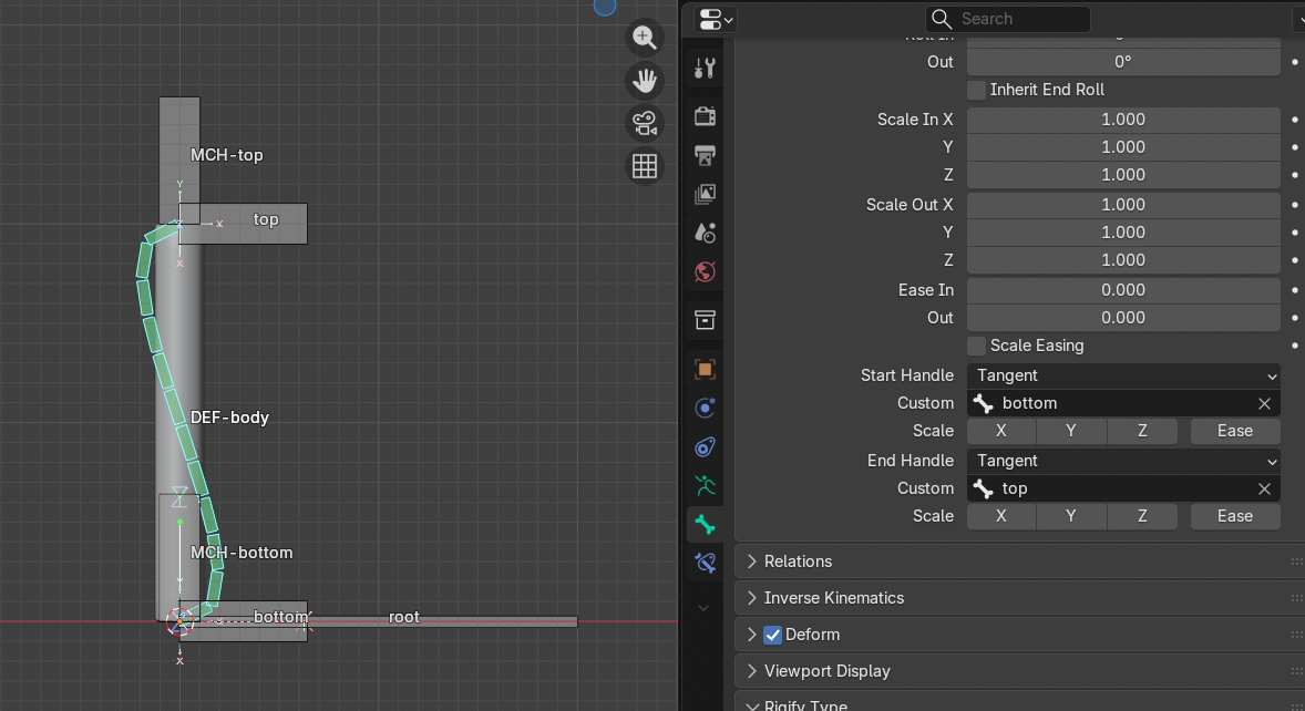

      Setup 01: Unused MCH bones, tangent handles on the ctrl bones
      This was the first thought I would have had. We just set our ctrl bones as the handles and set them to “tangent” as was done in the demo. The problem, kinda obviously, is it’s tangent, so this would deform by default into a weird “s” shape.
      Of course, the next obvious thought would be “what if we just aligned the handles”, which we can, and that leads us to…

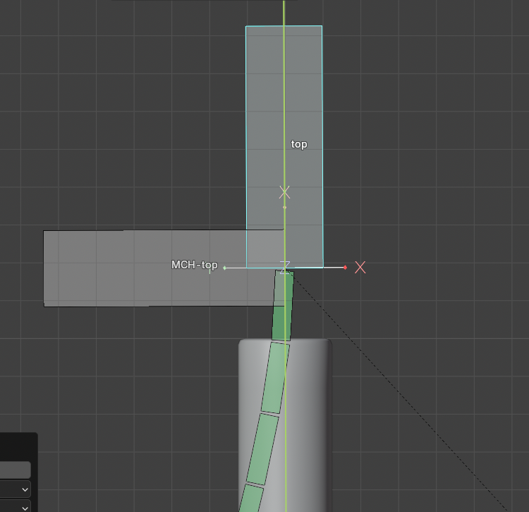

      Setup 02: Unused MCH bones, tangent handles on realigned ctrl bones
      This one is basically the same, except the handles are realigned to make it easier to manage.
      The problem here is that we still have to deal with animating these, and their axes are no longer aligned with world space. (Which iunno about you guys, but that’s kinda confusing.)
      (This is me pulling the “top” control bone along its own y-axis, which in this context matches the global Z axis)
      But okay, that gets us something that works. Not great, but it works.

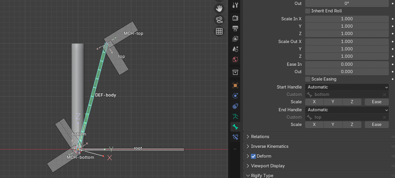

      Setup 03: Automatic handles (MCH bones still unused)
      This one is described as “uses the connected parent and children to compute the handle”.
      As you can see, it didn’t give a care about my rotation. I don’t want to even think about the extra work required to create a rotation handle here. NEXT.

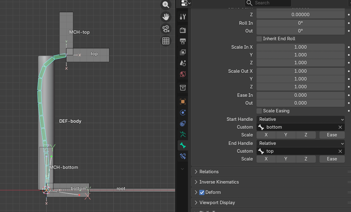

      Setup 05: Relative handles
      This provides a similar result, but also…
      We don’t have any real control over the rotation, it just computes it for us. Drat.

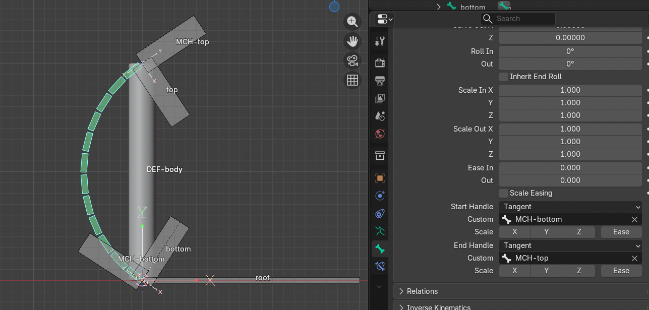

      So with all of that in mind, the setup that got us the closest was tangent handles with realigned control bones.
      But we don’t want to realign those control bones. We really want something easy to work with for animation.
      Hmm. What if we just created a set of bones that helped us maintain that tangent behavior, and then created a separate set of bones that were properly aligned with the world axes to contro-
      Ah, well, there it is!
      We can add the bones with a tangent, realign them, and then create separate bones to keep animating them from being a hassle!

          – The `Relative` option is mathematically buggy so you will get unexpected results which makes it unusable…..mmmm maybe I can either fix it for Blender 6.0 or remove it.
          – The Automatic option mentioned above requires a slightly different set up to work.  (this follows my first point above)
          Automatic will use the bones that is it connected to as a parent/child.
          This means the bottom MCH needs to be positioned differently – and the top MCH needs to be a connected child
