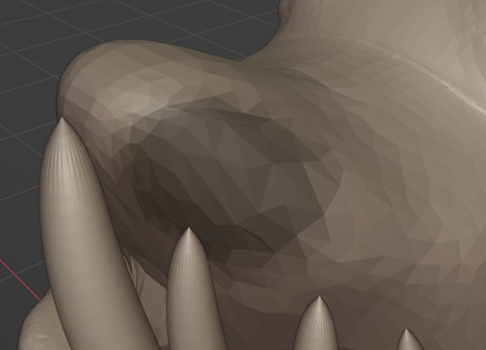

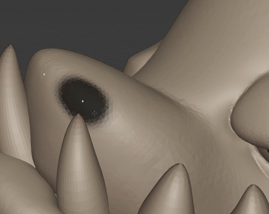

      he can create sharp shapes with his mask brush and the mask always looks denser where mine is never accurate around the edges and does not look dense like his mask
      my example
      mine is always artifact and not sharp or dense, i can never make accurate shapes with my mask brush even if i use the same radius and strength as he does in the examples

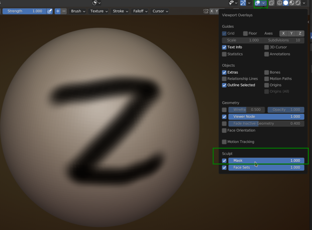

        That is mostly because of the Mask Overlay Strength; try setting that to 1 (default is 0.75):
        For the rest, it depends on the Mesh Density and the Falloff of the Brush (Smooth is default and is usually ok…Constant is more jagged).

          I did not know masks had a overlay strength. You know Blender inside out Spikey.
