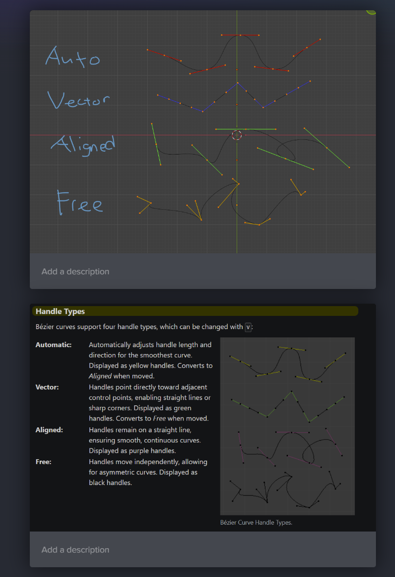

      I’m using Blender 5.0.0
      Hey all my handle type colors seem to be completely different than the video and the Blender 5.0 documentation. I haven’t ever changed them.
      Any reason why this might be?
      Thank you
      #100880
      Grady Pruitt
        Could be something with the theme or a change that was  made before release. My colors on 5.0 and 5.2 match yours. The important thing is that the reaction of the curves is consistent between what you have and what is shown in the image.
        #100881
        Grady Pruitt
          Could even be that the image, while still accurate in behavior, is actually from an older version of Blender that did use those colors for the handles.
          #100882
          Dwayne Savage
            I believe that is a theme change that hasn’t or wasn’t implemented. I don’t think I’ve ever seen free handles as black.
            #100883
            Jesse Palato
              Thank you for responding yall. Yes the curves act appropriately. The theme switch will make it a bit uncomfortable to follow along but ooh well.

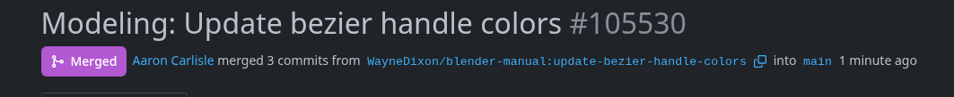

                #100885
                Wayne Dixon
                  Submitted the PR.
                  It should be corrected in 5.3
                  https://projects.blender.org/blender/blender-manual/pulls/105530
                  #100886
                  Dwayne Savage
                    Oh, I don’t know why I didn’t mention this earlier, but you can actually change those colors to match if it makes it easier for you. Ctrl+comma or edit->Preferences or F4->Preferences to open preferences. Click on theme on the left hand side. Then in the list expand common then expand curves. Then just set the color you want for each handle type. In pre 5.0 curves’ colors where by editor. So you would have to go into each editor and change them.
                    #100887
                    Wayne Dixon
                      The docs are updated (will become live in 5.3)
