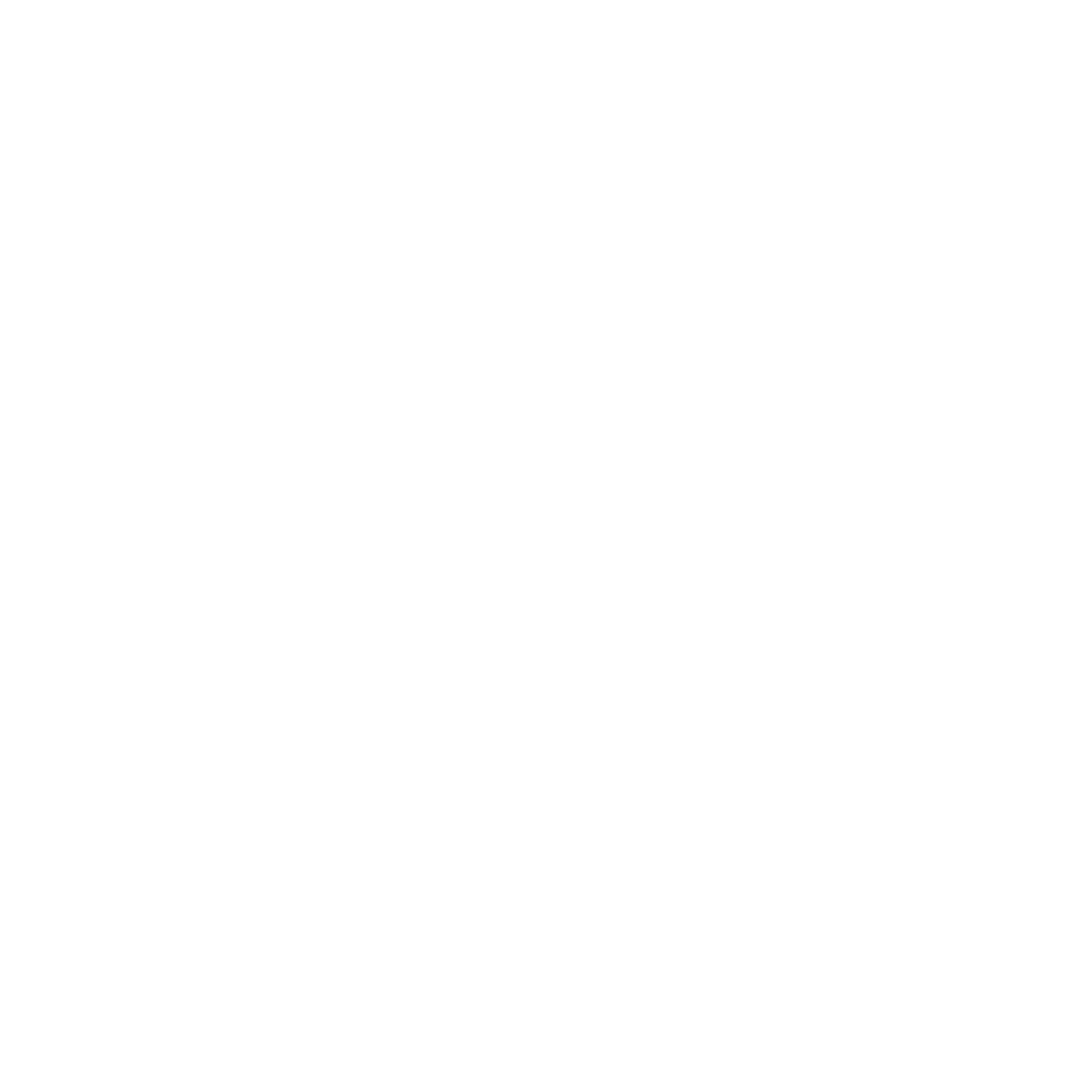

      Hi, I have this small problem that I am doing everything like in the tutorial, but somehow, when I hit bake, the grainy information does not appear, it is just purely white …
      Know, where the problem might be ? I tried to put lights to other layer, I tried to turn on/off world lighting, but nothing helped …
      There are seen highlighted sides of objects in blender +something like a checker board in the background, that seems like transparency, but the bake is white … ?

        @stopel Which version of Blender are you using? Also could you provide a download link to your .blend file (via dropbox for example) so I can take a closer look?

        Ján Ambróš
          Hi, Kent.
          I uploaded the file in here: https://ufile.io/wt9z1  + packed there some textures, if needed (try to bake the map). Currently I am using Blender 2.79b (22.03.2018 the latest before 2.8).

            Thanks for the .blend file @stopel. It’s an odd issue; one I’ve not run into before. But for some reason the material is preventing the bake from happening. If you [temporarily] remove the material from the object, it bakes fine for me. Weird.

              Yes, it is a strange thing. Probably there is something wrong with the material it self. In one of the courses, I think, it was where the painting was starting, you showed there, how to switch to GLSL view and remove shading, but I didnt had there that option. So I meddled with the settings on material a bit, and probably I created the material in cycles render and only after that switched to blender render (if you enable/disable the “enable nodes” option in materials, it lets you to switch shading on/off).

                I don’t know that the material was the issue by itself. In other words I don’t think you need to re-create it. But temporarily disconnecting from your object so you can do a clean AO bake, then simply re-assign it back to the model.
