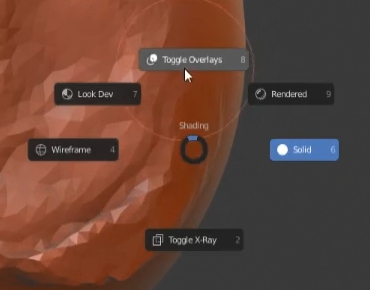

      In Chapter 2 : Sculpt Gravity and Brush, you’re using this pie menu :
      What’s the hotkey ?
      I thought it might be ‘Z’ but on my Blender the ‘Toggle Overlays’ and ‘Toggle X Ray’ options don’t pop up when I press ‘Z’.
      Is there an alternative hotkey or a setting to change to have all the options ?
      Thanks !

        Edit -> Preferences -> Keymap, and then check “Extra Shading Pie Menu Items”. Then all of them should show up when you press ‘z’.

          That’s it ! Thanks.
