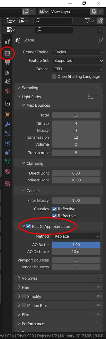

      In the video it shows that under the world properties you can tick on ‘ambient occlusion’ but I can’t find that option in the latest version, wondering where it has moved or been renamed?

        In the Render Properties, under Light Paths, you will find a Fast GI Approximation check box and dropdown menu.
        The other option is to use the Ambient Occlusion node in the Shader Editor with the world shader selected.

          Awesome! thanks for the speedy reply 🙂
