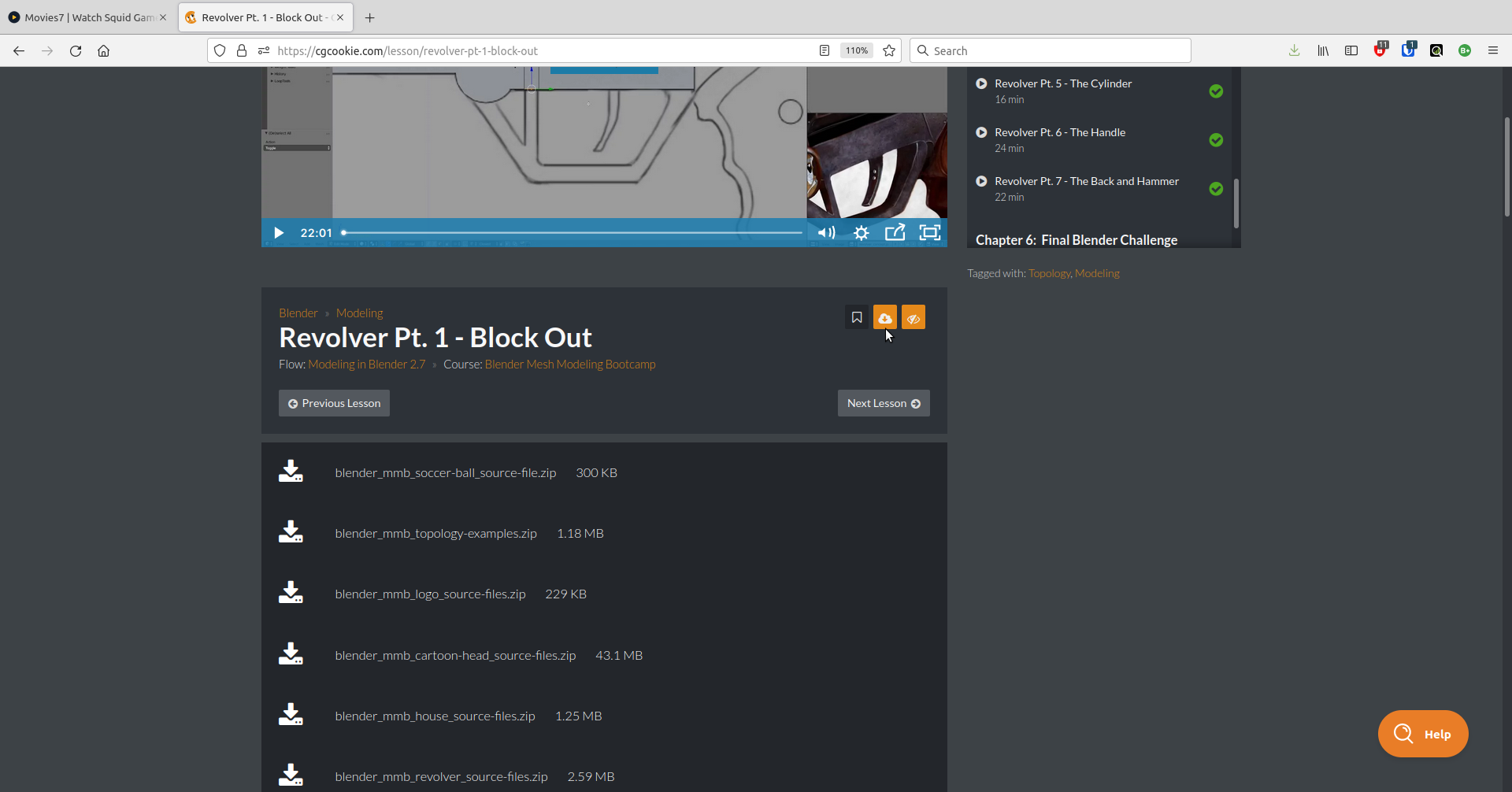

        If you click the cloud icon you get a list of downloads and at the bottom are the revolver source files, containing concept art and a modeling sheet:

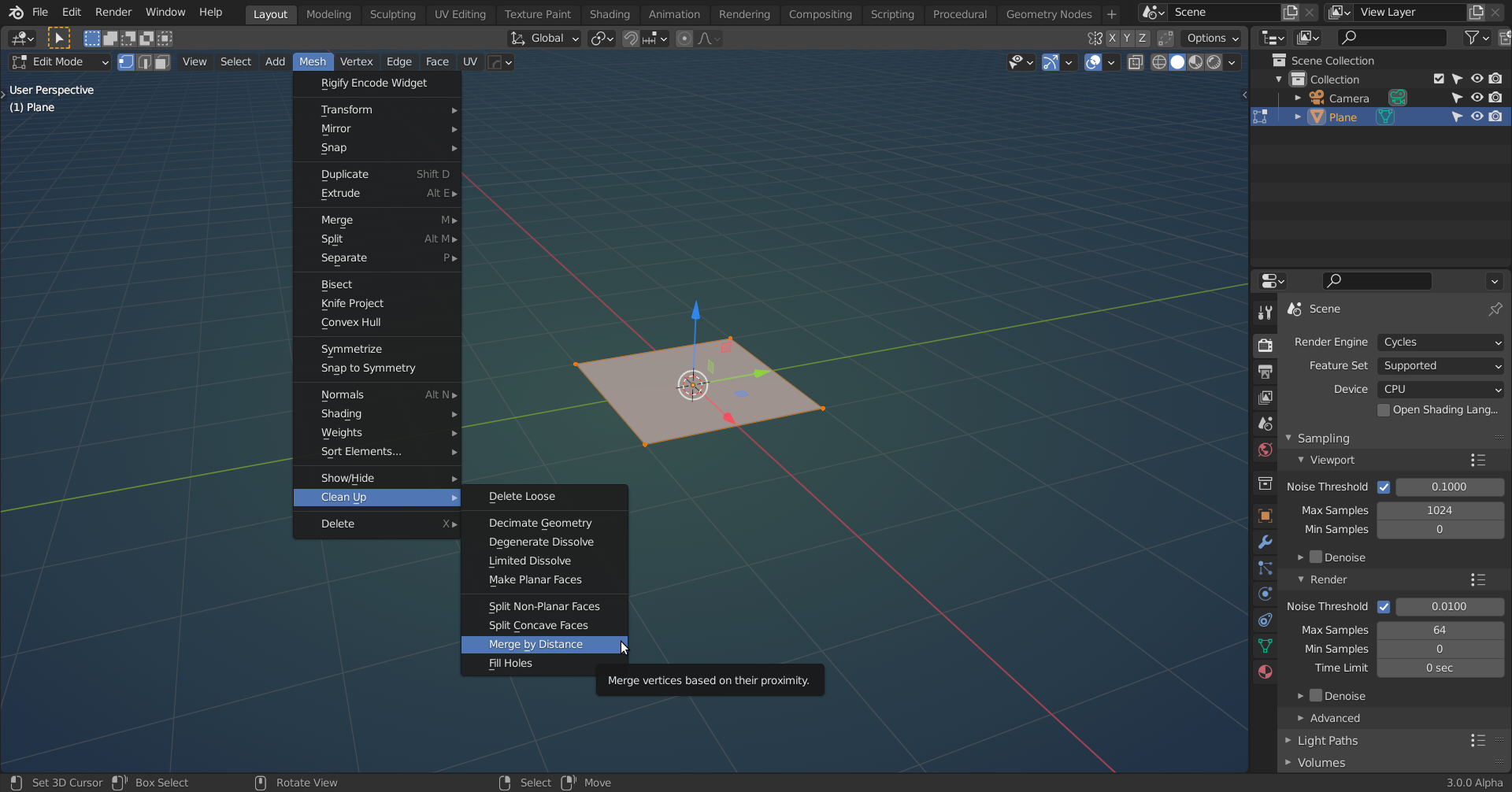

                Look like i hit a snag 12.59 Overlap double & select all i don’t see an option to remover double

                  Look like i hit a snag [video 12.59] Overlap double & select all i don’t see an option to remover double is there a setting or key at a miss ?

                    This has been re-named and the hotkey has also been changed.
                    M > Merge > Merge by Distance.
                    Can also be found here:
