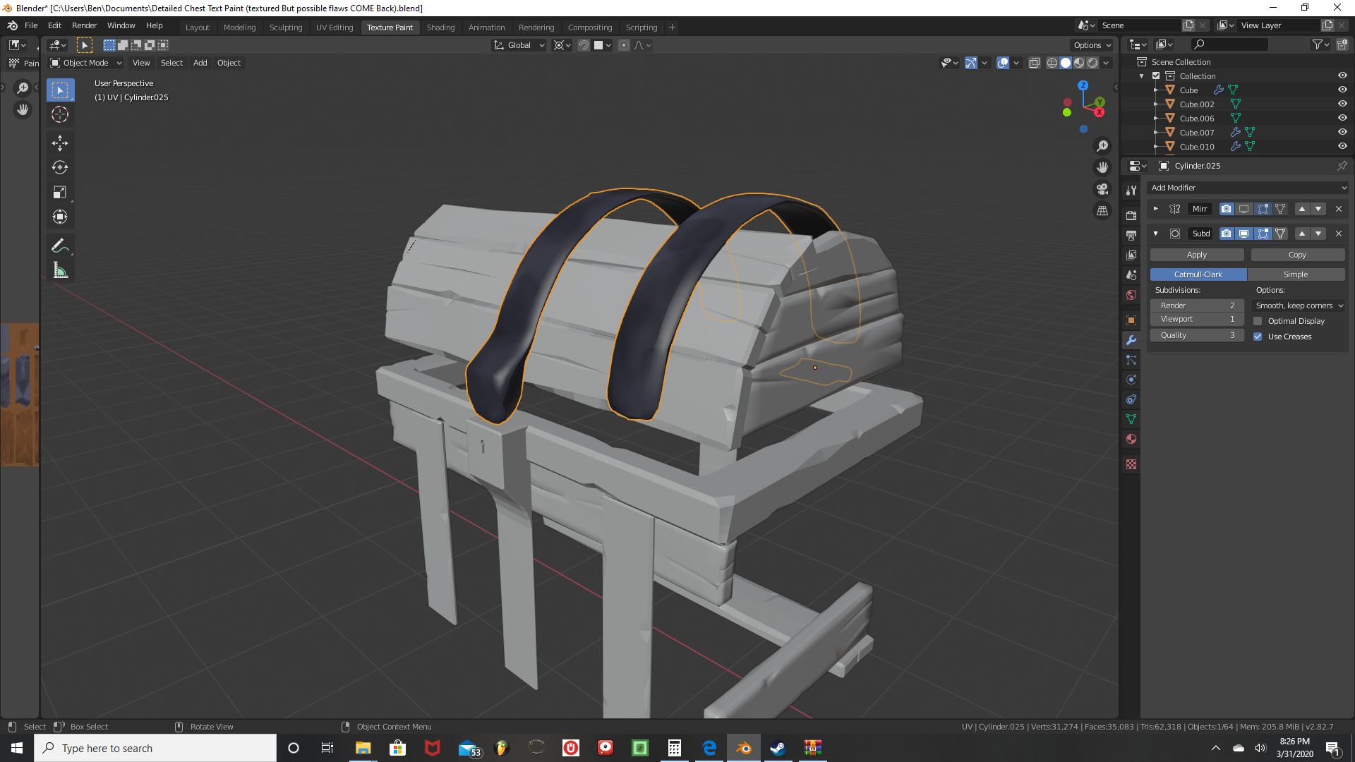

When i subdivide using the modifier it completely warps my metal brackets?
Forum Archive When i subdivide using the modifier it completely warps my metal brackets?
  • #11611
    thebends
      #55490
      thebends
        Edit: NVM I think I somehow missed the bevel process somewhere. beveling it out seemed to work a bit better
        #55491
          Yes you need to bevel as a means to reinforce the hard edges. The technique is also referred to as “holding edges”. Otherwise the subsurf modifier will smooth it out too much.
