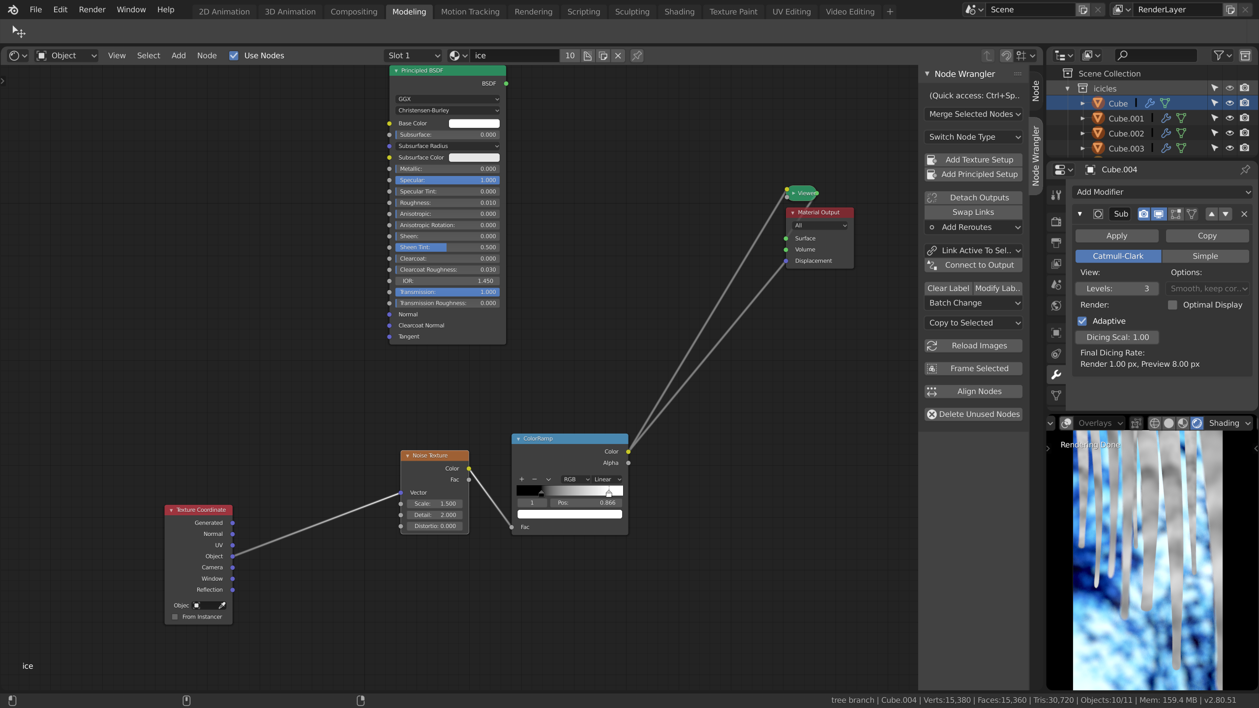

      Here’s what I’ve got so far. I’ve turned adaptive on for all the icicles. There’s no change in the shape of my icicles like how Kent’s become a little bumpier and deformed after connecting the ColorRamp node to the material output. Any help would be greatly appreciated, thanks.

        What if you add a Math node after the color ramp, change the operation to Multiply, and multiply value 1 (color ramp input) by 5, then 10, etc. Does that start to deform the model as expected?
        #28600
        Colin
          I restarted from the beginning just in case I missed something but I’m running into the same problem.
          This is the node setup.
          This is the render when multiply is 1.00
          And here’s 5x multiply
          And here’s 10x
          #28601
          Colin
            I think I just figured it out. I had to change the node surface setting from ‘bump only’ to ‘displacement and bump’.
            #28602
              Ahh yep, that will do it. Glad you solved it 👊
