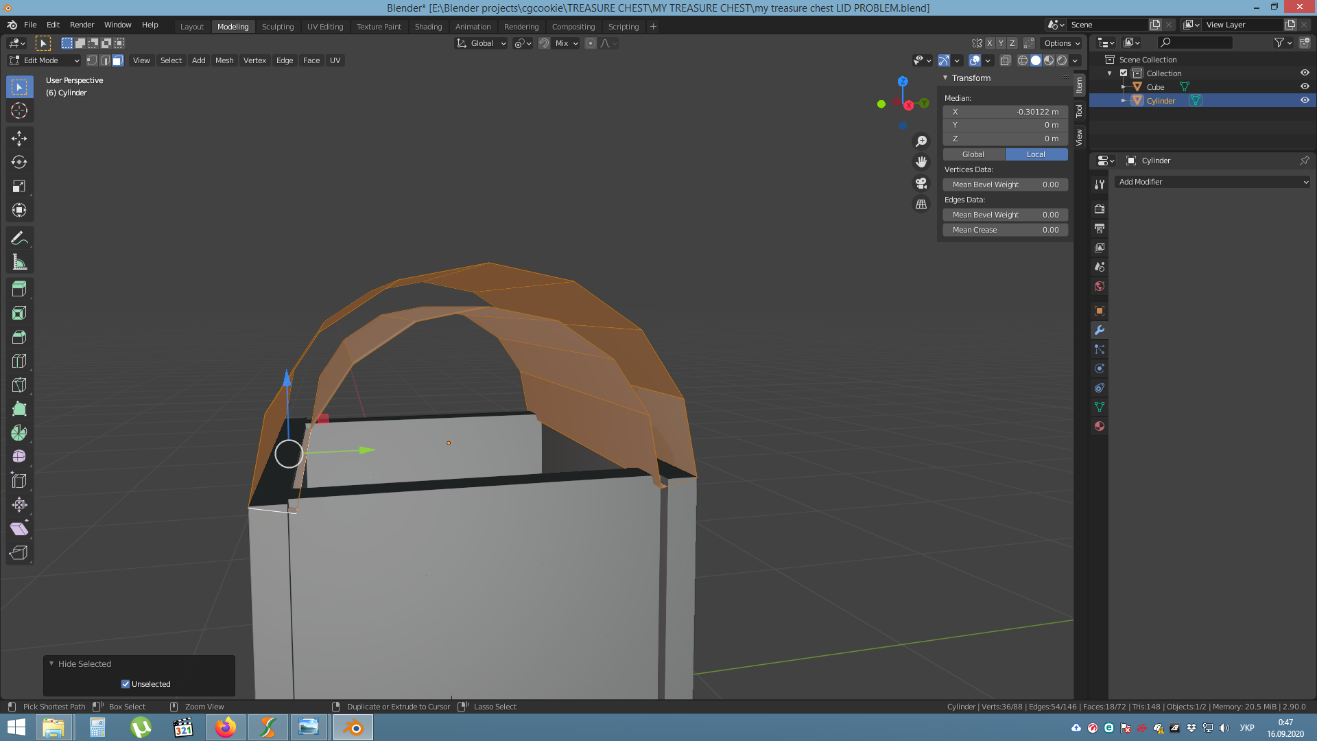

When extruding the lid planks, and doing Alt+S, I get planks without side faces.
Forum Archive When extruding the lid planks, and doing Alt+S, I get planks without side faces.
  • #12644
    Bohdan Skochii
      Basically, decided to re-do the tutorial just for practice, and got this problem.
      https://www.dropbox.com/s/rjnf32kxm47roev/my%20treasure%20chest%20LID%20PROBLEM.blend?dl=0
      Linked the project file with lid planks just before the Extrude.
      This time I can’t find a solution, and it creates more and more problems when I’m trying to fix those faces by filling. Any tips? Thanks!!
      #59997
        Hi Bohdan, you have a classical case of ‘double vertices’.
        Press M > Merge by Distance (with the lid selected) and it will ‘remove’ 18 vertices and then everything should work as expected.
        #59998
        Bohdan Skochii
          Wow, I totally forgot about this….. Many thanks!
          UPDATE
          It seems it still doesn’t work in my case. It removes 26 vertices and I still got open planks… But when I re-create the lid part anew, it works…. weird stuff
