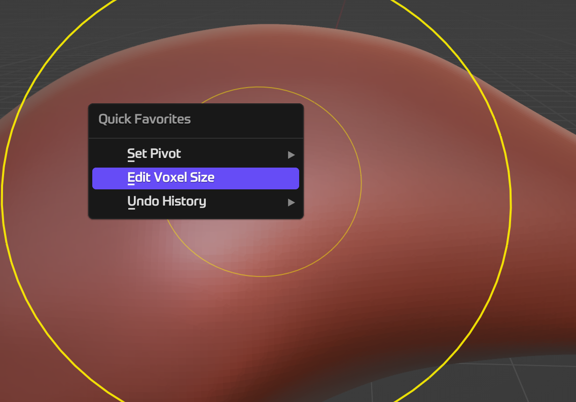

            (@ Martin) I was having a similar question and I love this tip!
            Just took it a step further and made it a Sculpt Mode Quick Fav:
