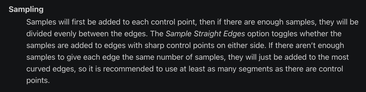

        Well speaking truthfully, there’s a bunch of settings no one ever uses, they are super technical and 99.99% of the time you don’t have to change. I bet those are of that kind. The wiki says this though:
        #89529
          It is about how the Edges are ‘subdivided’…you can see the effect in Edit Mode after Applying the Bevel Modifier):
          And:
          And I must admit, that I didn’t know this, before you asked…
          Like Omar said, you’ll probably never touch those Settings.
          And be aware, that Sample Even Lengths can alter your Custom Profile.
