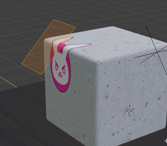

        To me the main benefits of this method are that it leaves the target mesh completely intact and allow you to treat the decal as a separated object. This means you can apply decals during any stage of your project, whether you are at the early stage or polishing it, with clean visual result. This technique also provides better looking results in non-flat surfaces compared to using the shrinkrap modifier.

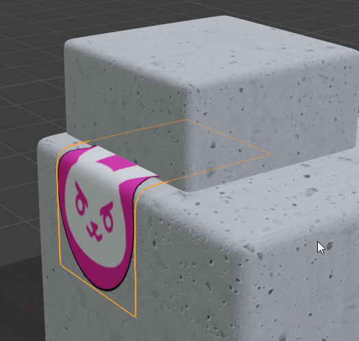

        Shrinkwraping the decal  on a curved surface or on the inside of an L shape will end up with non aligned faces no matter how high you’ll subdivide it. This will force you to use a higher offset value to avoid intersection and overlapping faces compared to the very low value of the displacement modifier. The end result can be damaged.
        Booling will allow you to borrow the target mesh and the decal will share the exact same topology and you will not have this issue. With a one-to-one topology you get the exact same normals and shading as well, which will make the decal to look stuck on the target.

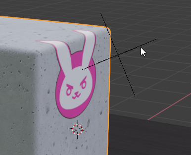

        The main drawback I found with using the UV Project technique directly on the target is that it goes through the whole mesh if (I used an image as empty for better visibility):
