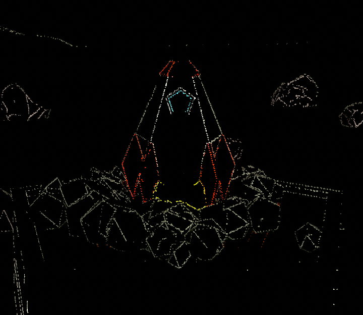

      I attempted to convert this into an Android app (ignoring ship controls for now) but ended up with some rendering issues:
      Well, I guess my phone is pretty old (Samsung Note 2). But I’m wondering if I might’ve missed some steps. This is what I did:
      1. Switch to Android platform in Build Settings.
      2. Switch Color Space to Gamma in Player Settings.
      3. Set Company/Product Name and Package Name in Player Settings.
      4. Build and Run.
      #51003
      Jonathan Gonzalez
        I would probably turn off the post processing as that may affect performance and I’m not sure how well post processing works on mobile to begin with. I would also try to bake the lighting using “subtractive” for the lighting mode. That’s meant for mobile and web gl games as it’s the most performant.
        Everything else should be good to go. I assume you were able to build to your device in which case you should have the Android tools already installed and you were able to build to your Android “Api Level”. The minimum you can build to is Android 4.1 Jelly Bean from what I see in Unity 2019.

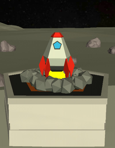

          Disabling Post Processing Layer on Main Camera did the trick! It renders OK now and seems to animate smoothly. Here’s another screenshot from my phone:

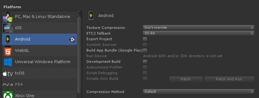

            When building, do you have your device selected within the build settings window? It should appear in here where it says “Run Device”
            I don’t have an Android device connected, but when you do you’ll see a dropdown appear there allowing you to specify where you want to build it. Typically it will automatically find the device connected and build to that.
            Whenever I build to a device I usually close down the app then use build and run again. If you leave the app open sometimes it doesn’t properly update it.
