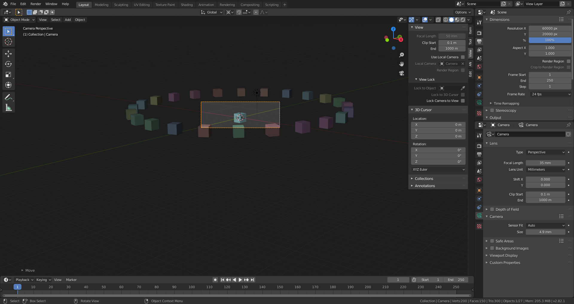

      When you change the output image’s X-resolution, this scales up the camera render frame’s Y-dimension. So far I know that this counterintuitive behaviour has to do with the camera’s sensor size (set in the “Camera” panel of the camera’ s “Object Data” tab) which is set to Auto per default (unless you choose a sensor preset where this default setting depends on the choosen sensor) and fits the image dimensions into a frame of certain dimensions. If you would go down with the X-demension far enough, that frame would switch growing in the view’s y-derection to shrink along the X-axis. With “Horizontal” as sensor fit, the camera’s render frame extension in the view’s X-axis would be kept while scaling the Y-extension in order to keep the images resolution ration between X and Y. With “Vertical” it would be the complementary with the view’s Y-direction being kept.

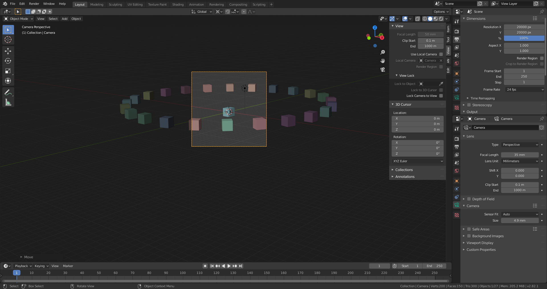

      With “Auto” as sensor fit the view angle never exceeds the limits of a squared render frame for equal values in X and Y, even if I choose extremely high values:
       As soon as I crank up or down one of both values the scene outcut shrinks in X or Y:

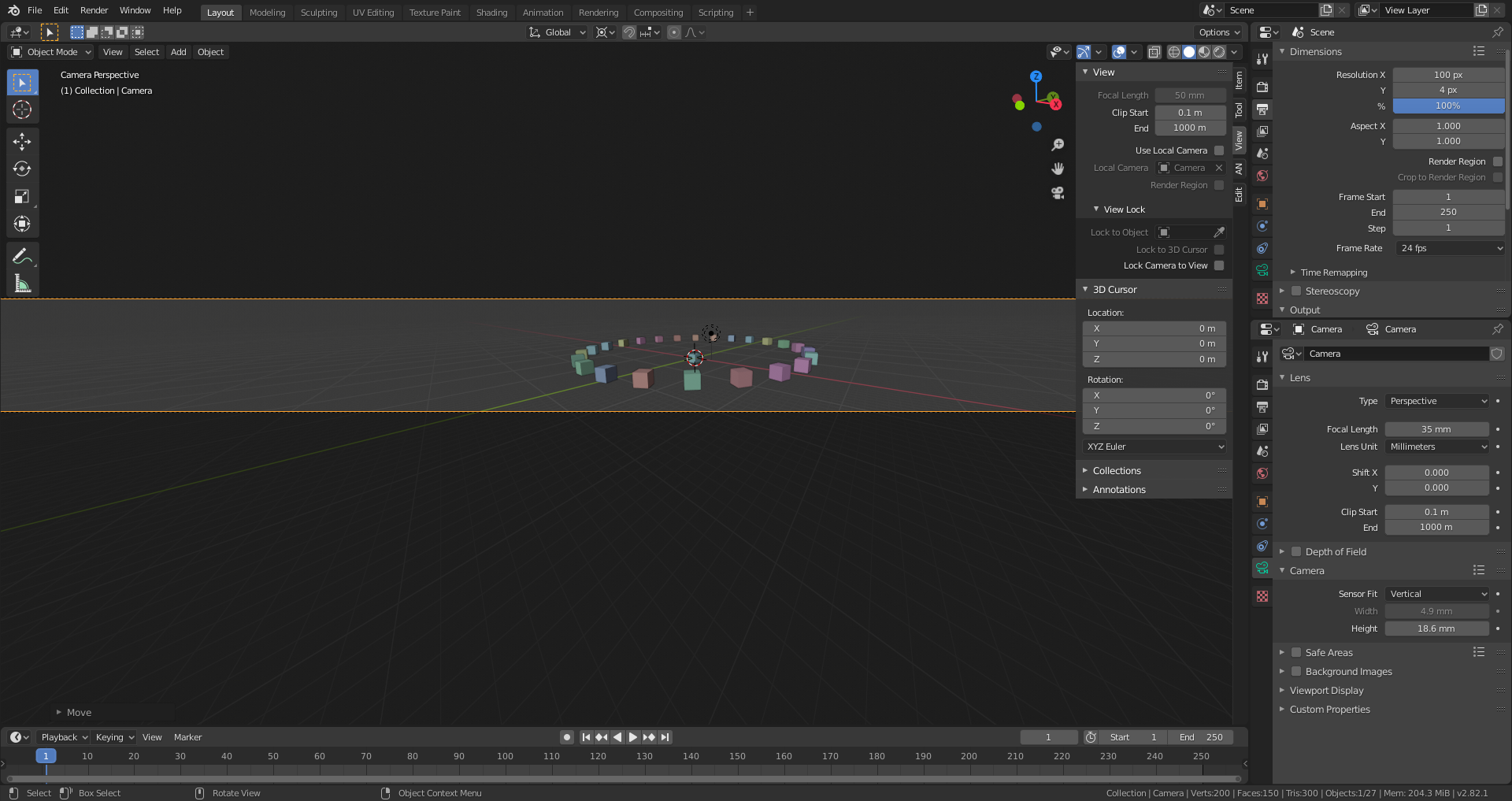

      With “Sensor Fit” set to “Vertical” I get a squared scene outcut for equal X and Y but for an growing “X divided by Y” ratio an outcut that can become so wide that I can’t zoom out further:
       With “Sensor Fit” set to “Horizontal” the same happens in view’s vertical direction.
      There’s also a zoom out of the scene when switching “Sensor Fit” from “Auto” or “Horizontal” to “Vertical”

          Where I’m still wondering is why in the last image from above the camera has zoomed out when switching from “Auto Sensor Fit” to “Vertical Sensor Fit” although the focal length is still 35mm and the image sensor width hasn’t changed.
          With a render image size of 4700 x 80 und “Vertical Sensor Fit” the output image looks as if taken with a wide angle lens at a viewing angle of 180 degrees:
