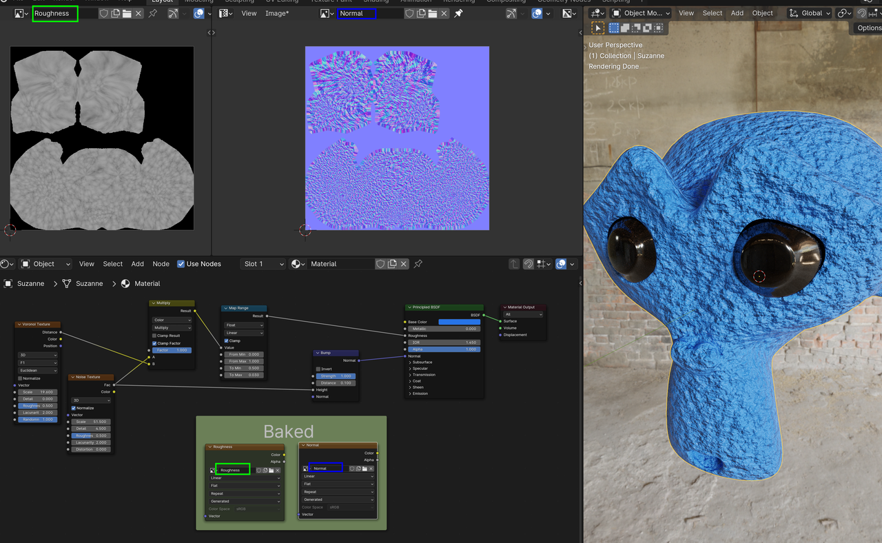

        So if you have a complex node setup for a material, or a simple like a noise texture mixed with a checker texture etc, you connect them to the shader and then in the render options click bake? And then the result of those two textures are “forever” saved to an image that doesn’t have to be calculated by the shader several times? Cause now it just looks like a finished image? So when it comes time to render, Blender’s render engine looks at the baked file and not the material made in the shader editor, if that makes sense?
        And if you need to bake like a normal map, would you do as in the picture? And then press baking in the render options, and then you would have baked a normal map? Or does it need to involve a texture?
        Is this closer to understanding it? 🙂

          Hi Student,
          You are correct up till the last sentence of your second paragraph:
          This kind of baking produces image files, but they still need to be used in a Material (plugged into a BSDF, for instance).
          Baking a Roughness and Normal Map example (just to be clear, these were done one after the other, not at the same time)::
          They are Baked to Images and can then be plugged directly into a Shader Node (or, in the case of the Normals, through a Normal Map Node) …Instead of having to calculate those values at each shading point, Blender can just take those values from the images.

          Am I correct in understanding that you make a 3D model (like the monkey head), and in the shader editor you make a roughness map of the object’s surface using several nodes (I suppose there are many tutorials on how to do this), and then bake them, and then connect the finished bake/product to the shader? If this is correct I might have understood some of it, I think.
          And that all types of baked maps are all completed before the final render, and no baking takes place when the final reder is being made?
          The nodes above the baked ones in the image you provided is not related to the baked maps underneath are they?

          #83891
            “The nodes above the baked ones in the image you provided is not related to the baked maps underneath are they?”
            Those Nodes are what is being Baked; what goes into the Roughness socket of the Principled Shader, is being Baked into the Roughness Image Texture and what goes into the Normal Socket is being Baked into the Normal Image Texture…
