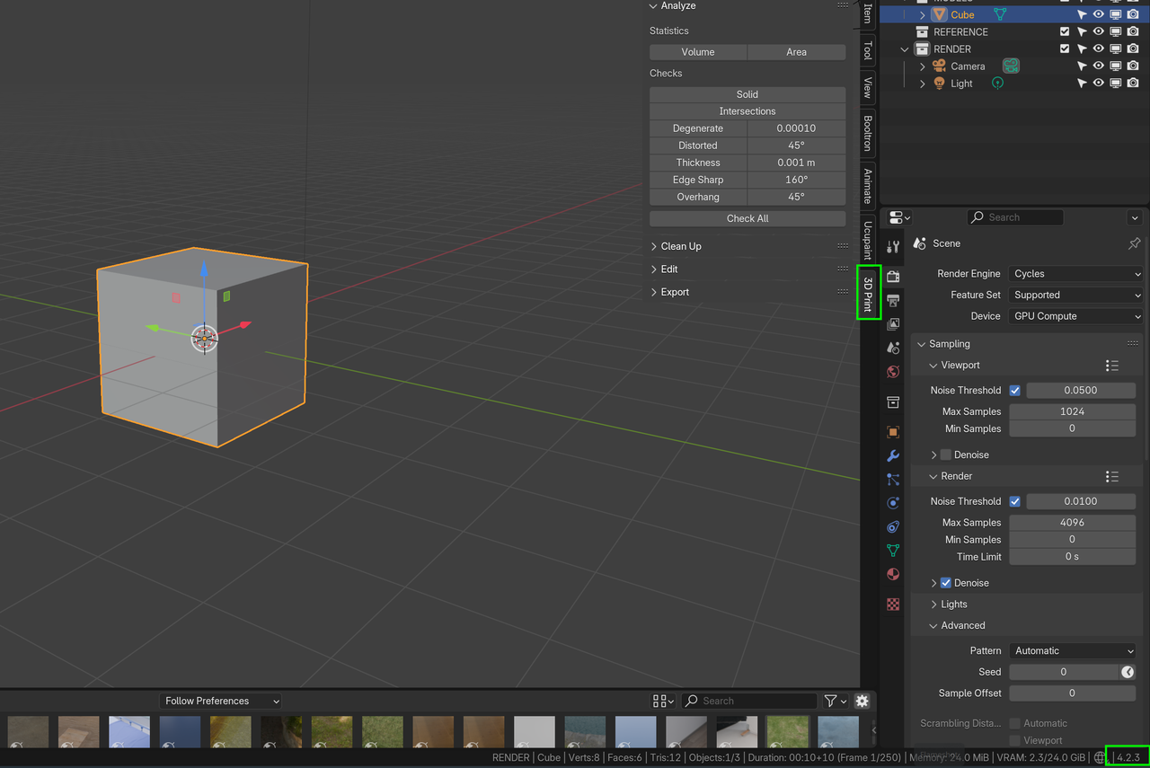

              Sometimes we don’t realize we have to switch it in one of those thingies, there should be an extra one with the name of the addon, try and see if that’s it:
              #90889
                Should work in 4.2 as well, Jerry (sorry for the misspelling above, my eyes are getting worse…):
