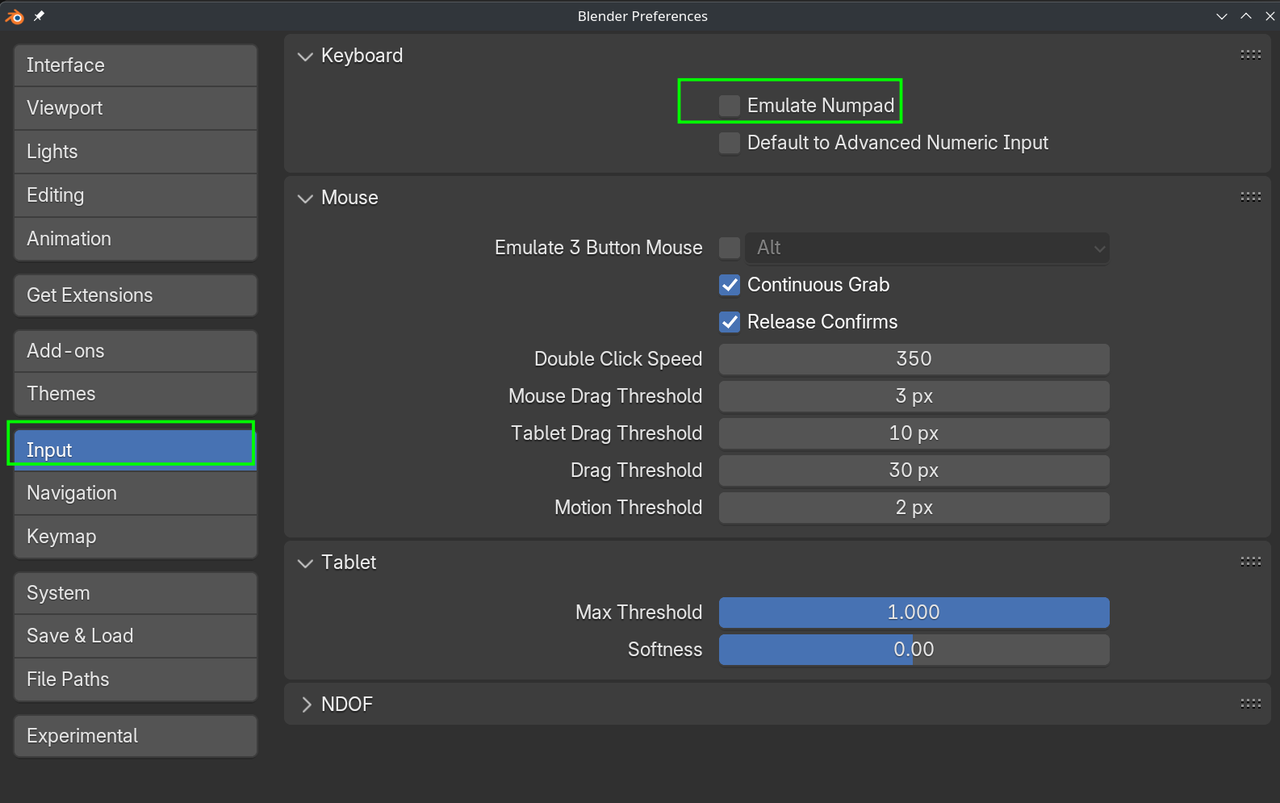

        It’s not mandatory, there are ways around it. For instance, you can enable Emulate Numpad (wouldn’t recommend that though) in your Preferences:

        The first two years, I used Blender without a Numpad, so it’s very do-able.

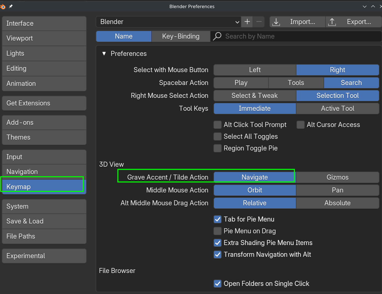

        As the Numpad is mostly used for Views, you can use the Key below the Escape to activate a View Pie Menu:
        This is, what I would recommend, instead of Emulate Numpad, but you can play around and see what works best for you.

          Yeah as Martin says, the view pie menu is the best if you don’t have the numpad. The pie menu has all the functionalities the numpad has. It’s this one:

              I personally prefer the pie menu(aka the tilde key. Technically the accent grave) for quick view switching while modeling I like to use the alt+middle mouse drag. By default it’s set to relative. This means it’s based on your current views position. For example if you’re in front view. Hold alt down then hold down middle mouse button and drag. To the left will give you right side view to the right will give you left side view down will give you top view and up will give you bottom view. Of course if you’re in right side view then dragging right gives front view and dragging left gives back view. I personally go to preferences->keymap and set alt middle mouse drag to absolute. This means when you drag it is the same views as the pie menu. Up is always top. Down is always bottom. Right is right side view. Left is left side view diagonal up/left is front view and diagonal up/right is back view.
