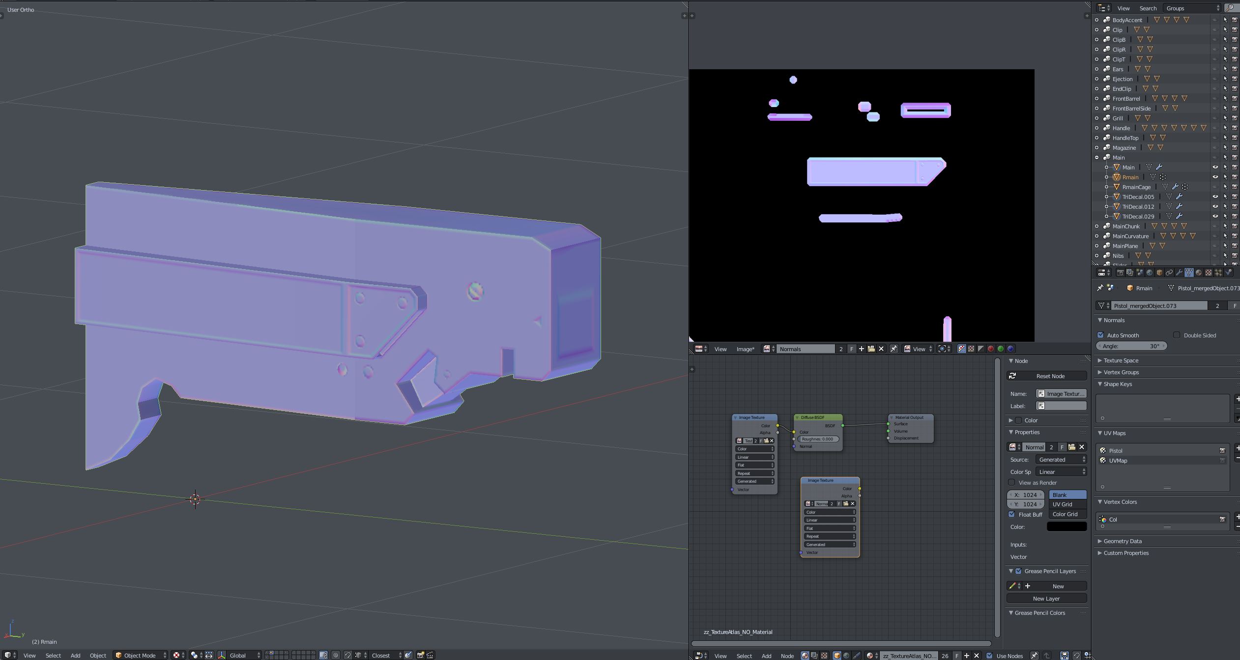

      Hey, I was just wondering why my normals look kinda bland? They arent as crisp as yours it seems.

        Hey @abraxocleaner , those look fine to me! I’m not sure what you mean by bland I guess, but if they look fine when plugged into the normal socket and rendered out then it’s good to go 👍

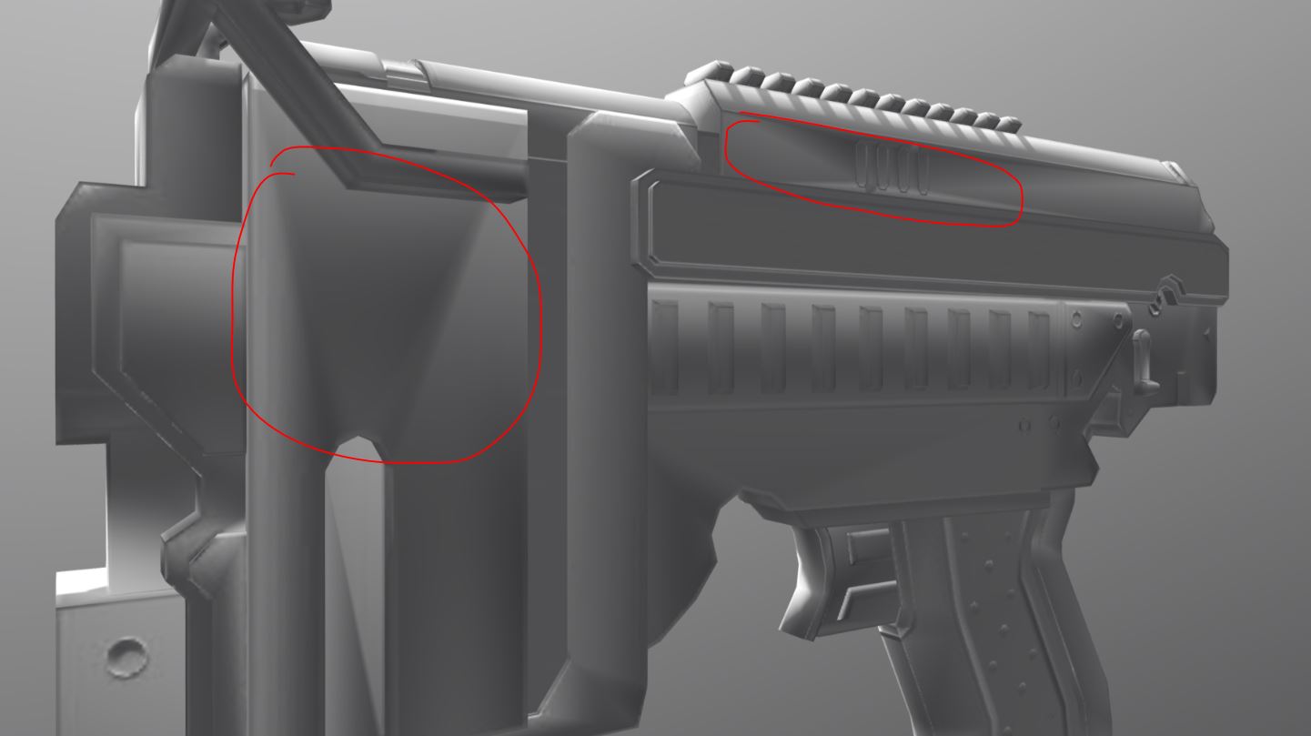

          Oh hey john! I think it just looked bland because it was an exr, I made a png (I watched the video I was supposed to before ) and did that whole 8 bit thingy in photoshop, thanks! Sorry, I shouldnt be asking you here but I have another question regarding the final model? Is there any way to fix this? What causes this issue? Sorry haha, it’s been bugging me for a while

            Hmm, that doesn’t look like the normal map that you’ve baked. Is it set to use its custom normals? Be sure you’ve ended the texture atlas manual unwrap, since that will make things look smooth while you’re still editing the UV’s.
