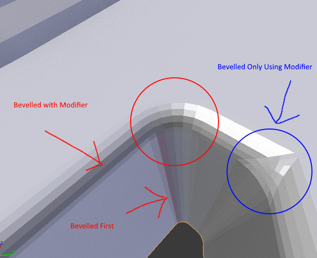

      When I use the Bevel Modifier it creates these weird edges on acute angles.
       Have a look at the images below.
      #26816
        Interesting, it looks like that non-ideal geometry shows a current limitation of the bevel modifier. There will be someone working on fixing it this summer, but in the meantime you might need to bevel that area in edit mode. This addon looks like it would make that process a lot better, but I haven’t had time to try it out just yet: https://www.blendermarket.com/products/MESHmachine

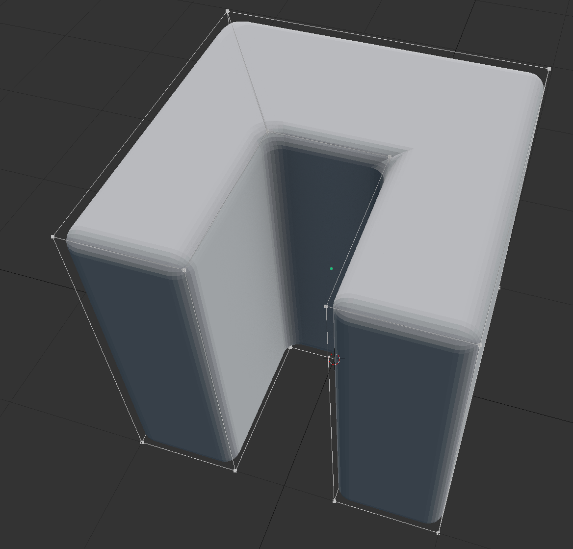

              I am using a default cube extruded on two sides to simulate the issue.
              Using a Ngon:
              Using Quads:
              #26820
                Interesting, for me it only happens when I have an n-gon:

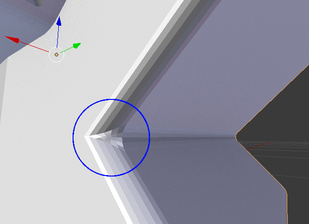

                        Oh I see, so the difference is that one of the top edges is being beveled while the other one is not:
                        If none of the automatic Limit Method options are working, you can set it to Weight and then assign the bevels manually from the Transform section of the viewport properties panel.

                          How come this does’nt happen on your model when you do the same thing?
                          #26826
                            It’s the exact same behavior, it’s just that mine must have the edge that’s on the flat surface beveled as well.
                            #26827
                            Henry Smith
                              If the flat edge isn’t evenly in between the beveled edges it stretches those sides. Not Ideal.
