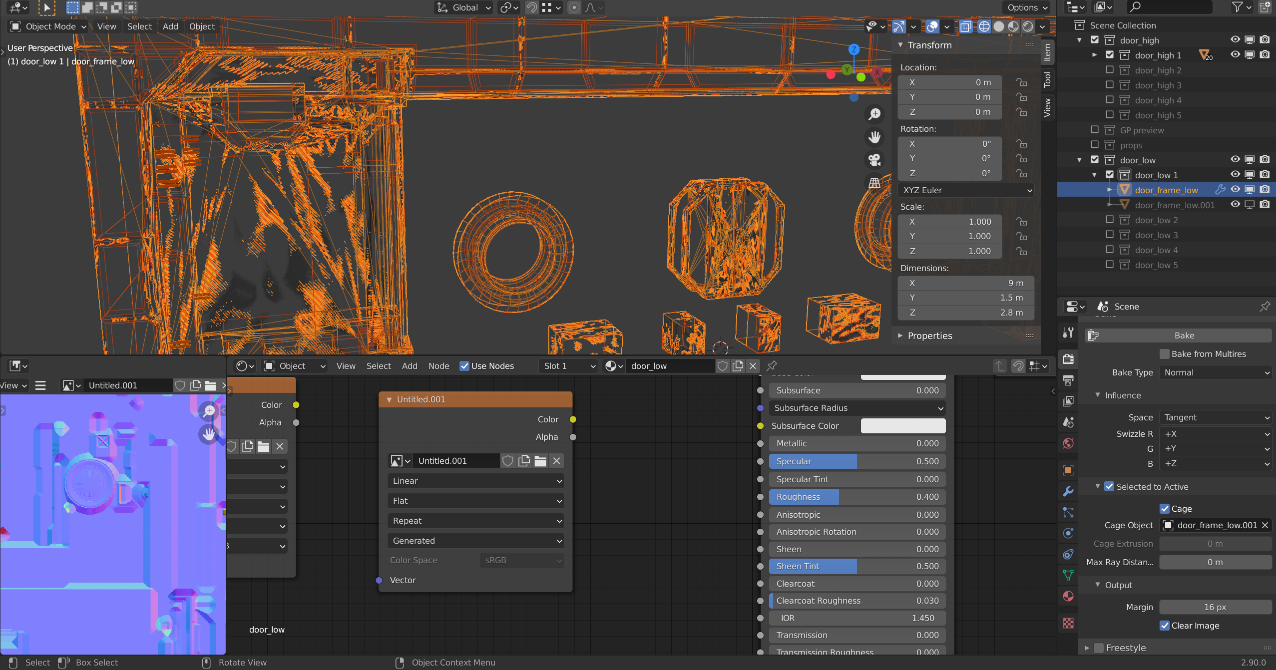

      This is my first time baking normals and I have no idea what happened. I bet it’s something simple that I just missed. I’ve tried changing the cage around and baking without a cage but it’s always something similar to this.

          Jonathan Lampel
            This drove me absolutely nuts, but I finally got it. It’s because the door_high_1 and door_low_1 collections are enabled but are in the door_high and door_low collections which are disabled. Taking them out of those collections or enabling them will fix it!

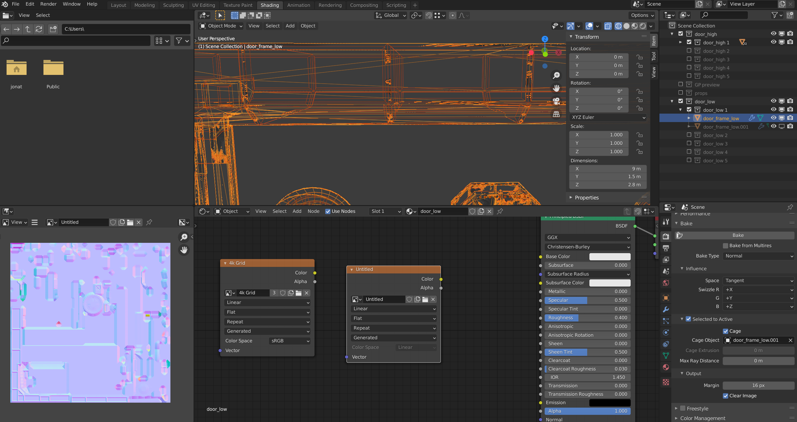

                  Jonathan Lampel
                    Shoot, I’m not sure what to tell ya – I opened up the file, created a new image, and clicked bake. It worked the first time:
                    I am using Blender 2.90 if that makes any difference. Maybe try switching to CPU to see if your GPU is running out of memory partway through?
