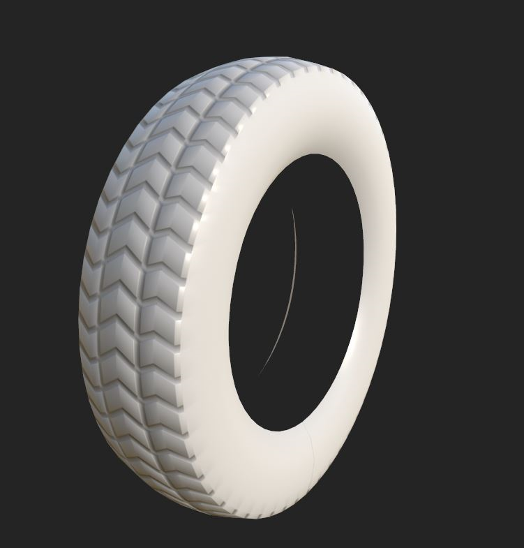

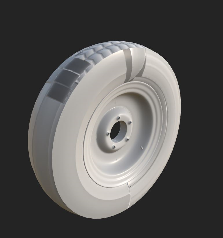

      When I try to bake the entire tire with the rubber, wheel and valve stem, I get a very weird baking result. If I only do the rubber portion, it looks fine. Any ideas what I need to check to fix this?tire_full.pngtire_rubber.png

        I have never used Substance, but maybe I can take a guess and say that that looks as if there are other objects in the scene blocking the main mesh? @chunck will know more.
        #83004
        Adrian Bellworthy
          Check your normals,
          incorrect normal direction is often a source of this type of issue.
          #83005
            And maybe the wheel is slightly offset from the rubber (in Blender). (Sometimes you move things accidentally, without noticing…)
