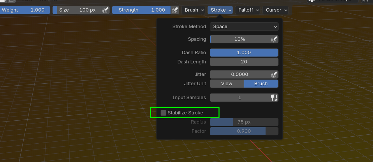

        It looks to me like you have Stabilize Stroke enabled:
        If so, disable that.
