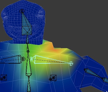

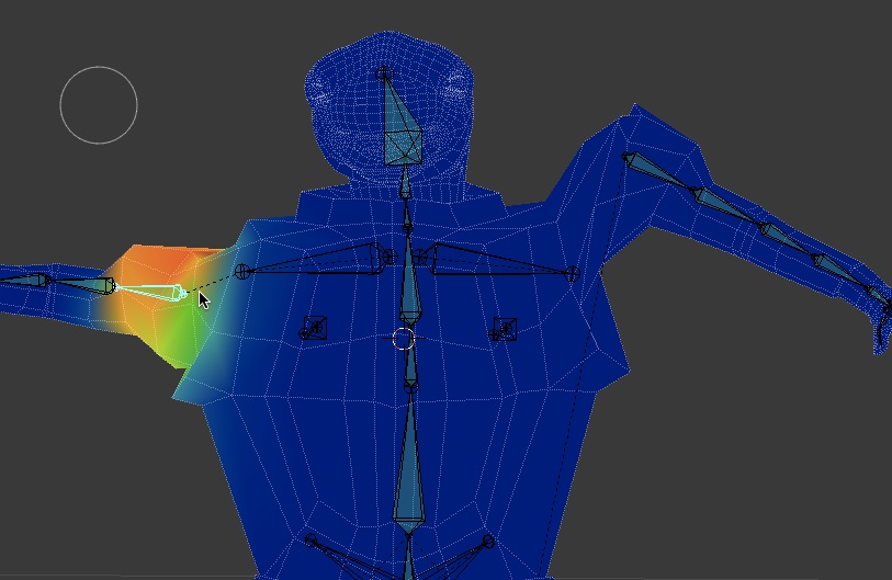

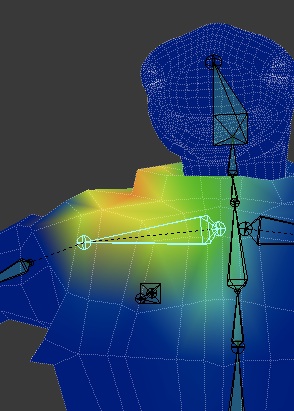

      Got a character I’ve set up with Rigify and for some reason the left and right shoulder weight painting seems to be not working correctly. The painting looks right but the deforms are off.

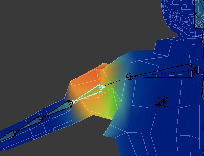

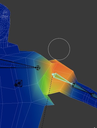

          Thanks, Looking at these screen shots again. It looks like the left arm is parented to the wrong bone. It’s parent is Root. The right arm’s parent is org.shoulder.R
          #34352
          Paul Goodrich
            That was it. Went back to the metarig and reparented the arm. Generated a new rig and it works now. Don’t know how it got un-parented. Thanks for your help.
