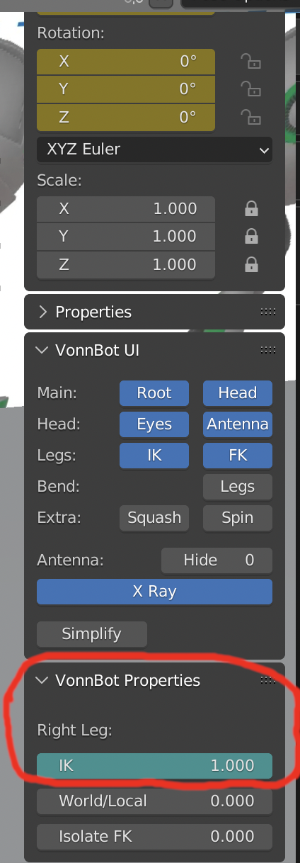

          In pose mode if you open up the side panel by pressing N and look at the VonBott Properties, there’s IK.
          On the left leg it was set to 1.0.
          On the right leg it was 0.0.
          I set both to 1.0 and now the right leg moves.
          For anybody else running into this, here’s a screenshot:

            Glad you got it solved Austin.
            That was my first thought.  Check the IK/FK settings.
            I will put it on my to-do list to adjust this and resave the source files.
