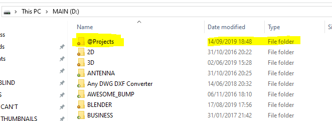

      I am fairly new to Sheep-it , and I have been doing a LOT of rendering on it over the past month. However today I have just discovered something very concerning : I have a rogue folder in one of my hard drives that I have never seen before and can only be a project of somebodys that has been rendered in Sheep-it.
      The strangest , and most concerning thing is that it is on a Hard Disk that has NEVER been associated with Sheep-It.

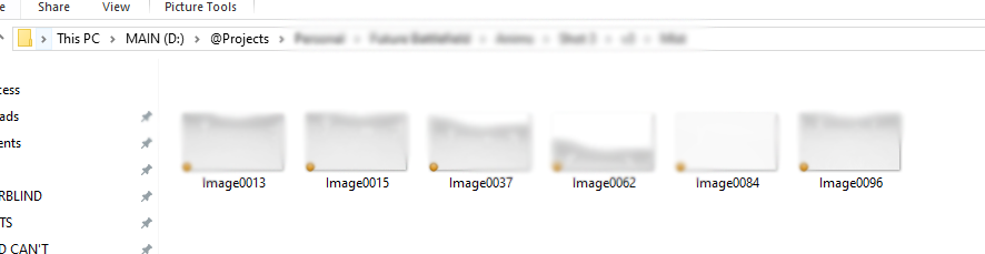

      The screenshots below show the folder, and each subfolder in it (apart from any sensitive info that whoever this belongs to would get upset over.
      What concerns me , is not just the fact that my computer is being invaded by folders that I have no idea about – on Hard Disks that Sheep-it should never have had access or permission to be in , but also the fact that I have access to some poor individuals work … It makes me wonder how many other peoples projects are being left on random HDD’s across the world.

              @jakeblended , yes I agree, and there is actually a dedicated file in the drive that you select in Sheep-it where it caches the render files as they are used. But I checked that out and all the files are zipped, with only the actual Blender file inside that can’t be opened without a password.
              The files I showed above are actual finished renders of somebody project , that I can open and see and edit. Whats more , they are in a project folder in a drive that has never been associated with Sheep-it.
              The point I was making is that Sheep-it has accessed and saved into a drive that I never allowed it to , and the files that it has saved are somebodys private files that are not encrypted and I can do as I wish with.
