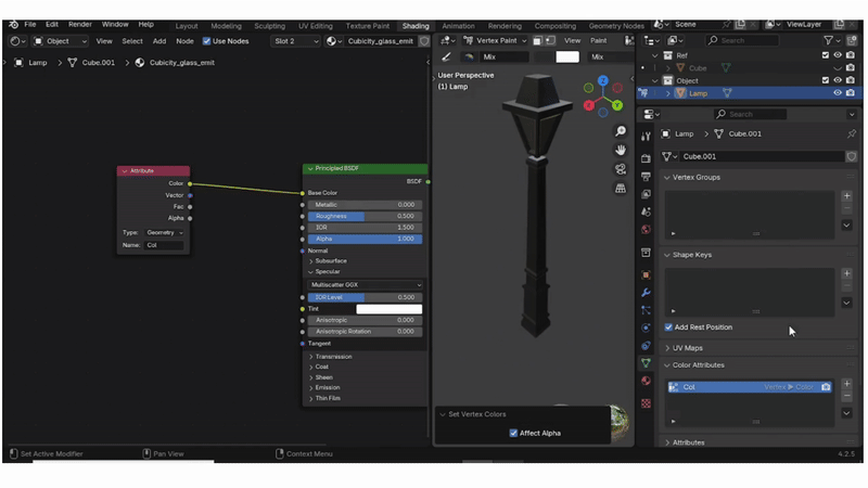

      While trying to fill paint using vertex paint my object color will be filled completely. I have also tried assigning materials several times. Am I doing something wrong or missing something?
      #94052
        Hello. Can you walk us through the process? So expand on your explanations a little more. What exactly are you doing? So we can see where the mistake is. Also attach some screenshots to see if we can spot an error.
        #94053
        Devesh Gupta
          Sure I am attaching this video to show the problem i am facingvertexPaintIssue.gif
          #94054
          Devesh Gupta
            this is the whole scenario i am stuck maybe there is something i am missing in this. The version i am currently using is blender 4.2.5
            Thank you for the reply
            #94055
              Did you assign the material to their respective faces? At around 2:55 Kent starts the process of assigning each material to the faces of the lamp post. That way material #1 is assigned to the entire lamp and material #2 is assigned to the faces that make up the glass of the lamp. And then the vertex color will work as you intend.

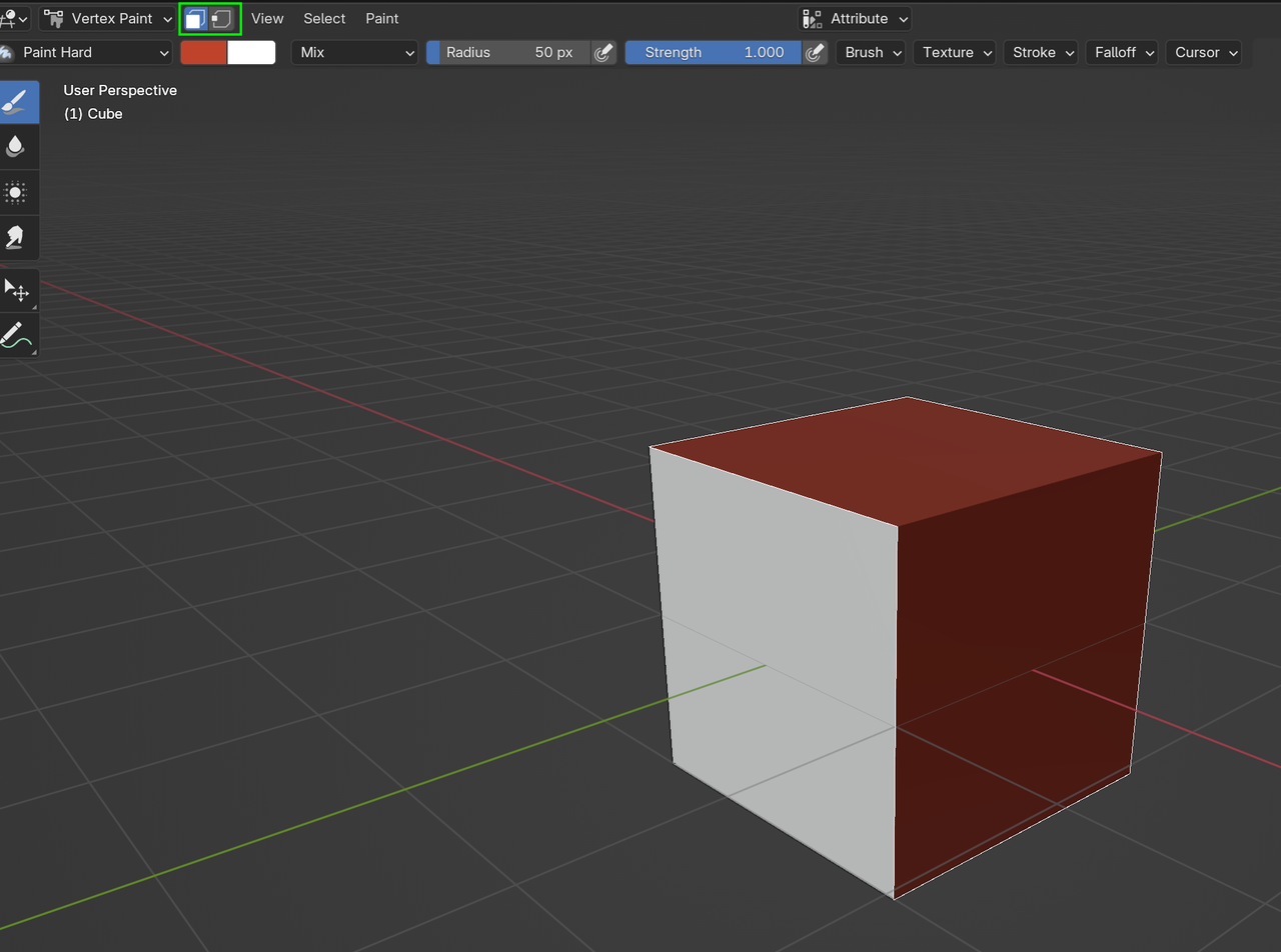

                You can use Face Masking and Select the Faces you want to Paint (they will show slightly darker) and then use CTRL+X:
                If I remember correctly, that’s how Kent does it as well (but with the ‘old’ shortcut SHIFT+K).

                  I did assign the materials thats why i am unable to understand the issue
                  #94058
                    Maybe this is one of those cases where we have to go deep into Sherlock mode. Can you upload your file and paste the link? So we can tinker with it and run experiments.

                      I just 5 minutes ago tried the face masking as mentioned by Martin Bergwerf it seemed to work but the paint has a weird finish to it025-03-28 230903.png
